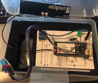

First we need a device to use at the edge. I will be using a "Particle Electron" shown below.
  • Particle Electron 3G Cellular Board
  • Green LED
  • White LED
  • DHT11 Temperature and Humidity Sensor
  • Breadboard
  • LiPo Battery
The device you choose should take into account how it will be deployed and what that environment will offer. For example this device will be used to demonstrate the full solution in several settings and several locations. With no real predictable environment the cellular access combined with the ability to run off a rechargeable battery make this device ideal.

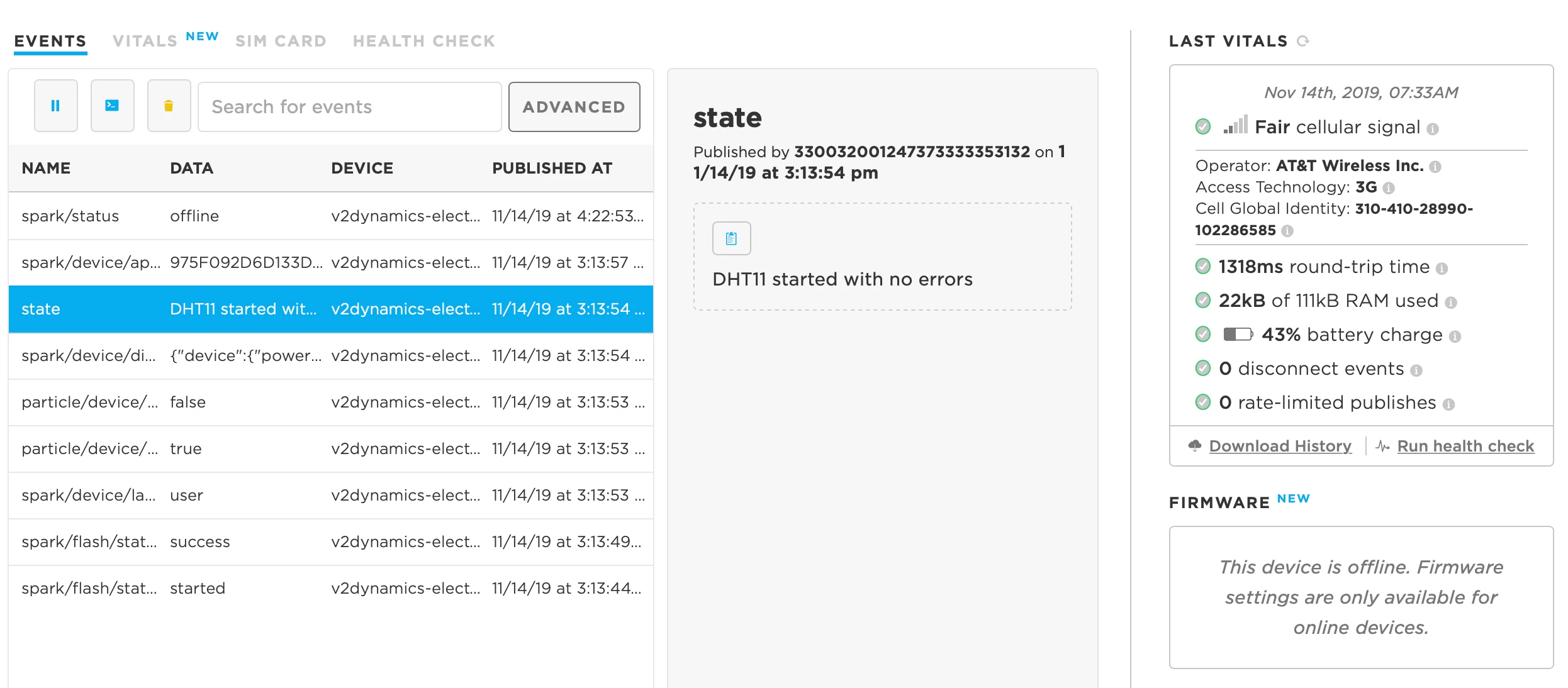

We can see the device and its metrics in the particle console once you have registered it following the instructions included with the device.

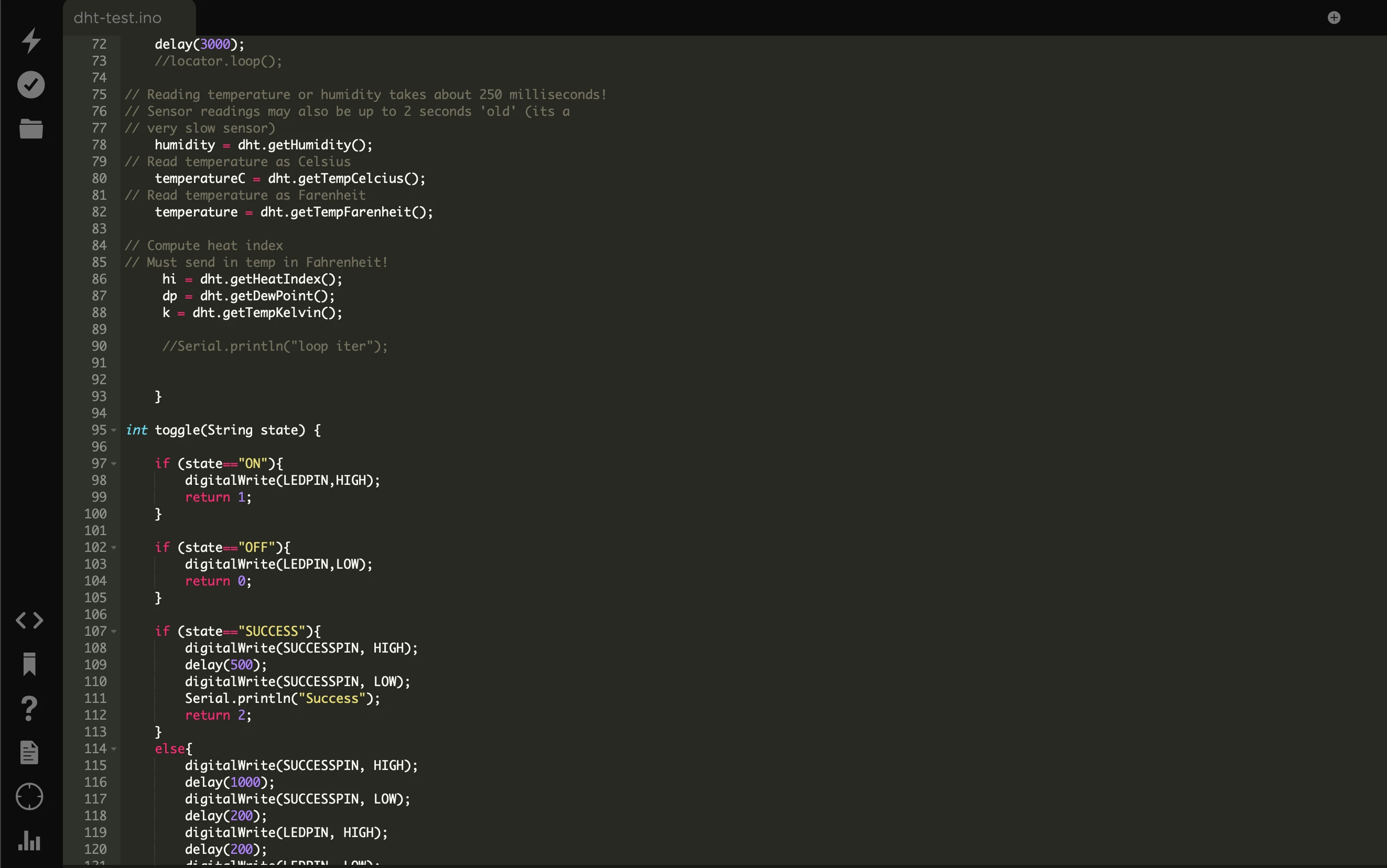

To program the device we need an IDE. All devices have IDE’s they work with some have several to choose from.
You are free to use any IDE you feel comfortable with. The particle devices have access to an online web IDE which I have found useful as well as IDE plugins for Atom and Visual Studio.
Using the IDE you chose, flash the DHT11 application firmware to your device.
If you're following along then this would be the .ino file from the github repo.
DEVICE TESTING

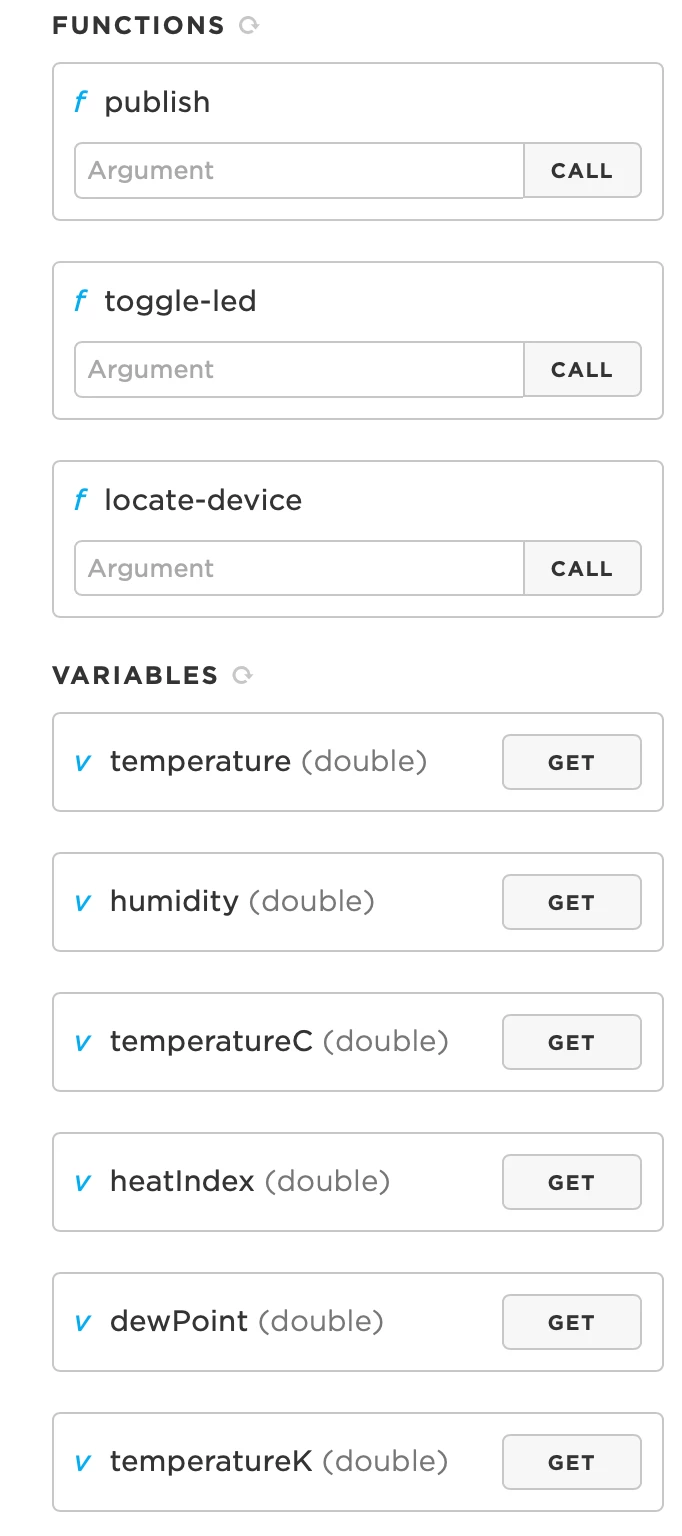

With the firmware flashed you can verify that you are getting readings. Since I chose to use the particle board I am able to call my functions from the console.
I can click “GET” on any variable to grab a current reading from the device, or I can call any of the pre-defined functions to execute the code on the device and examine the results.
Go ahead and test everything out and once you are satisfied with the functions and variables you have and how they accept and transmit their data you can begin to move on to the next stage in our solution.

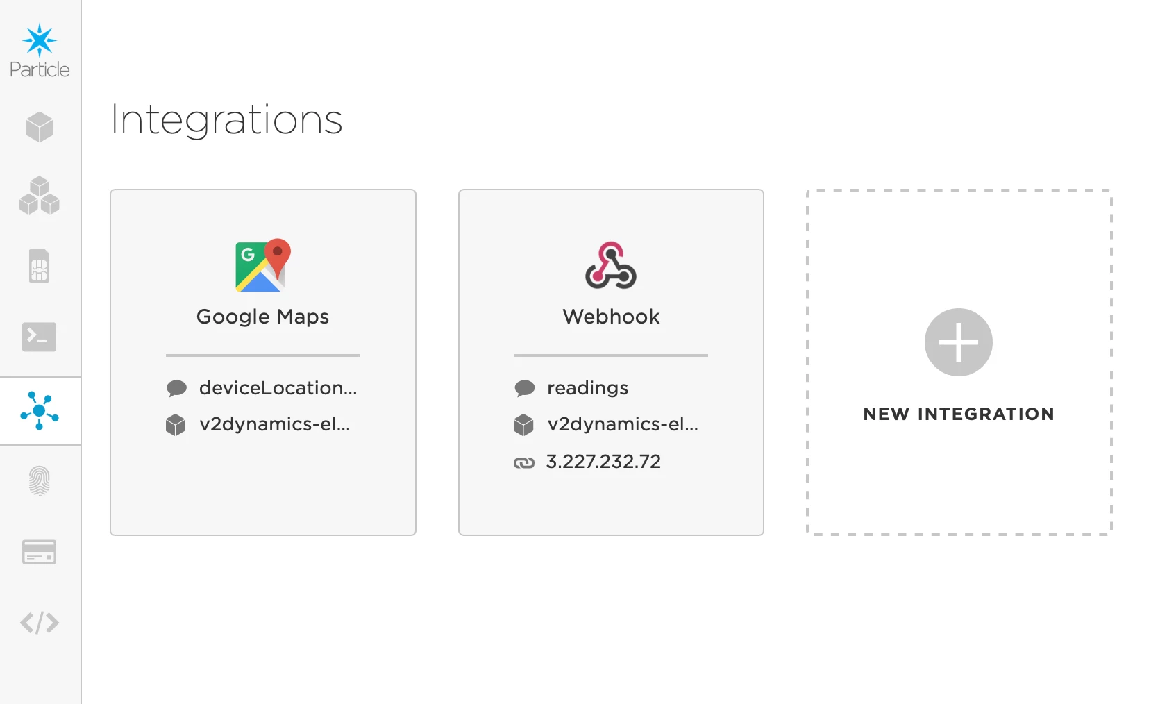

CREATE INTEGRATION
To create the web-hook you simply go to the integrations tab in the Particle console and enter the required info. You should then see it listed as an Integration on the Integration tab. All you need here is the IP address of you ingestion server. We will be using Apache Nifi so we send the data to our NiFi URL.
This takes care of our integration point into the organization. And out sensor is fully operational and ready to be deployed anywhere in the field as is. Great work!

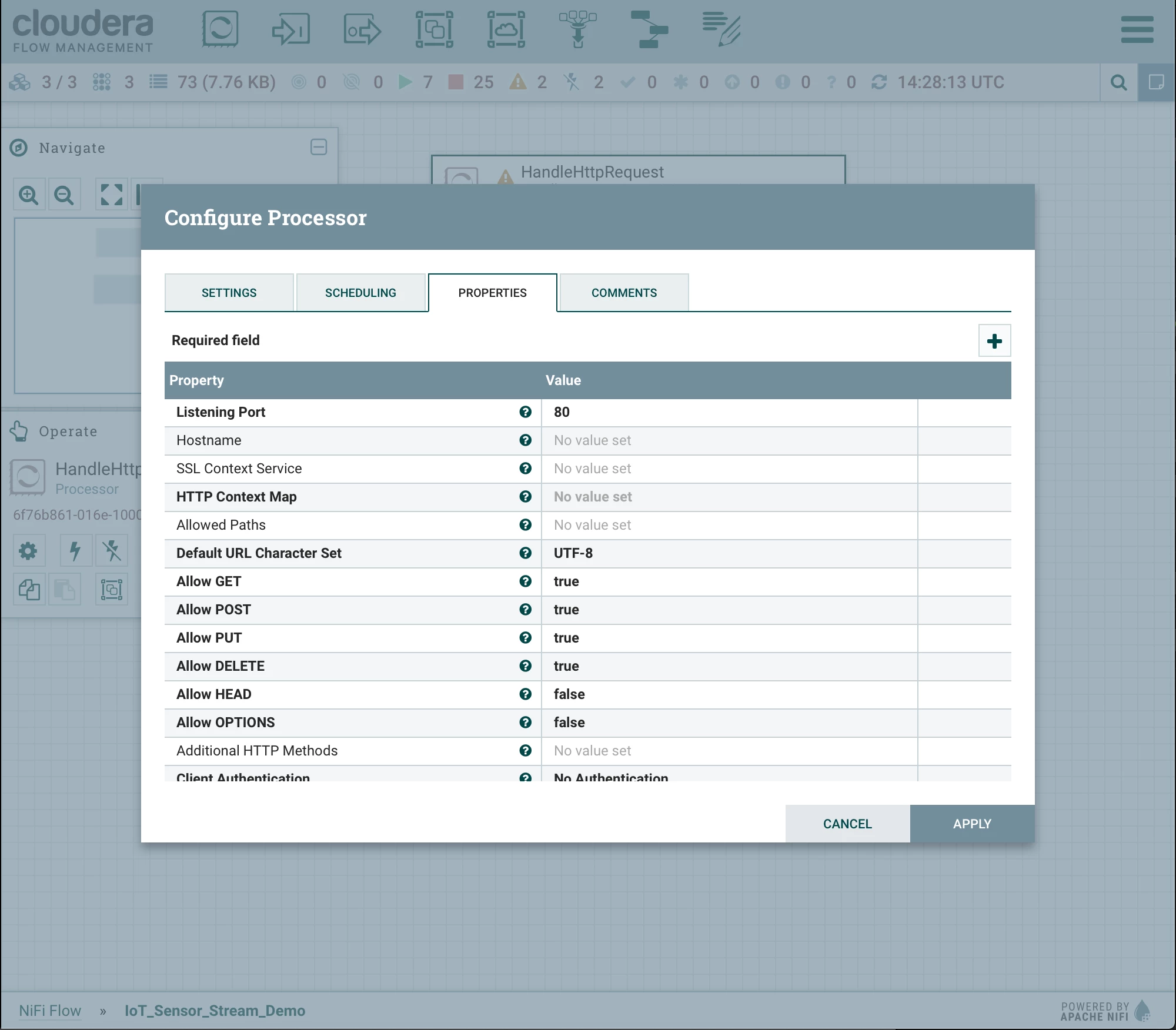

As you can see the majority of the properties are pre configured to default values and there are only a few values we need to provide. Namely :
1.Listening Port if different from 80.
2.HTTP Context Map
       - This is created for you in the drop down by selecting create new and enabling the service.
3.Any additional values you wish to add in your tailored solution.

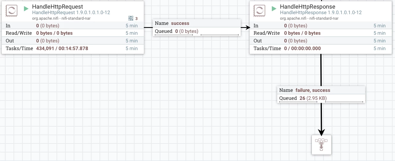

That is all now close the dialogue and drag another processor onto the canvas. This time we use the Handle HTTP Response and specify the return code. Link the two processors together by dragging a connection from Request to Response as seen below:
We also add a “funnel” to direct our messages temporarily as we are developing our flow to allow us to see what our results are.
Now you can go publish some data from the particle console and you will start to see those messages in the Queue in NiFi. That’s all we have a fully functional integration point ready to pull in all messages from our first device and more in the future.

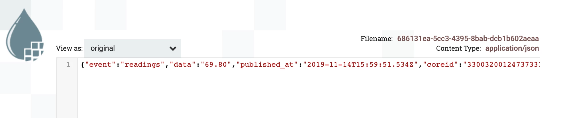

Back to our flow. If you right click the queue and select list queue you see a list of messages. These are flow files and represent each individual event that entered NiFi through your HandleHTTPRequest processor. You can expand a message and click view to see the data you are dealing with:
So our JSON data package will have the following format:
"event": "readings",
"data": "69.80",
"published_at": "2019-11-14T15:59:51.534Z", "coreid": "330032001247373333353132"
We can always modify the firmware to add additional reading values but this is great for our first phase and 1.0 release.

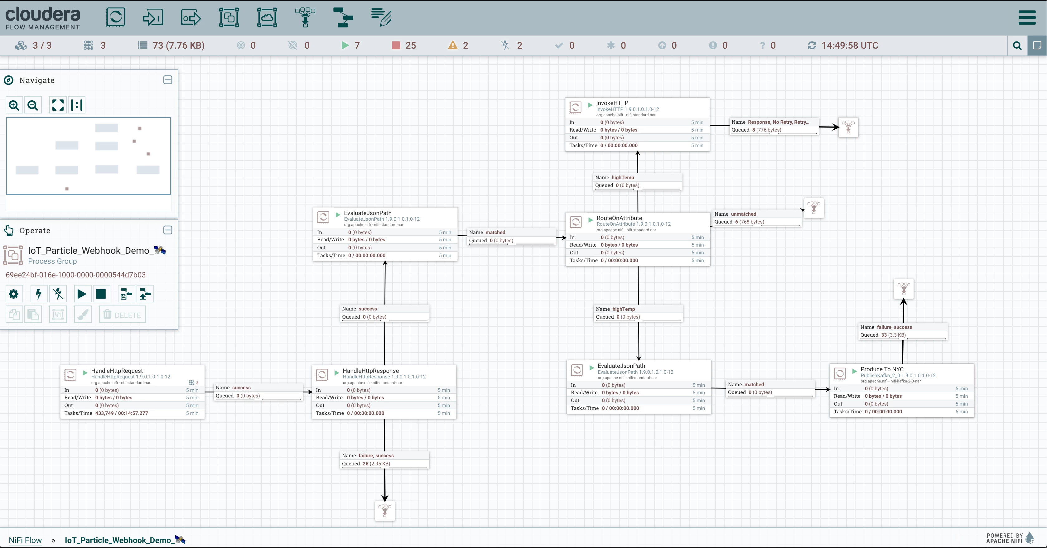

Now let’s add the remaining processors to complete our flow. Add the following processors to the canvas:
1. EvaluateJSONPath x2 2. RouteOnAttribute
3. InvokeHTTP
4. PublishKafka_2_0
Now connect them so that the data flows as in the image below:

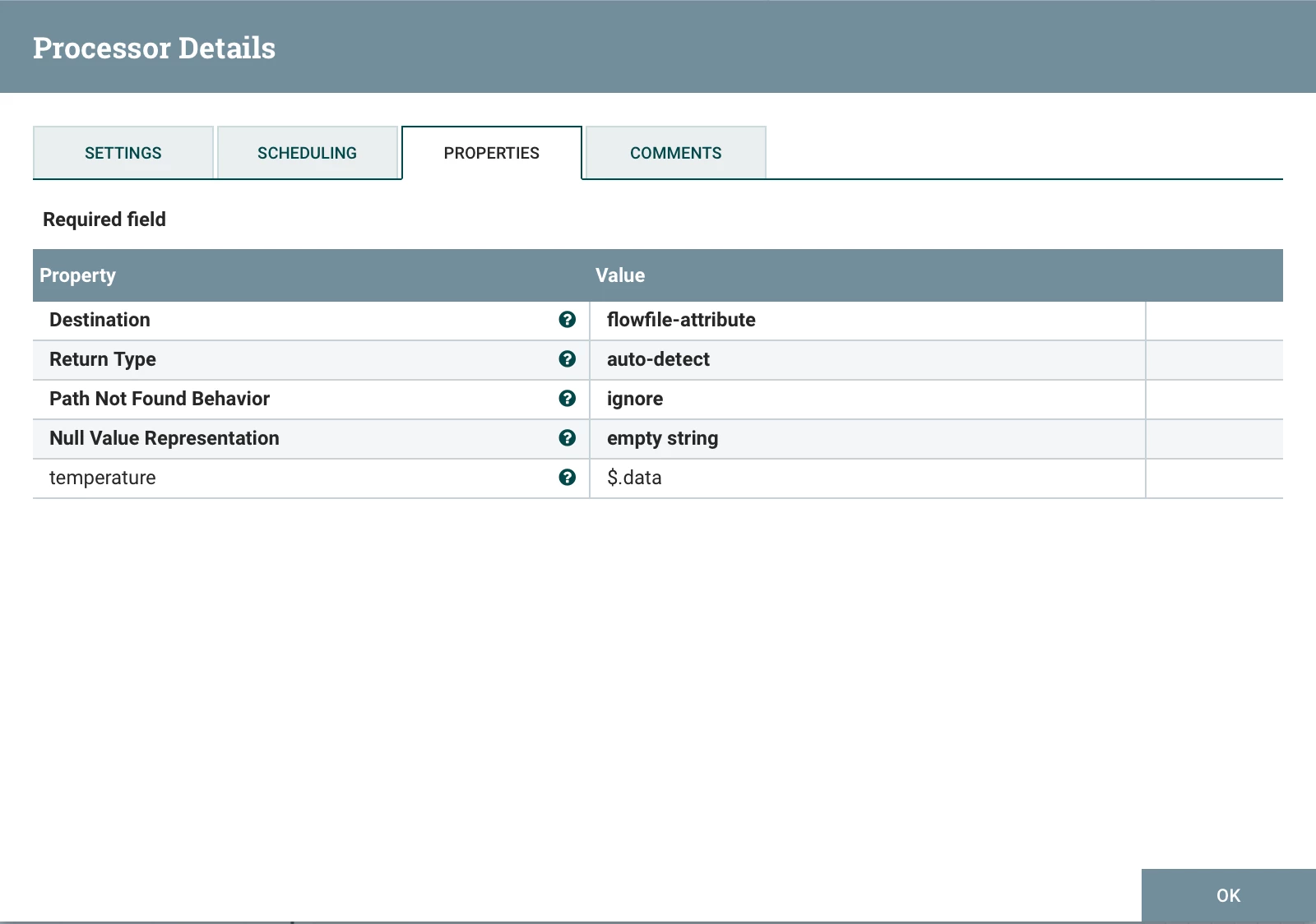

Our first EvaluateJSONPath will simply extract the temperature and store it as an attribute.
[ $.data ] is all we need to enter here that will return the value of the data element that is at the root level of the json.

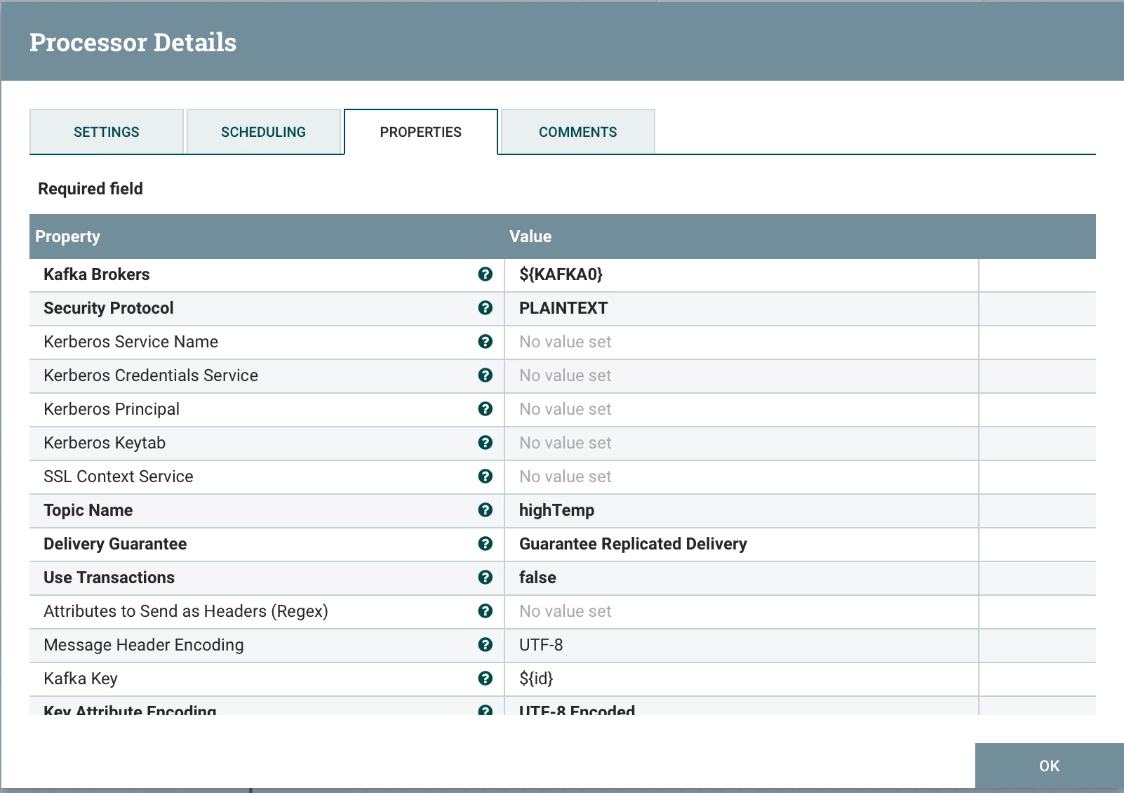

Further down our flow we also push our event data into a Kafka Topic which allows us to decouple our ingest and realtime action portion of the solution from additional downstream applications and storage that depend on this data.
DECOUPLING
In our PublishKafka processor we can specify the Kafka broker and topic we wish to write to. That is all you need to do! Much simpler than having to write java code every time you want to push new data into Kafka, or switch topics...
You may have noticed several PublishKafka processors. There are many available and you can do even more with the others. PublishKafkaRecord allows you to convert formats and publish to Kafka all in a single processor by setting one more property value! Try converting your JSON to Avro for example if you are interested in exploring this further.
We will leave it at that as this checks all our phase 1 boxes and completes the final portion of our solution.
