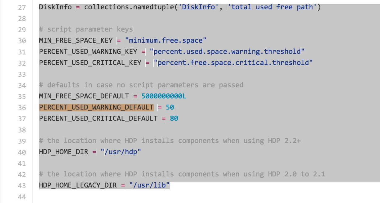

https://github.com/apache/ambari/blob/trunk/ambari-server/src/main/resources/host_scripts/alert_disk_space.py
vi /var/lib/ambari-server/resources/host_scripts/alert_disk_space.py
# defaults in case no script parameters are passed
MIN_FREE_SPACE_DEFAULT = 5000000000L #5GB
PERCENT_USED_WARNING_DEFAULT = 50
PERCENT_USED_CRITICAL_DEFAULT = 80
You can change the above parameter to avoid alerting at 80% threshold reached in case it needs to be aletered to 85 or 90

@Neeraj Sabharwal
As per Ambari REST API docs https://github.com/apache/ambari/blob/trunk/ambari-server/docs/api/v1/alert-definitions.md
the definitions can be updated
Is it possible to use REST API to update these thresholds ?
If not, then once the cluster has been deployed should these properties be updated in /var/lib/ambari-server/resources/host_scripts/alert_disk_space.py and then ambari server restarted to push this update to all the agents ?
I couldn't find a way to update these thresholds in Ambari UI

In addition don't forget to re-start Amabri-server after making above mentioned changes.
