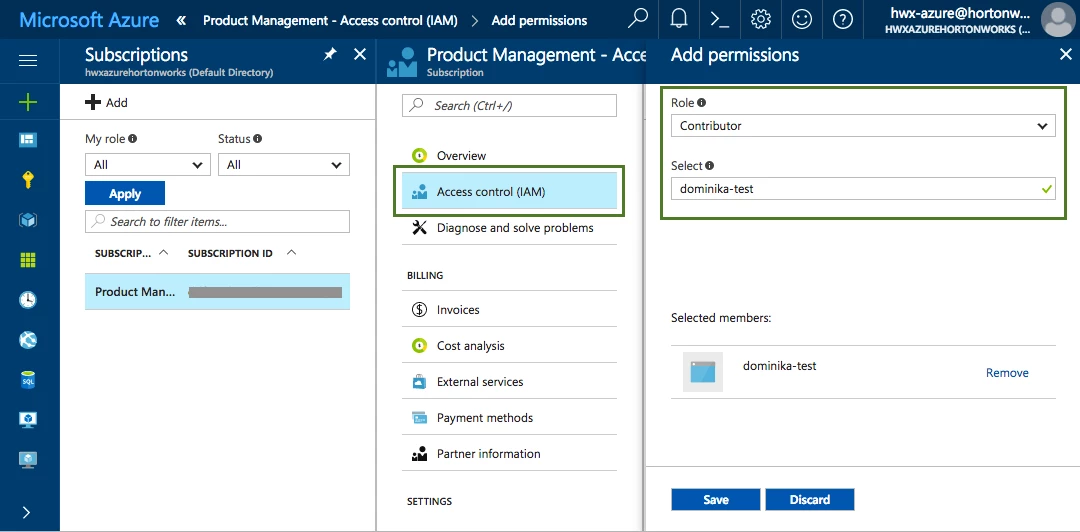

One tip here is that after registering an Azure application you may have to ask your Azure administrator to perform the step of assigning the "Contributor" role to it:
Your account will most likely not have the required permissions and you will get an error. Once your Azure admin performed the role assignment, you can perform the create credential task in Cloudbreak.

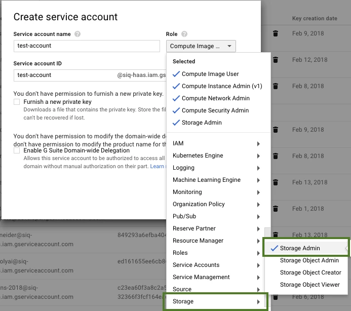

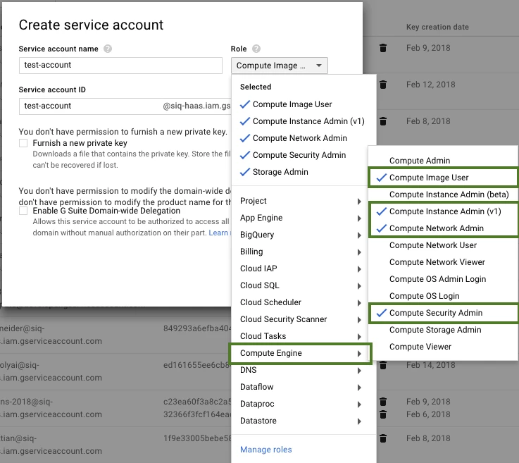

In order to launch clusters on GCP via Cloudbreak, you must have a Service Account that Cloudbreak can use to create resources. In addition, you must also have a P12 key associated with that account.
Usually, a user with an "Owner" role can assign roles to new and existing service accounts from IAM & Admin > IAM. If you are using your own account, you should be able to perform this step, but if you are using a corporate account, you will likely have to contact your Google Cloud admin.
The service account must have the following roles enabled:
  • Compute Engine > Compute Image User
  • Compute Engine > Compute Instance Admin (v1)
  • Compute Engine > Compute Network Admin
  • Compute Engine > Compute Security Admin
  • Storage > Storage Admin
Note that you must include these exact permissions or else you will run into problems.
