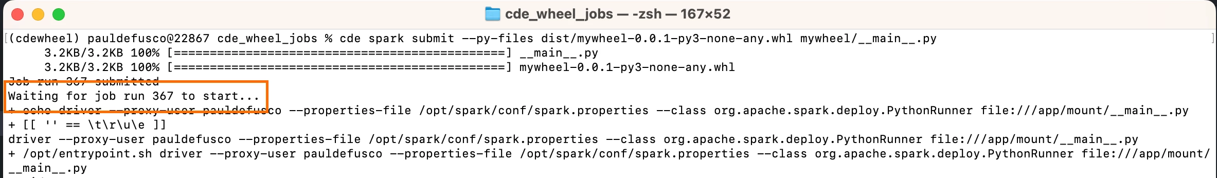

Once you have the CDE CLI installed on your terminal you can launch a CDE Job from local via the CDE CLI via the ```cde spark submit``` command. Copy the following command and execute it in your terminal:
cde spark submit --py-files dist/mywheel-0.0.1-py3-none-any.whl mywheel/__main__.py

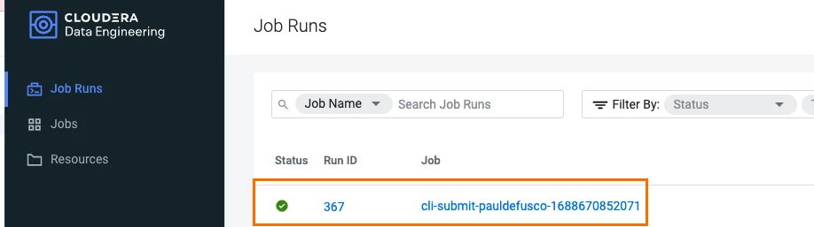

In the terminal, validate that the Spark Job has launched successfully and note the Job Run ID.

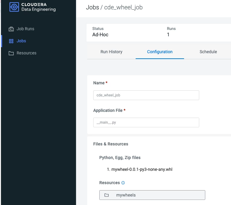

Next, navigate to the CDE Job Runs UI and validate job execution:

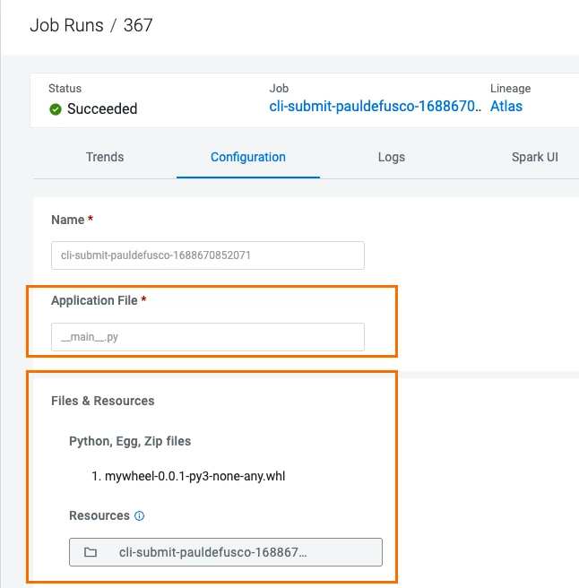

Open the Job Configuration tab and notice that the Wheel has been uploaded in a File Resource for you.
However, notice that the Job Configuration tab does not provide means to edit or reschedule the job definition. In other words the entries in the Configuration tab are final. In order to be able to change the definition we will need to create a CDE Spark Job.

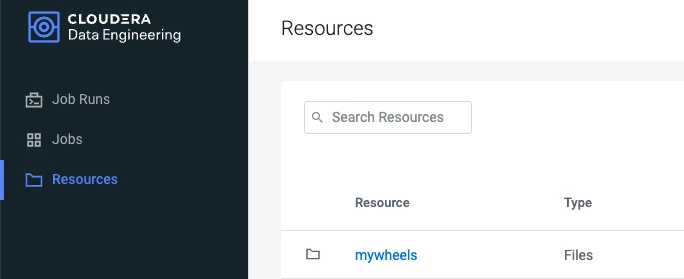

Create the File Resource:
cde resource create --name mywheels

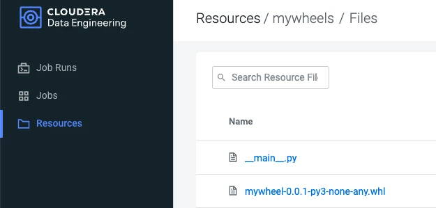

Upload Application Code and Wheel to the File Resource:
cde resource upload --name mywheels --local-path dist/mywheel-0.0.1-py3-none-any.whl
cde resource upload --name mywheels --local-path mywheel/__main__.py
Navigate to the CDE Resource tab and validate that the Resource and the corresponding files are now available.

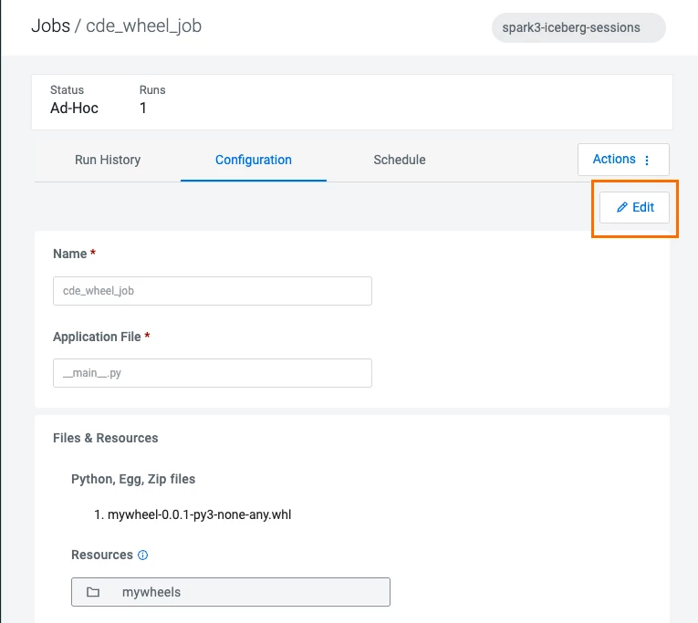

Create the CDE Spark Job definition. Navigate to the CDE Jobs UI and notice a new CDE Spark Job has been created. The job hasn't run yet so only the Configuration tab is populated with the Spark Job definition.
cde job create --name cde_wheel_job --type spark --py-files mywheel-0.0.1-py3-none-any.whl --application-file __main__.py --mount-1-resource mywheels

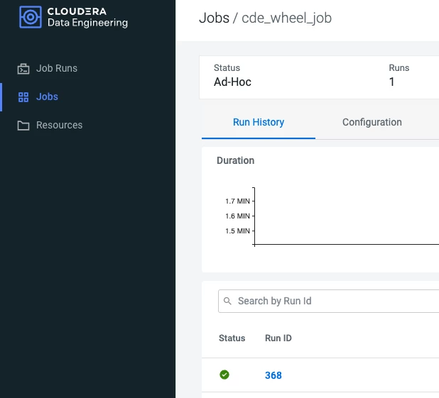

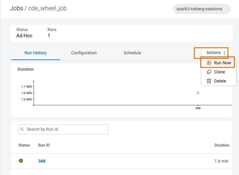

Finally, run the job. Now the Job Runs will include a new entry reflecting Job execution:
cde job run --name cde_wheel_job
Notice that the CDE Job definition can now be edited. This allows you to make changes to files and dependencies, create or change job execution schedule, and more.
For example, the CDE Job can now be executed again.
