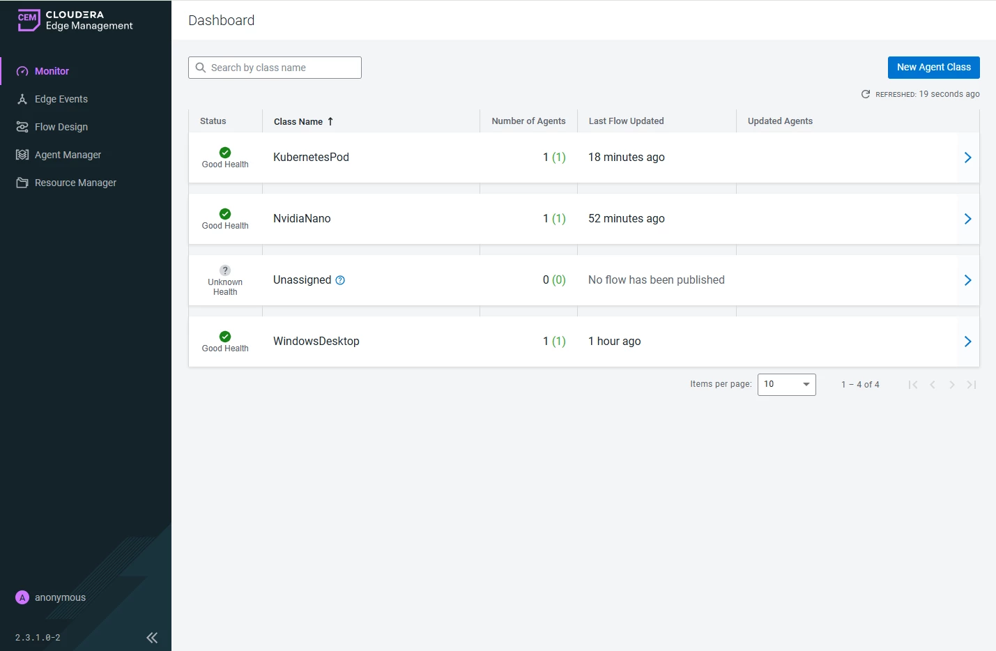

If you have ever run Cloudera Edge Flow Manager (EFM) out of the box on Kubernetes, you know the sad little moment when the pod restarts and every agent class, every flow, and every resource you painstakingly uploaded is just… gone. EFM’s default persistence lives inside the pod’s ephemeral filesystem, and unless you wire it up properly it never sees a second day.
This post is the recipe I keep coming back to for running EFM 2.3.1.0-2 on minikube with full persistence. All state survives kubectl rollout restart, minikube stop, or the laptop lid closing on you at the wrong moment.
Three things need a permanent home:
  • Metadata (agent classes, flows, agents, manifests) → PostgreSQL
  • Agent binaries (MiNiFi C++ / Java installers) → a PVC
  • Uploaded resources (Python scripts, JARs, custom assets) → a second PVC
The third one is the piece a bare EFM install always loses on restart, and it is the reason this post exists.

10. Access the UIPermalink
Open your browser and go to:
http://127.0.0.1:10090/efm/ui/
You are in. Create your first agent class, design a flow, publish it, and upload a resource — everything is now backed by Postgres and the two PVCs.
11. Prove the PersistencePermalink
The whole point of this exercise. Bounce EFM and confirm nothing disappears:
kubectl rollout restart deployment/efm -n cld-streaming
kubectl rollout status deployment/efm -n cld-streaming --timeout=180s
Refresh the UI. Your agent classes, your flows, and your uploaded resources should all still be there. Agents re-download their assets from the PVC-backed file on the next heartbeat.
For an even stronger test, run minikube stop and minikube start. Once EFM’s pod comes back Ready, everything reloads from Postgres and the PVCs automatically. Nothing to re-upload.
