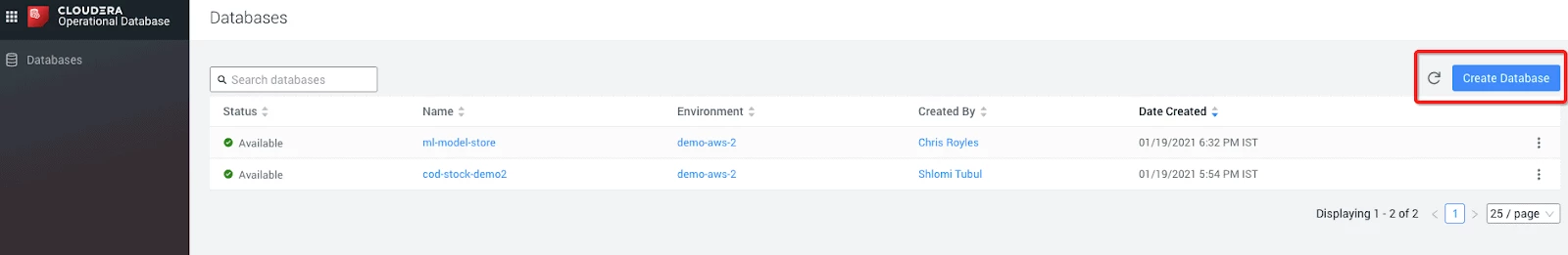

The first thing we need to do is to create a database in COD:
  1. Log in to Cloudera Public Cloud 'Control Plane' (CP)

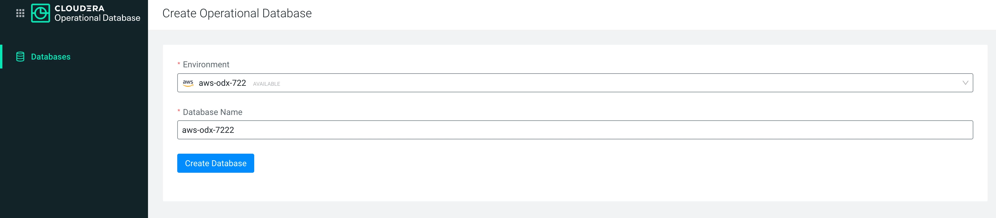

  3. Select the environment to which the COD will be attached and give a unique name for the COD, and then click Create DatabaseScreenshot 2021-02-18 at 10.21.39 AM.png

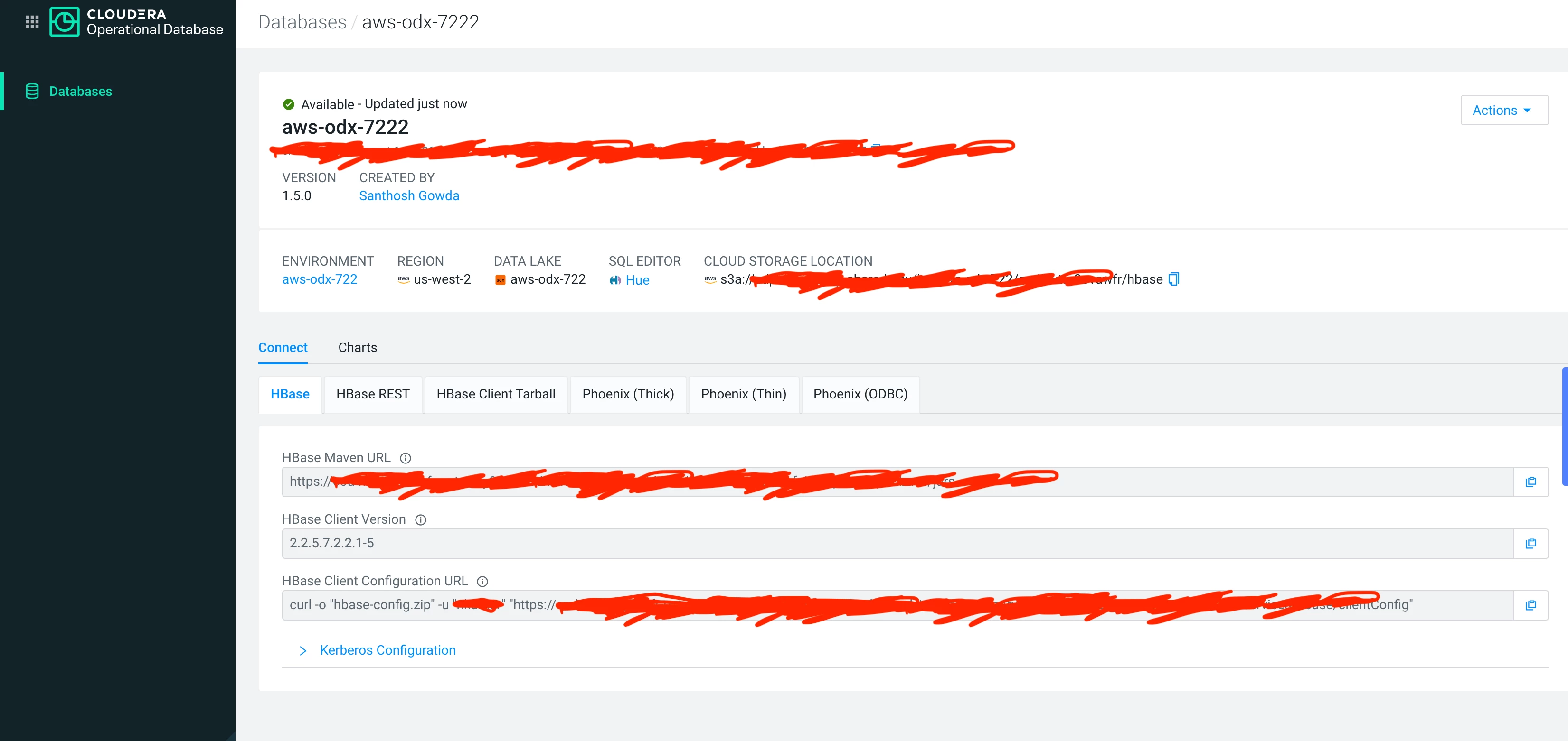

  4. Once created, open the COD page and use the HBase Client Configuration URL to get the hbase-site.xml needed in CMLScreenshot 2021-02-18 at 12.19.50 PM.png

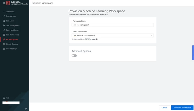

Next, Provision CML:
  1. Log in to CDP Public Cloud CP
  2. Select Machine Learning and click Provision Workspace
  3. Select the environment for which the CML workspace will be provisioned and give a unique name for the same, and then click Provision WorkspaceScreenshot 2021-02-18 at 10.19.22 AM.png

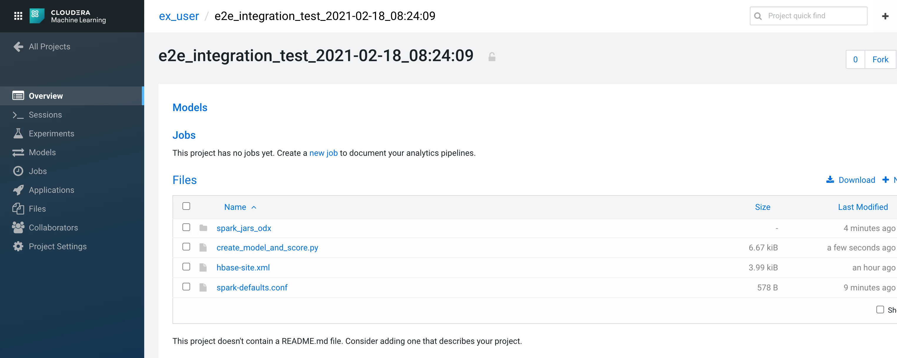

Create Project in CML: Model and Prediction
Once CML is provisioned, we go ahead and create a project in the workspace. We will be using the local template and upload the required files to it. create_model_and_score_phoenixTable.py is the pyspark script that we will be using for the task. Screenshot 2021-02-18 at 3.19.47 PM.png

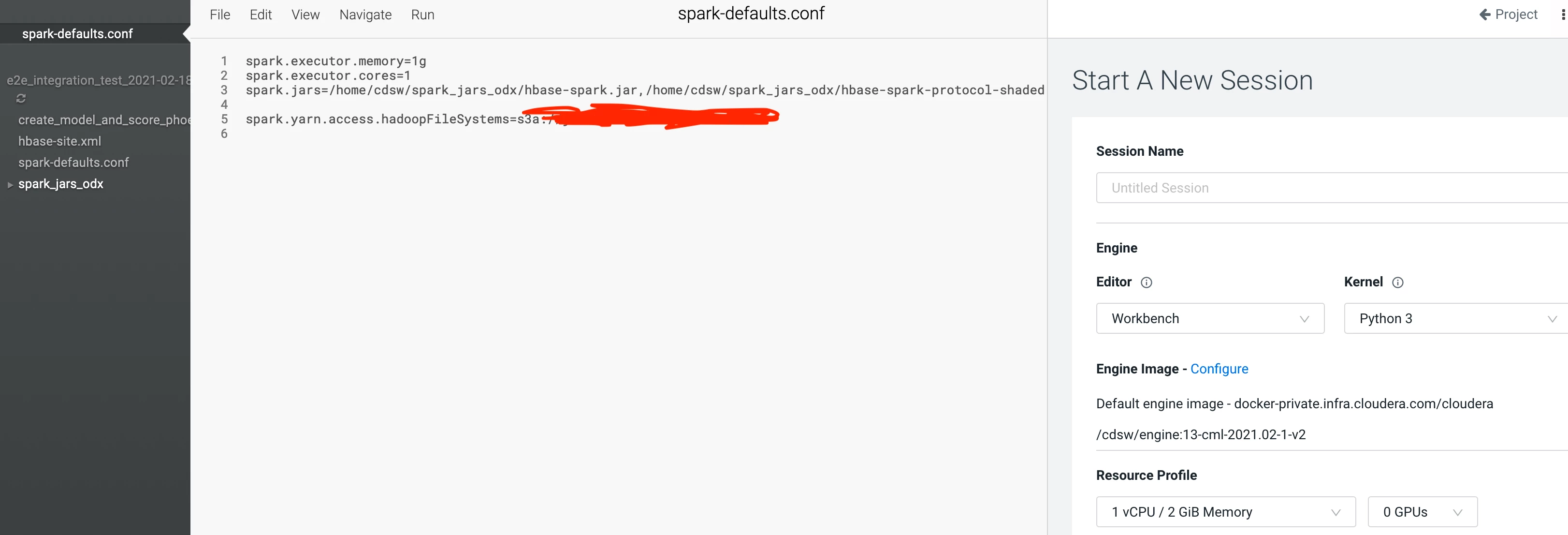

CML: Configuration for use in CML session
  1. Upload the configuration files we downloaded from COD (A.4); we will require the hbase-site.xml file for use in the CML session to connect to the COD (see picture above).
  2. We also need to configure the spark-defaults.conf file with jars to be used, and if there are any external cloud storage in use (from where data is being read), we will need to configure that too for Spark to authenticate with IDBroker and get access.Screenshot 2021-02-18 at 2.42.29 PM.png
    Note: Since we have the data in an external S3 bucket, we added appropriate IDBorker mapping to allow the user access to this external bucket.

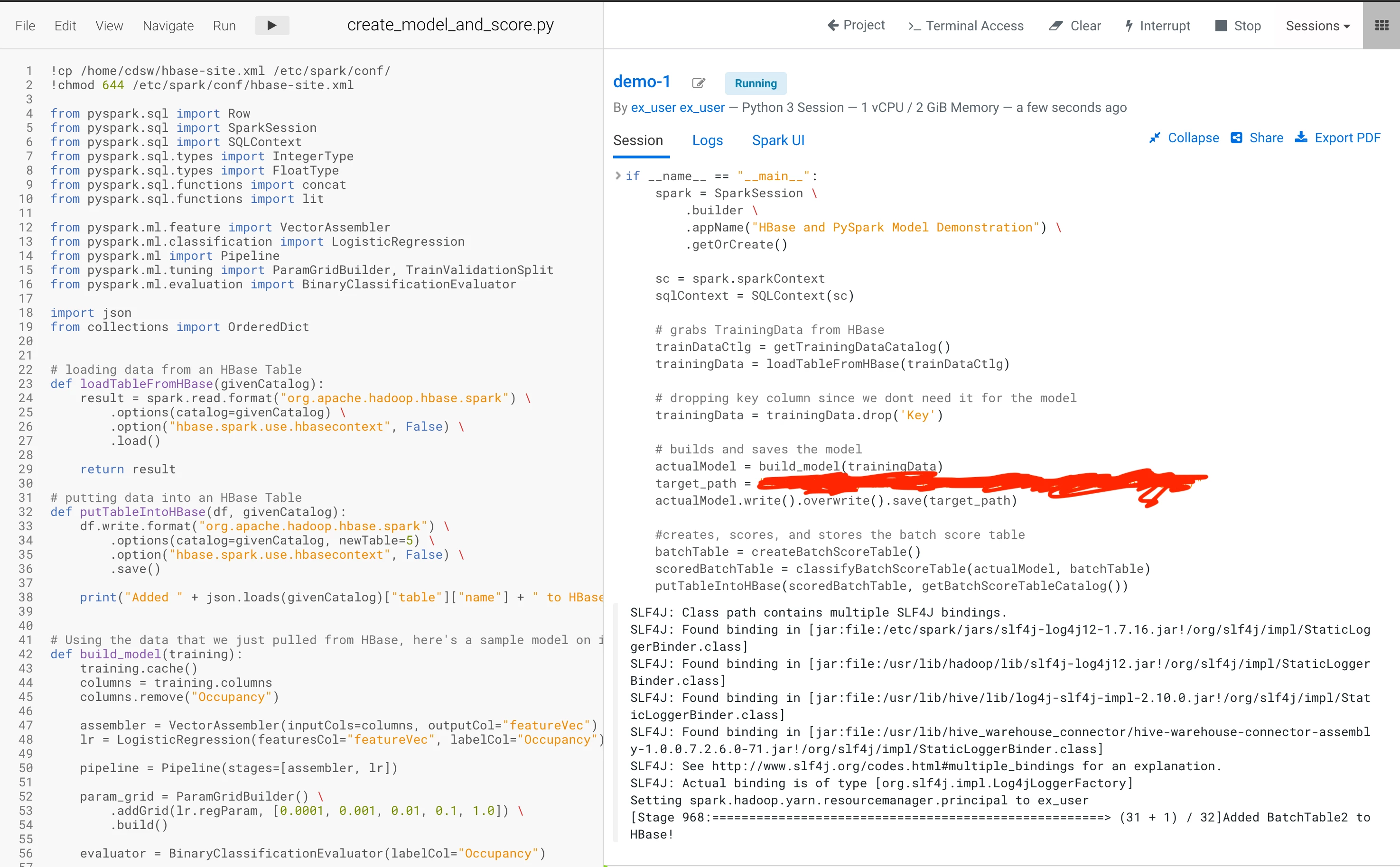

The pyspark script we used can be found here.
Though the code in this file is written for CML-CDSW integration (for On-prem set-ups), we modified it a little bit to work for the Cloud native platform i.e. CDP Public Cloud.

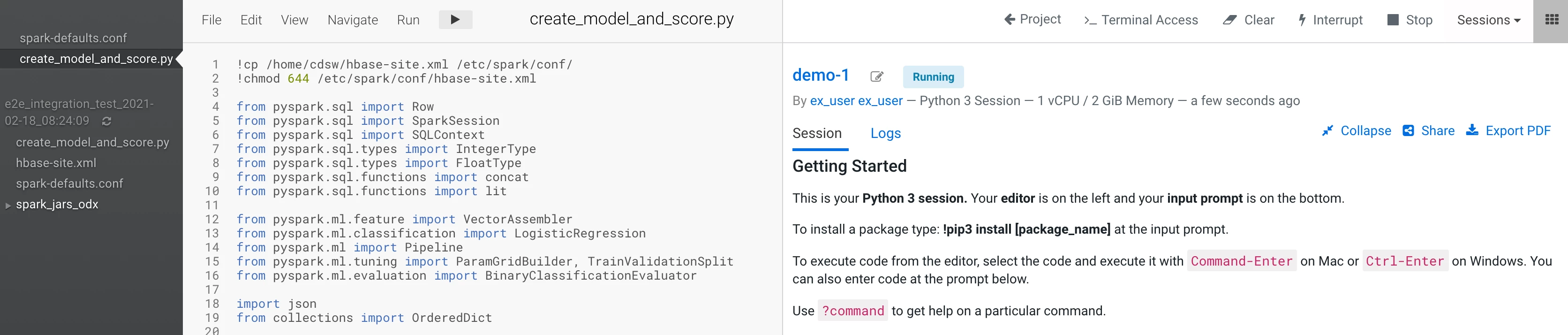

  1. Firstly we added two lines at the start of the script file- these lines are required as of now to move the hbase-site.xml config to Spark's default conf dir in order for connection to COD to work and allow the file to be read by all users. (There is no way to override this as of now, so this workaround is needed).
  2. Also, we modified the target_path for the temp files (that will be generated by the Spark job), since the user we executed this job (use has been given "MLUser" permission on the environment) needs to have access to the location specified.
    !cp /home/cdsw/hbase-site.xml /etc/spark/conf/
    !chmod 644 /etc/spark/conf/hbase-site.xml
    same code section from the git file
    target_path = "<path to the location(in out case, external s3 bucket) where data is residing>"
    Rest all is the same in the file.

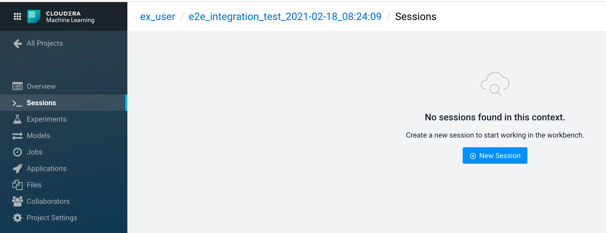

Start running the project

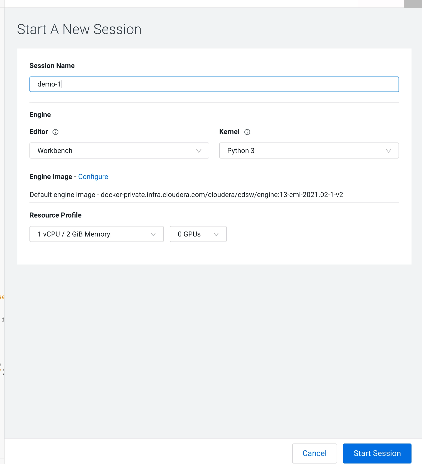

  1. Click New Session
  2. Give the session a name and click the Start Session button at the bottom (adjust Workbench, kernel, and Resource Profile if required for the project)

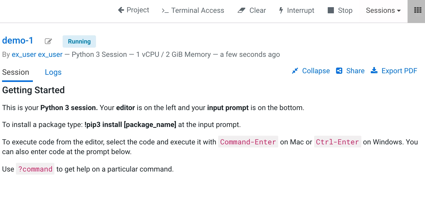

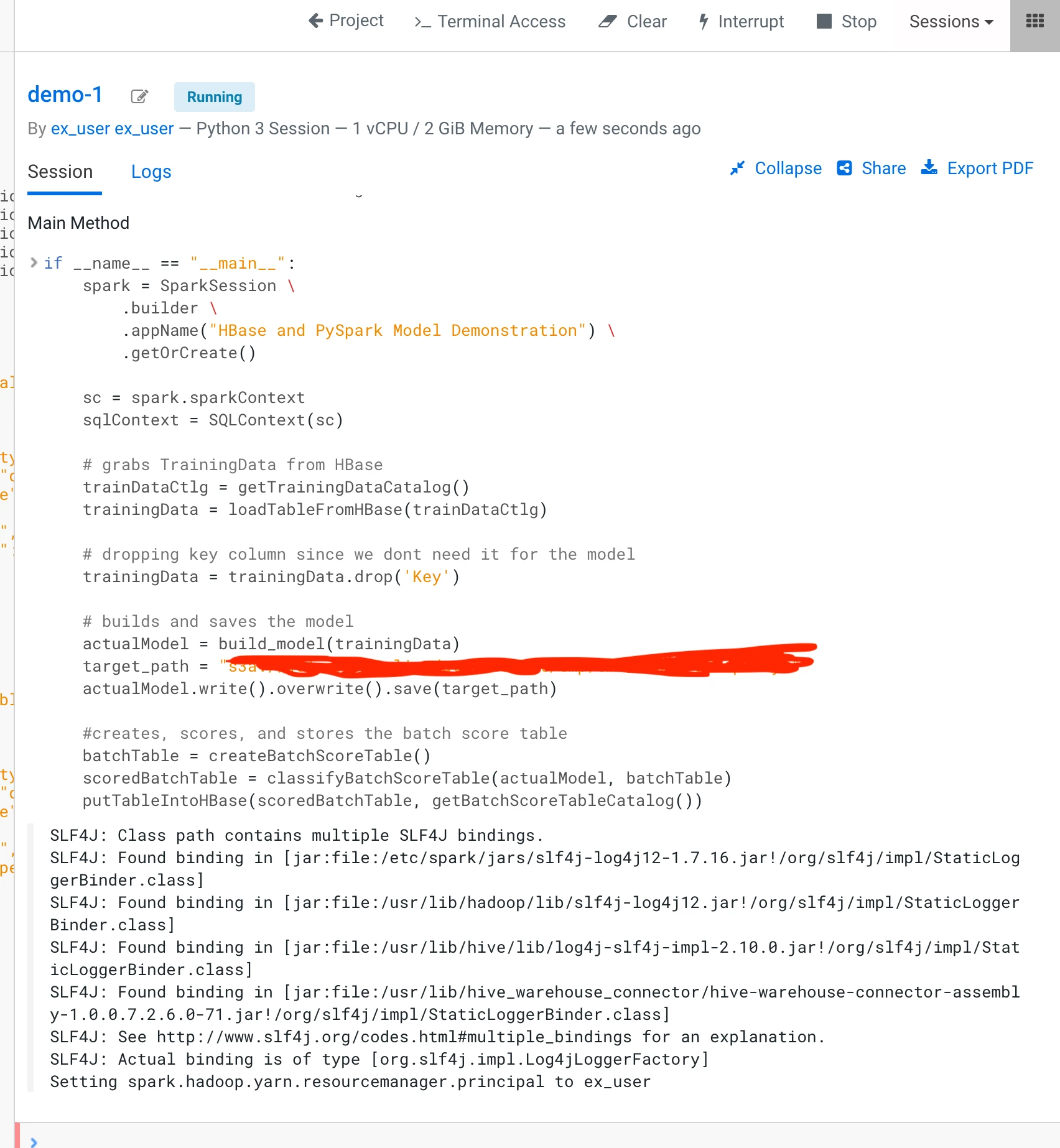

  3. Once the session has started, select the pyspark script file, and click the Run icon at the menu on top of the file contents.Screenshot 2021-02-18 at 3.21.28 PM.png
    Once the execution starts, the session logs and task logs tabs will appear on the right half of the screen.
    The logs will end on completion of the script execution (Success or Failure)

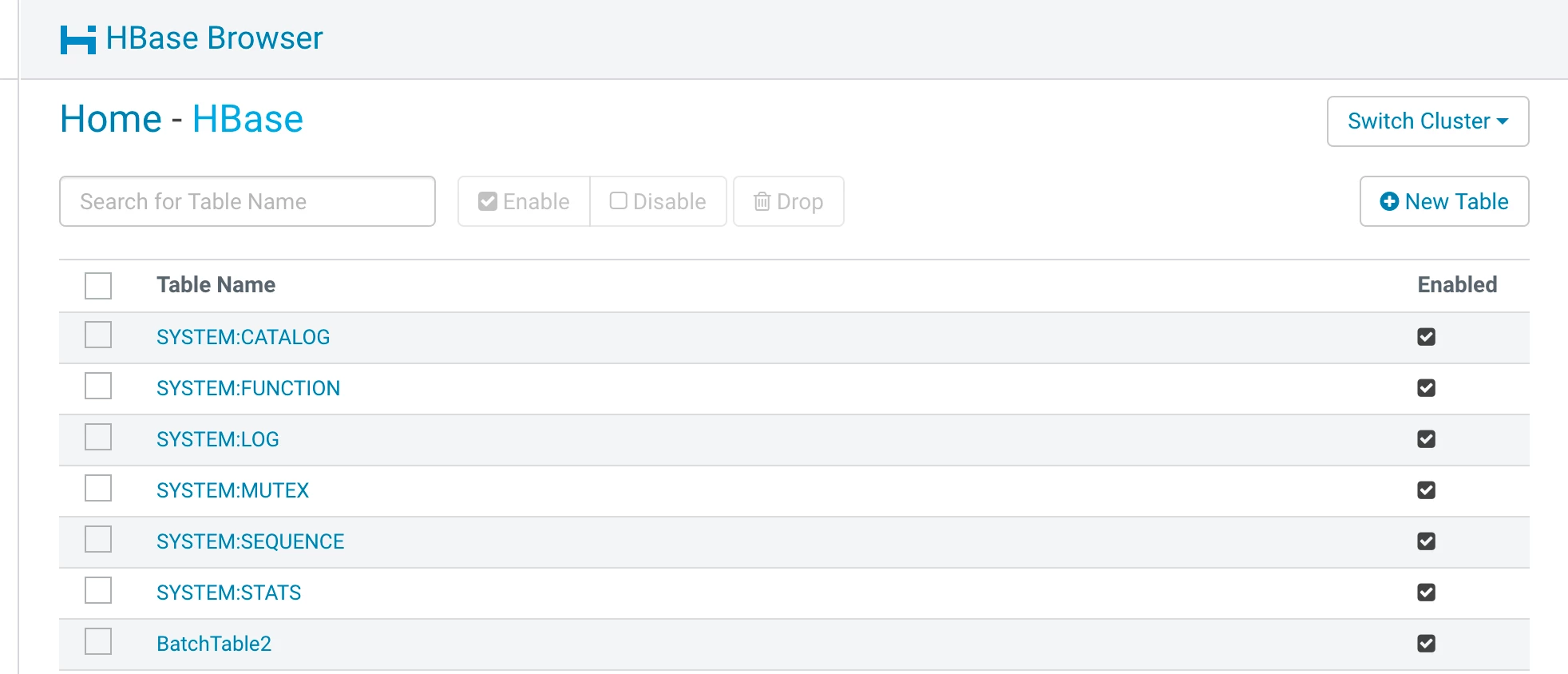

    There we have it, on Success the table (BatchTable2) gets created in COD.
