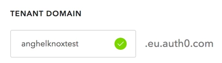

Since this a public SaaS based service, it needs a unique identifier to distinguish between clients (it will form its own unique subdomain):

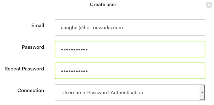

Add the first user
Once the account is created, add a new user in the auth0 internal database. This user will be used to login in Knox. auth0 can integrate with a variety of sources (including AD/LDAP) and Social (Google, Facebook). However, for this test, we define the user in the default auth0 internal Database.
Go to Users section and create your first user:

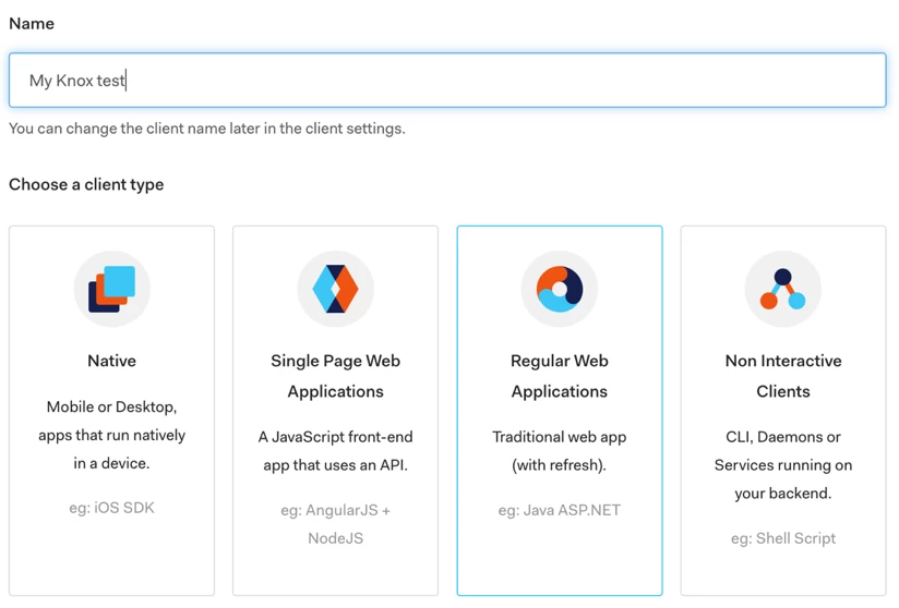

Define the client
Once we have a new user, the next step is to define a new client, in this case Knox, which is a Regular Web Application:

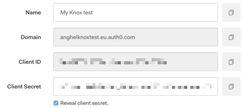

Client id and secret
Once the application is created, go to the Settings tab and note down the information that Knox will use to authenticate itself, as a client application, to auth0 (these will later be used in Knox's configuration):

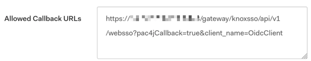

Callback URLs
Then there is one setting that needs defined here - Allowed Callback URLs - which is the Knox URL that auth0 will redirect the user back to after successful authentication. This URL is in the following format:

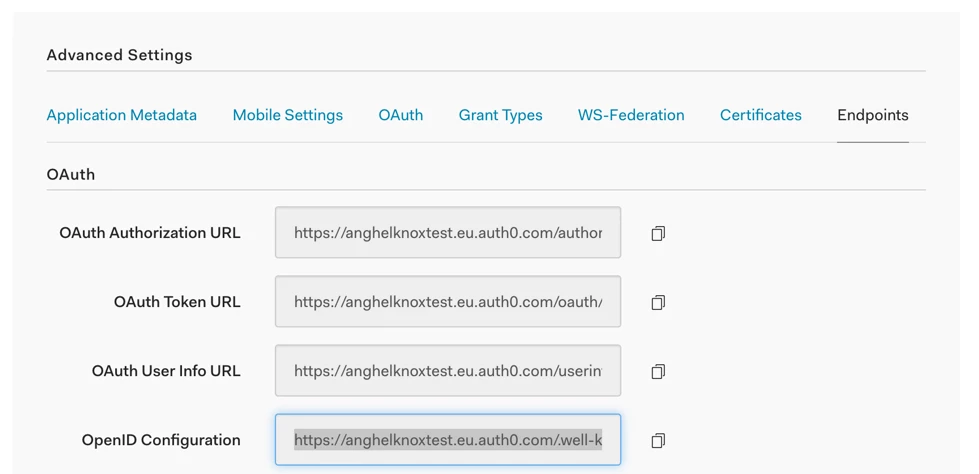

discoveryUri
Lastly, one other piece of configuration required by Knox is discoveryUri, which can be found at the end of the configuration page, in the Show Advanced Settings section -> Endpoints -> OpenID Configuration (typically in the format https://anghelknoxtest.eu.auth0.com/.well-known/openid-configuration

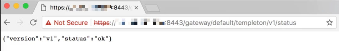

Test
Now restart Knox and test if it works.
To test, go to any Knox page, like :8443/gateway/default/webhdfs/v1/tmp" target="_blank" rel="nofollow noopener noreferrer">https://<KNOX>:8443/gateway/default/webhdfs/v1/tmp

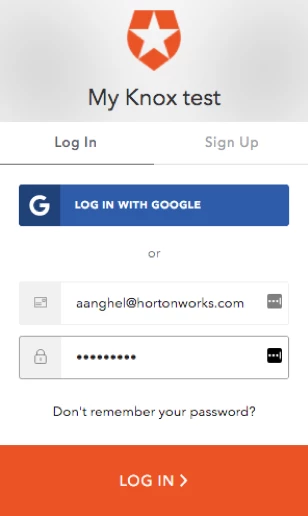

For example, going to https://00.000.000.000:8443/gateway/default/templeton/v1/status should redirect to the auth0 authentication page:
And once you input the user details for the user that was previously created, it should redirect back to the knox page that was originally requested:

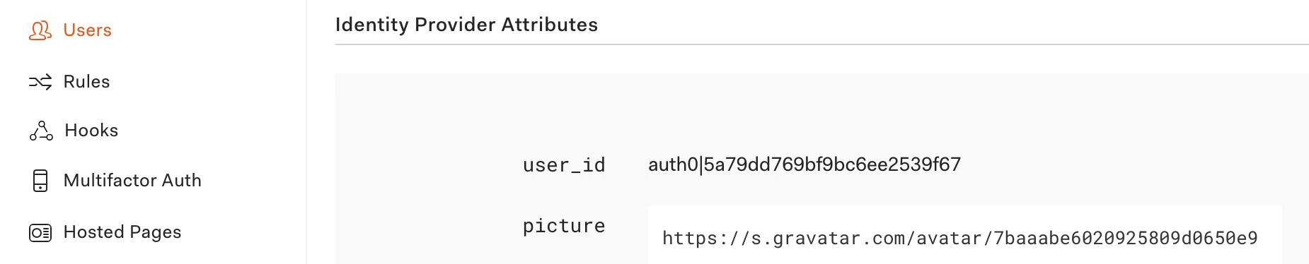

The user id
There is one issue remaining, that of the user identifier that is being retrieved by Knox, which is then used to communicate with Hadoop services and Ranger.
If we look in the gateway-audit.log file, we can see the following entry for the above request:
WEBHCAT|auth0|5a79dd769bf9bc6ee2539f67|||access|uri|/gateway/default/templeton/v1/status|success|Response status: 200From the log, we can see that the user Knox actually "sees" is auth0|5a79dd769bf9bc6ee2539f67 which is the user id from auth0:
