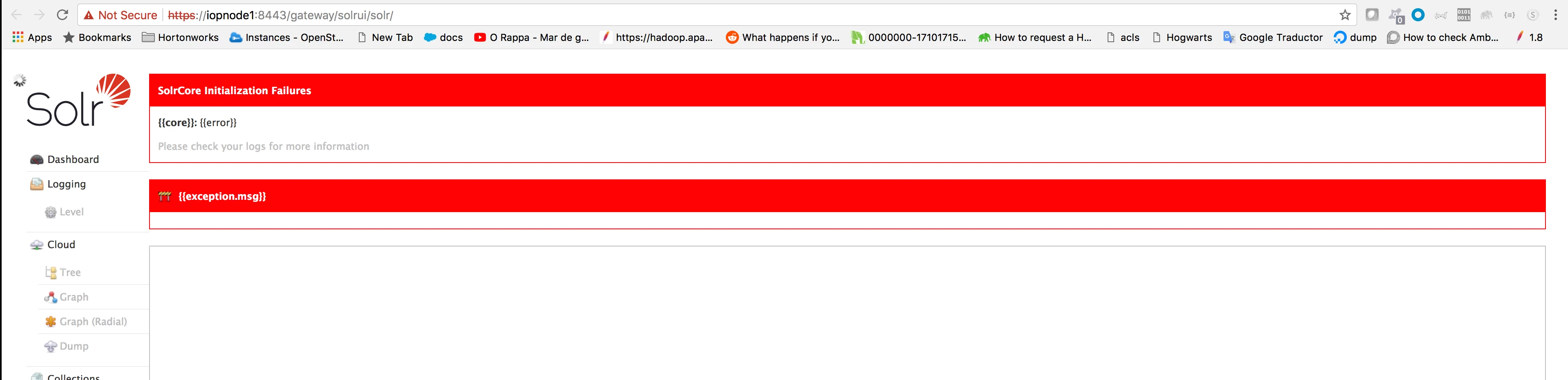

Problems like that are usually related with kerberos issues.
Pre-reqs: You should have already configured your knox with the desired authentication mode:
OBS: In order to use this flag "Dsun.security.krb5.rcache", the jdk 1.8 or above must be used.
Root cause:
a) You may have not configured your browser for authentication ( SPNEGO ),
b) You haven't included your users into the SolR Plugin on Ranger.
c) You are hitting a known issue related with this parameter "Dsun.security.krb5.rcache=none", which is better described in this forum
https://community.hortonworks.com/content/supportkb/150162/error-gssexception-failure-unspecified-at-gss-api.html

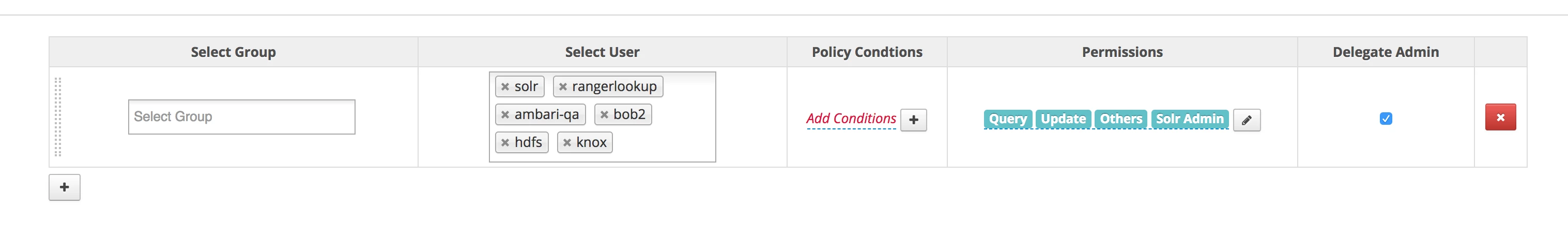

3) Go to the "Quick Links > Ranger > Ranger Admin UI > Solr" and add the user "knox"

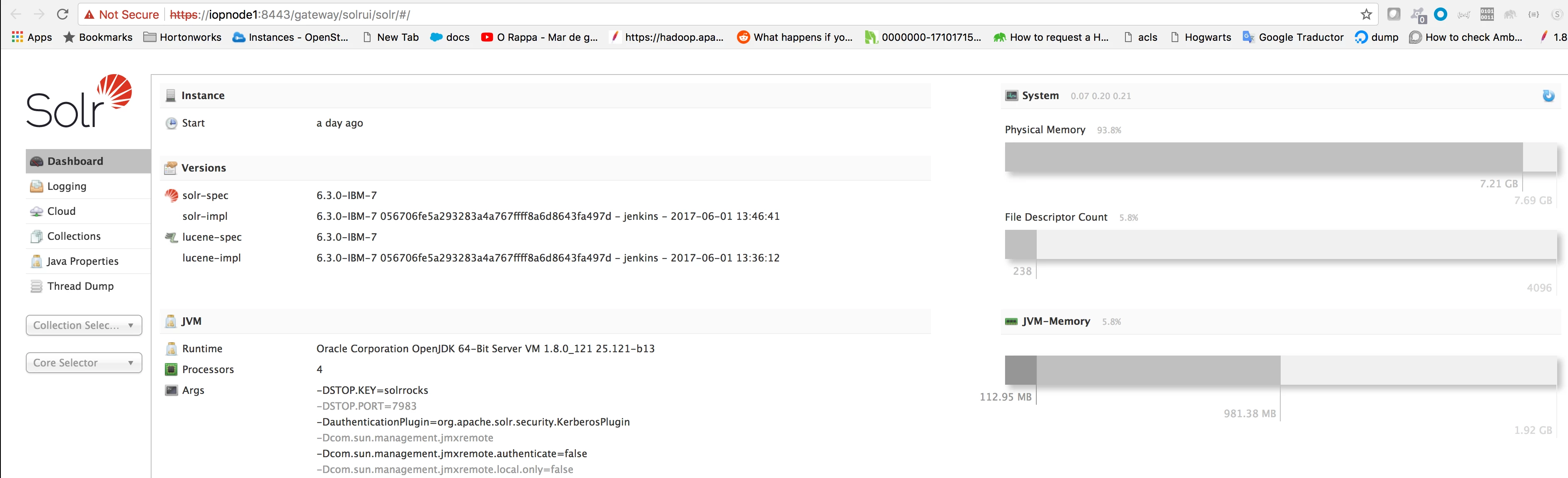

After these steps, your SolR UI should work fine through Knox.
