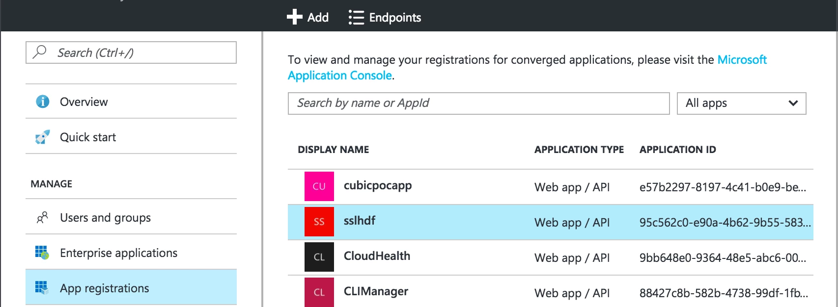

In order to authenticate to ADLS, we'll use OAuth2. This requires the TenantID associated with your Azure account. This simplest way to obtain this is via the Azure CLI, using the azure account show command.

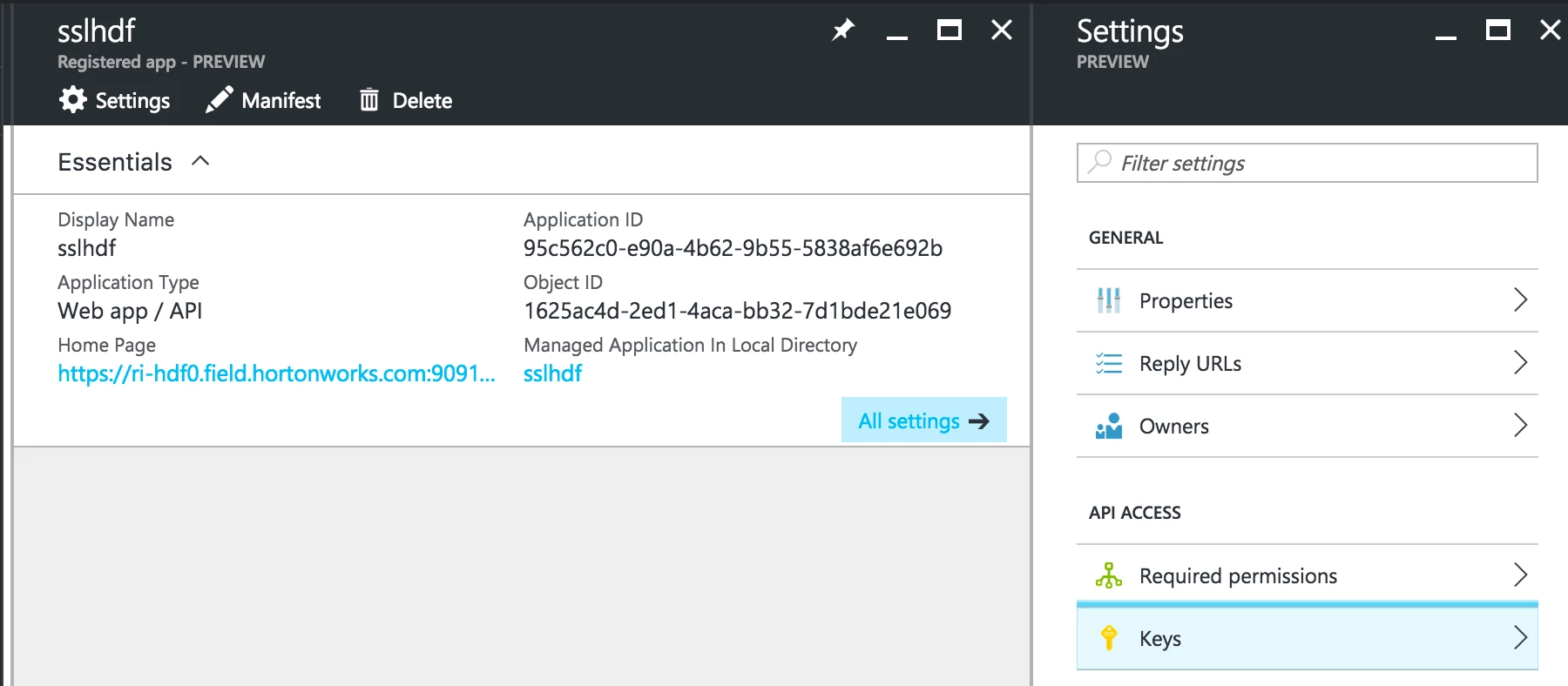

You will also need to create an Azure AD service principal as well as an associated key. Navigate to Azure AD > App Registrations > Add
Take note of the Application ID (aka the Client ID) and then generate a key via the Keys blade (please note the Client Secret value will be Hidden after leaving this blade so be sure to copy somewhere safe and store securely).

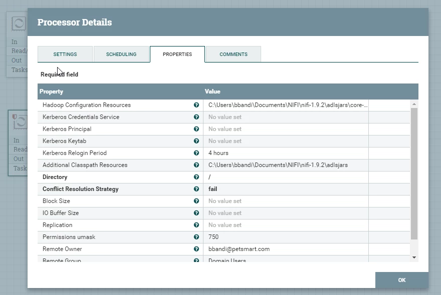

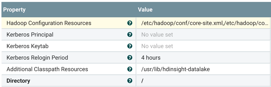

We're now ready to configure the PutHdfs processor in NiFi.
For Hadoop configuration resources, point to your modified core-site.xml including the properties above and an hdfs-site.xml (no ADLS-specific changes are required).
Additional Classpath Resources should point to the /usr/lib/hdinsight-datalake to which we copied the dependencies on all NiFi nodes.
The input to this PutHdfs processor can be any FlowFile, it may be simplest to use the GenerateFlowFile processor to create the input with some Custom Text such as
The time is ${now()}

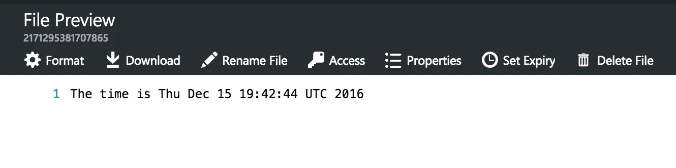

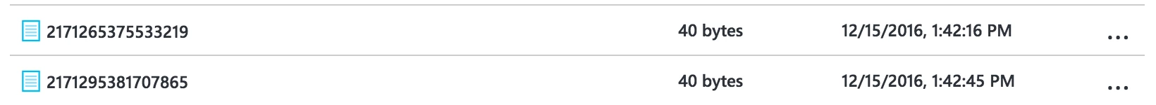

When you run the data flow, you should see the FlowFiles appear in the ADLS directory specified in the processor, which you can verify using the Data Explorer in the Azure Portal, or via some other means.

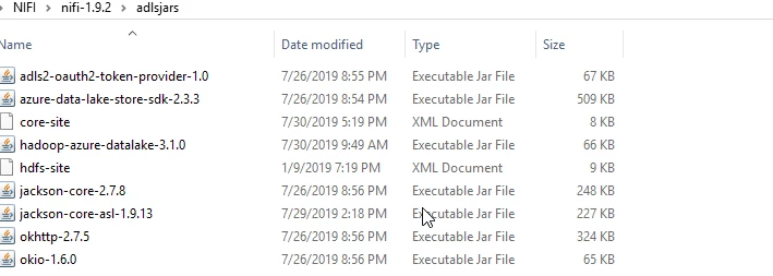

Hi All,
I try to ingest data from a cluster Nifi 1.5 (hosted in 3 Vms -not on Hadoop) to Azure Data Lake Store.
I followed this wonderful tutorial but i still have problem.
I get these jar files (not exactly the same versions than in this tutorial):
  • adls2-oauth2-token-provider-1.0.jar
  • azure-data-lake-store-sdk-2.1.4.jar
  • hadoop-azure-datalake-2.7.3.2.6.2.25-1.jar
  • jackson-core-2.2.3.jar okhttp-2.4.0.jar
  • okio-1.4.0.jar
I do not have hdfs-site.xml (because Nifi is not part of the Hadoop) ; so I referenced my Azure Datalake Store in core-site.xml like this:
<property> <name>fs.defaultFS</name> <value>adl://xxxx.azuredatalakestore.net</value> </property>
I'm right ?
When I start the PutHDFS, I have this error in log file : java.lang.NoClassDefFoundError: Could not initialize class org.apache.hadoop.fs.adl.AdlFileSystem (with jar tf, I saw that this method is referenced in hadoop-azure-datalake-2.7.3.2.6.2.25-1.jar). In the property tab of the PutHDFS, the "Additional Classpath Resources" is filled with /usr/lib/hdinsight-datalake (where I copy the jar files).
What is wrong with this configuration ?
