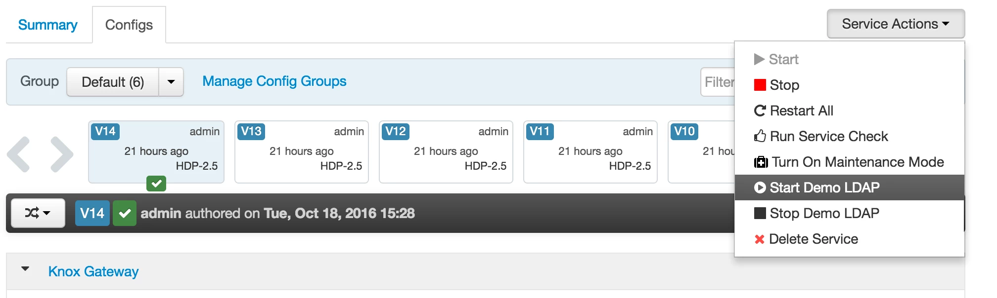

I will assume that Knox has already been installed. If you don't have a LDAP server in your environment for testing, Ambari includes a Demo LDAP service that can be started from the Knox service.

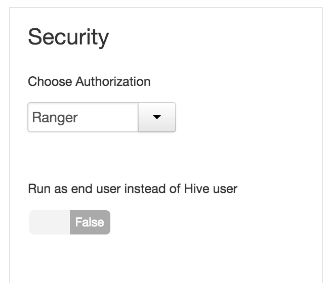

Further, we assume Ranger is being used for Hive authentication (so Hive impersonation is disabled, i.e., hive.server2.enable.doAs is false).
In order to configure Hive for Knox, we'll need to change the transport mode (hive.server2.transport.mode) to 'http' (it is set to 'binary' by default) and then restart Hive.

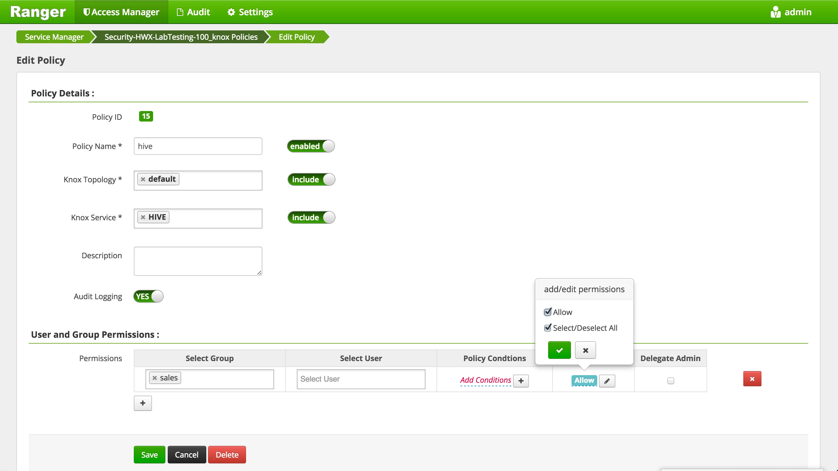

Assuming Ranger is being used to authorize access to Knox, we'll need to create an appropriate policy in Ranger for the users and groups which require access.

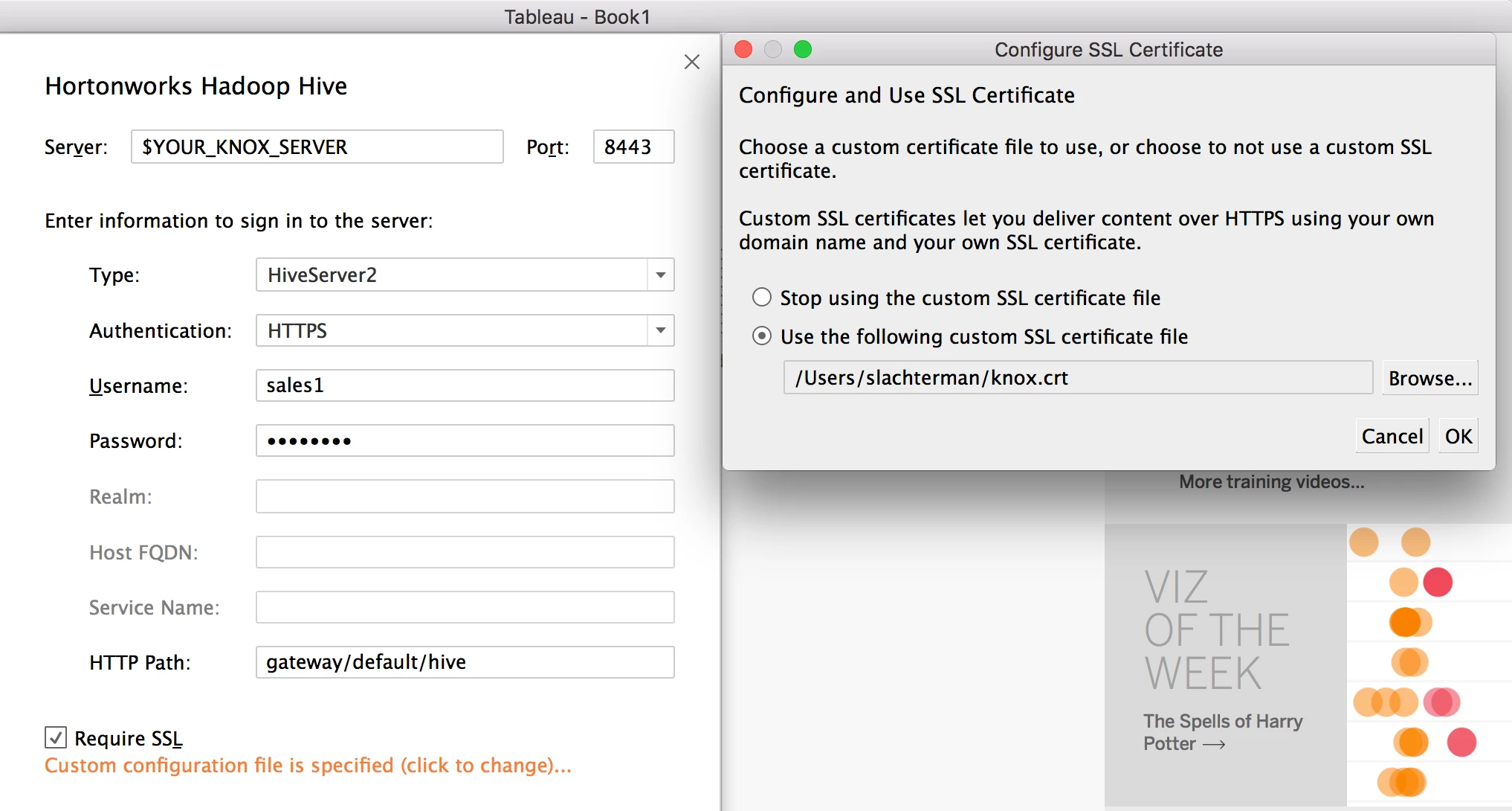

We will use the Hortonworks Hadoop Hive native connector. We will specify our Knox Server hostname in the Server field, the port over which we are connecting to Knox using TLS, an Authentication method of HTTPS, and the username and password of the LDAP user that has access (via the Ranger policies for Knox and for Hive that have been configured).
Please see the Advanced users-ldif within Knox configuration for identifying appropriate users in the Demo LDAP (such as guest, sam, and tom).
We need to specify the HTTP path of gateway/default/hive, select the Require SSL checkbox, and click the "No custom configuration . . ." orange link to specify the path at which we've saved the Knox certificate (or at which our Desktop Administrator has provided a root certificate that was used to sign Knox's certificate), as seen in the screenshot below.
