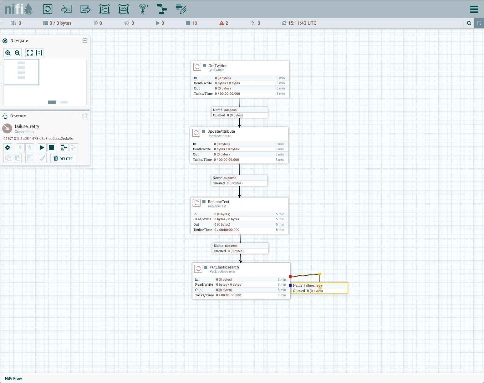

We are picking up from where the last tutorial left off. We currently have a single dataflow. Our GetTwitter processor combines multiple filters. We would like to clearly define two GetTwitter processors, each with their own filter.
This is what our current data flow looks like:

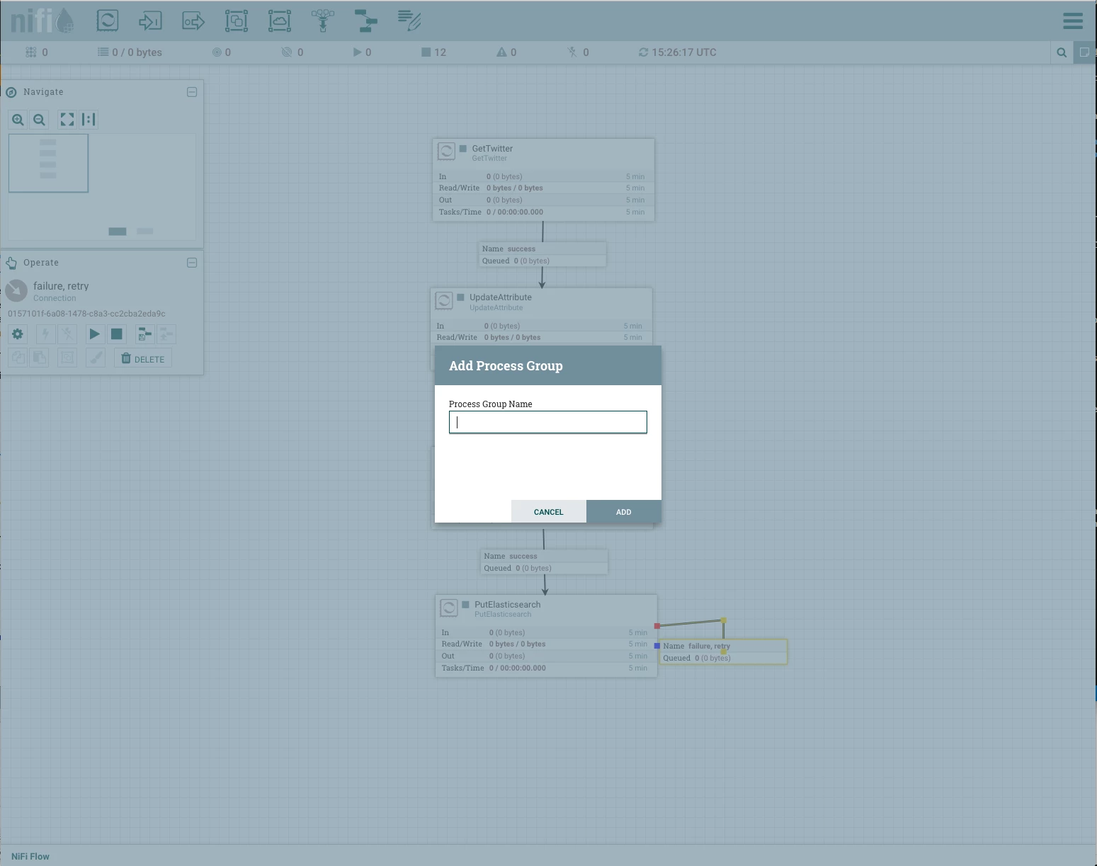

The first thing we are going to do is to add a Process Group to our NiFi canvas. To do this, drag the Process Group icon from the menu bar to the canvas area. Here is a screenshot showing the Process Group icon:
Once you drag the process group icon to the canvas, the Add Process Group dialog will be displayed. It should look similar to this:
Give the process a group a meaningful name. In our case, we will call it Twitter Feed. Click the ADD button. The process group will be added to the canvas. You should see something similar to this:
You should drag the process group so that it is easier to see. You should see something similar to this:

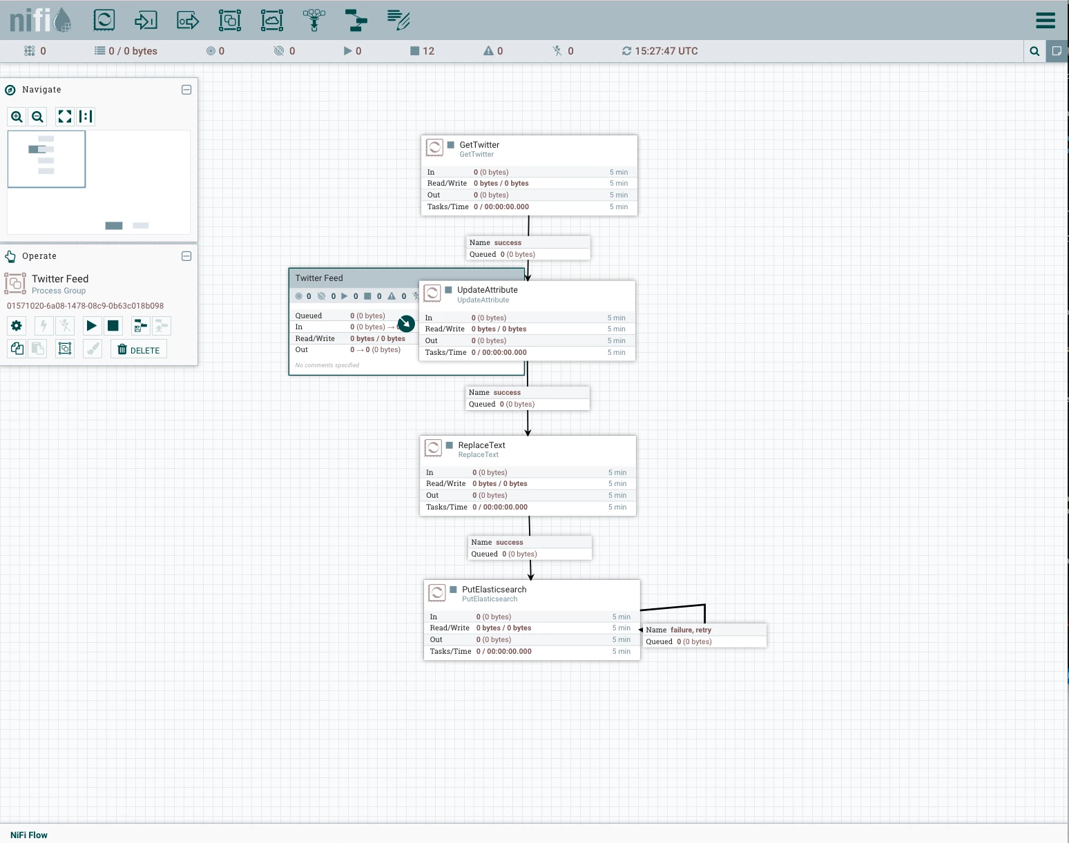

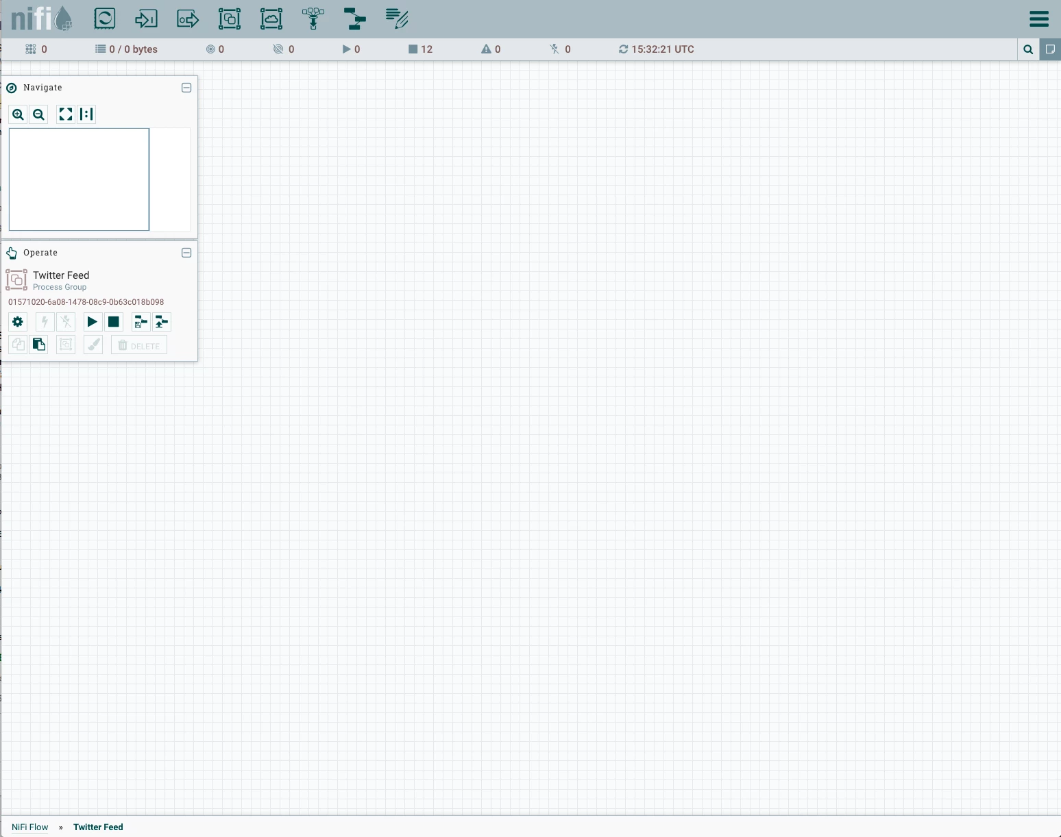

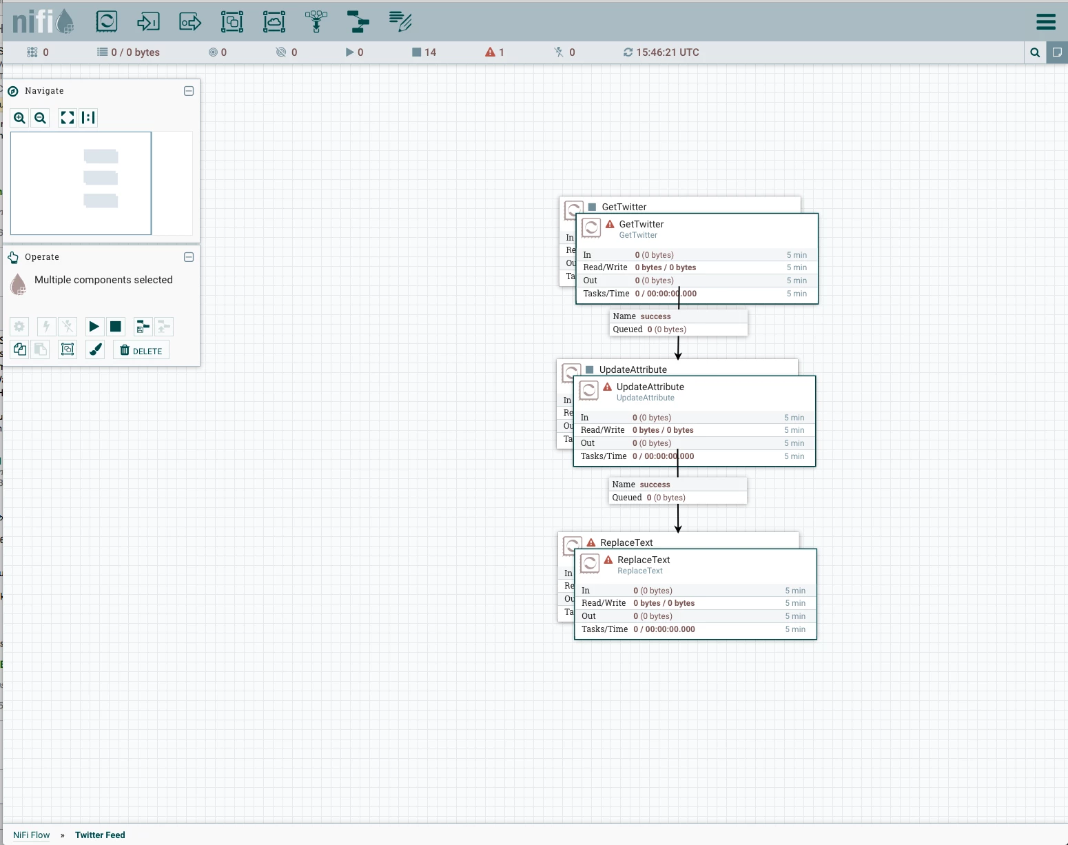

Copy data flow to process group

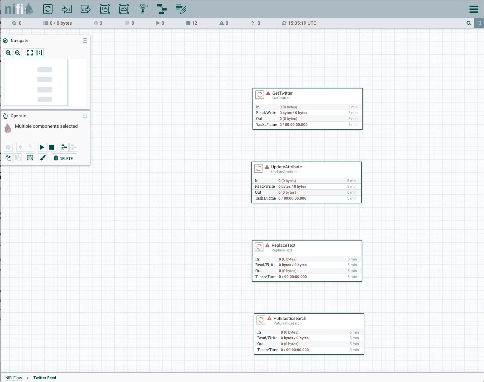

Now we want to copy our existing flow to the process group we just created. Select all 4 of the processors in our current flow. Press the COMMAND-C (or CTRL-C on Windows) to copy the selected components. Now double click on the Twitter Feed process group. This will open the process group. You should see something similar to this:
Notice the canvas is now blank? You should also notice the bread crumb navigation in the lower left of the screen. NiFi Flow >> Twitter Feed is your indication that you are inside the process group.

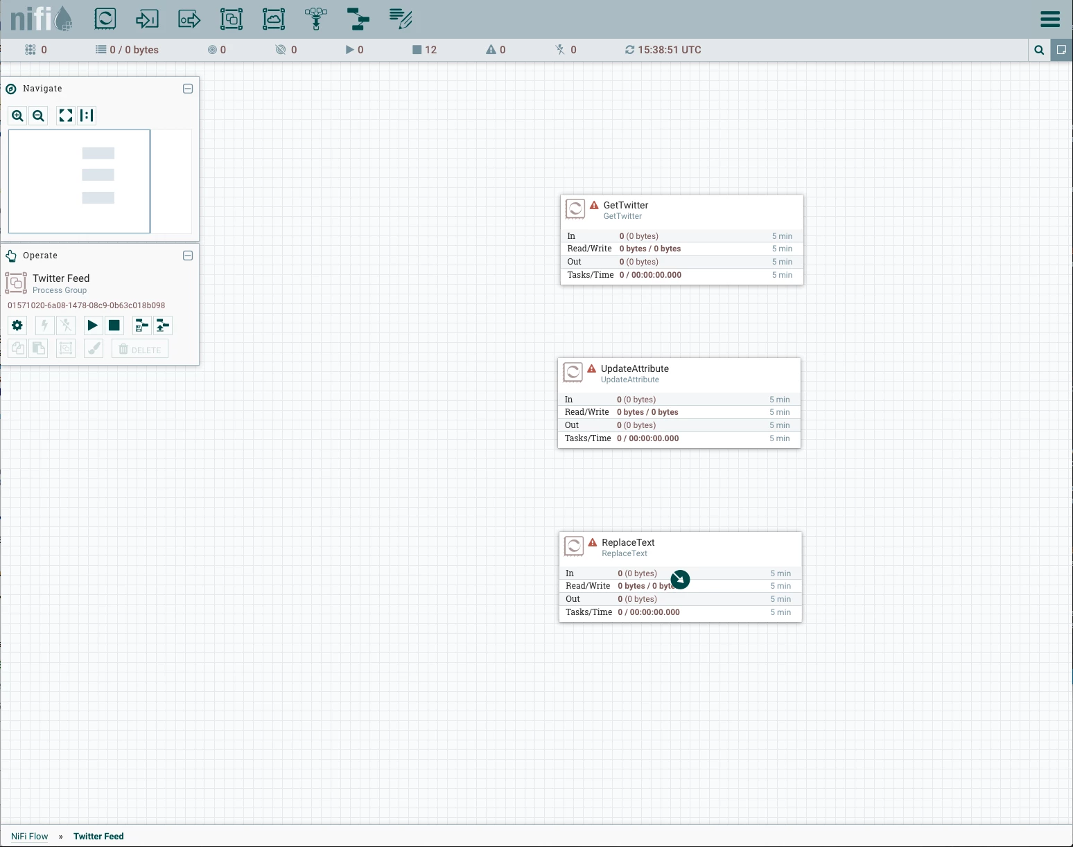

Now we can paste our copied flow files on the canvas. You should be able to press the COMMAND-V (CTRL-V on Windows) to copy our flow to the process group. You should see something similar to this:
You should see the 4 processors copied to the canvas. You should also notice the connections are missing. We need to reestablish the connections. Before doing that, we are going to delete the PutElasticsearch processor. It already exists outside of the process group and we don't need a copy inside.
Delete PutElasticsearch processor
Inside of your processor group (missing connections and bread crumb in lower left will confirm this), select the PutElasticsearch processor by clicking on it. Now you can delete it by pressing the delete key. You should see something similar to this:

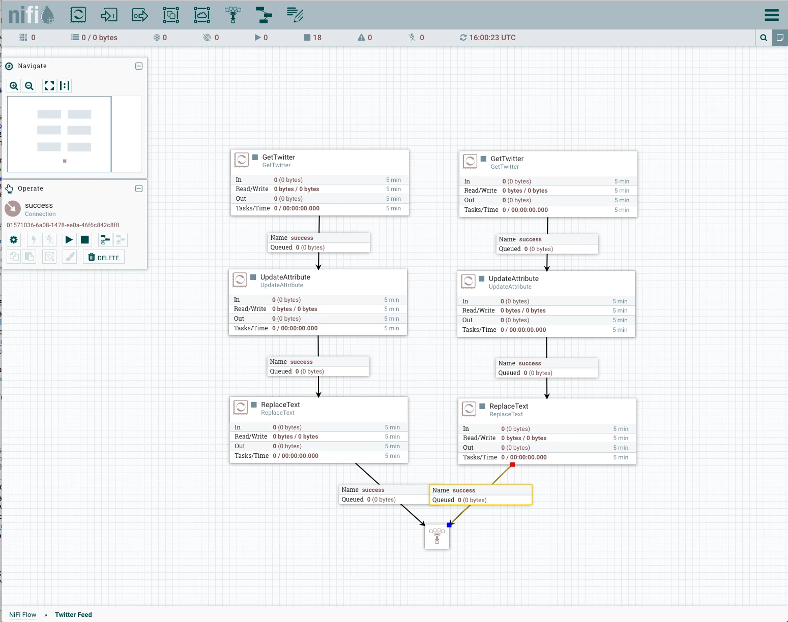

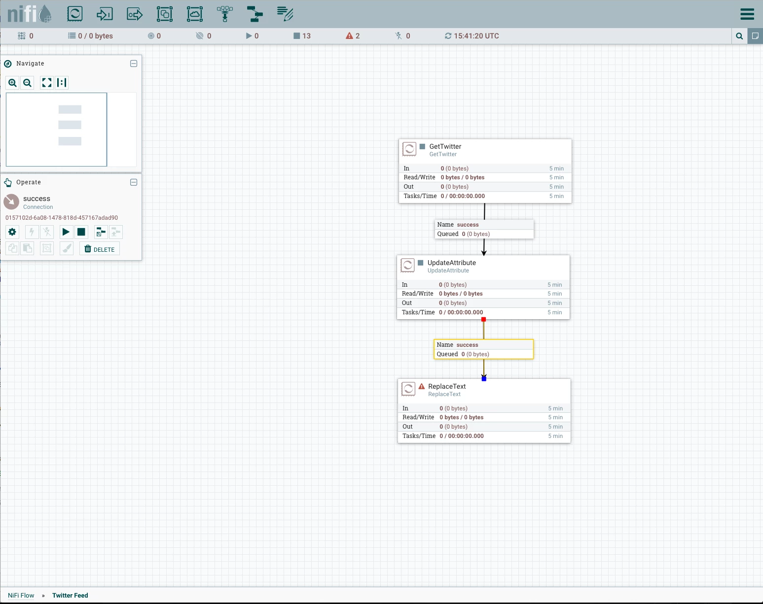

Create connections between processors
Now we are going to create connections between the 3 processors. Drag the circle arrow icon from the GetTwitter processor to the UpdateAttribute processor. You don't need to change anything; click the ADD button. Drag the circle arrow icon from the UpdateAttribute processor to the ReplaceText processor. You don't need to change anything; click the ADD button. You should see something similar to this:
You should notice a red triangle in the upper left of the ReplaceText processor. That is because we haven't connected it to anything yet. We'll get to that shortly.

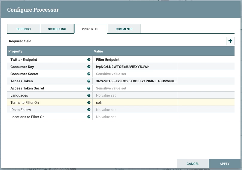

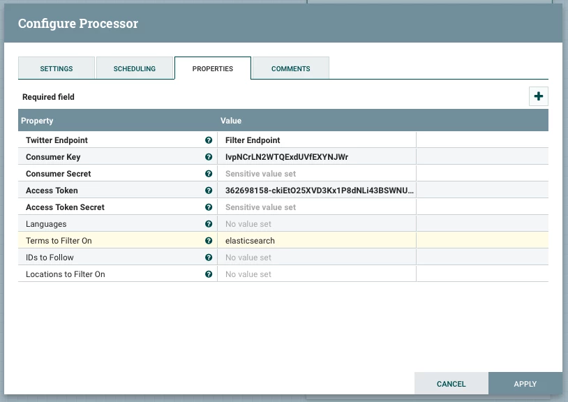

Edit GetTwitter processor
This first dataflow will be for our elasticsearch related tweets. We need to edit the GetTwitter processor to filter only on elasticsearch. Right click on the processor and select configure. Click the PROPERTIES tab. Click on the Terms to Filter On value field to edit the value. Enter elasticearch as the only term. Click the OK button to save the change. You should see something similar to this:
Click the APPLY button to save the change.

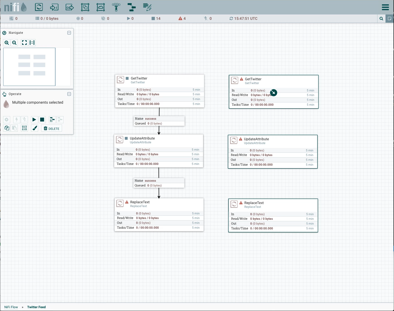

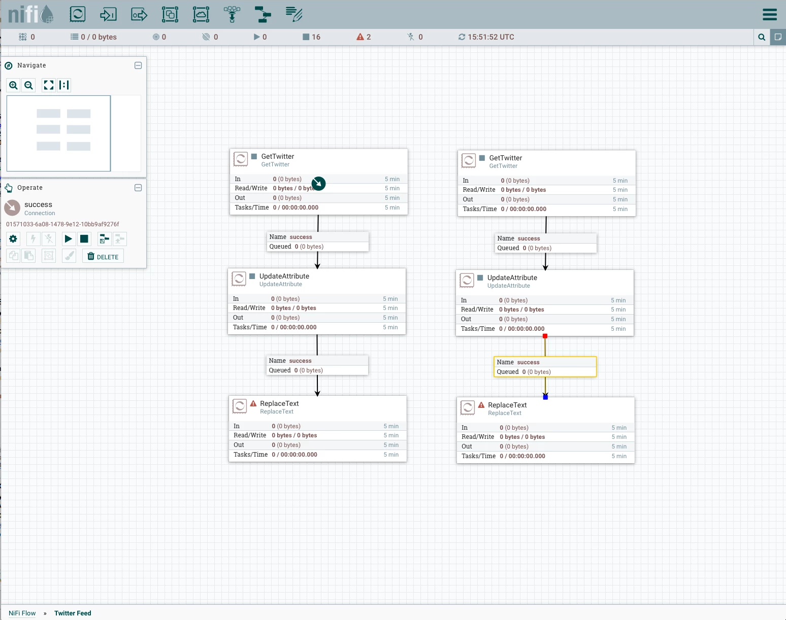

Copy data flow

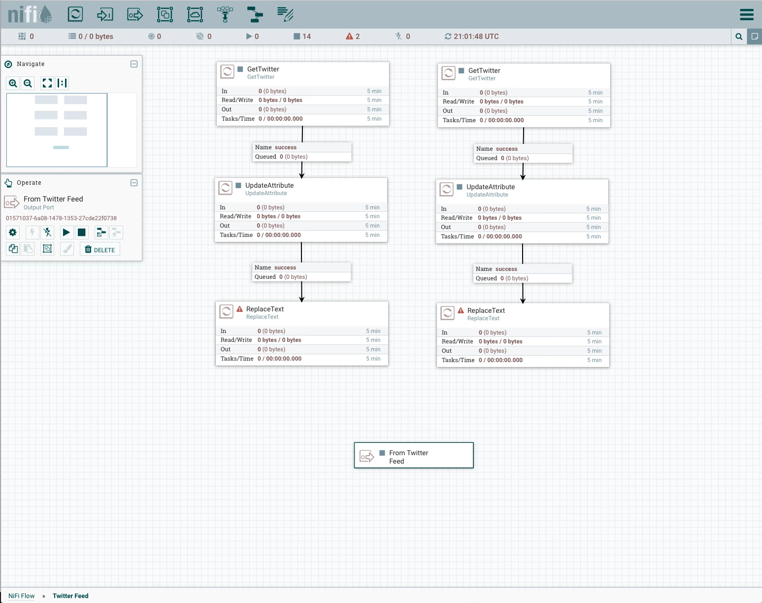

We need a similar data flow within this process group. The second data flow should be filtering on the term solr. To do that, select all 3 processors and press the COMMAND-C keys. Now press the COMMND-V keys to paste a copy of the processors. You should see something similar to this:
The processors you copied should still be selected. Let's move them so it's easier to see the two flows. Drag the selected processors to the right. You should see something similar to this:
We need to edit the GetTwitter processor for the second data flow. Follow the same procedure we did the first time, only this time use the term solr. You should have something that looks like this:
As we did before, create the connections between the processors in the second flow. Drag the circle arrow icon from the GetTwitter processor to the UpdateAttribute processor. You don't need to change anything; click the ADD button. Drag the circle arrow icon from the UpdateAttribute processor to the ReplaceText processor. You don't need to change anything; click the ADD button. You should see something similar to this:

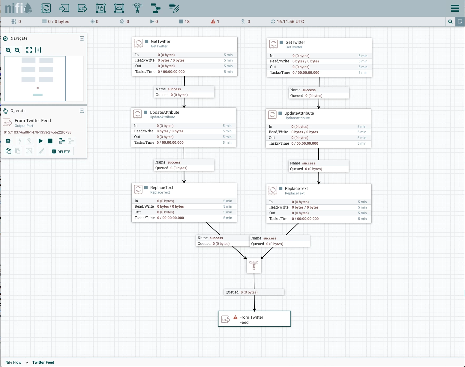

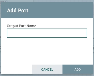

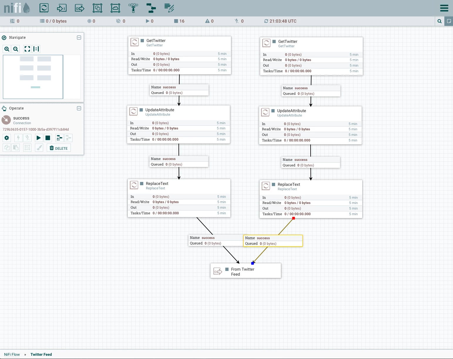

Create Output Port
We need the data flow from this process group to be sent outside of the group to enable connections to our Elasticsearch processor. To enable this, we are going to add an Output Port. Drag the Output Port icon from the menu bar to the canvas area. Here is a screenshot showing the Output Port icon:
An Add Port dialog should be displayed. You should see something similar to this:
This is a user-friendly name for the port that will be created. We'll call our port From Twitter Feed. Click the ADD button to add the port. You should see something similar to this:
You should notice a red triangle in the upper left of our From Twitter Feed Output Port. This because there is no connection defined yet.

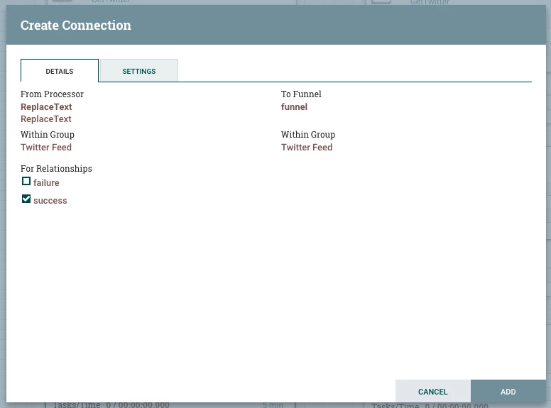

Create connections to Output Port
Now we need to create a connection from each of the ReplaceText processors to the Output Port. To do this, drag the circle arrow icon from the ReplaceText processor the Output Port. A Create Connection dialog will be displayed. Select the success relationship. Click the ADD button to create the connection. Do this for both ReplaceText processors. Now you should see something similar to this:

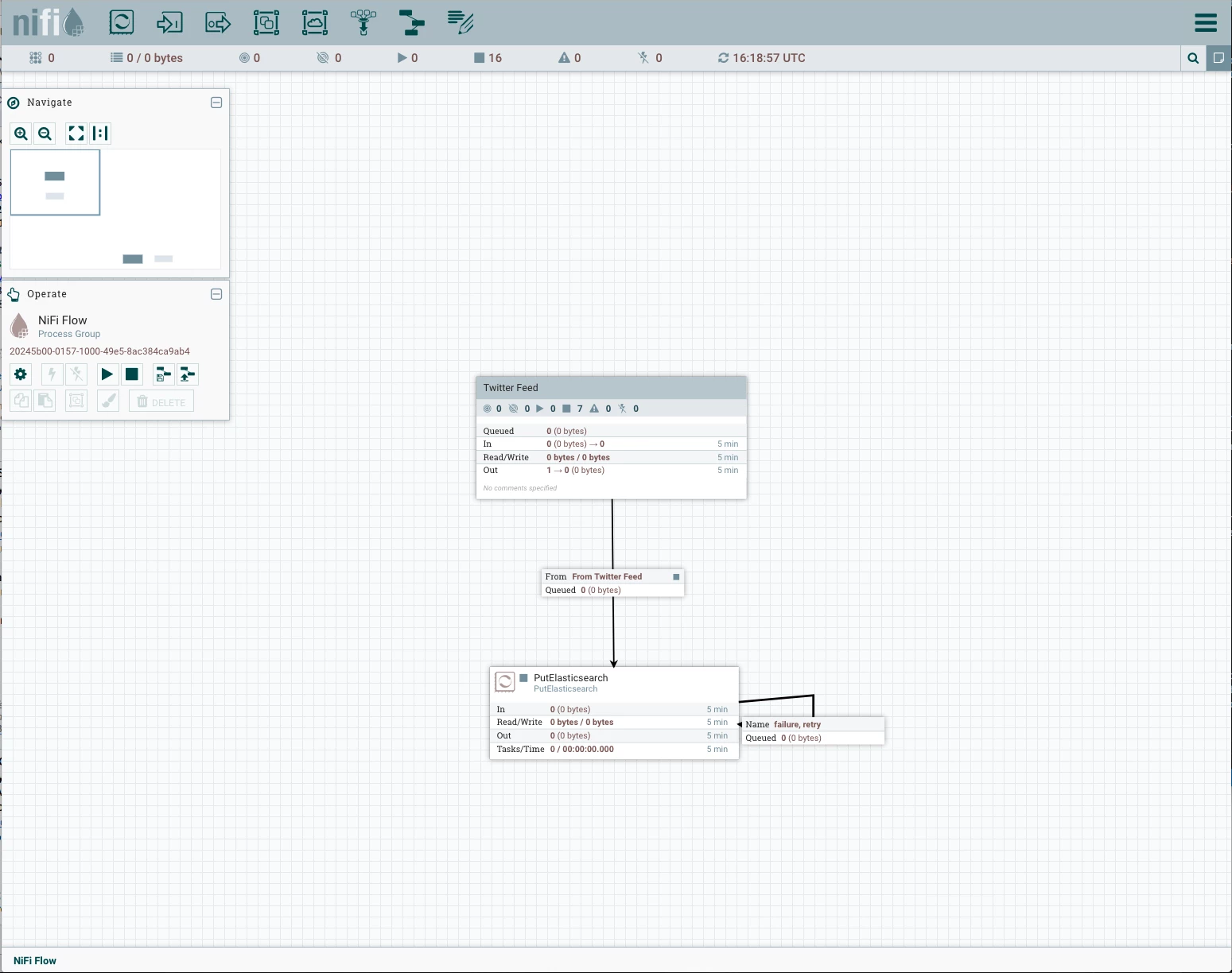

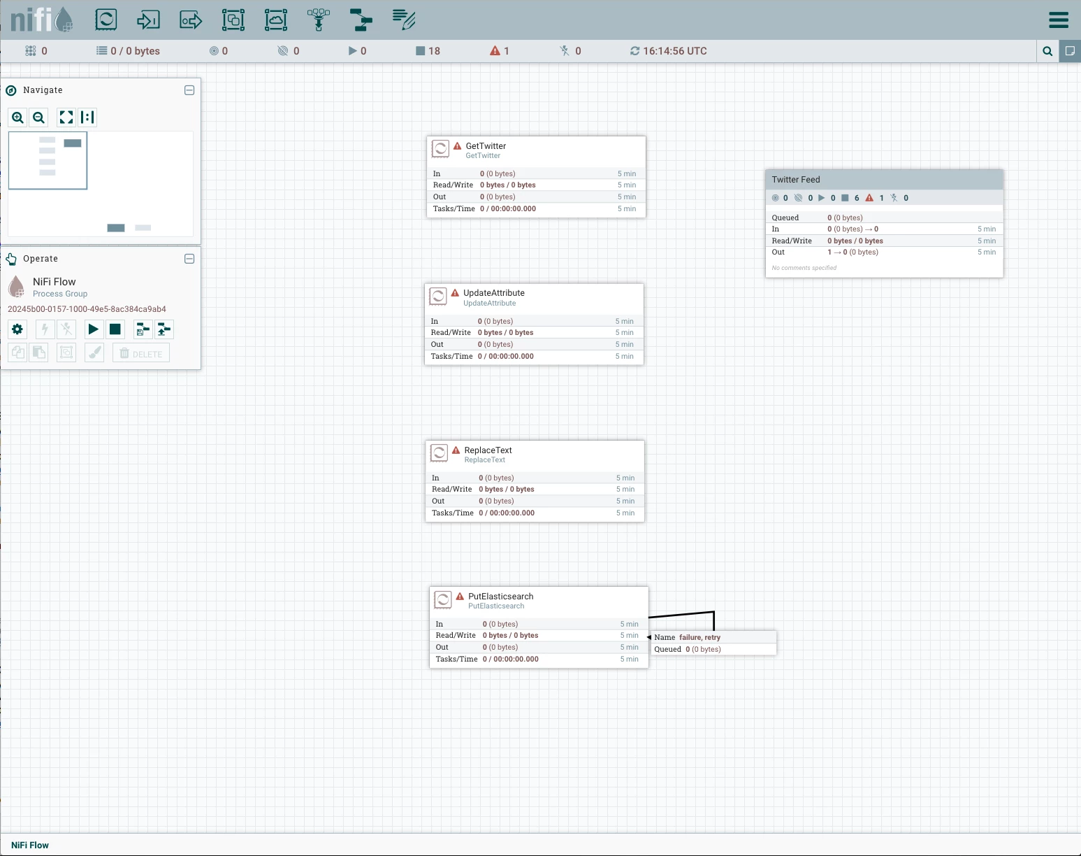

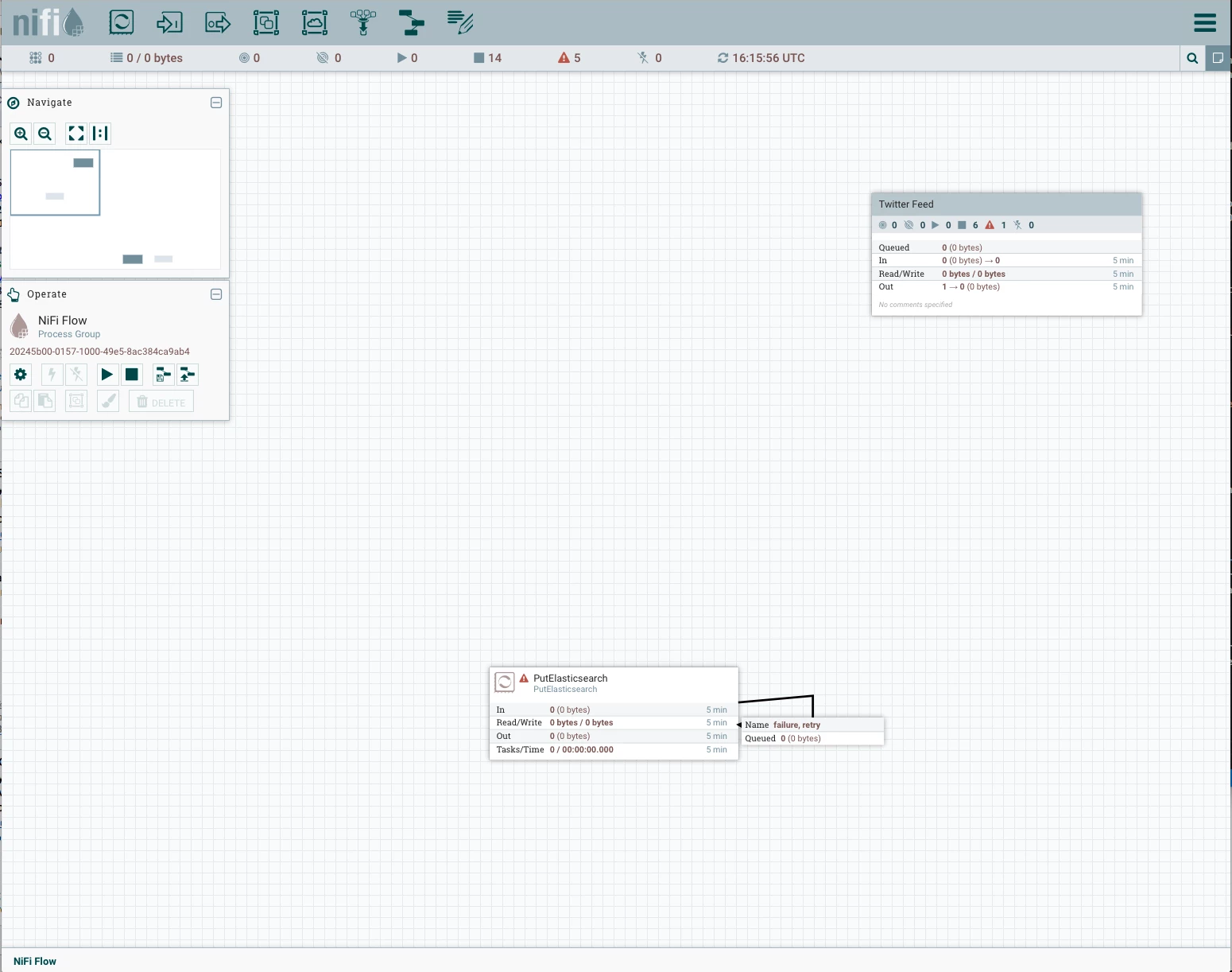

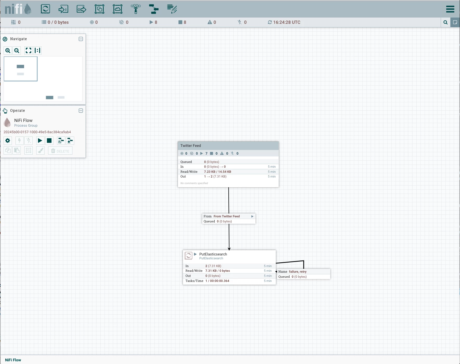

Create connection between Process Group and PutElasticsearch processor
Now we are ready to create the connection between our Process Group and our PutElasticsearch processor. Using the bread crumb navigation in the lower left, click on the NiFi Flow link to go up a level.
We no longer need the GetTwitter, UpdateAttribute and ReplaceText processors on the main canvas. Select each of the connections between the processors and delete the connections with the delete key. You should see something similar to this:
Now delete the GetTwitter, UpdateAttribute and ReplaceText processors from the main canvas. We want to keep the PutElasticsearch processor. You should see something similar to this:
Create a connection between the process group and the PutElasticsearch processor by dragging the circle arrow icon from the process group to the PutElasticsearch processor. A Create Connection dialog will be displayed. You don't need to change any options, so click the ADD button to create the connection. You should have something that looks similar to this:
If you look inside your process group now, you should notice the red triangle is gone for the Output Port. That is because a connection exists now.

Look for the twitterFilterAttribute field. You should see it has the value solr.
