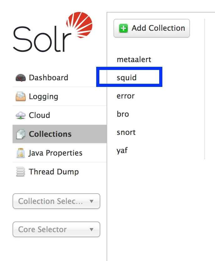

2. Run the following commands on the Metron host to create a Solr collection for Squid
export SOLR_HOME=/opt/lucidworks-hdpsearch/solr/
export SOLR_USER=solr
su $SOLR_USER -c "$SOLR_HOME/bin/solr create -c squid -d $METRON_HOME/config/schema/squid/"

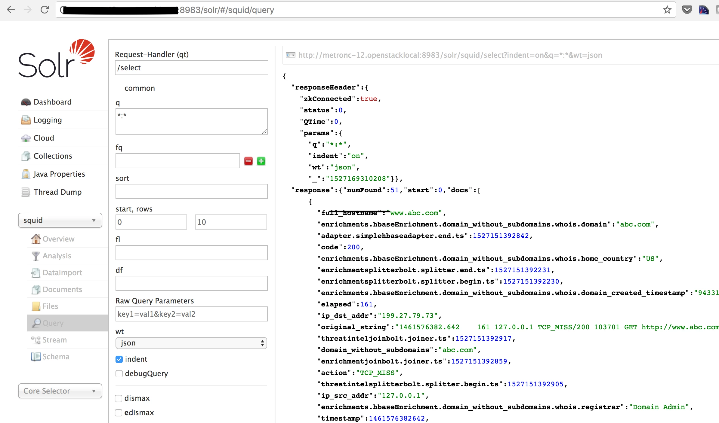

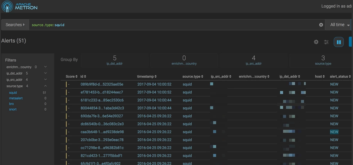

4. Ingest events into the 'squid' kafka topic and you should see documents being written into the Squid collection in Solr.
5. Fire up Alerts UI and verify that Squid events are seen.
