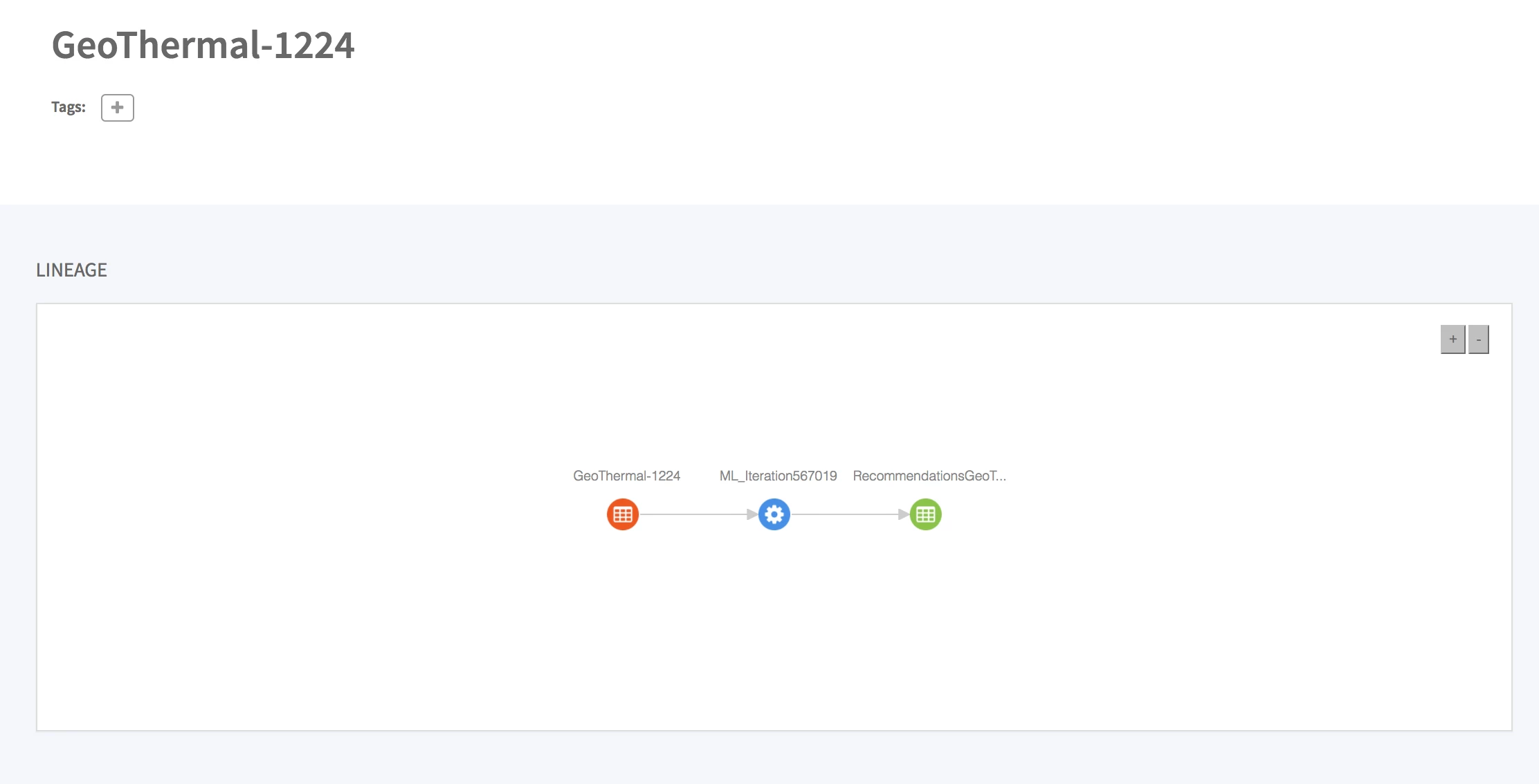

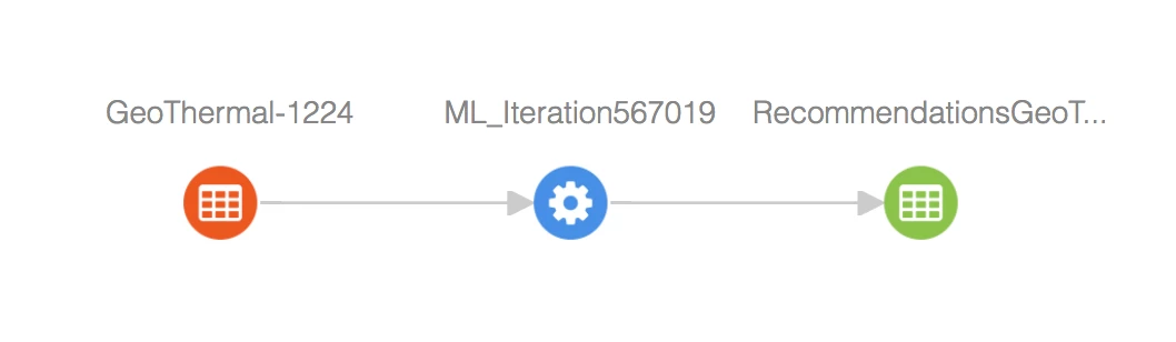

The eventual lineage we want to capture would look something like this:-

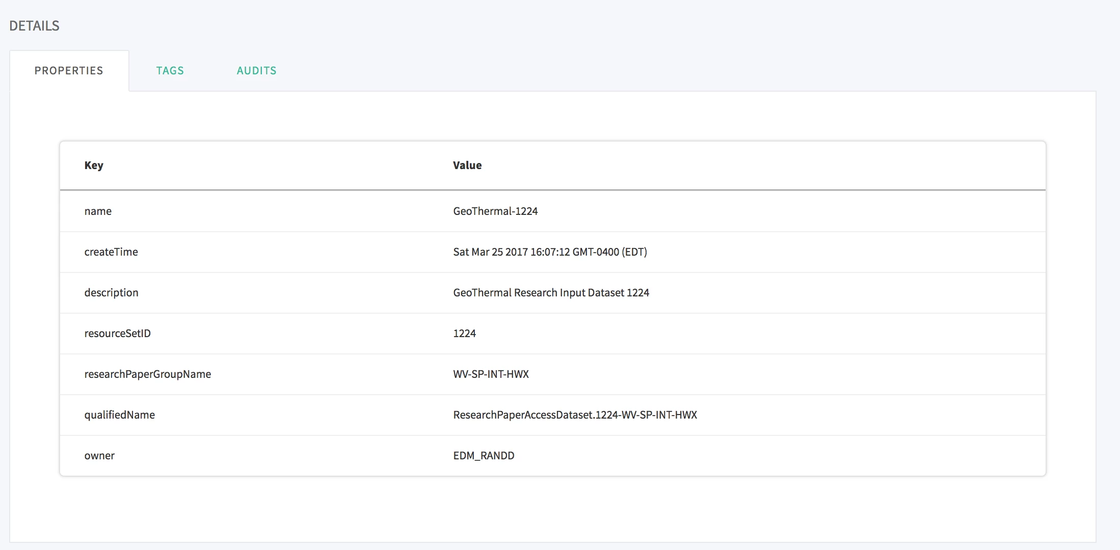

2. Create Entity for ResearchPaperAccessDataset Type:-
[root@zulu atlas]# curl -i -X POST -H 'Content-Type: application/json' -H 'Accept: application/json' -u admin 'http://yellow.hdp.com:21000/api/atlas/entities' -d @atlas_entity_ResearchPaperDataSet.json
{"requestId":"qtp84739718-15 - 827d5151-a6fb-4ccb-909f-f4ac5f8d8f26","entities":{"created":["40dc03dc-16d6-4281-826d-c4884cd1dad5"]},"definition":{"jsonClass":"org.apache.atlas.typesystem.json.InstanceSerialization$_Reference","id":{"jsonClass":"org.apache.atlas.typesystem.json.InstanceSerialization$_Id","id":"40dc03dc-16d6-4281-826d-c4884cd1dad5","version":0,"typeName":"ResearchPaperAccessDataset","state":"ACTIVE"},"typeName":"ResearchPaperAccessDataset","values":{"name":"GeoThermal-1224","createTime":"2017-03-25T20:07:12.000Z","description":"GeoThermal Research Input Dataset 1224","resourceSetID":1224,"researchPaperGroupName":"WV-SP-INT-HWX","qualifiedName":"ResearchPaperAccessDataset.1224-WV-SP-INT-HWX","owner":"EDM_RANDD"},"traitNames":[],"traits":{}}}

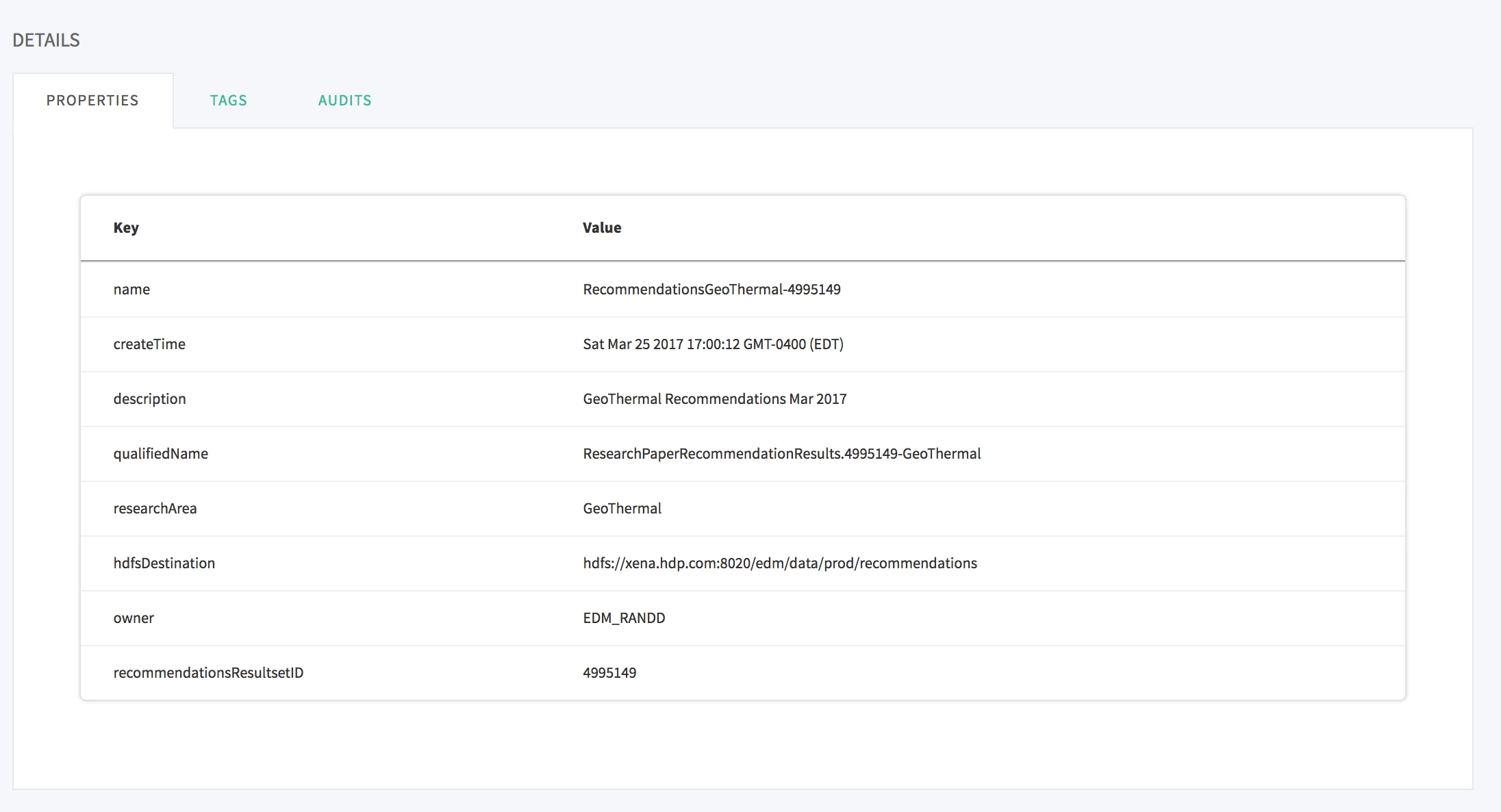

4. Create Entity for ResearchPaperRecommendationResults Type:-
[root@zulu atlas]# curl -i -X POST -H 'Content-Type: application/json' -H 'Accept: application/json' -u admin 'http://yellow.hdp.com:21000/api/atlas/entities' -d @atlas_entity_RecommendationResults.json
Enter host password for user 'admin':
{"requestId":"qtp84739718-16 - b7ebe7d8-e671-4e94-a6c7-506947c7d5e5","entities":{"created":["43b6da13-31ee-4bbe-980e-84ed4b759f11"]},"definition":{"jsonClass":"org.apache.atlas.typesystem.json.InstanceSerialization$_Reference","id":{"jsonClass":"org.apache.atlas.typesystem.json.InstanceSerialization$_Id","id":"43b6da13-31ee-4bbe-980e-84ed4b759f11","version":0,"typeName":"ResearchPaperRecommendationResults","state":"ACTIVE"},"typeName":"ResearchPaperRecommendationResults","values":{"name":"RecommendationsGeoThermal-4995149","createTime":"2017-03-25T21:00:12.000Z","description":"GeoThermal Recommendations Mar 2017","qualifiedName":"ResearchPaperRecommendationResults.4995149-GeoThermal","researchArea":"GeoThermal","hdfsDestination":"hdfs:\/\/xena.hdp.com:8020\/edm\/data\/prod\/recommendations","owner":"EDM_RANDD","recommendationsResultsetID":4995149},"traitNames":[],"traits":{}}}

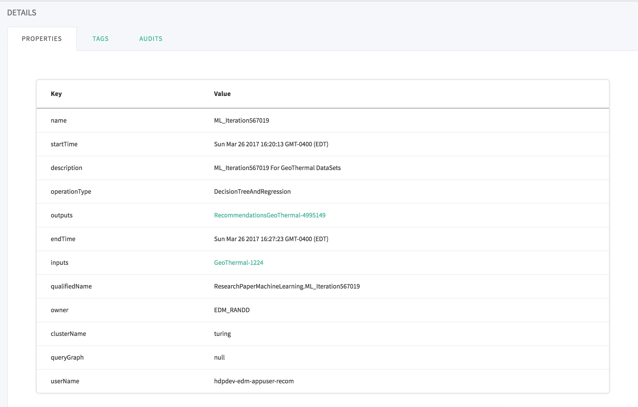

6. Create an entity for the Process Type:-
[root@zulu atlas]# curl -i -X POST -H 'Content-Type: application/json' -H 'Accept: application/json' -u admin 'http://yellow.hdp.com:21000/api/atlas/entities' -d @atlas_entity_process_ML.json
Enter host password for user 'admin':****
{"requestId":"qtp84739718-18 - abbc3513-fa09-4a63-a8e5-af4b7b5f2d9a","entities":{"created":["4bd5263e-761b-4c0c-b629-c3d9fc87626f"]},"definition":{"jsonClass":"org.apache.atlas.typesystem.json.InstanceSerialization$_Reference","id":{"jsonClass":"org.apache.atlas.typesystem.json.InstanceSerialization$_Id","id":"4bd5263e-761b-4c0c-b629-c3d9fc87626f","version":0,"typeName":"ResearchPaperMachineLearning","state":"ACTIVE"},"typeName":"ResearchPaperMachineLearning","values":{"name":"ML_Iteration567019","startTime":"2017-03-26T20:20:13.675Z","description":"ML_Iteration567019 For GeoThermal DataSets","operationType":"DecisionTreeAndRegression","outputs":[{"jsonClass":"org.apache.atlas.typesystem.json.InstanceSerialization$_Id","id":"43b6da13-31ee-4bbe-980e-84ed4b759f11","version":0,"typeName":"DataSet","state":"ACTIVE"}],"endTime":"2017-03-26T20:27:23.675Z","inputs":[{"jsonClass":"org.apache.atlas.typesystem.json.InstanceSerialization$_Id","id":"40dc03dc-16d6-4281-826d-c4884cd1dad5","version":0,"typeName":"DataSet","state":"ACTIVE"}],"qualifiedName":"ResearchPaperMachineLearning.ML_Iteration567019","owner":"EDM_RANDD","clusterName":"turing","queryGraph":null,"userName":"hdpdev-edm-appuser-recom"},"traitNames":[],"traits":{}}}

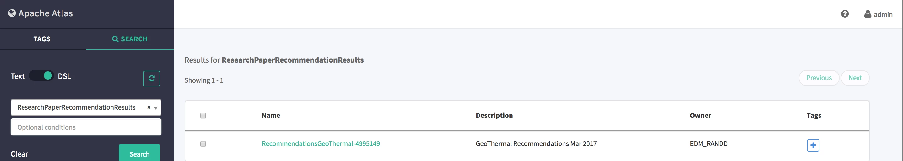

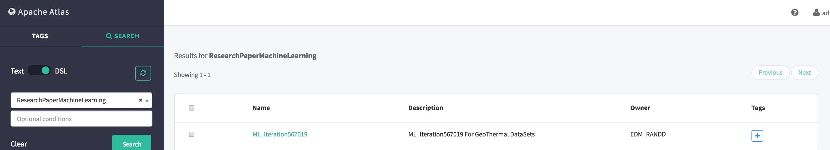

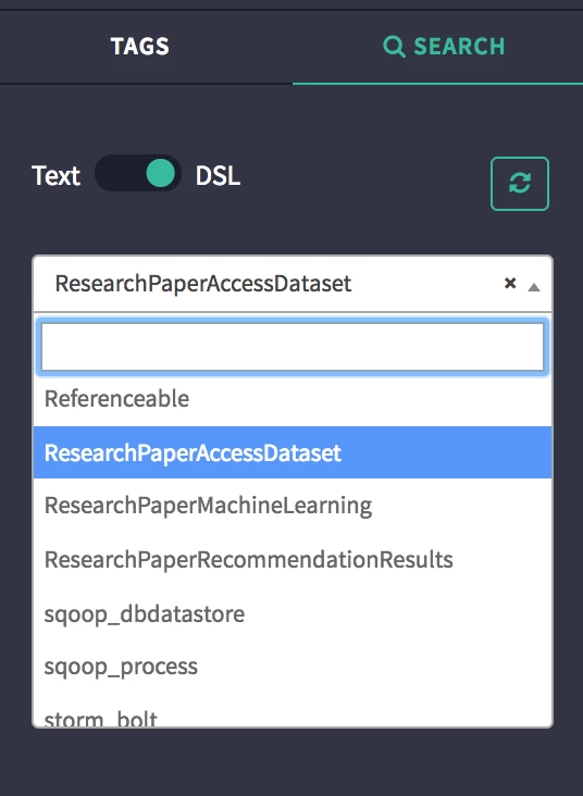

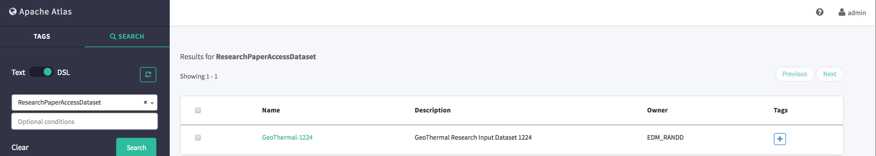

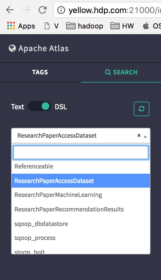

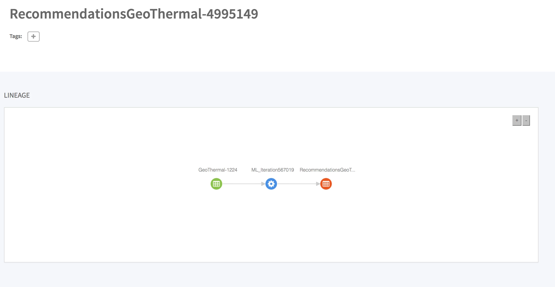

So after creating all the necessary Types and Entities we should be able to see the respective types created in Atlas UI and query entities and create new entities as usual.
In this case we had a java application that used to create and deliver the entity json files for the above workflow after each iteration of the ML process completed successfully (Since the attributes values in the entities json file should be altered dynamically based on the iteration and results)
You should also be able to see the types created thus far in the search objects.
