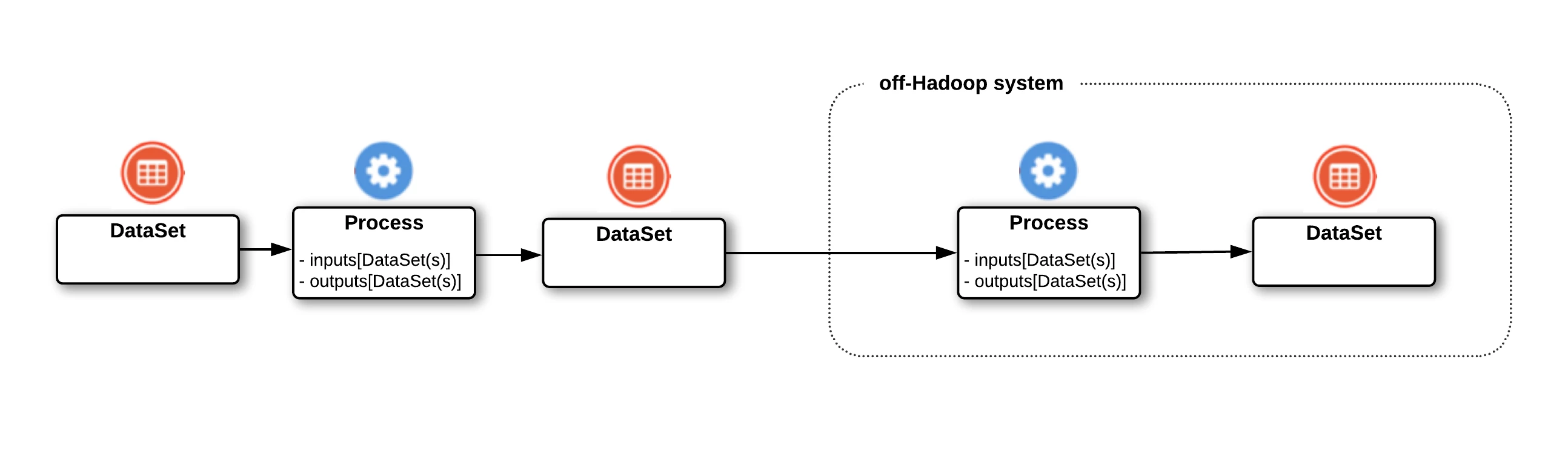

  • show how to extend your Atlas lineage to include processing and outputs on non-Hadoop systems
  • represent the above as a single lineage that connects data in Hadoop to a reporting system which generates a report and sends an email with the report attached
  • emphasize a key principle about Atlas: because its Rest API and customized types allow metadata to be sent and represented from any system, Atlas can centralize metadata from your entire data landscape.

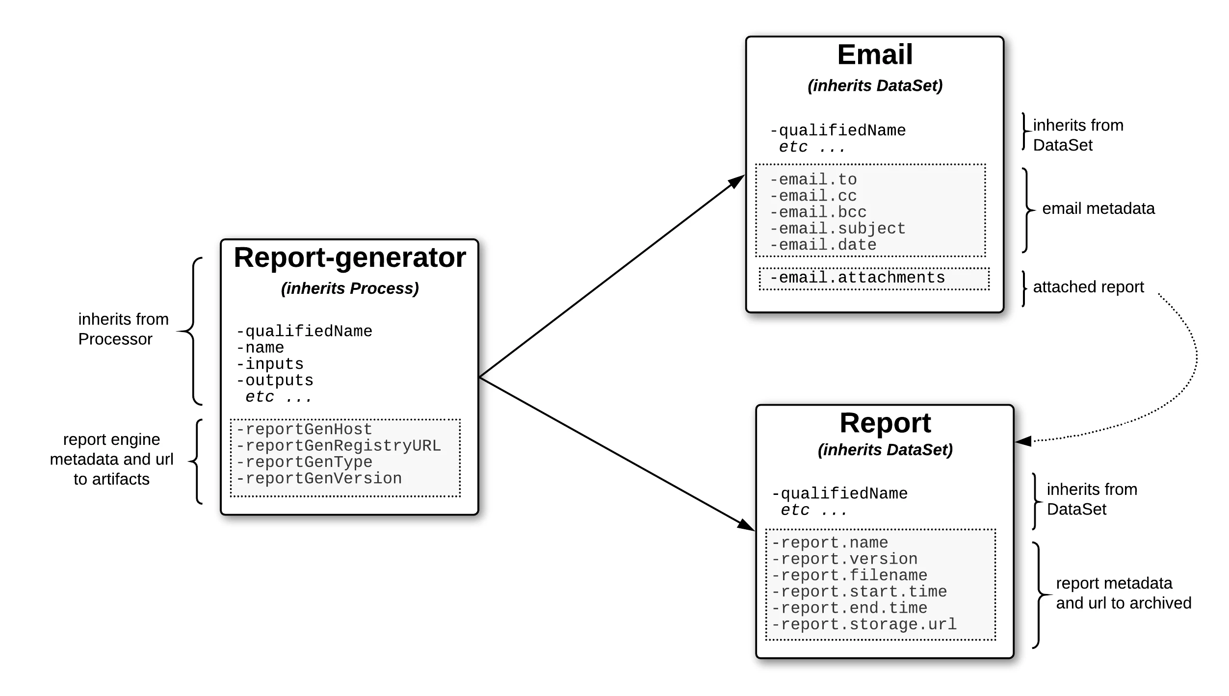

The main concepts is summarized below.

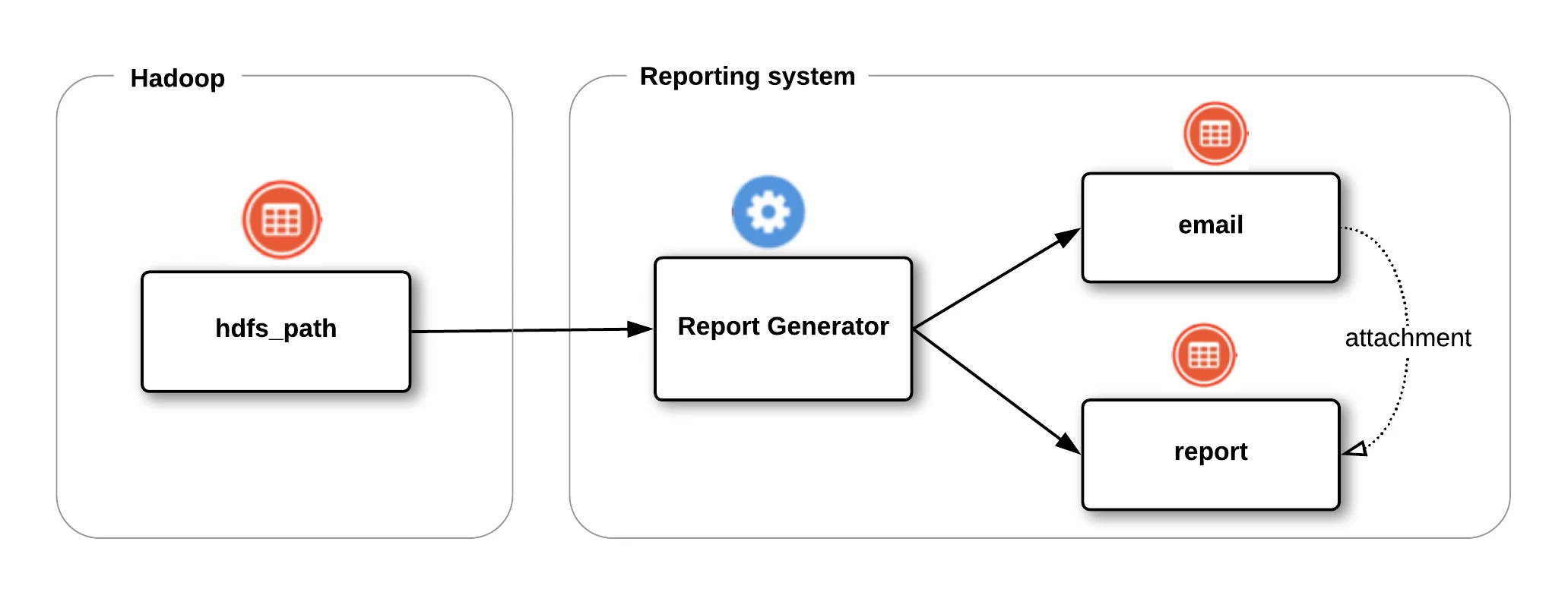

The Atlas lineage includes processing and outputs on systems beyond Hadoop.
Example: Reporting system
The reporting system:
  • inputs HDFS data
  • outputs a report and archives it
  • attaches the report in an email and sends the email
This is shown in the digram below.
Implementation
ReportGenerator type is implemented as follows (one-time operation):

ReportGenerator entity is implemented as follows:

Report type is implemented as follows (one-time operation):

Report entity is implemented as follows:

Email type is implemented as follows (one-time operation):

Email entity is implemented as follows:

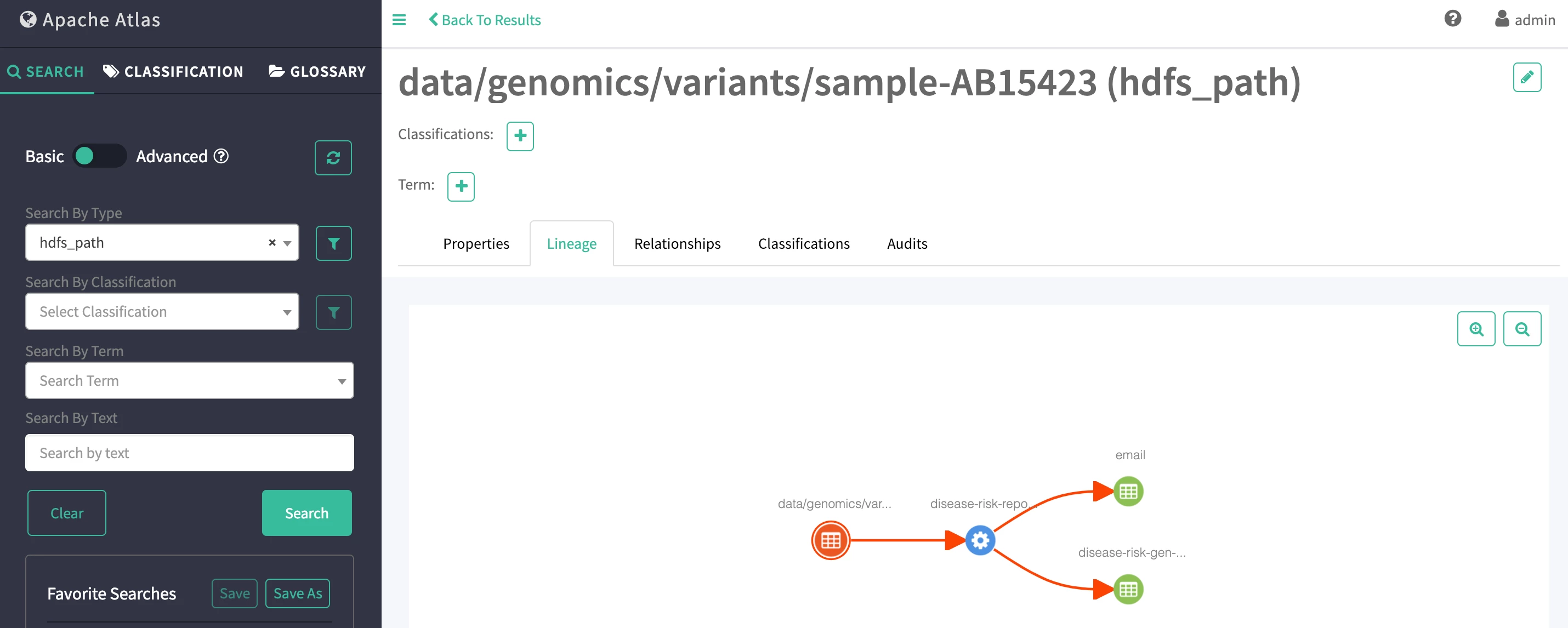

Results in Atlas UI
Lineage
Lineage shows the HDFS input file and the processing and output on the reporting system.

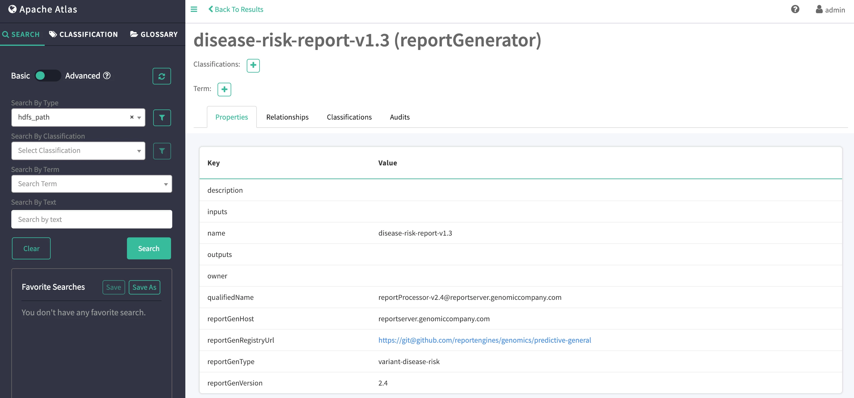

Report Generator
When we click the blue gear we see full metadata on the reporting engine, including host machine and url to its artifacts (e.g. deployed binary, code, etc). This is shown in screenshot below.

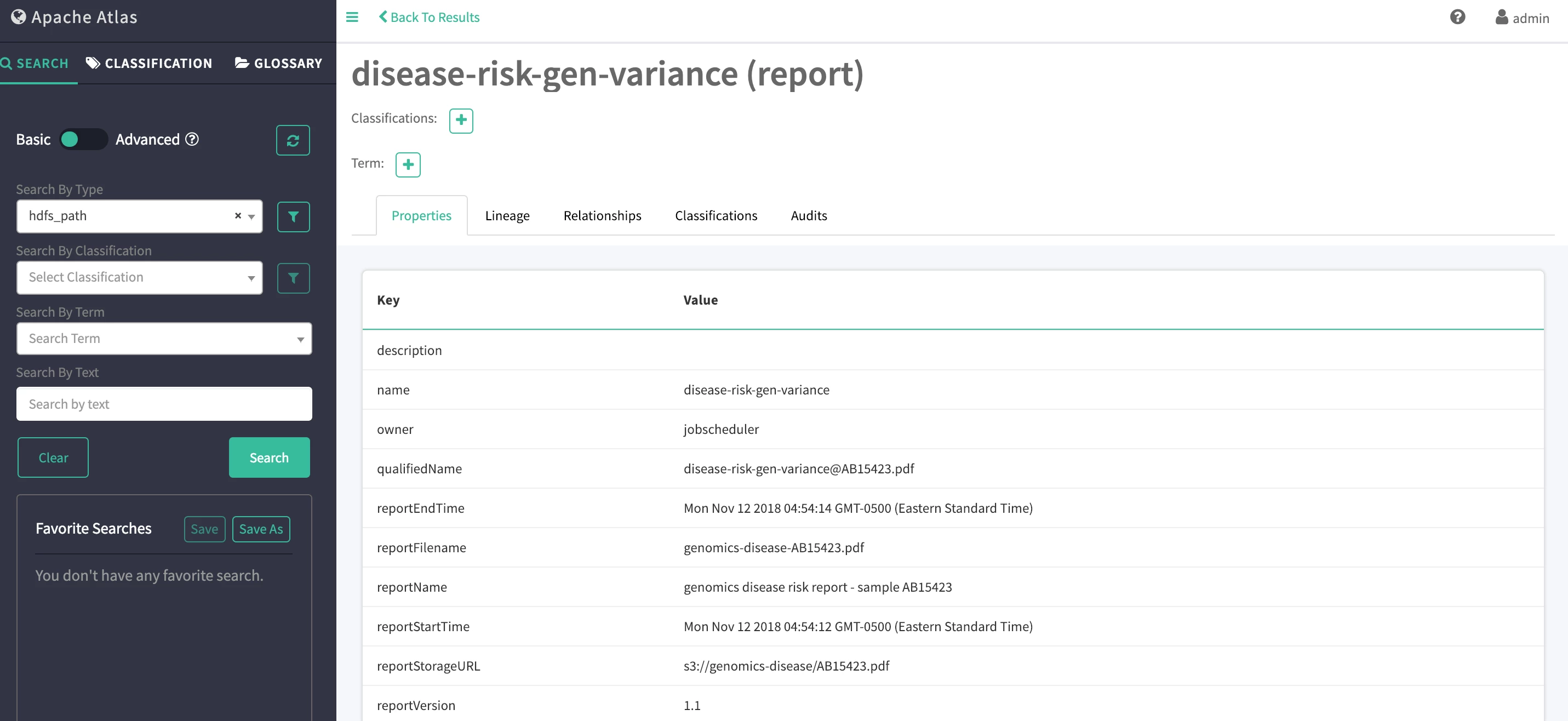

Report
From the lineage when we click the report output, we see full metadata on the generated report, including filename, archive location and creation time. This is shown in screenshot below.

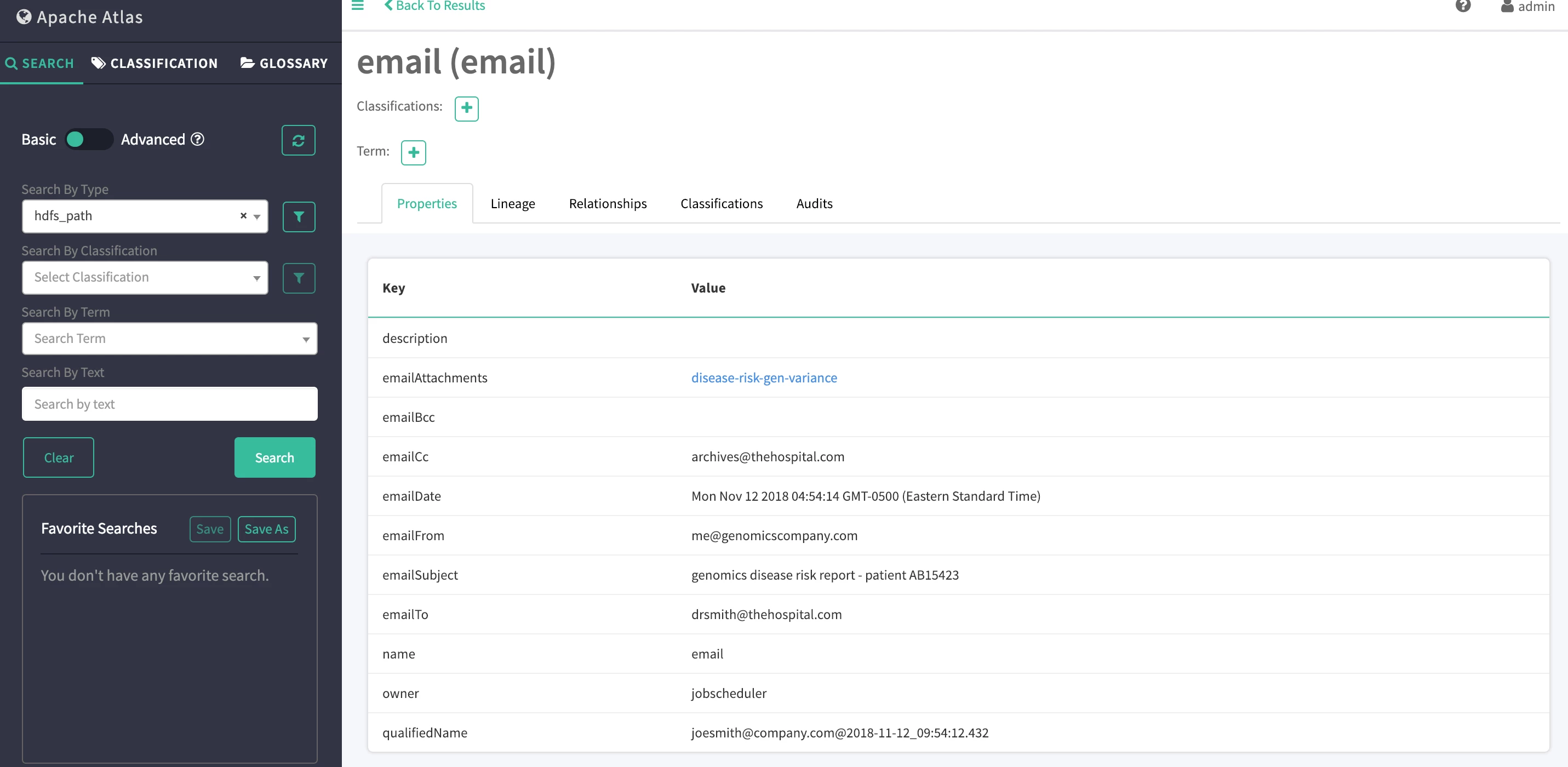

Email
From the lineage when we click email output, we see familiar information about an email, including to, from, cc, subject and date. This is shown in screenshot below.
Note that the attachment field shows a clickable link to the report entity that is attached. Clicking this link leads the same report screen as shown above.
