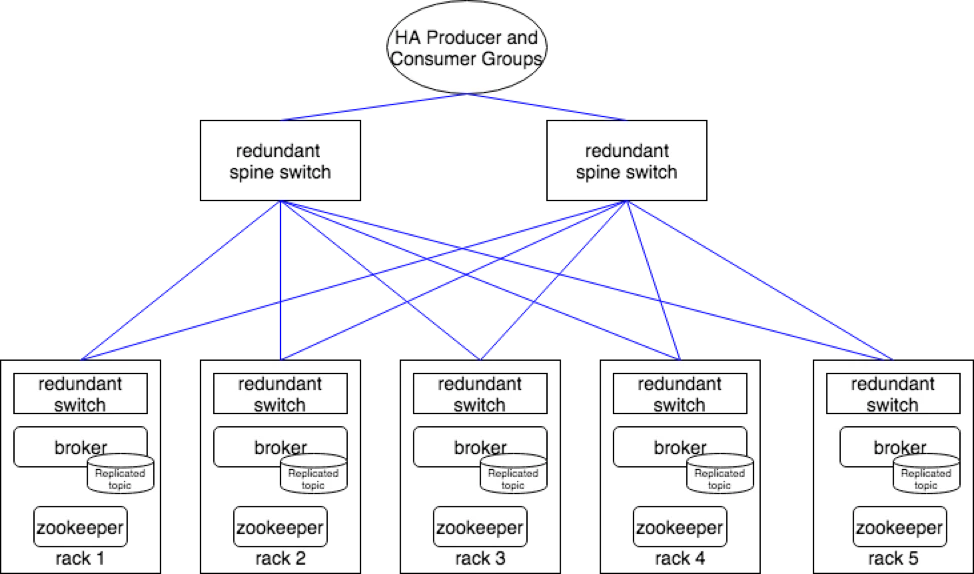

See below a simplified example of a logical architecture for HA.
The above diagram shows an implementation for HA for an enterprise that uses 5 racks, 5 zookeepers distributed across multiple racks, multiple brokers distributed across those 5 racks, replicated topics, HA producers and consumers. This is similar with HDFS HA network design.
