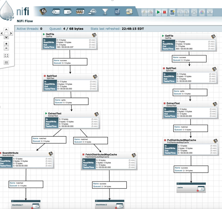

After importing the model, instantiate it. It will show as the following:

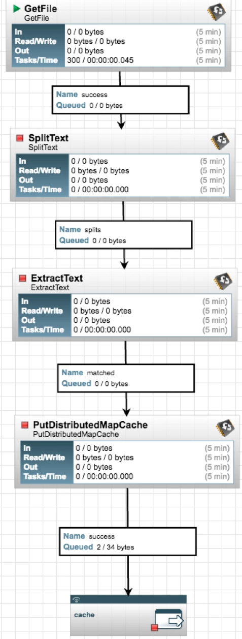

Populating DistributedMapCache is performed in the flow presented on the right side of the model that you imported at the previous step.

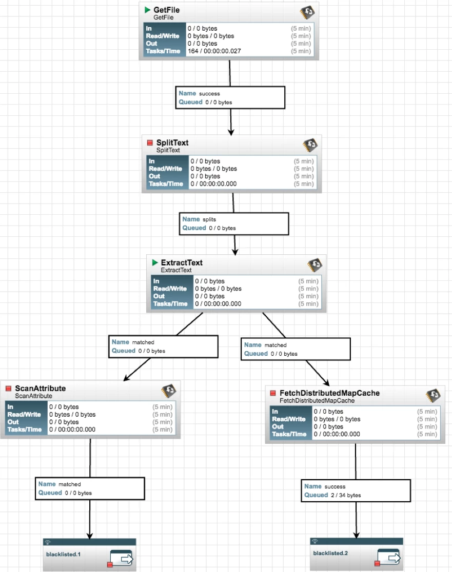

The filtering flow, via Scan Attribute or FetchDistributedCacheMap:
Use of GetFile, SplitText and ExtractText processor is well documented and a basic Google will return several good examples, however, a good example of how to use FetchDistributedMapCache and PutDistributedMapCache is not that well documented. That was the main reason to write this article. I could not find another good reference. I am sure others felt the same way and hopefully this helps.

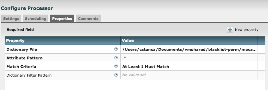

ScanAttribute Approach
Before starting this processor, you need to right click on its header, choose Configuration and go to Properties tab and change the Dictionary file to be your macaddress-blacklist.txt. This is a clone of the same file you use in GetFile processor, but I suggest to put it in a separate folder as such GetFile will not ingest it and delete it after use. This needs to be permanent like a lookup file on the disk.
SplitText is used to split the file line by line. You can check this property by righ-clicking the header of the processor and choosing “Properties” tab. Line Split Count is set to 1.
ExtractText processor uses a custom regex to extract the mac address from macaddress-log.txt. You can find in Properties, last property in the list.
ScanAttribute processor sets the Dictionary File to the folder/file of choice. In this demo, I used macaddresses-blacklist.txt file included in the repo that you cloned at one of the previous steps.
DistributedCache Approach

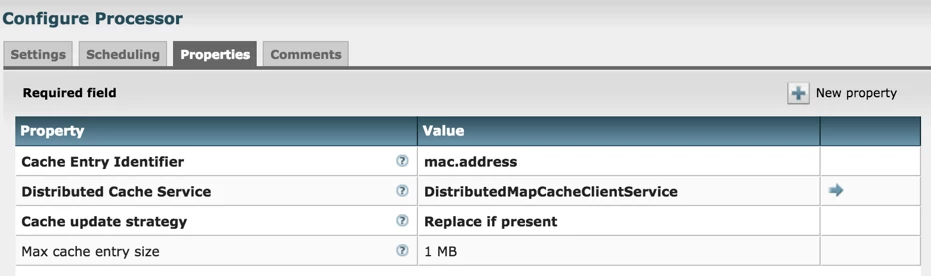

The right branch of the flow in the left uses the DistributedCache populated by the flow on the right of the model. Inspect each processor by checking each processor properties. They are already similar with the first half of the flow on the left, excepting the use of PutDistributedCache processor which sets the Cache Entry Identifier for mac.address value.

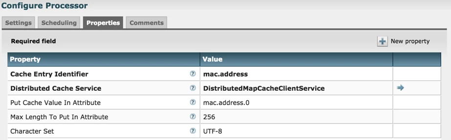

I’ll refer only to the consumption of the mac.address property value set by PutDistributedCache.
Set Cache Entry Identifier to the same mac.address
Please note that DistributedMapCacheClientService is enabled. You can achieve that by clicking on NiFi Flow Settings icon, fourth on the right corner, "Controller Services"

Don’t forget to start all processors and inspect the queues. My approach is to start processors one at the time in the order of the data flow and processing and check all the stats and lineage on connection queues. This is what I love about NiFi, it is so easy to test and learn.
