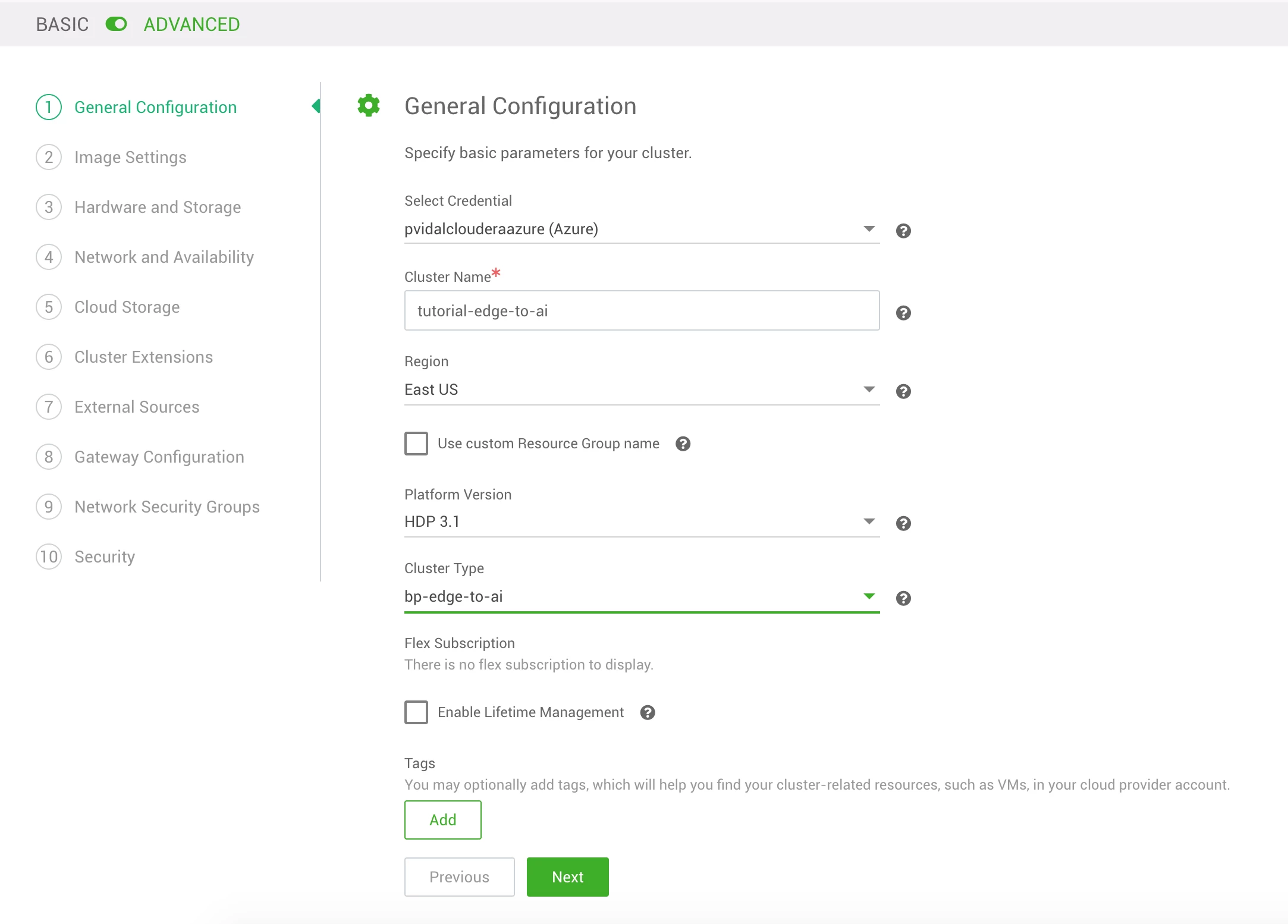

  • Step 3: Create cluster

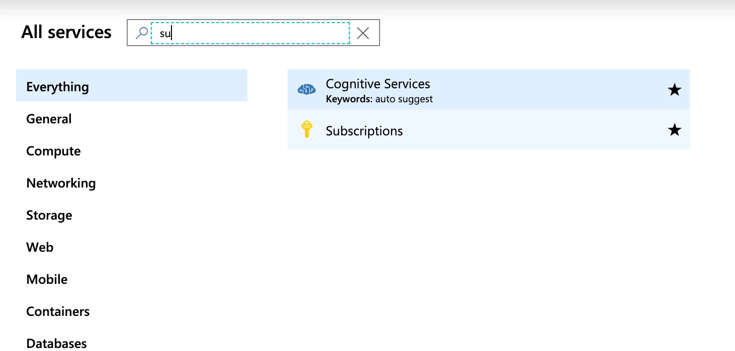

Find your Azure subscription and tenant ID
To find your subscription ID, go to the search box and look for subscription; you should find it as such:

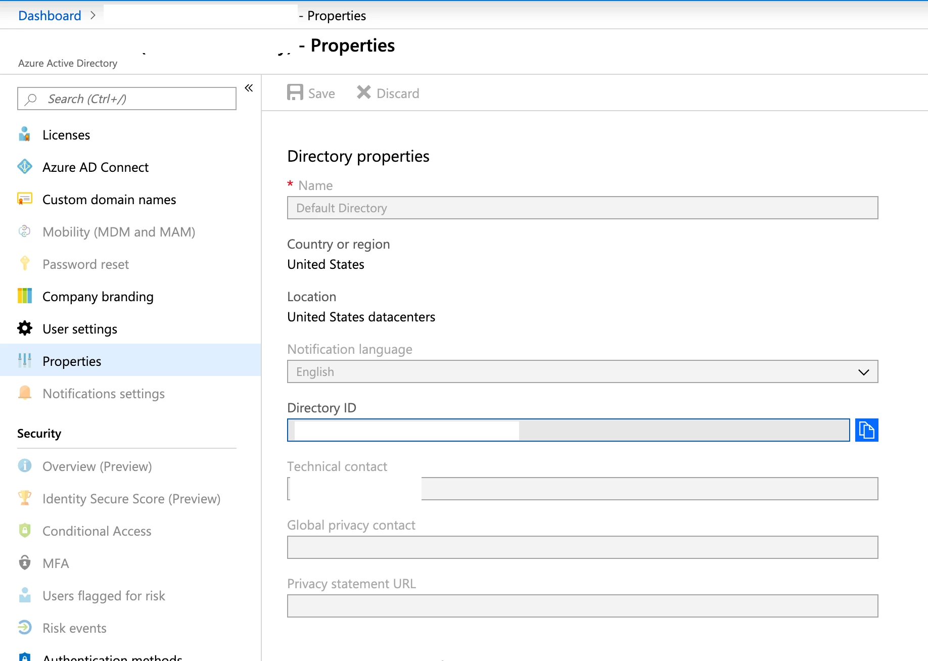

For the tenant ID, use the Azure AD Directory ID:

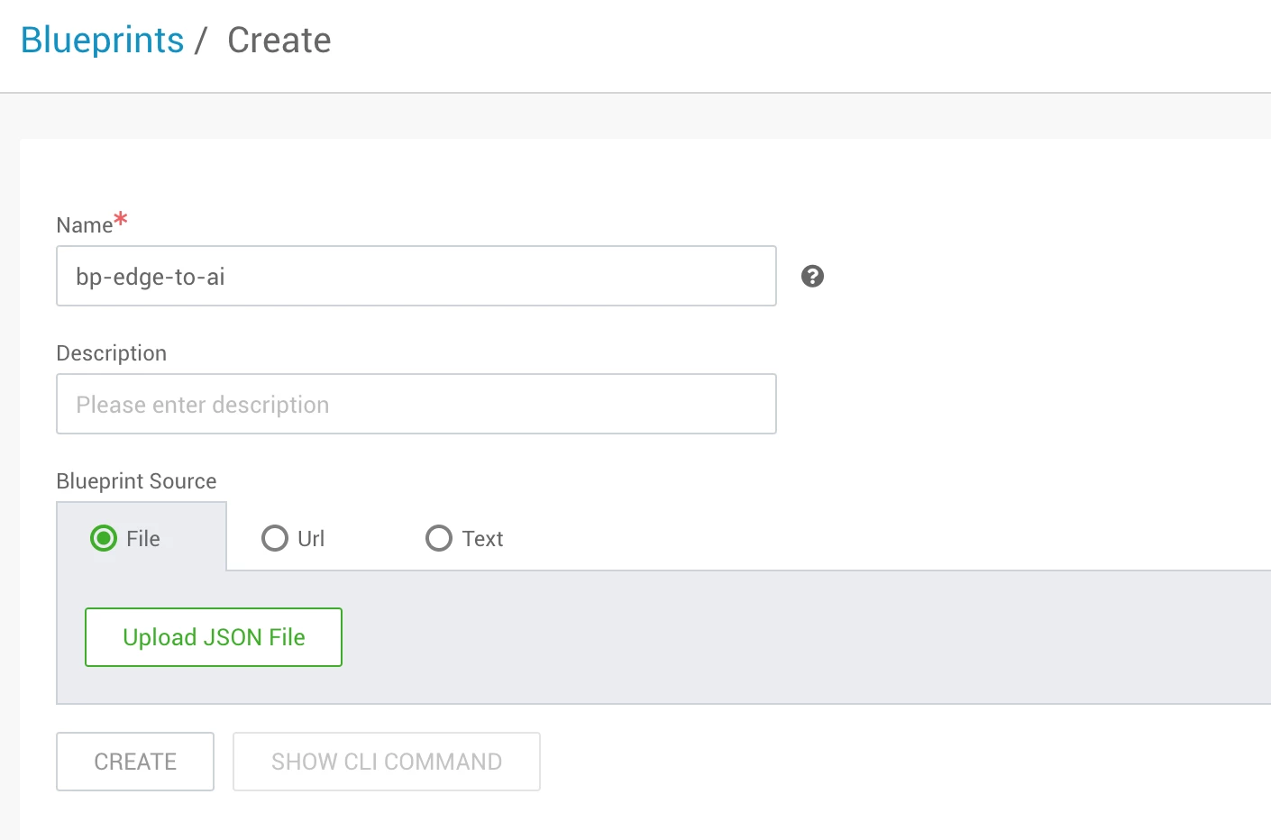

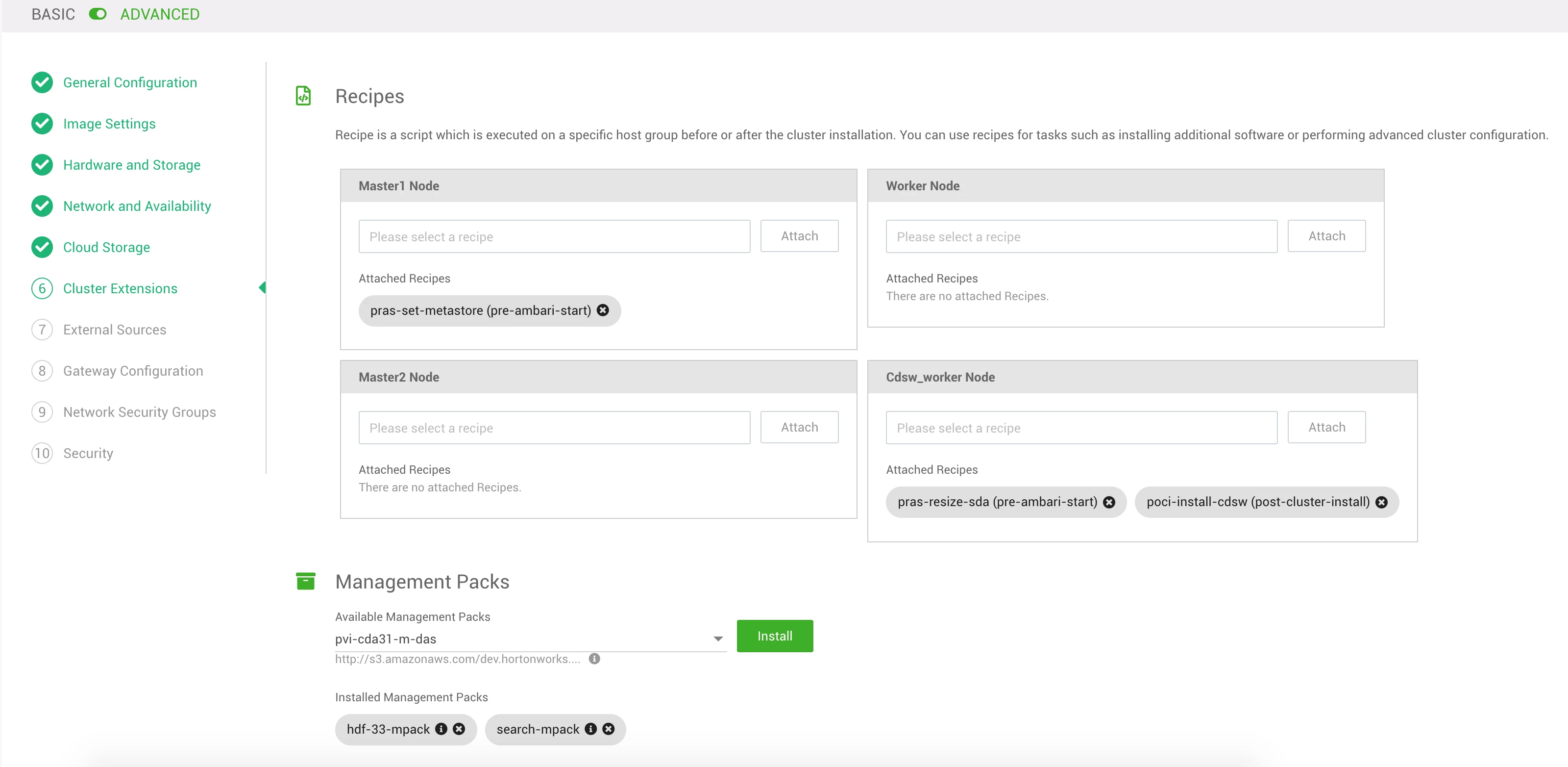

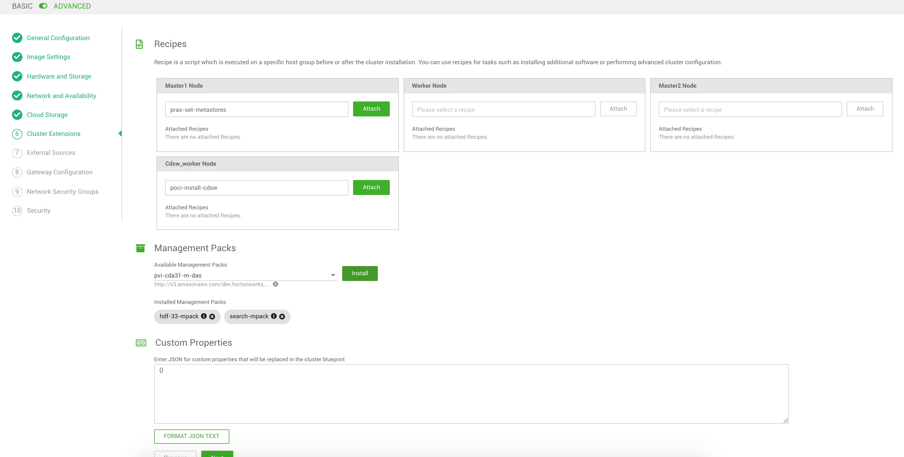

Step 2: Setup blueprint and cluster extensions
Blueprint
First upload the blueprint below:

Recipes

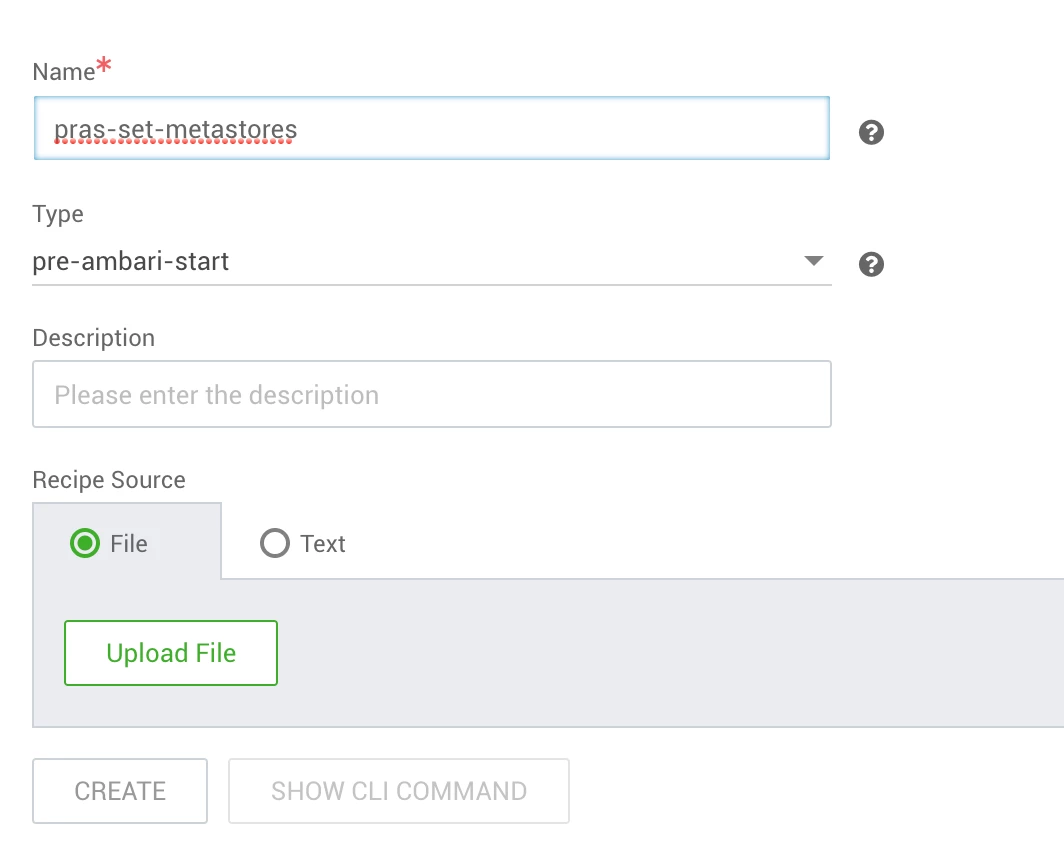

Pre Ambari start recipe to setup metastores
#!/usr/bin/env bash
# Intialize MetaStores
yum install -y https://download.postgresql.org/pub/repos/yum/9.6/redhat/rhel-7-x86_64/pgdg-redhat96-9.6-3.noarch.rpm
yum install -y postgresql96-server
yum install -y postgresql96-contrib
/usr/pgsql-9.6/bin/postgresql96-setup initdb
sed -i 's,#port = 5432,port = 5433,g' /var/lib/pgsql/9.6/data/postgresql.conf
echo '' > /var/lib/pgsql/9.6/data/pg_hba.conf
echo 'local all das,streamsmsgmgr,cloudbreak,registry,ambari,postgres,hive,ranger,rangerdba,rangeradmin,rangerlogger,druid trust ' >> /var/lib/pgsql/9.6/data/pg_hba.conf
echo 'host all das,streamsmsgmgr,cloudbreak,registry,ambari,postgres,hive,ranger,rangerdba,rangeradmin,rangerlogger,druid 0.0.0.0/0 trust ' >> /var/lib/pgsql/9.6/data/pg_hba.conf
echo 'host all das,streamsmsgmgr,cloudbreak,registry,ambari,postgres,hive,ranger,rangerdba,rangeradmin,rangerlogger,druid ::/0 trust ' >> /var/lib/pgsql/9.6/data/pg_hba.conf
echo 'local all all peer ' >> /var/lib/pgsql/9.6/data/pg_hba.conf
echo 'host all all 127.0.0.1/32 ident ' >> /var/lib/pgsql/9.6/data/pg_hba.conf
echo 'host all all ::1/128 ident ' >> /var/lib/pgsql/9.6/data/pg_hba.conf
systemctl enable postgresql-9.6.service
systemctl start postgresql-9.6.service
echo "CREATE DATABASE streamsmsgmgr;" | sudo -u postgres psql -U postgres -h localhost -p 5433
echo "CREATE USER streamsmsgmgr WITH PASSWORD 'streamsmsgmgr';" | sudo -u postgres psql -U postgres -h localhost -p 5433
echo "GRANT ALL PRIVILEGES ON DATABASE streamsmsgmgr TO streamsmsgmgr;" | sudo -u postgres psql -U postgres -h localhost -p 5433
echo "CREATE DATABASE druid;" | sudo -u postgres psql -U postgres
echo "CREATE DATABASE ranger;" | sudo -u postgres psql -U postgres
echo "CREATE DATABASE registry;" | sudo -u postgres psql -U postgres
echo "CREATE USER druid WITH PASSWORD 'druid';" | sudo -u postgres psql -U postgres
echo "CREATE USER registry WITH PASSWORD 'registry';" | sudo -u postgres psql -U postgres
echo "CREATE USER rangerdba WITH PASSWORD 'rangerdba';" | sudo -u postgres psql -U postgres
echo "CREATE USER rangeradmin WITH PASSWORD 'ranger';" | sudo -u postgres psql -U postgres
echo "GRANT ALL PRIVILEGES ON DATABASE druid TO druid;" | sudo -u postgres psql -U postgres
echo "GRANT ALL PRIVILEGES ON DATABASE registry TO registry;" | sudo -u postgres psql -U postgres
echo "GRANT ALL PRIVILEGES ON DATABASE ranger TO rangerdba;" | sudo -u postgres psql -U postgres
echo "GRANT ALL PRIVILEGES ON DATABASE ranger TO rangeradmin;" | sudo -u postgres psql -U postgres
#ambari-server setup --jdbc-db=postgres --jdbc-driver=/usr/share/java/postgresql-jdbc.jar
if [[ $(cat /etc/system-release|grep -Po Amazon) == "Amazon" ]]; then
echo '' > /var/lib/pgsql/9.5/data/pg_hba.conf
echo 'local all cloudbreak,ambari,postgres,hive,ranger,rangerdba,rangeradmin,rangerlogger,druid,registry trust ' >> /var/lib/pgsql/9.5/data/pg_hba.conf
echo 'host all cloudbreak,ambari,postgres,hive,ranger,rangerdba,rangeradmin,rangerlogger,druid,registry 0.0.0.0/0 trust ' >> /var/lib/pgsql/9.5/data/pg_hba.conf
echo 'host all cloudbreak,ambari,postgres,hive,ranger,rangerdba,rangeradmin,rangerlogger,druid,registry ::/0 trust ' >> /var/lib/pgsql/9.5/data/pg_hba.conf
echo 'local all all peer ' >> /var/lib/pgsql/9.5/data/pg_hba.conf
echo 'host all all 127.0.0.1/32 ident ' >> /var/lib/pgsql/9.5/data/pg_hba.conf
echo 'host all all ::1/128 ident ' >> /var/lib/pgsql/9.5/data/pg_hba.conf
sudo -u postgres /usr/pgsql-9.5/bin/pg_ctl -D /var/lib/pgsql/9.5/data/ reload
else
echo '' > /var/lib/pgsql/data/pg_hba.conf
echo 'local all cloudbreak,ambari,postgres,hive,ranger,rangerdba,rangeradmin,rangerlogger,druid,registry trust ' >> /var/lib/pgsql/data/pg_hba.conf
echo 'host all cloudbreak,ambari,postgres,hive,ranger,rangerdba,rangeradmin,rangerlogger,druid,registry 0.0.0.0/0 trust ' >> /var/lib/pgsql/data/pg_hba.conf
echo 'host all cloudbreak,ambari,postgres,hive,ranger,rangerdba,rangeradmin,rangerlogger,druid,registry ::/0 trust ' >> /var/lib/pgsql/data/pg_hba.conf
echo 'local all all peer ' >> /var/lib/pgsql/data/pg_hba.conf
echo 'host all all 127.0.0.1/32 ident ' >> /var/lib/pgsql/data/pg_hba.conf
echo 'host all all ::1/128 ident ' >> /var/lib/pgsql/data/pg_hba.conf
sudo -u postgres pg_ctl -D /var/lib/pgsql/data/ reload
fi
yum remove -y mysql57-community*
yum remove -y mysql56-server*
yum remove -y mysql-community*
rm -Rvf /var/lib/mysql
yum install -y epel-release
yum install -y libffi-devel.x86_64
ln -s /usr/lib64/libffi.so.6 /usr/lib64/libffi.so.5
yum install -y mysql-connector-java*
ambari-server setup --jdbc-db=mysql --jdbc-driver=/usr/share/java/mysql-connector-java.jar
if [ $(cat /etc/system-release|grep -Po Amazon) == Amazon ]; then
yum install -y mysql56-server
service mysqld start
else
yum localinstall -y https://dev.mysql.com/get/mysql-community-release-el7-5.noarch.rpm
yum install -y mysql-community-server
systemctl start mysqld.service
fi
chkconfig --add mysqld
chkconfig mysqld on
ln -s /usr/share/java/mysql-connector-java.jar /usr/hdp/current/hive-client/lib/mysql-connector-java.jar
ln -s /usr/share/java/mysql-connector-java.jar /usr/hdp/current/hive-server2-hive2/lib/mysql-connector-java.jar
mysql --execute="CREATE DATABASE druid DEFAULT CHARACTER SET utf8"
mysql --execute="CREATE DATABASE registry DEFAULT CHARACTER SET utf8"
mysql --execute="CREATE DATABASE streamline DEFAULT CHARACTER SET utf8"
mysql --execute="CREATE DATABASE streamsmsgmgr DEFAULT CHARACTER SET utf8"
mysql --execute="CREATE USER 'das'@'localhost' IDENTIFIED BY 'dasuser'"
mysql --execute="CREATE USER 'das'@'%' IDENTIFIED BY 'dasuser'"
mysql --execute="CREATE USER 'ranger'@'localhost' IDENTIFIED BY 'ranger'"
mysql --execute="CREATE USER 'ranger'@'%' IDENTIFIED BY 'ranger'"
mysql --execute="CREATE USER 'rangerdba'@'localhost' IDENTIFIED BY 'rangerdba'"
mysql --execute="CREATE USER 'rangerdba'@'%' IDENTIFIED BY 'rangerdba'"
mysql --execute="CREATE USER 'registry'@'localhost' IDENTIFIED BY 'registry'"
mysql --execute="CREATE USER 'registry'@'%' IDENTIFIED BY 'registry'"
mysql --execute="CREATE USER 'streamsmsgmgr'@'localhost' IDENTIFIED BY 'streamsmsgmgr'"
mysql --execute="CREATE USER 'streamsmsgmgr'@'%' IDENTIFIED BY 'streamsmsgmgr'"
mysql --execute="CREATE USER 'druid'@'%' IDENTIFIED BY 'druid'"
mysql --execute="CREATE USER 'streamline'@'%' IDENTIFIED BY 'streamline'"
mysql --execute="CREATE USER 'streamline'@'localhost' IDENTIFIED BY 'streamline'"
mysql --execute="GRANT ALL PRIVILEGES ON *.* TO 'das'@'localhost'"
mysql --execute="GRANT ALL PRIVILEGES ON *.* TO 'das'@'%'"
mysql --execute="GRANT ALL PRIVILEGES ON *.* TO 'das'@'localhost' WITH GRANT OPTION"
mysql --execute="GRANT ALL PRIVILEGES ON *.* TO 'das'@'%' WITH GRANT OPTION"
mysql --execute="GRANT ALL PRIVILEGES ON *.* TO 'ranger'@'localhost'"
mysql --execute="GRANT ALL PRIVILEGES ON *.* TO 'ranger'@'%'"
mysql --execute="GRANT ALL PRIVILEGES ON *.* TO 'ranger'@'localhost' WITH GRANT OPTION"
mysql --execute="GRANT ALL PRIVILEGES ON *.* TO 'ranger'@'%' WITH GRANT OPTION"
mysql --execute="GRANT ALL PRIVILEGES ON *.* TO 'rangerdba'@'localhost'"
mysql --execute="GRANT ALL PRIVILEGES ON *.* TO 'rangerdba'@'%'"
mysql --execute="GRANT ALL PRIVILEGES ON *.* TO 'rangerdba'@'localhost' WITH GRANT OPTION"
mysql --execute="GRANT ALL PRIVILEGES ON *.* TO 'rangerdba'@'%' WITH GRANT OPTION"
mysql --execute="GRANT ALL PRIVILEGES ON druid.* TO 'druid'@'%' WITH GRANT OPTION"
mysql --execute="GRANT ALL PRIVILEGES ON *.* TO 'registry'@'localhost'"
mysql --execute="GRANT ALL PRIVILEGES ON *.* TO 'registry'@'%'"
mysql --execute="GRANT ALL PRIVILEGES ON *.* TO 'registry'@'localhost' WITH GRANT OPTION"
mysql --execute="GRANT ALL PRIVILEGES ON *.* TO 'registry'@'%' WITH GRANT OPTION"
mysql --execute="GRANT ALL PRIVILEGES ON *.* TO 'streamsmsgmgr'@'localhost'"
mysql --execute="GRANT ALL PRIVILEGES ON *.* TO 'streamsmsgmgr'@'%'"
mysql --execute="GRANT ALL PRIVILEGES ON *.* TO 'streamsmsgmgr'@'localhost' WITH GRANT OPTION"
mysql --execute="GRANT ALL PRIVILEGES ON *.* TO 'streamsmsgmgr'@'%' WITH GRANT OPTION"
mysql --execute="GRANT ALL PRIVILEGES ON streamline.* TO 'streamline'@'%' WITH GRANT OPTION"
mysql --execute="CREATE DATABASE beast_mode_db DEFAULT CHARACTER SET utf8"
mysql --execute="CREATE USER 'bmq_user'@'localhost' IDENTIFIED BY 'Be@stM0de'"
mysql --execute="CREATE USER 'bmq_user'@'%' IDENTIFIED BY 'Be@stM0de'"
mysql --execute="GRANT ALL PRIVILEGES ON beast_mode_db.* TO 'bmq_user'@'localhost'"
mysql --execute="GRANT ALL PRIVILEGES ON beast_mode_db.* TO 'bmq_user'@'%'"
mysql --execute="GRANT ALL PRIVILEGES ON beast_mode_db.* TO 'bmq_user'@'localhost' WITH GRANT OPTION"
mysql --execute="GRANT ALL PRIVILEGES ON beast_mode_db.* TO 'bmq_user'@'%' WITH GRANT OPTION"
mysql --execute="FLUSH PRIVILEGES"
mysql --execute="COMMIT"
#remount tmpfs to ensure NOEXEC is disabled
if grep -Eq '^[^ ]+ /tmp [^ ]+ ([^ ]*,)?noexec[, ]' /proc/mounts; then
echo "/tmp found as noexec, remounting..."
mount -o remount,size=10G /tmp
mount -o remount,exec /tmp
else
echo "/tmp not found as noexec, skipping..."
fi
Pre Ambari start recipe to grow the root volume for the CDSW worker
#!/usr/bin/env bash
# WARNING: This script is only for RHEL7 on Azure
# growing the /dev/sda2 partition

Post cluster install recipe to setup CDSW
#!/usr/bin/env bash

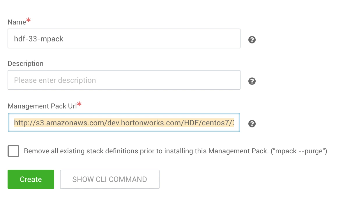

Management packs
You will need two management packs for this setup, using the URL detailed below:

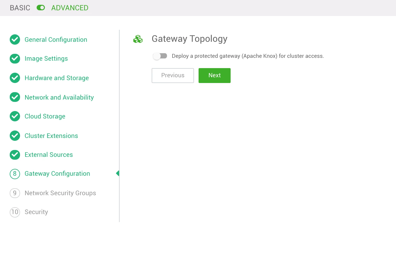

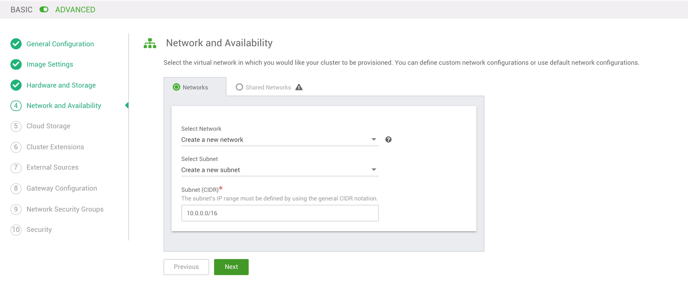

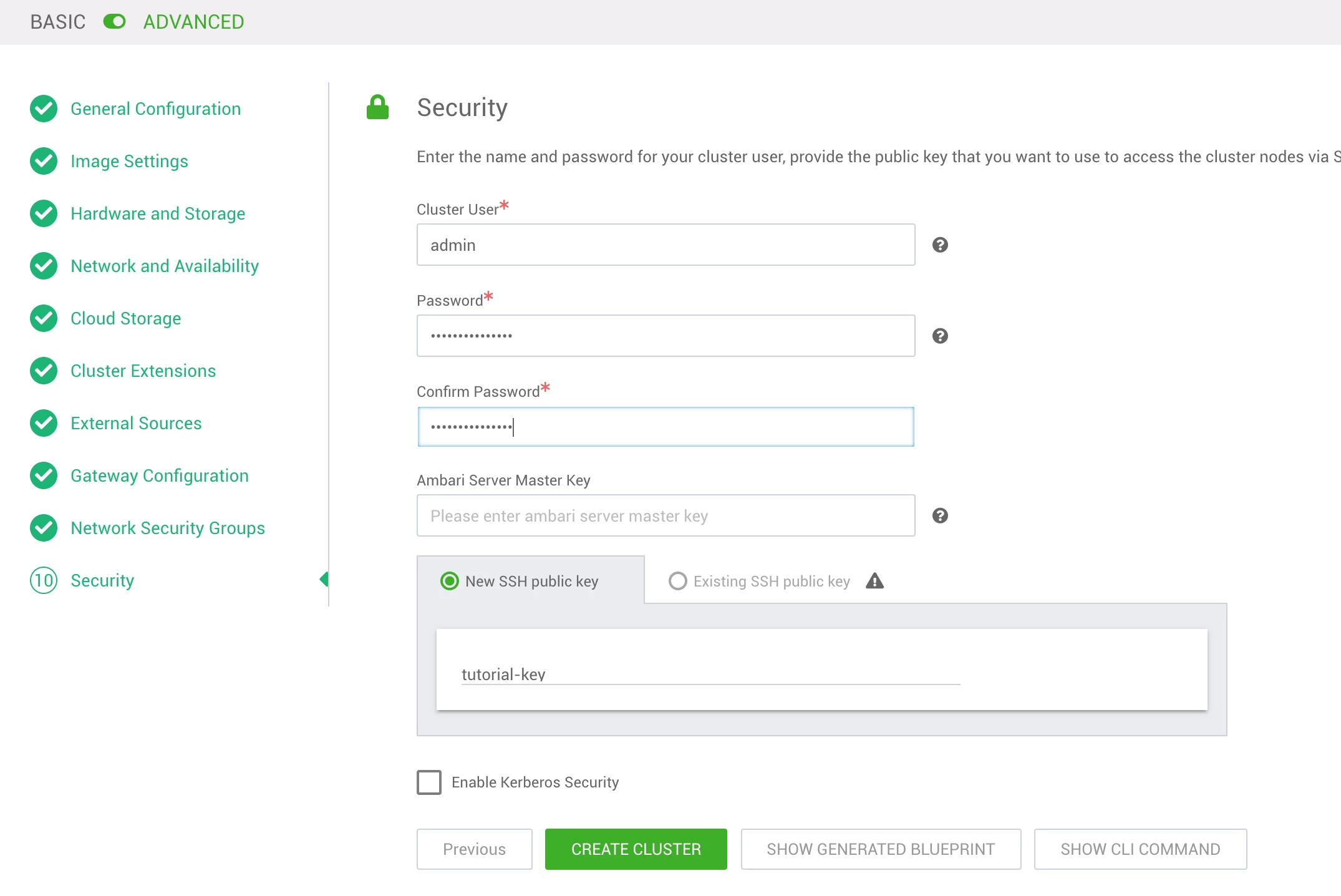

This step uses Cloudbreak's Create Cluster wizard, and is pretty self-explanatory following screenshots, but I will add specific parameters in text form for convenience
Note: Do not forget to toggle the advanced mode when running the wizard (top of the screen)

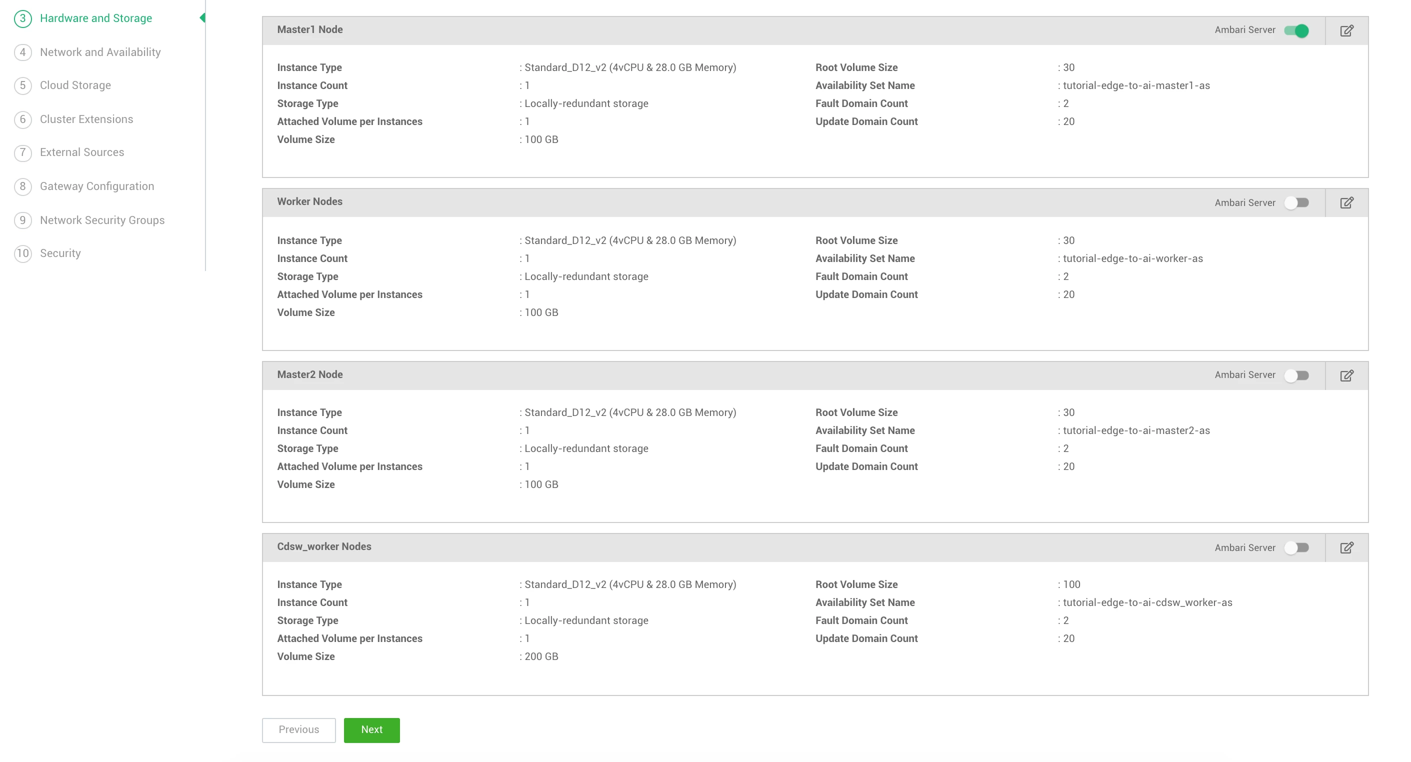

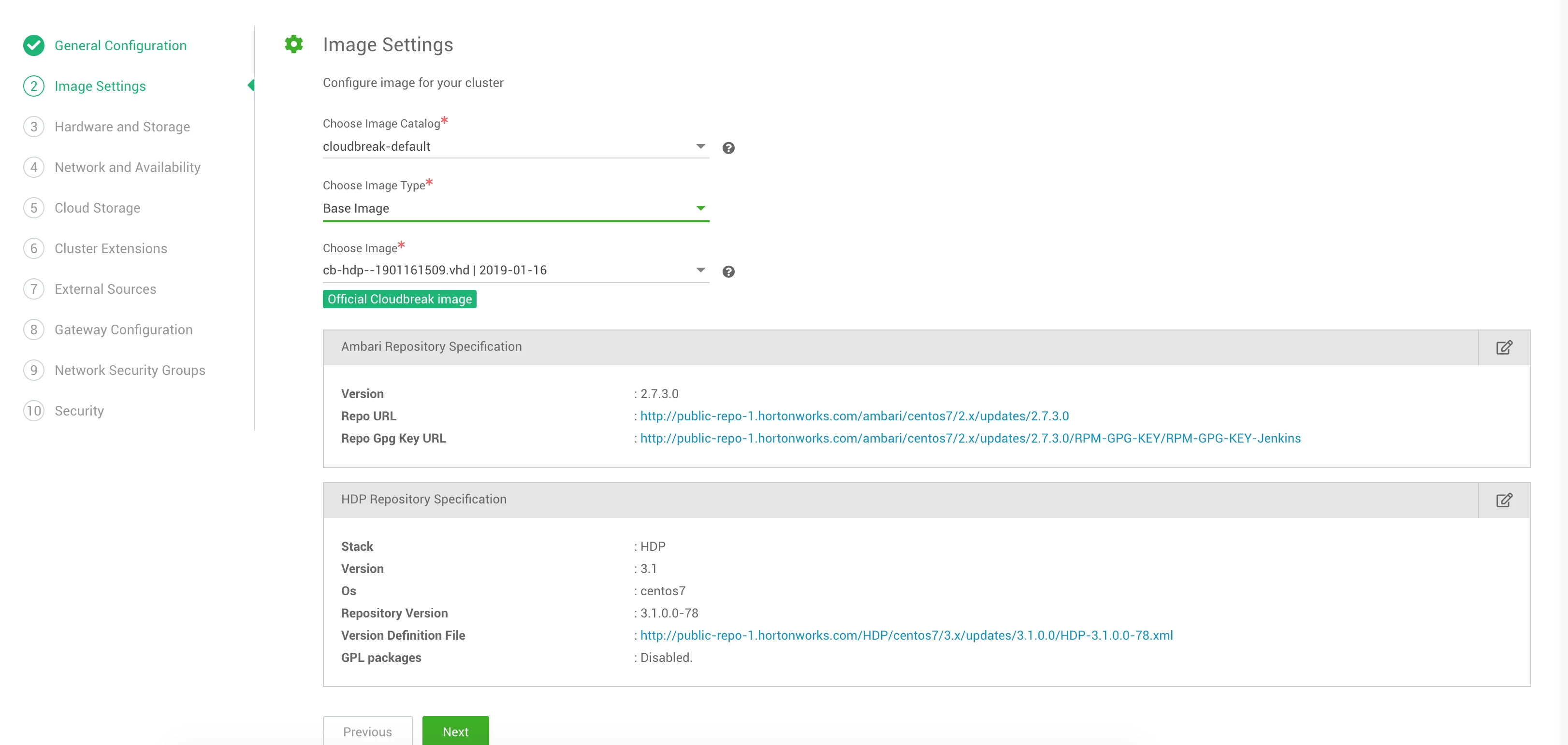

General Configuration
Image Settings
Hardware and Storage
Note: Make sure to use 100 GB as the root volume size for CDSW.
Network and Availability

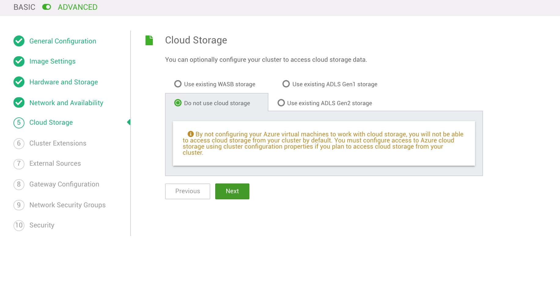

Cloud Storage
Cluster Extensions

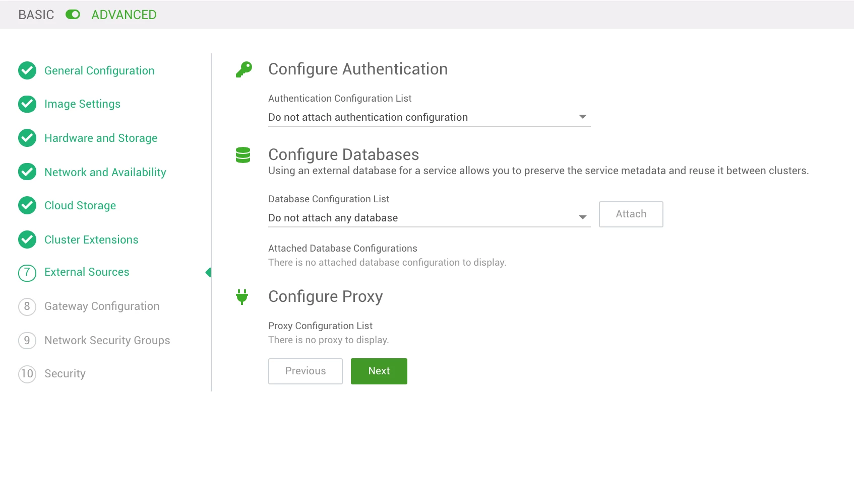

External Sources
Gateway Configuration

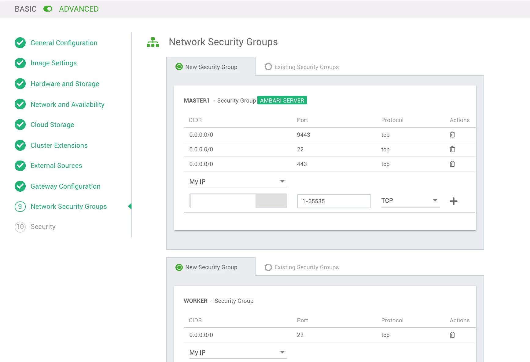

Network Security Groups

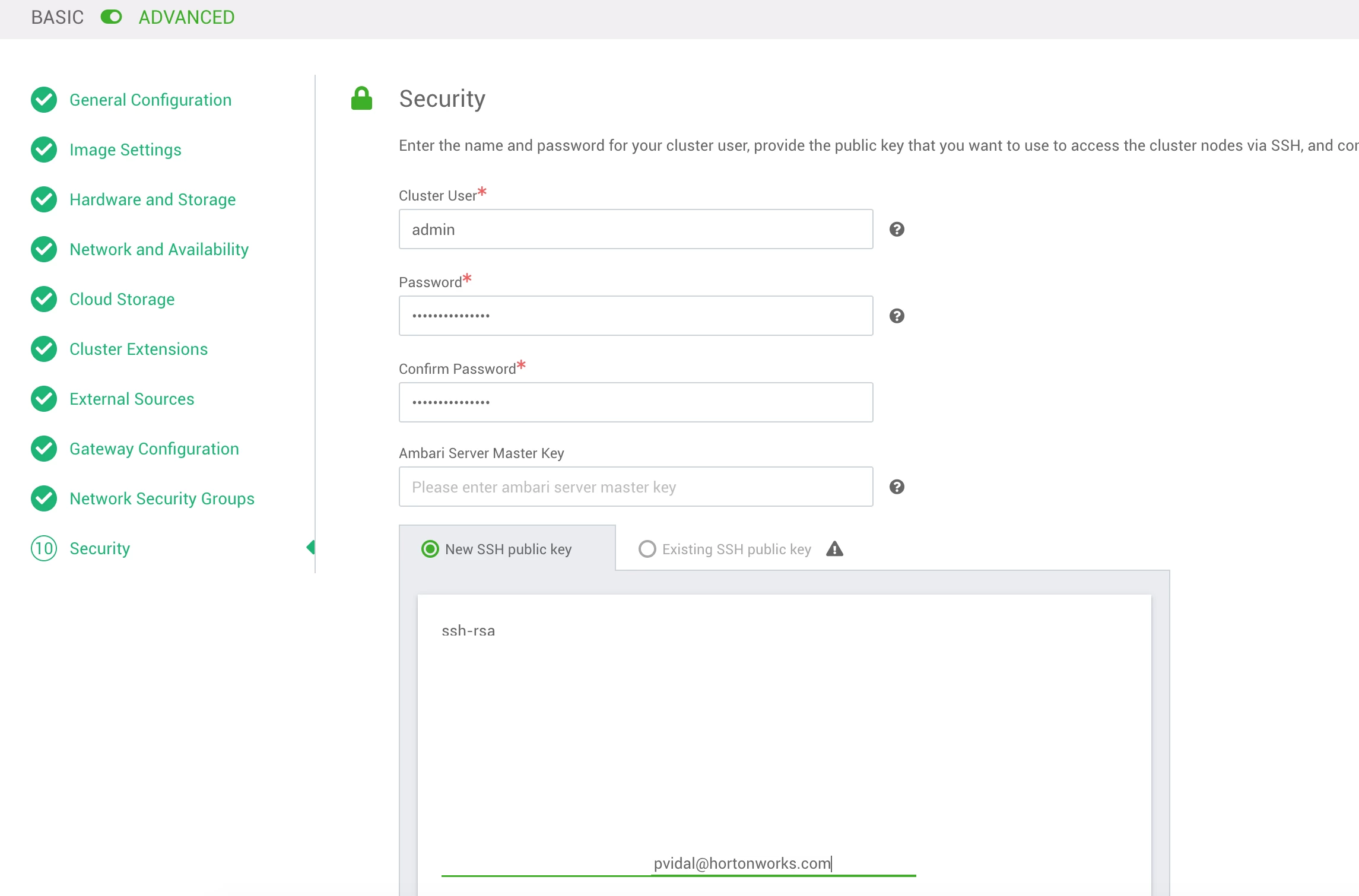

Security

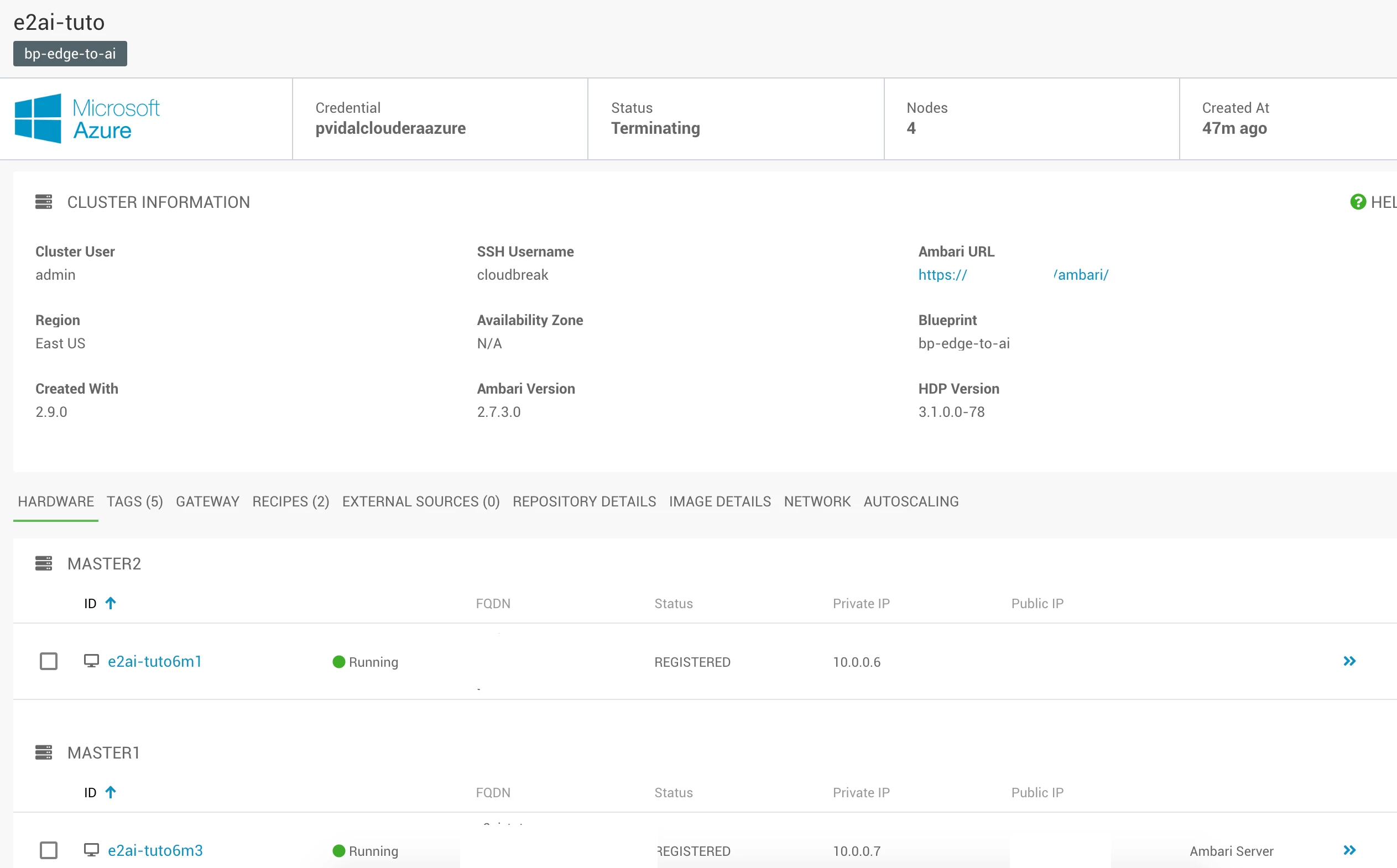

Result
After the cluster created, you should have access to the following screen in Cloudbreak:
You can now access Ambari via the link provided, and CDSW using http://[CDSW_WORKER_PUBLIC_IP].xip.io
