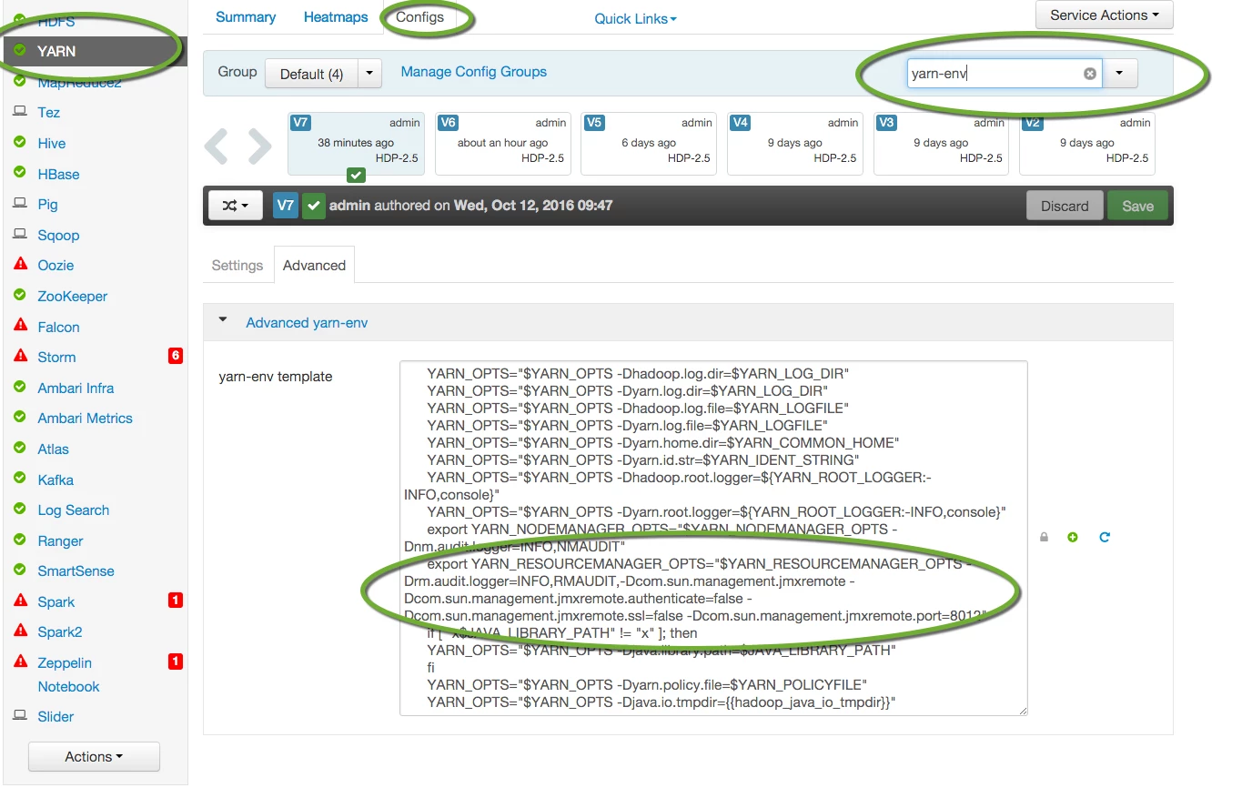

To start pulling jmx metrics from hadoop you need to first enable it via jvm parameters. Go to ambari-->Yarn-->config-->yarn-env
Enable jmx by adding the following params to YARN_RESOURCEMANAGER_OPTS
"-Dcom.sun.management.jmxremote -Dcom.sun.management.jmxremote.authenticate=false -Dcom.sun.management.jmxremote.ssl=false -Dcom.sun.management.jmxremote.port=8001"
Set the port to whatever port is available on your cluster
Save the new config. This will require restart of yarn.

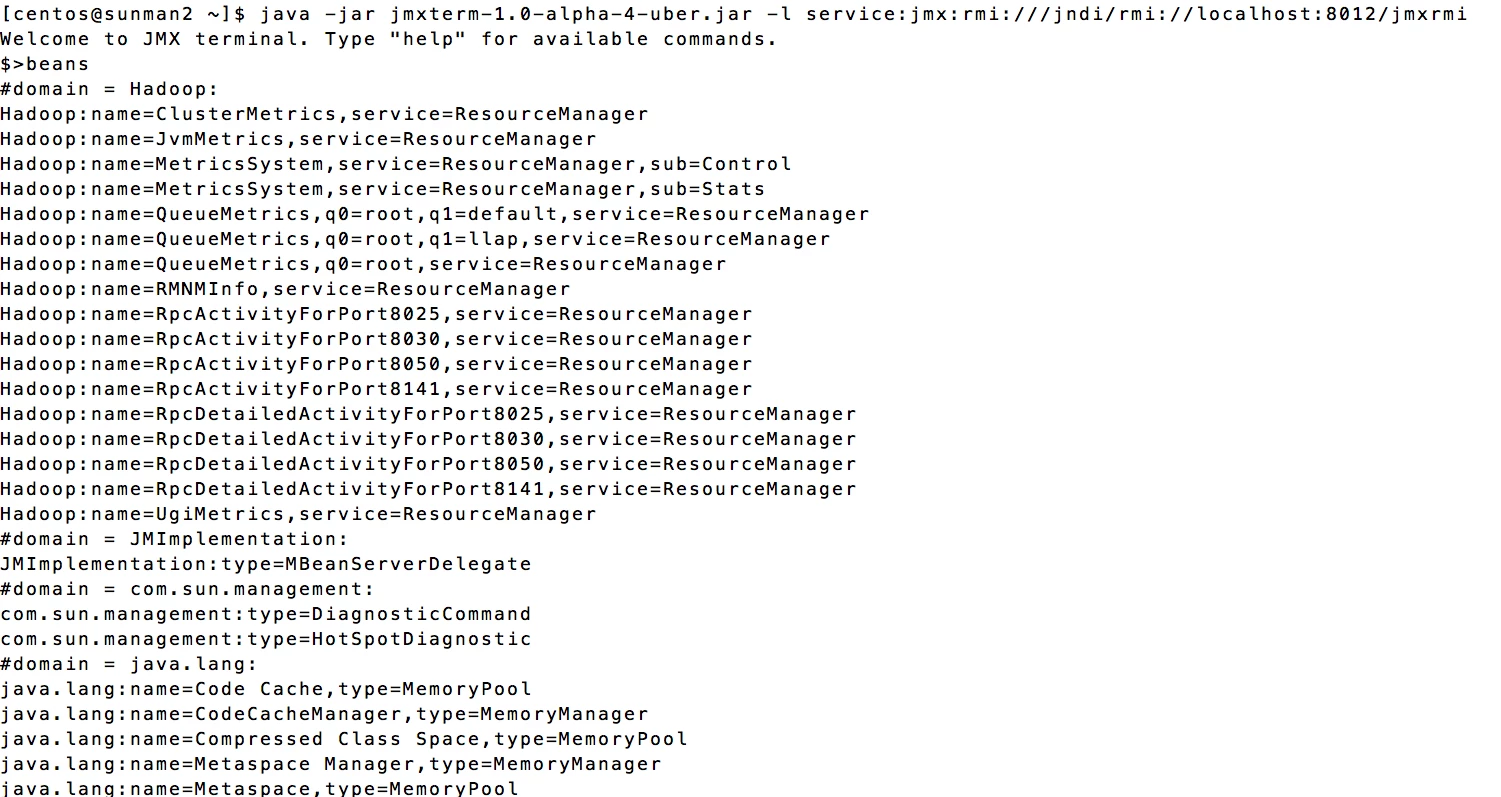

Now I am connected to jxm. Lets look at all the beans available by issuing beans commands

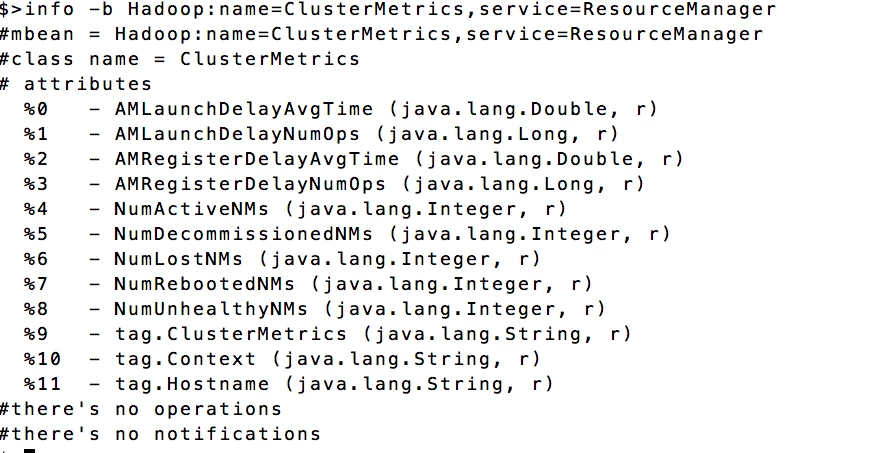

Well now I see all the beans available to pull metrics from. Lets say I want to pull metrics about resourcemanager cluster metrics. That is bean Hadoop:name=ClusterMetrics,service=ResourceManager. Lets find all the attributes available for that beans by issuing info -b Hadoop:name=ClusterMetrics,service=ResourceManager
All the attributes are shown and notice there is a notification attribute. You can use this for notification into your enterprise operational system. To pull metrics for a specific attribute within a bean use
