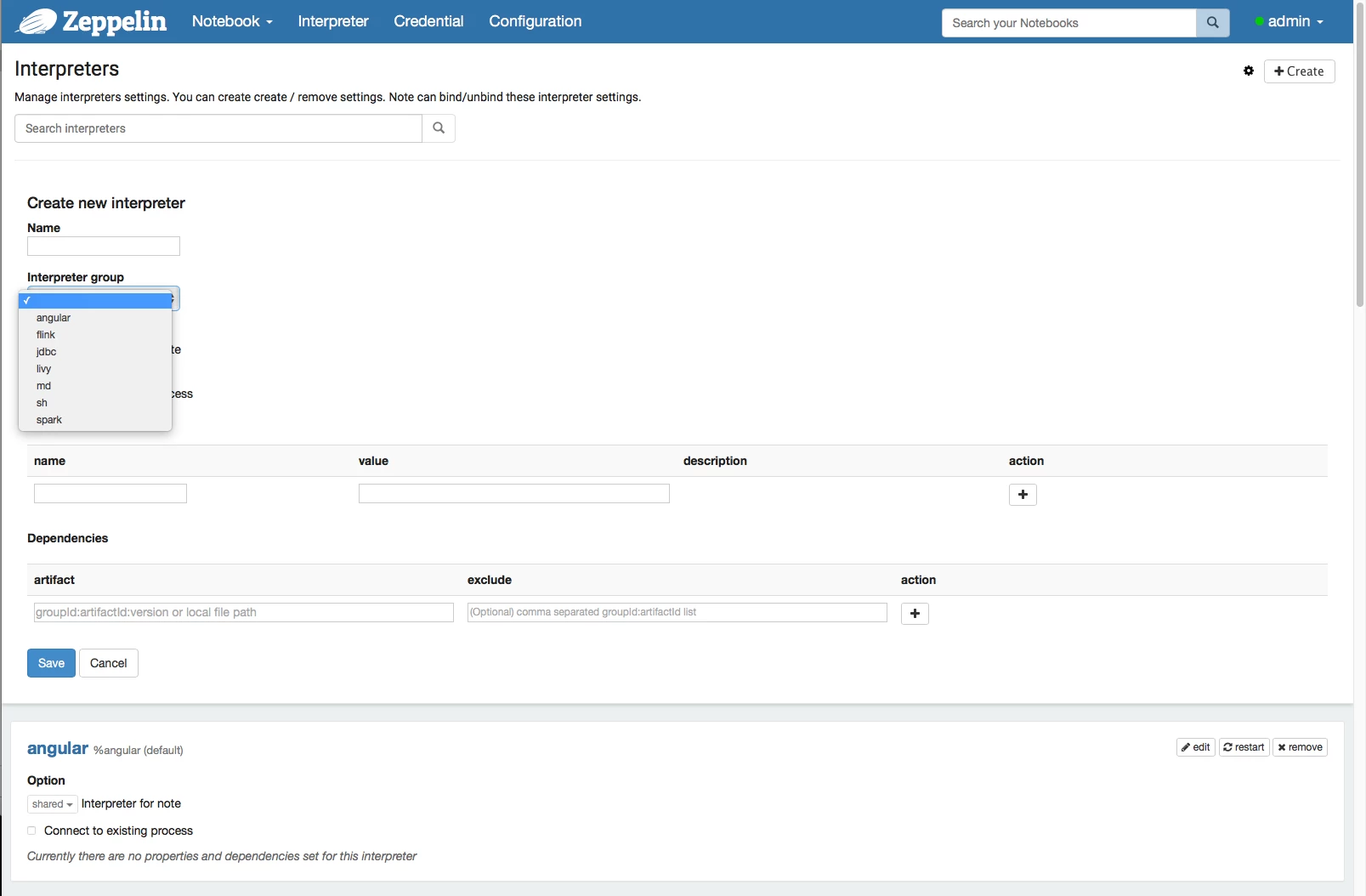

Here is the online documentation for the Elasticsearch interpreter for Zeppelin: Elasticseach Interpreter. If you follow the steps provided in this documentation, you will find that adding the Elasticserch interpreter is not possible as the documentation shows. That is because the interpreter is not enabled.
If you try to add the interpreter, you will see it is not in the list. You should see something similar to:
Verify Elasticsearch Interpreter is available

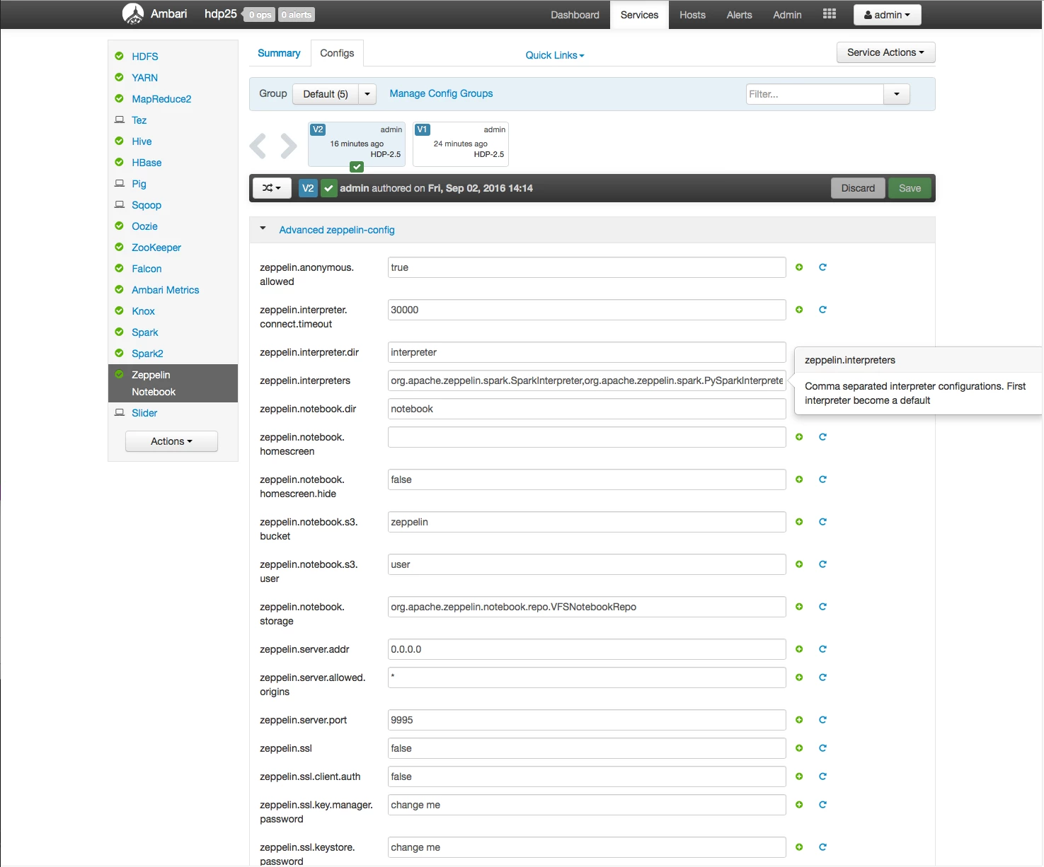

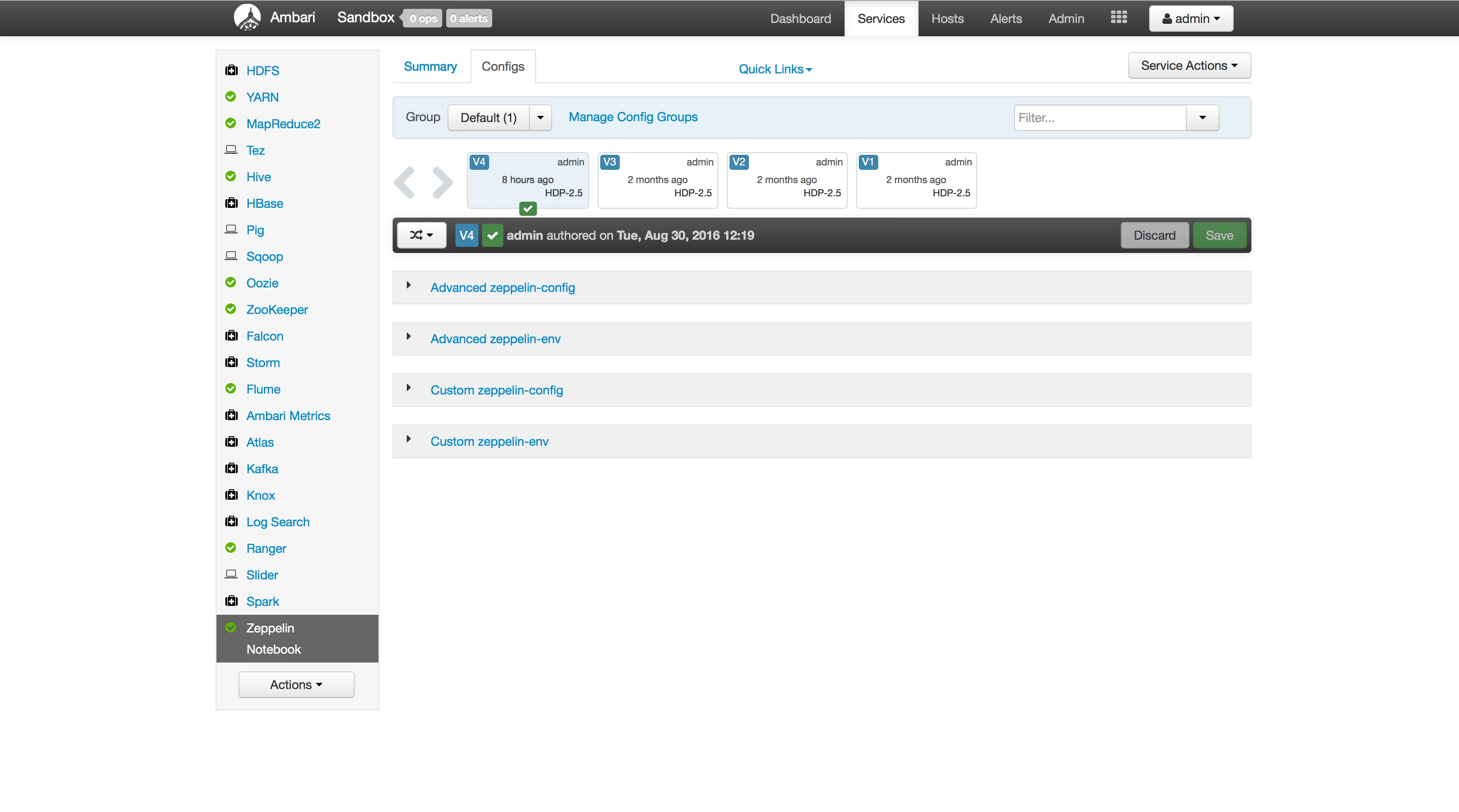

Now we need to add the Elasticsearch interpreter to the Zeppelin configuration, which enables access to it. You need to modify the zeppelin.interpreters parameter.

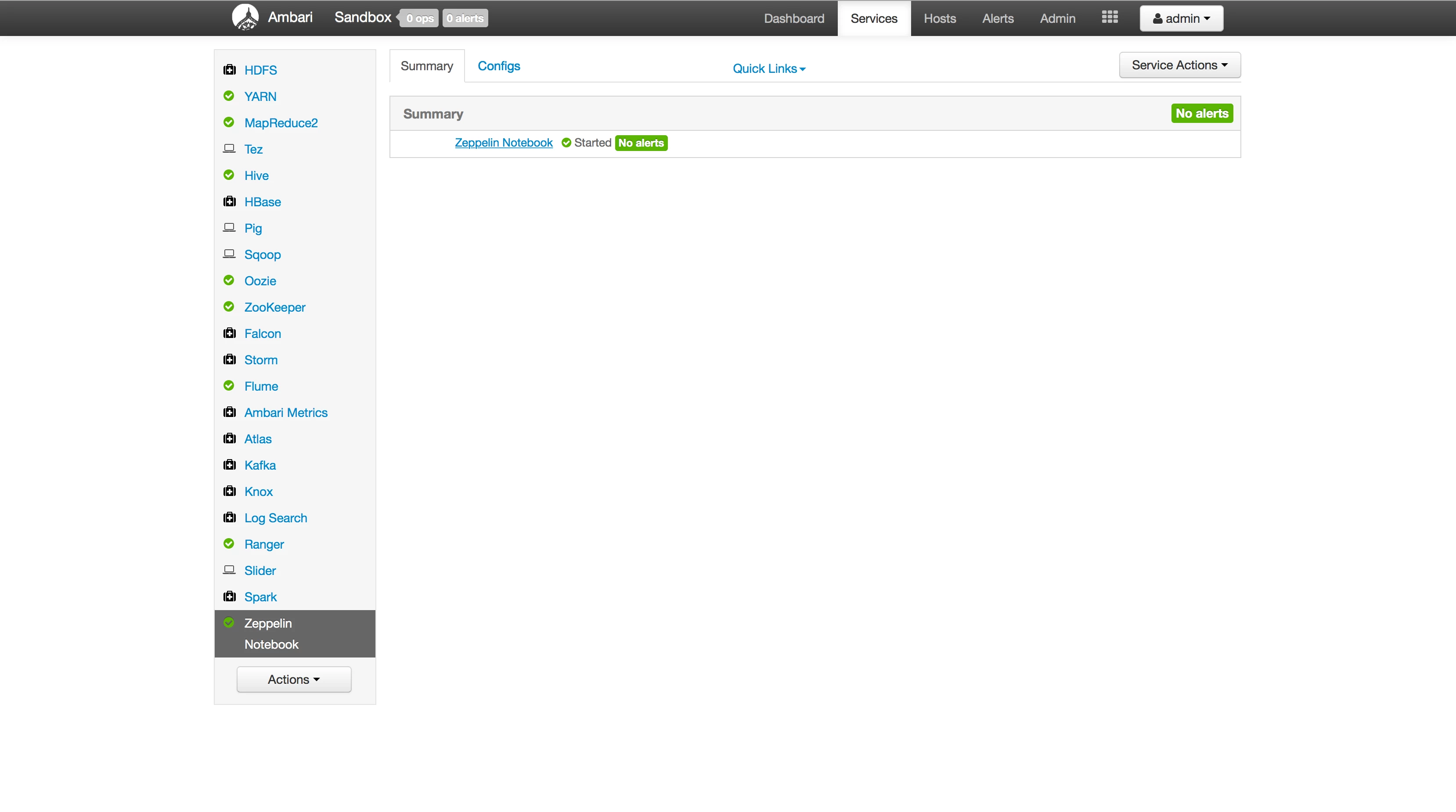

Click on the Zeppelin Notebook service in Ambari:
Now, click on the Configs link:
Expand Advanced zeppelin-config:
Add the following string to the end of the zeppelin.interpreters parameter:
,org.apache.zeppelin.elasticsearch.ElasticsearchInterpreter
Note: The comma is not a typo. It is required to seperate our added value from the previous value.

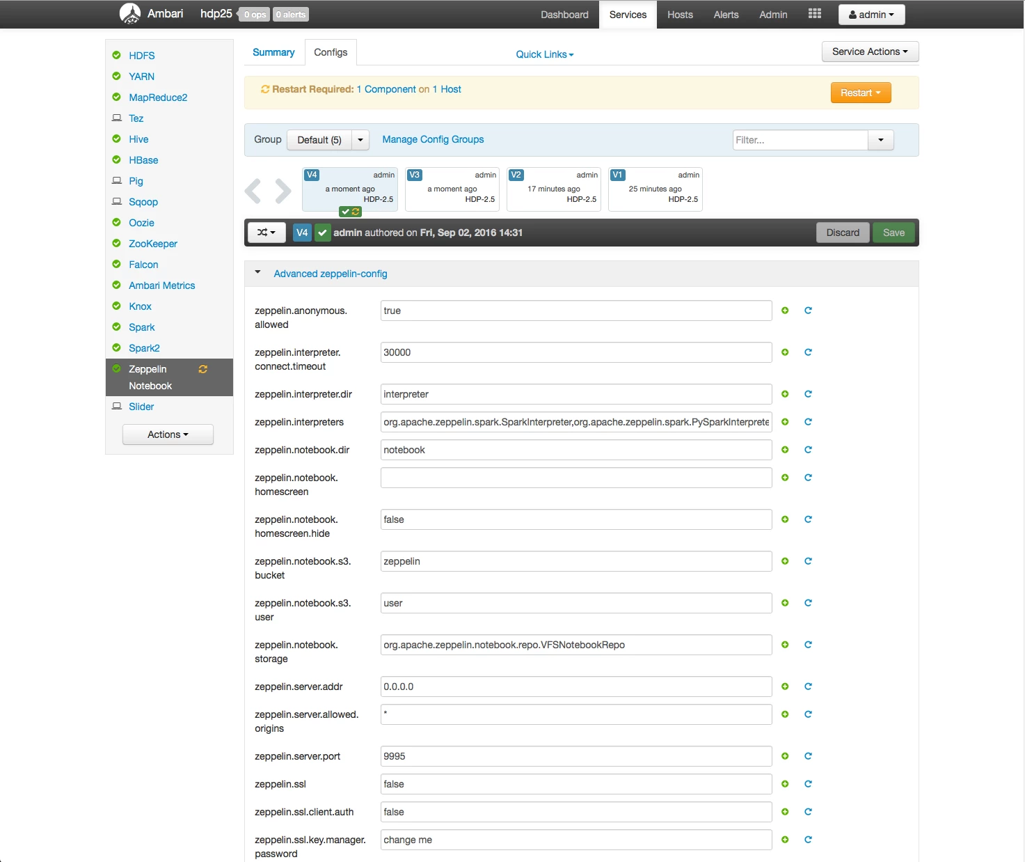

It should look similar to this:
Now click the Save button to save the settings. You should see an indication that you need to restart the Zeppelin service. It should look similar like this:
Restart the Zeppelin Notebook service.

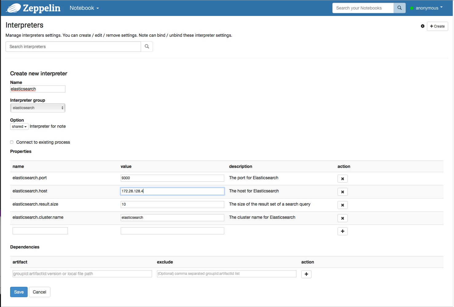

Configure Zeppelin Interpreter
Now you should be able to follow the documentation I linked previously for setting up the Elasticsearch interpreter. You should have something similar to this:
The elasticsearch.host value will correspond to your ip address or sandbox.hortonworks.com if you have edited your local /etc/hosts file.

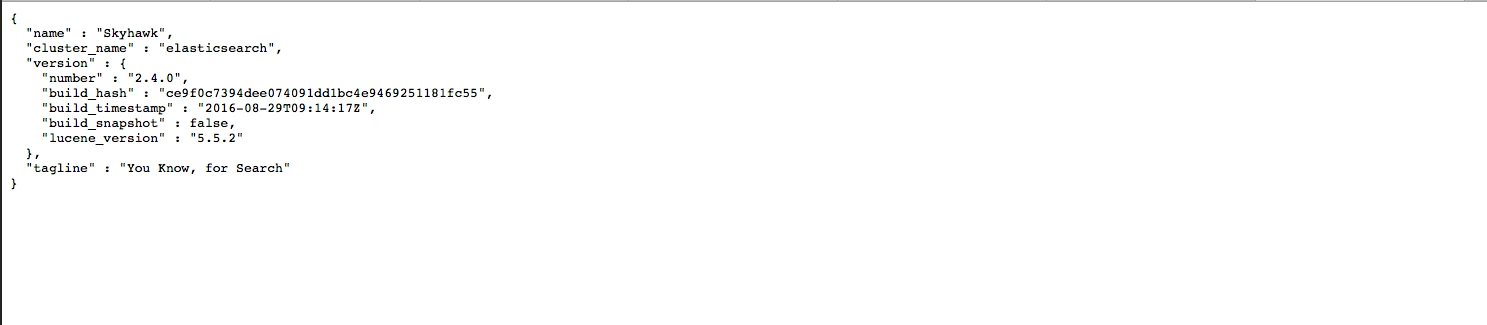

Verify access to Elasticsearch
Using your web browser, verify you get a response from Elasticsearch by using the following address:
http://sandbox.hortonworks.com:9200
Alternatively, you can use curl:
curl -XGET http://sandbox.hortonworks.com:9200
You will see a similar json output message.

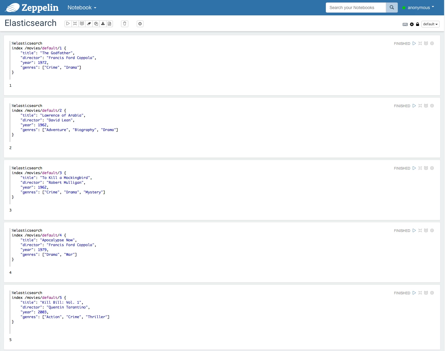

Add data to elasticsearch
Now we are going to create a notebook in Zeppelin. You should have a note for each index operation in the notebook. Let's use the %elasticsearch and the index command to index some data:
%elasticsearch
index movies/default/1 {
"title": "The Godfather",
"director": "Francis Ford Coppola",
"year": 1972,
"genres": ["Crime", "Drama"]
%elasticsearch
index movies/default/2 {
"title": "Lawrence of Arabia",
"director": "David Lean",
"year": 1962,
"genres": ["Adventure", "Biography", "Drama"]
%elasticsearch
index movies/default/3 {
"title": "To Kill a Mockingbird",
"director": "Robert Mulligan",
"year": 1962,
"genres": ["Crime", "Drama", "Mystery"]
%elasticsearch
index movies/default/4 {
"title": "Apocalypse Now",
"year": 1979,
"genres": ["Drama", "War"]
%elasticsearch
index movies/default/5 {
"title": "Kill Bill: Vol. 1",
"director": "Quentin Tarantino",
"year": 2003,
"genres": ["Action", "Crime", "Thriller"]
%elasticsearch
index movies/default/6 {
"title": "The Assassination of Jesse James by the Coward Robert Ford",
"director": "Andrew Dominik",
"year": 2007,
"genres": ["Biography", "Crime", "Drama"]
You should have a notebook that looks similar to this:
For each of the index notes, click the play button to insert the data.
