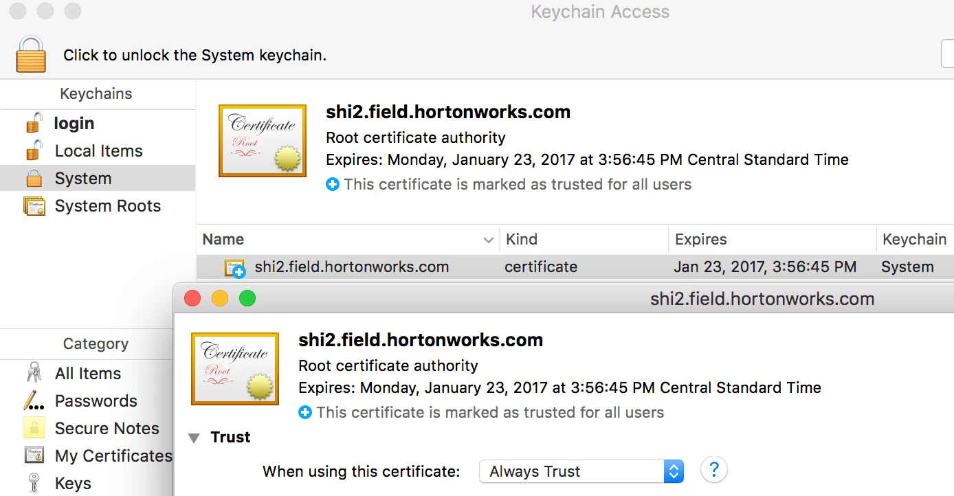

Now we need to ensure that our Chrome browser trusts this self-signed certificate. We need to copy the certificate to our Desktop (click the broken HTTPS link > Details > View Certificate and drag and drop to the desktop).
We can then import the certificate into our OS X keychain and set it as trusted:

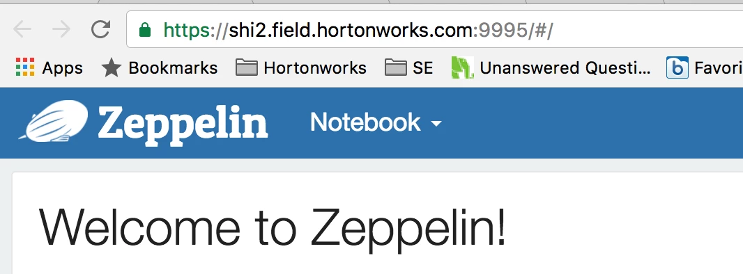

Make sure you restart Chrome. After doing so, you should see the green lock icon next to the HTTPS URL and should no longer see a browser warning,
