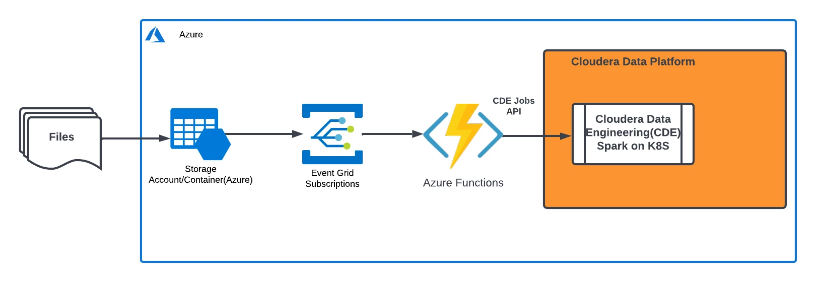

There are a numerous ways of doing event driven architectures in Cloud with Cloudera Data Platform(CDP) but, lately I was working on a use case which required Spark inferences and transformations on streaming log data in Azure cloud environment on a near realtime basis. The use case is to kickoff Spark transformations as soon as the files get landed in the Azure storage container.
                                  The preferred way of doing Spark transformations for Data Engineering use cases in CDP is by leveraging Cloudera Data Engineering(CDE) which runs Spark on Kubernetes. CDE provides much better isolation, job orchestration with help of Airflow, Spark version independence, scales faster, efficiently utilizes the cloud native resources and the best part is that it does dependency management like a rockstar. Just makes your life easy and simple.
                                  CDE exposes Jobs API for integration with your CI/CD platforms. There are multiple patterns to do streaming architectures with CDE such as leveraging:
  • Cloudera Data Flow(Powered by Apache NiFi) to invoke CDE Spark/Airflow jobs using the Jobs API
  • Leverage Azure Cloud native frameworks such as Azure Event Grid to trigger CDE jobs using Azure Functions.
In this article we will discuss the later option on how we can leverage Azure Event Grid and Azure Functions to trigger CDE Jobs. There are many other patterns that Azure Event Grid integrates with natively and everything is possible with this pattern, but for the sake of this article, we will explore how Even grid integrates with an Azure Storage containers to monitor for incoming files and invokes an Azure python functions(serverless) which invokes a Cloudera Data Engineering(CDE) Airflow/PySpark job using CDE Jobs API.

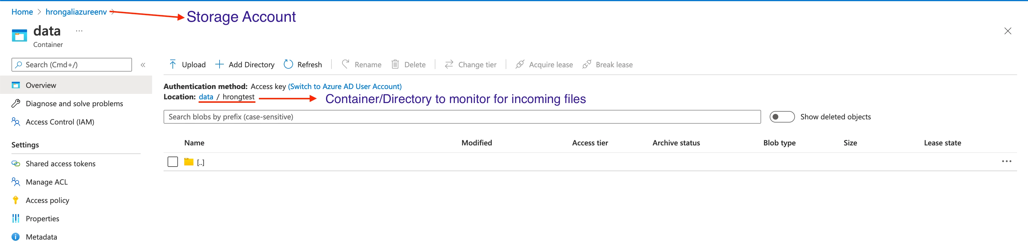

Create a Azure storage container/directory
  1. Create an Azure Storage account and create a container/directory that we want to monitor for incoming files

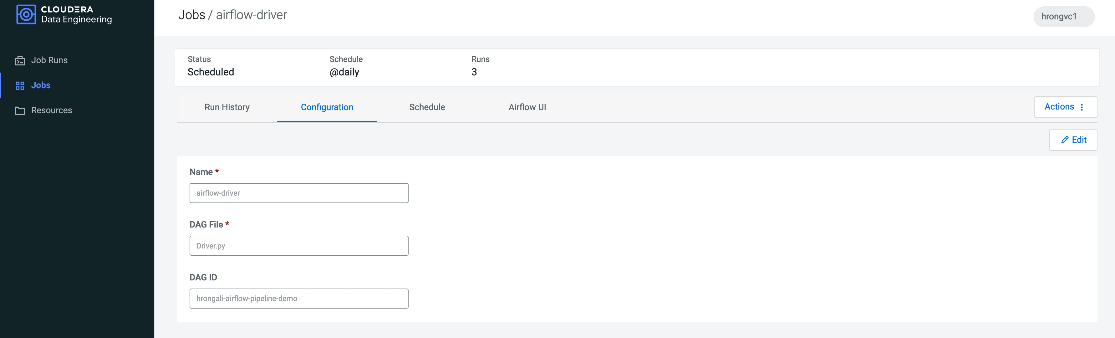

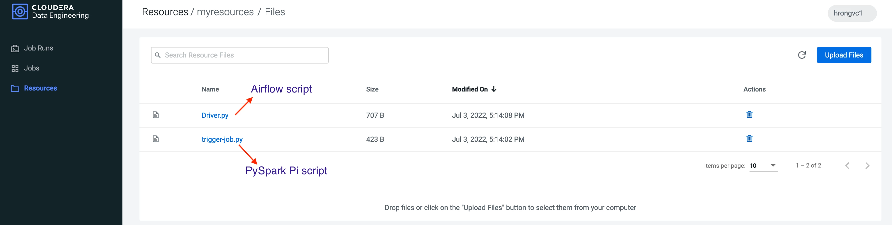

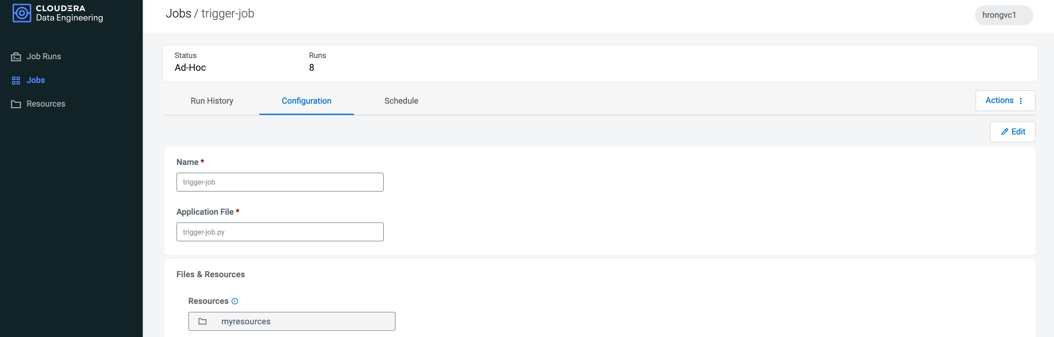

Create CDE components - Resources, Jobs
Create Airflow and/or Spark jobs in CDE following these instructions

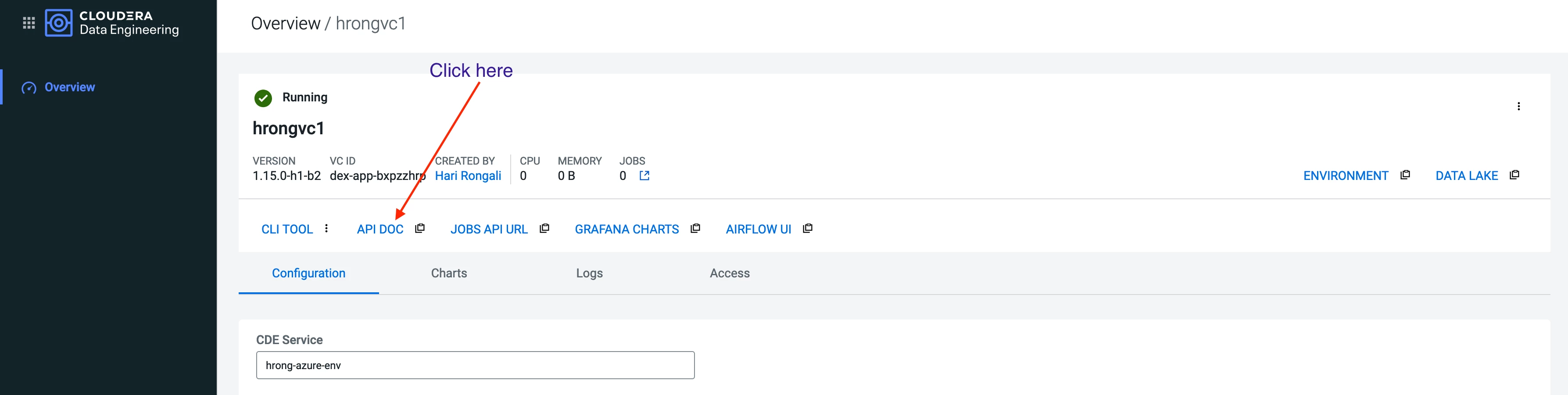

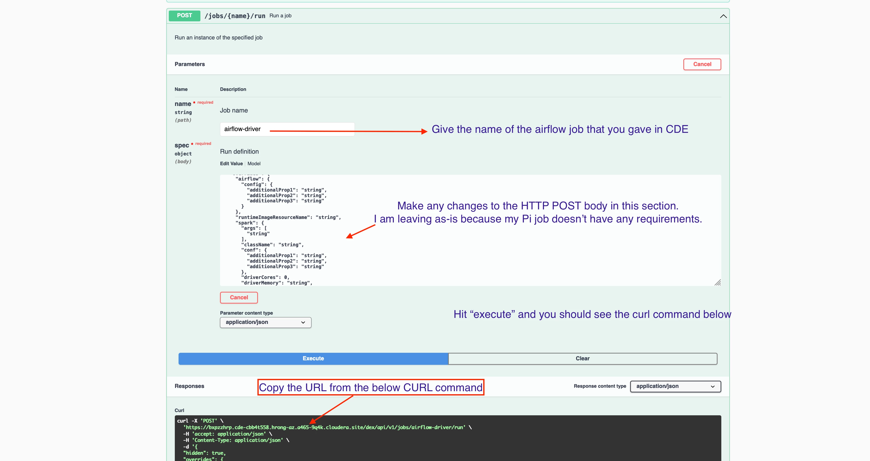

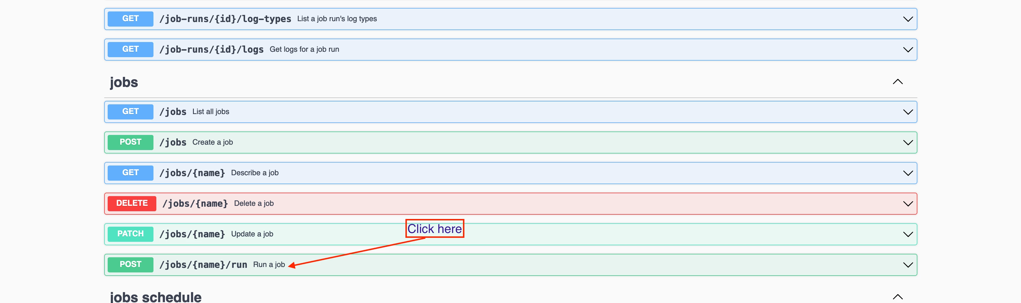

Collect CDE URLs required to trigger Spark/Airflow jobs
Gather the JOBS API URL for the airflow/spark job and token_url for retrieving the AUTH token
  • JOBS API URL:

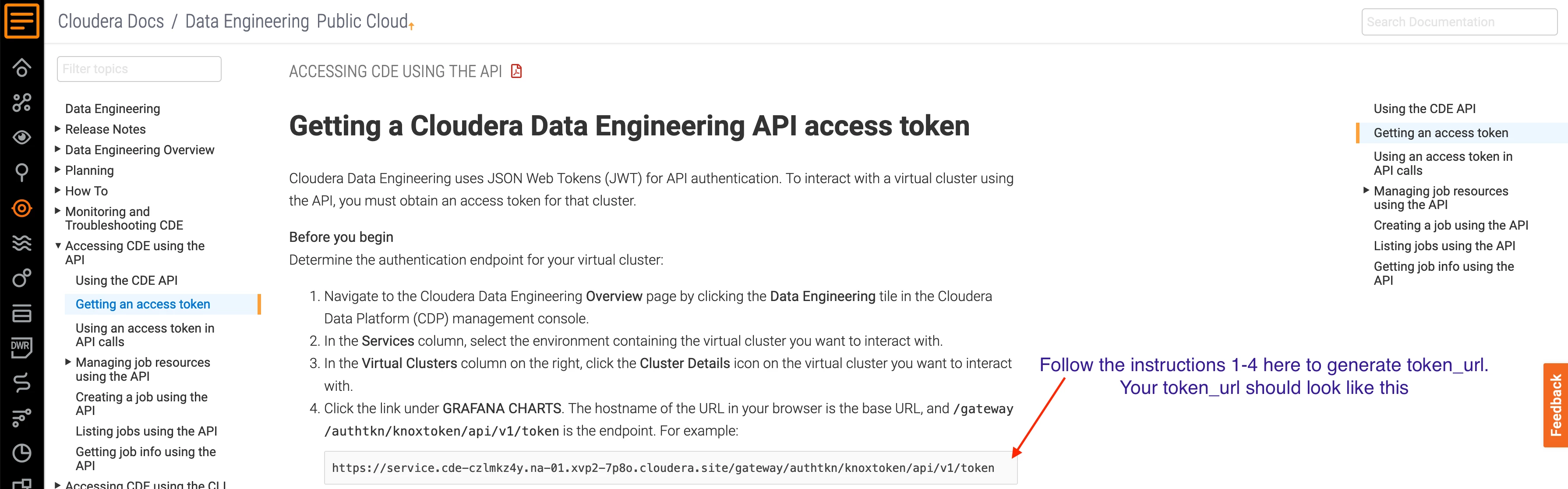

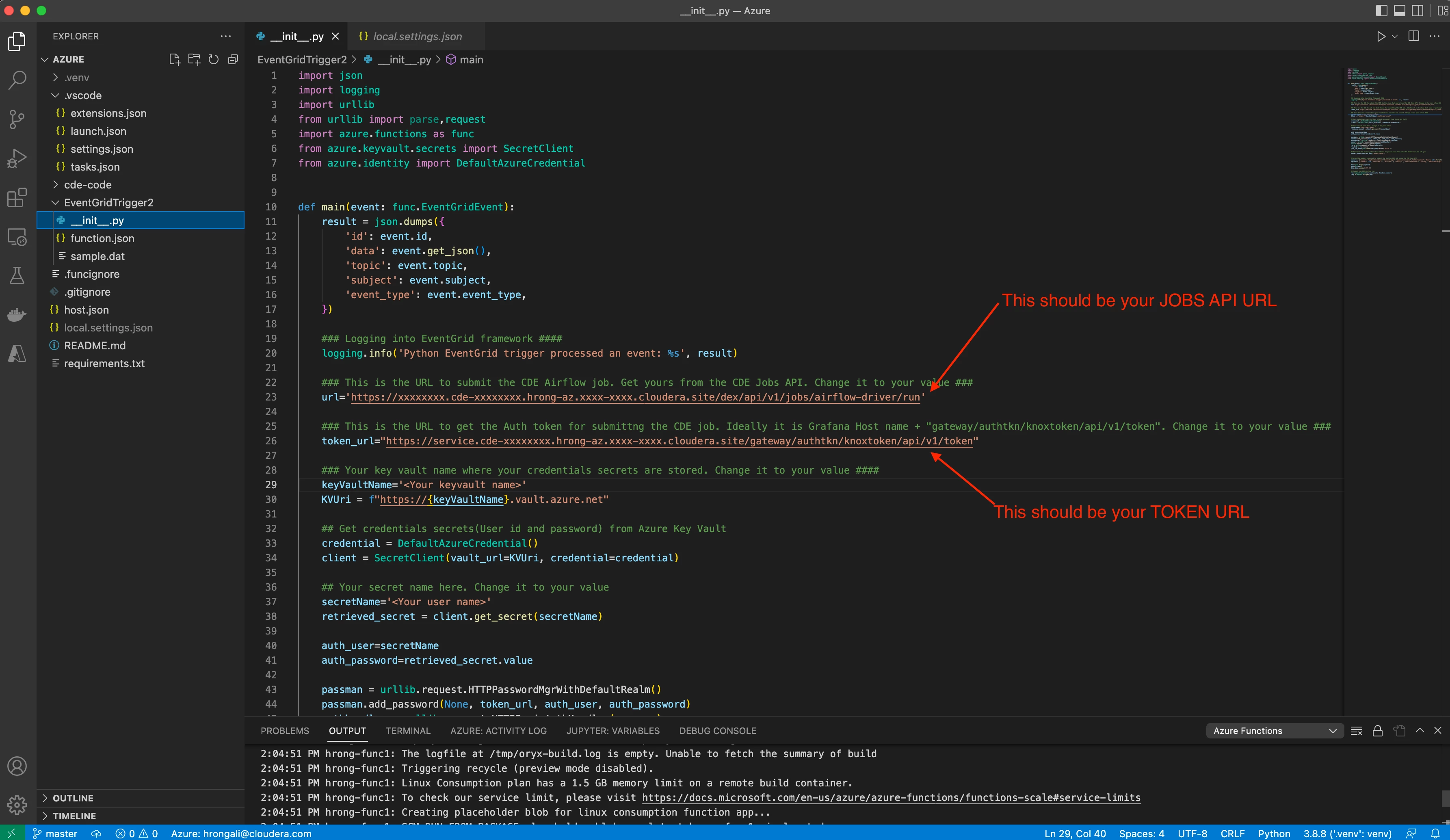

Get the TOKEN URL for extracting the AUTH token for authentication purposes

    2. Configure a local Azure functions development environment with something such as Visual Studio code with Azure plugins installed. Choose "Azure Event Grid Trigger" template in Step#4 of the document instructions.
    3. Example Azure Event Grid function can be found here. Make changes to the function according to your environment.

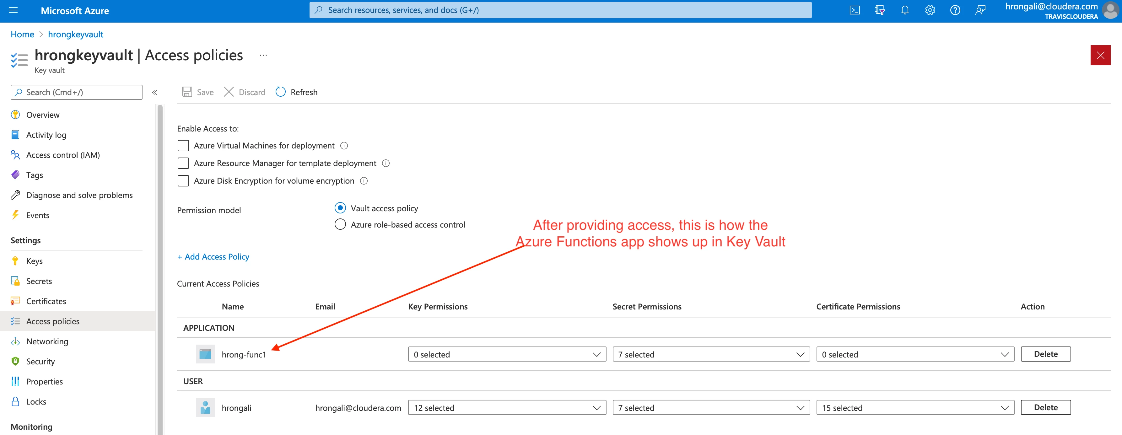

Create Azure key vault and provide access to Azure python function
  1. Cloudera Data Engineering uses JSON Web Tokens (JWT) for API authentication and you may need user id and password to get the token. Obtaining the token programmatically is covered in the Azure function code itself, but you might have to store the user id and password in a secure location within Azure such as Azure Key Vault by creating a secret.
    • Provide access to Azure function to the Azure Key Vault by adding an "Access Policy". I followed this blog to make this integration work.

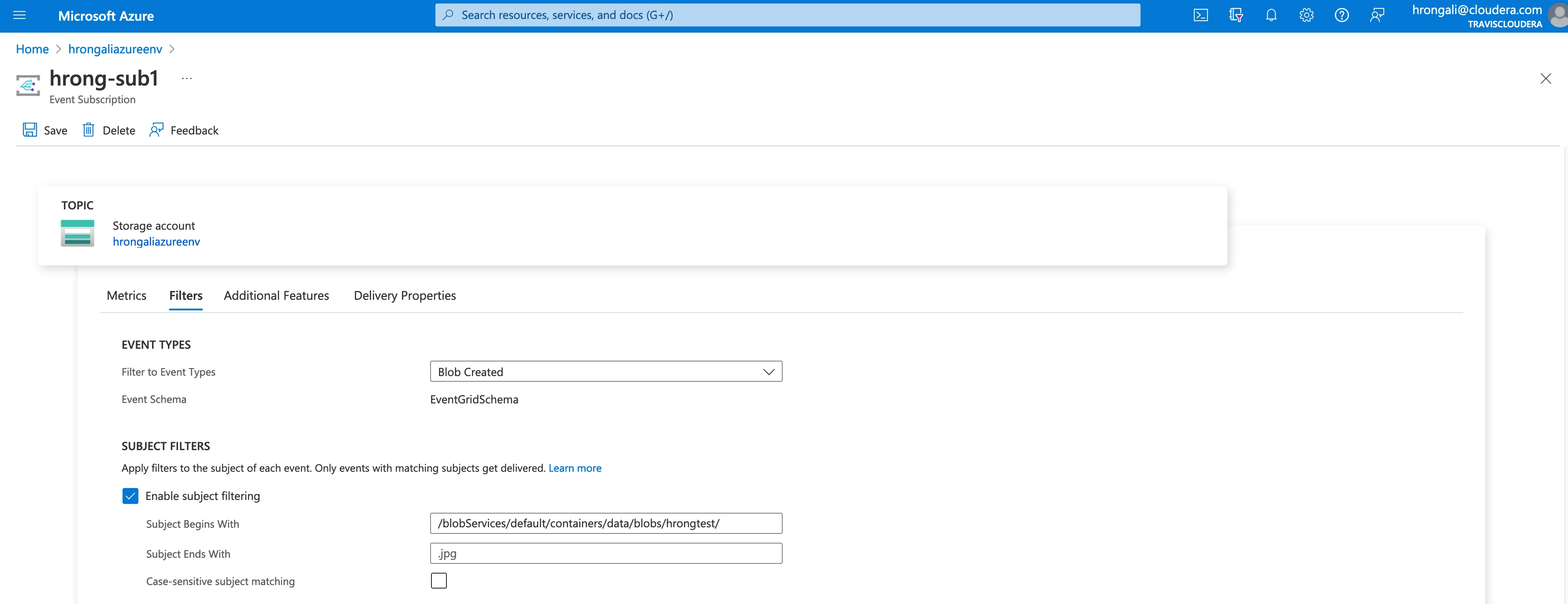

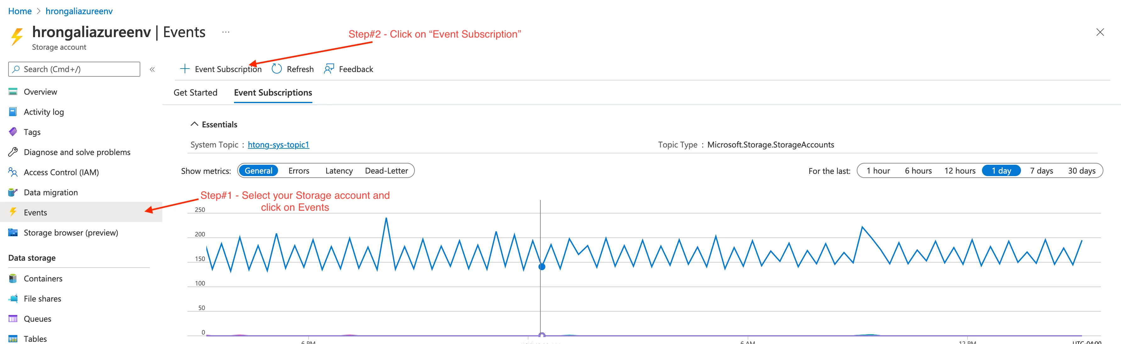

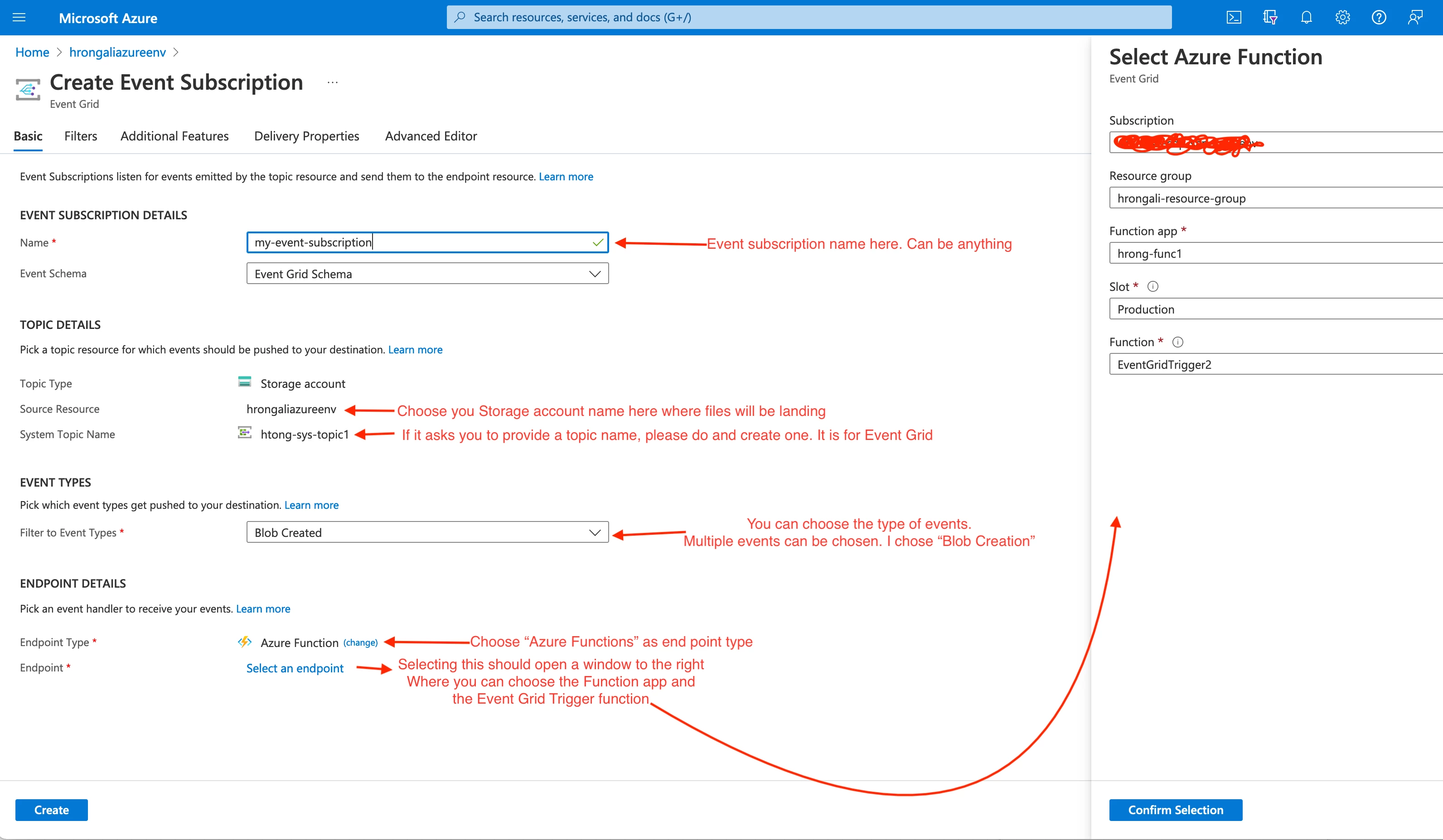

Create Event Grid subscription on storage account and configure filter to the directory to be monitored
  1. Create Event Grid Subscription on the Storage Account and configure a filter to monitor only the required container/directory -- This is very important, otherwise you will end up with function triggers for every storage container activity(Be careful and test your filter thoroughly)
    2.
    3. Choose the correct filter for the container/directory, you want to monitor. On the same page, click on the "Filters" tab and enable "Enable Subject Filtering" checkbox. In my case, I wanted to monitor hrongaliazureenv/data/hrongtest where hrongaliazureenv==My storage account, data==My Container inside my storage account and hrongtest==a directory inside my "data" container. My equivalent filter is:
/blobServices/default/containers/data/blobs/hrongtest/​

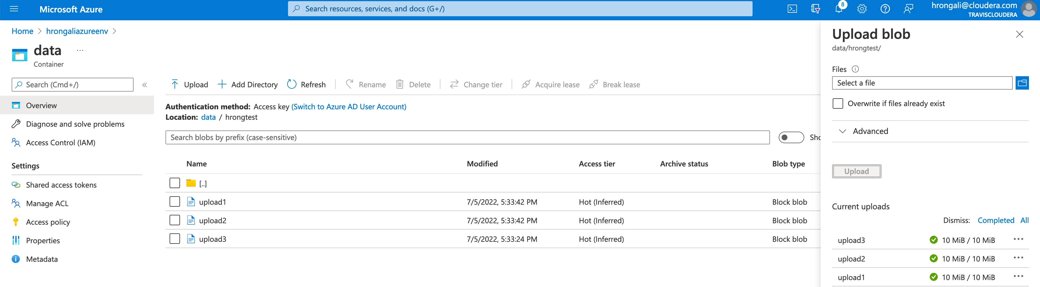

Start running the event driven pipeline with Event Grid/Azure functions and CDE

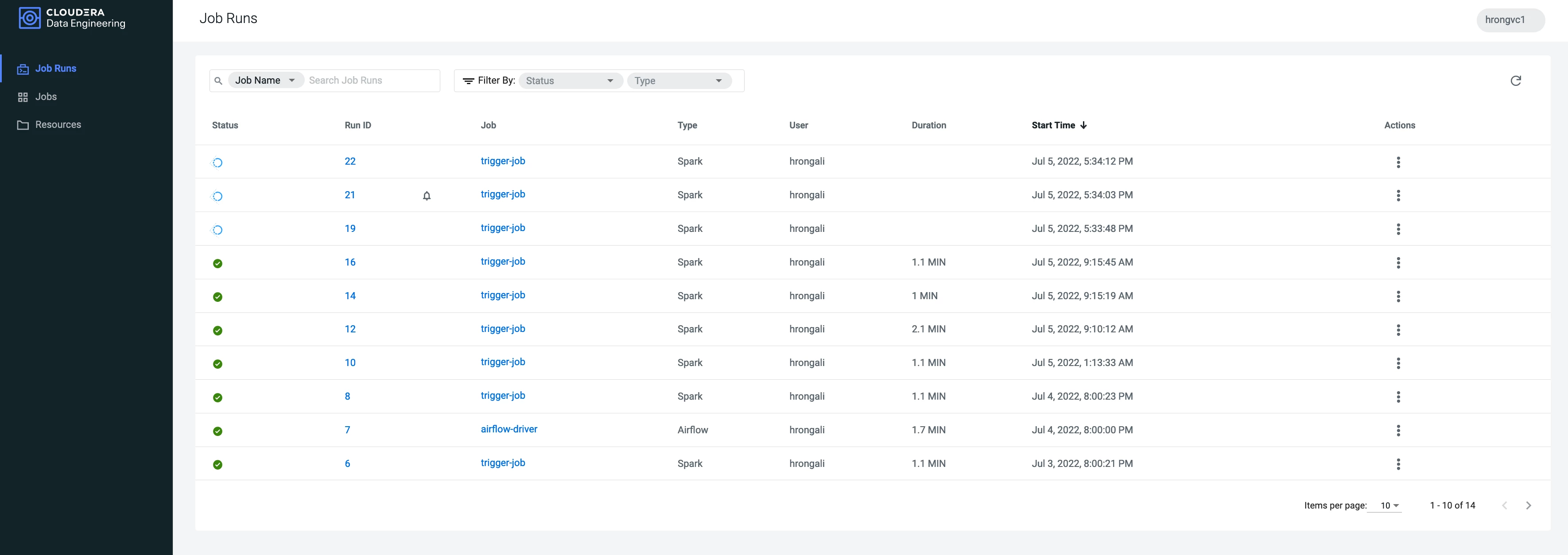

  1. Start uploading the blobs into the hrongtest directory in your storage account and you should see CDE Spark jobs running in CDE
    1. In this case, I have uploaded 3 blobs upload1, upload2 and upload3
    2.  You should see logs from the Azure functions monitoring tab for each function invocations:
      1. From Azure functions --> Monitoring
    3. You should also see the Azure functions triggering CDE Jobs from CDE console
