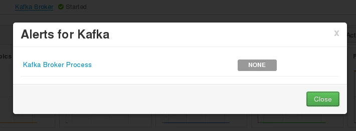

  2. Make sure the default_port is an INTEGER when you upload. This is tricky because if you keep the decimal (ex. 6667.0), you won't get an error response, but if you look at /var/log/ambari-server/ambari-server.log, you'll get a number format exception. What's even more tricky is that ambari will start ignoring these metrics all together and you'll end up with this:
