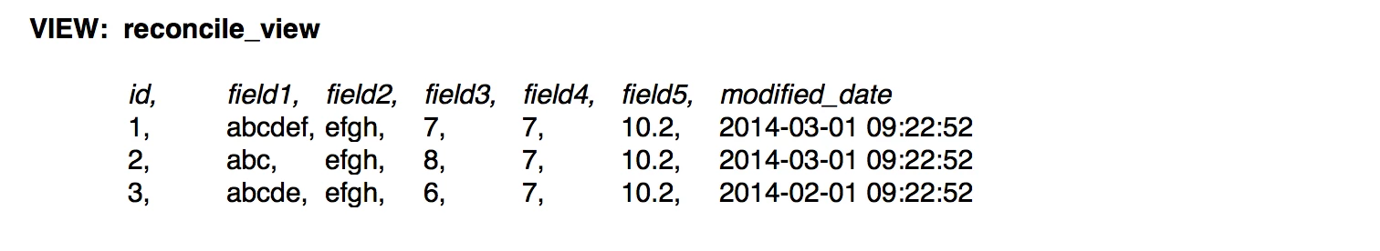

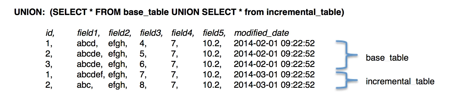

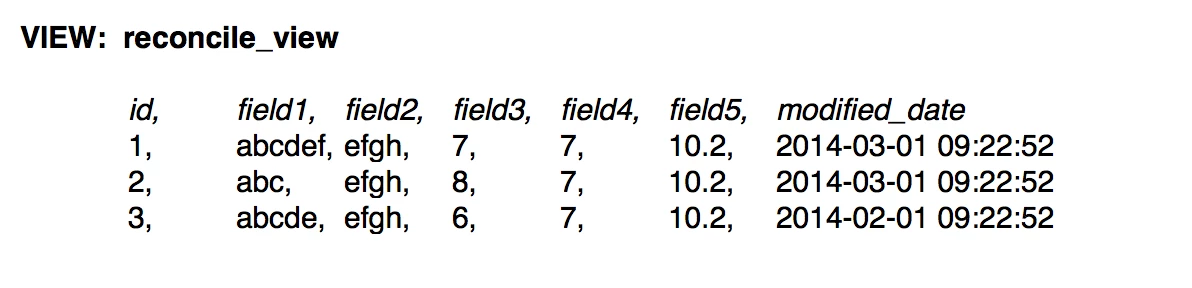

Example:
The sample data below represents the UNION of both the base_table and incremental_table. Note, there are new updates for “id” values 1 and 2, which are found as the last two records in the table. The record for “id” 3 remains unchanged.
The reconcile_view should only show one record for each unique “id”, based on the latest “modified_date” field value.
The resulting query from “select * from reconcile_view” shows only three records, based on both unique “id” and “modified_date”
