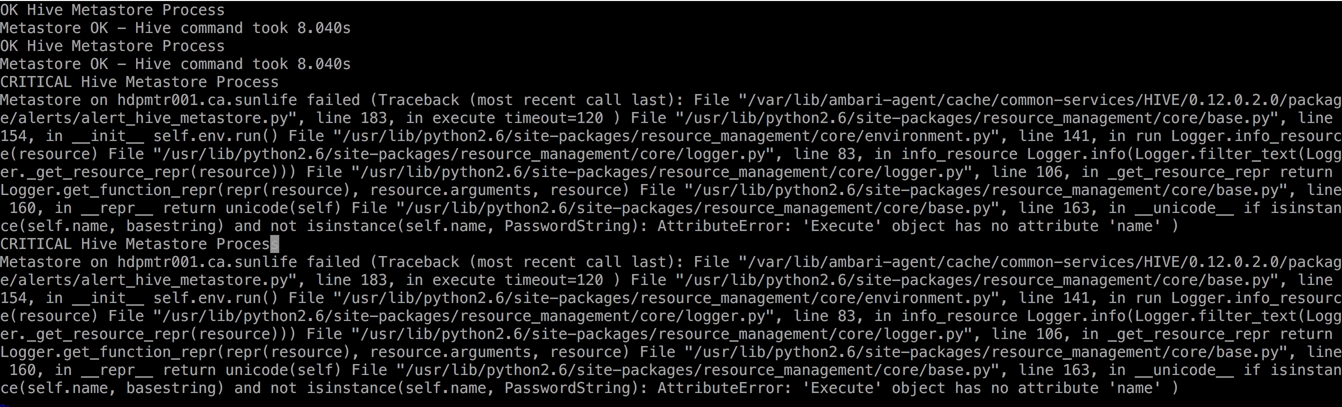

PROBLEM STATEMENT: There are frequent email alerts from HiveServer2 Metastore process which are misleading. When check the HiveServer2 Metastore process is up and running fine without issue.
ERROR: Below is sample email alert -

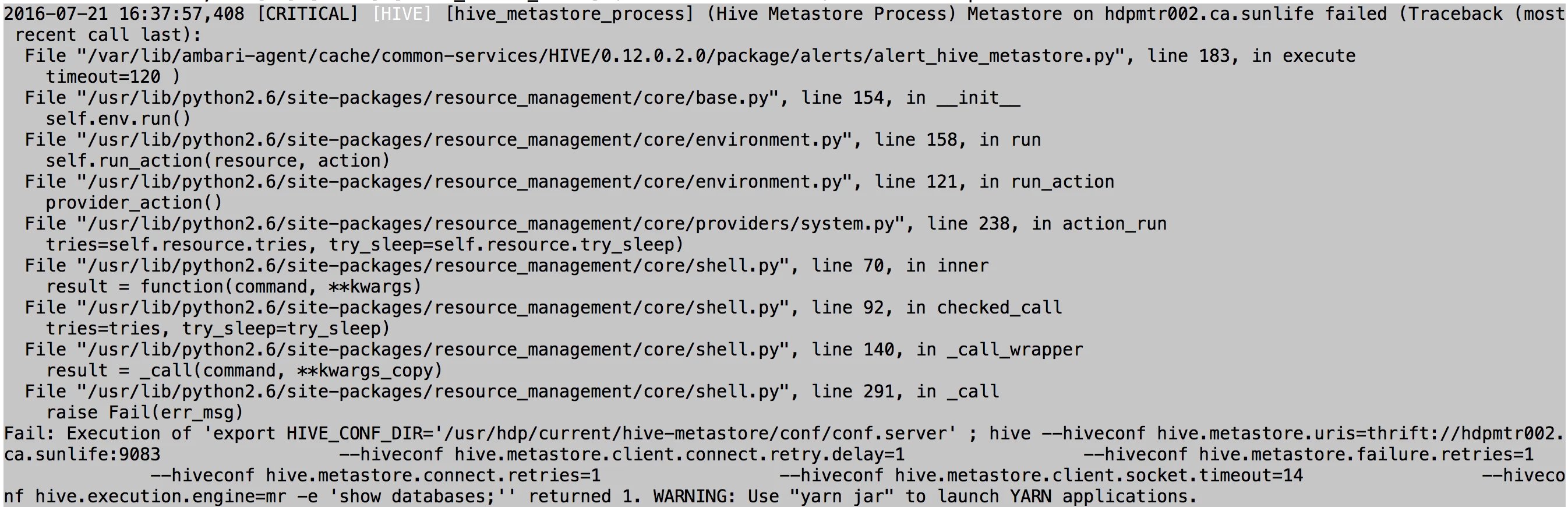

Ambari Alerts log output shows -
/var/log/ambari-server/ambari-alerts.log
