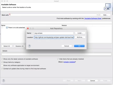

First thing we need to do is go to Help > Install New Software, give the plugin a name and enter URL http://github.com/eyala/pig-eclipse-update-site/raw/master

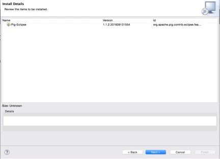

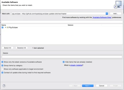

Select the Pig-Eclipse plugin and hit Next
Eclipse will fetch the bits

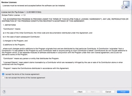

Accept the EULA and hit Finish

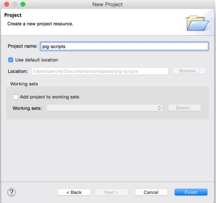

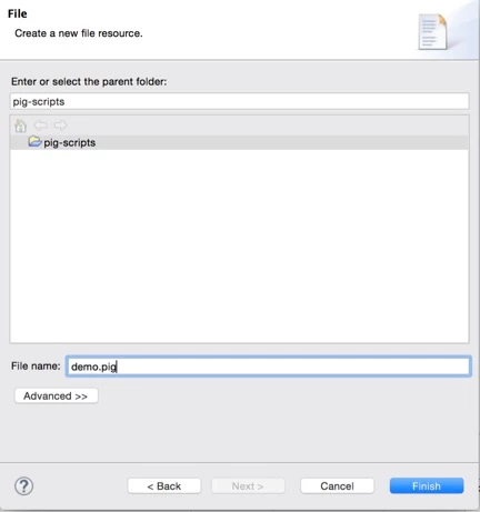

At this point we can create a new project in a typical Eclipse fashion and start writing Pig scripts
Saving Pig scripts with .pig extension identifies them automatically, you can change the behavior in preferences section

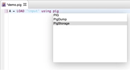

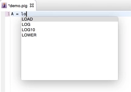

Let's see code completion, you invoke it with ctrl+space

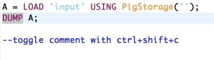

You can toggle comment with ctrl+shft+c

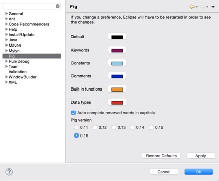

and you can change preferences for theme and colors as well as behavior based on Pig version
