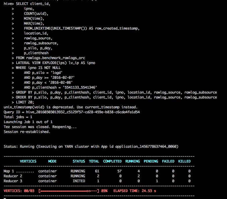

1. First Execution of Query
Here we can see 61 Mappers were created, which is determined by the group splits and if not grouped, most likely corresponding to number of files or split sizes in the Orc table. For a discussion on the number of mappers determined by Tez see How are Mappers Determined For a Query and How initial task parallelism works
The mappers complete quickly but the the execution is stuck on 89% for a long time.
We observe that there are three vertices in this run, one Mapper stage and two reducer stages.
The first reducer stage ONLY has two reducers that have been running forever? hmmmm...
Query finally completed in 60 secs.
What gives? Why only 2 Reducers?

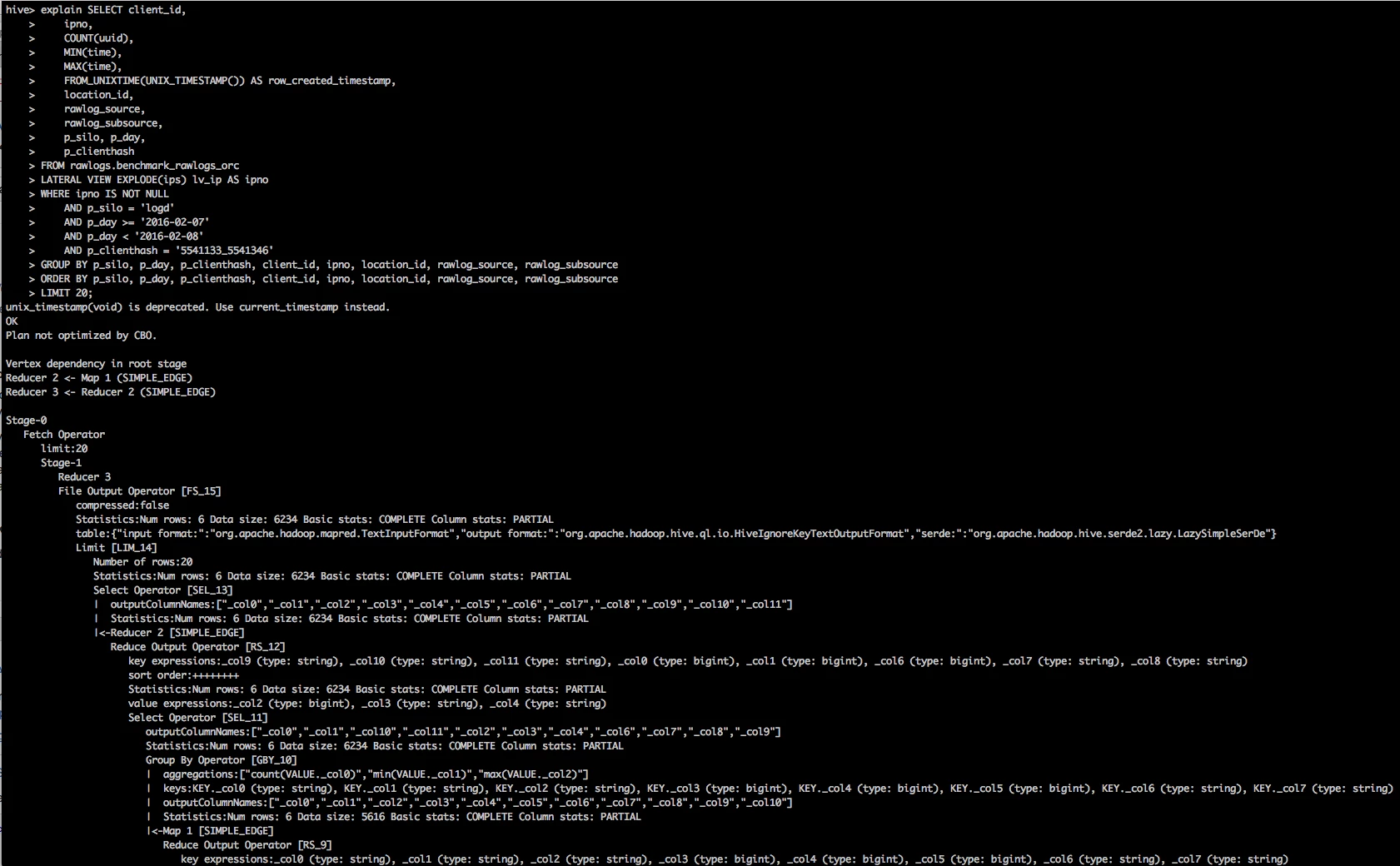

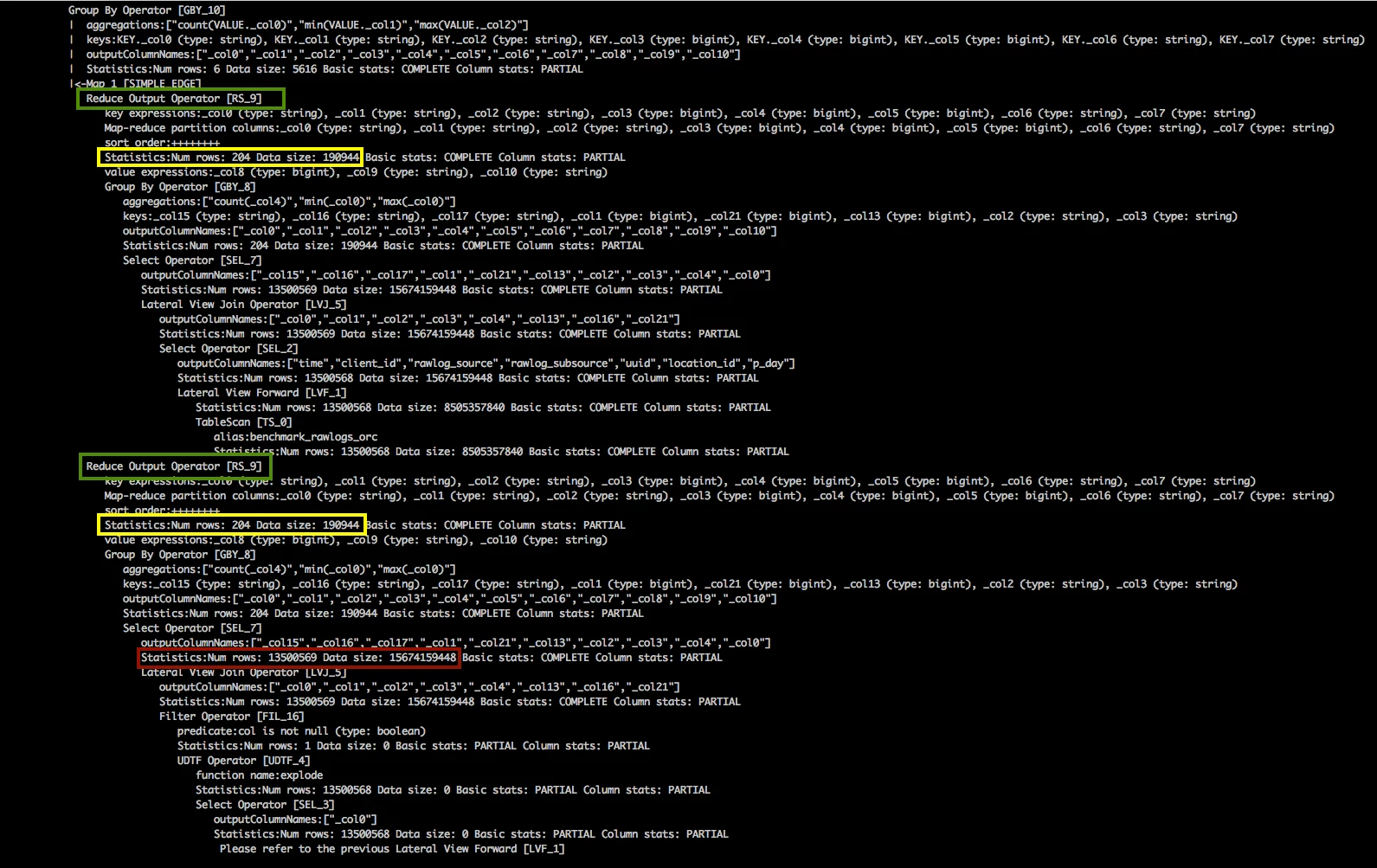

Let's look at the Explain plan.

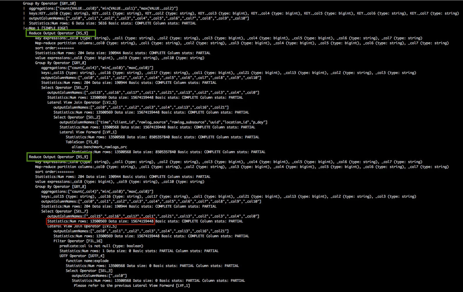

2. The LONGGGGGG Explain Plan
Let's look at the relevant portions of this explain plan. We see in Red that in the Reducers stage, 14.5 TB of data, across 13 million rows are processed. This is a lot of data to funnel through just two reducers.
The final output of the reducers is just 190944 bytes (in yellow), after initial group bys of count, min and max.
We need to increase the number of reducers.

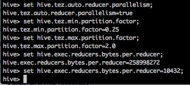

- How to Properly Set Number of Reducers
First we double check if auto reducer parallelism is on. The parameter is hive.tez.auto.reducer.parallelism
See
https://cwiki.apache.org/confluence/display/Hive/Configuration+Properties#ConfigurationProperties-hive.tez.auto.reducer.parallelism
It is set to true.
#Turn on Tez' auto reducer parallelism feature. When enabled, Hive will still estimate data sizes and set parallelism estimates. Tez will sample source vertices' output sizes and adjust the estimates at runtime as necessary.
> set hive.tez.auto.reducer.parallelism;
> set hive.tez.auto.reducer.parallelism = true;
This is the first property that determines the initial number of reducers once Tez starts the query.

The third property is hive.exec.reducers.max which determines the maximum number of reducers. By default it is 1099.
The final parameter that determines the initial number of reducers is hive.exec.reducers.bytes.per.reducer
By default hive.exec.reducers.bytes.per.reducer is set to 256MB, specifically 258998272 bytes.

So in our example since the RS output is 190944 bytes, the number of reducers will be:
> Max(1, Min(1099, 190944/258998272)) x 2
> Max (1, Min(1099, 0.00073)) x 2 = 1 x 2 = 2
Hence the 2 Reducers we initially observe.

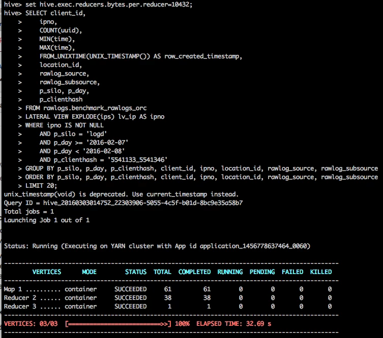

4. Increasing Number of Reducers, the Proper Way
Let's set hive.exec.reducers.bytes.per.reducer to 10 MB about 10432
The new number of reducers count is
> Max(1, Min(1099, 190944/10432)) x 2
> Max (1, Min(1099, 18.3)) x 2 = 19 (rounded up) x 2 = 38
Query takes 32.69 seconds now, an improvement.

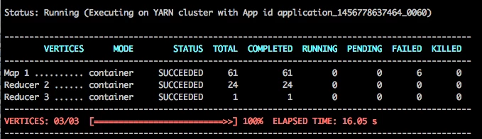

5. More reducers does not always mean Better performance
Let's set hive.exec.reducers.bytes.per.reducer to 15.5 MB about 15872
> Max(1, Min(1099, 190944/15360)) x 2
> Max (1, Min(1099, 12)) x 2 = 12 x 2 = 24
Performance is BETTER with 24 reducers than with 38 reducers.

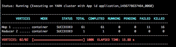

7. Reducing number of Reducer Stages
Since we have BOTH a Group By and an Order by in our query, looking at the explain plan, perhaps we can combine that into one reducer stage.
The parameter for this is hive.optimize.reducededuplication.min.reducer which by default is 4.
Setting this to 1, when we execute the query we get
Performance is BETTER with ONE reducer stage at 15.88 s.
NOTE: Because we also had a LIMIT 20 in the statement, this worked also. When LIMIT was removed, we have to resort to estimated the right number of reducers instead to get better performance.
