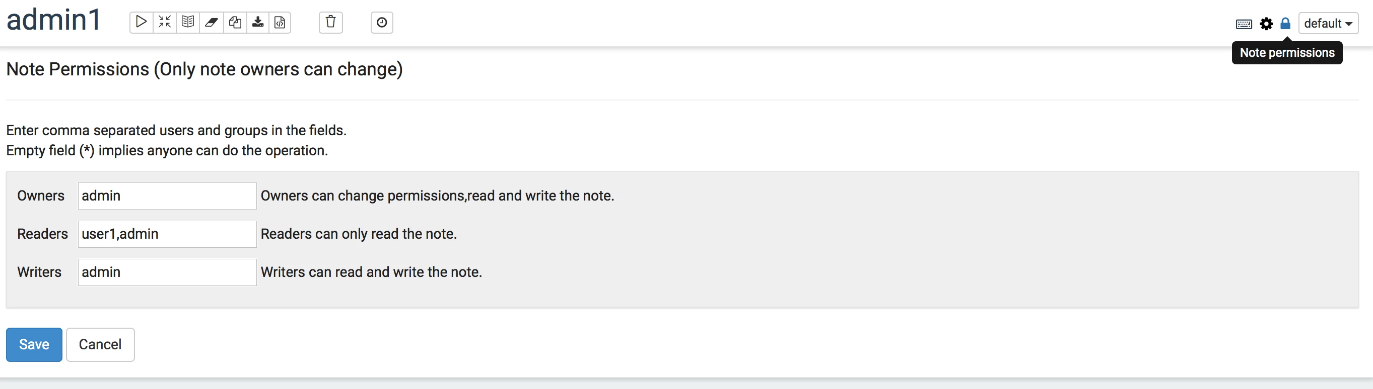

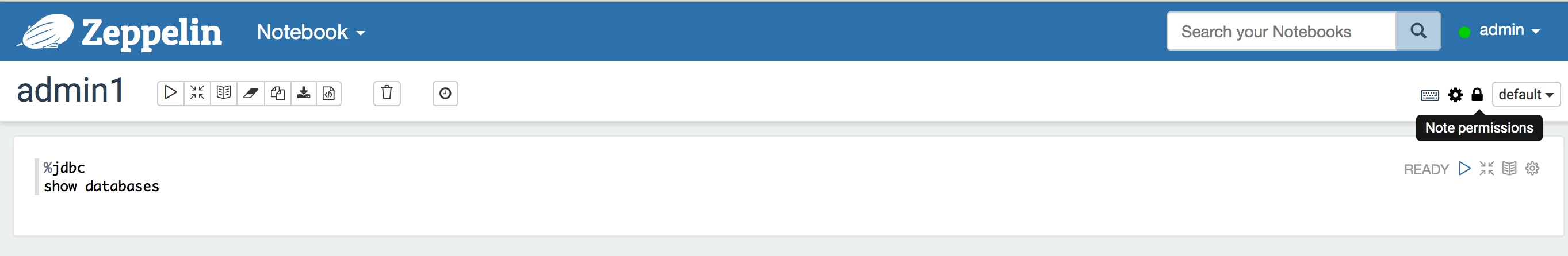

Permissions are available under existing notebook -> padlock button
There are three different permissions:
  • Owners – this is the owner(s) of the notebook. This permissions allows owners to give further - read/write - permission to that notebook
  • Readers – these users can only read scripts created in the section of that notebook. They can neither execute nor edit the scripts - see below
  • Writers – these users can edit the scripts in notebook. With that permissions the users can also read the notebook. Hence, there is no need to add them to be Reader as well

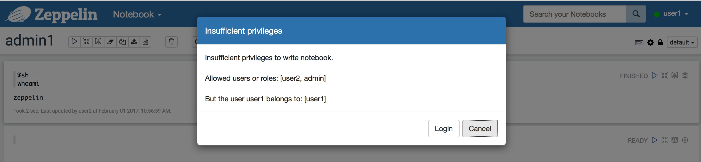

Reader users:
When they try to execute the script

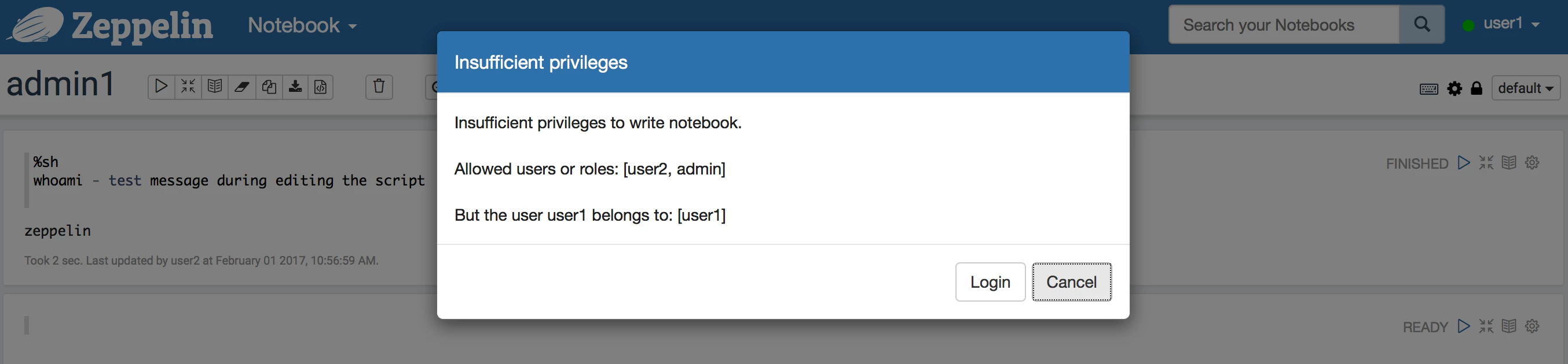

When they edit the script - the screen comes up after few seconds. But the content create is not saved
