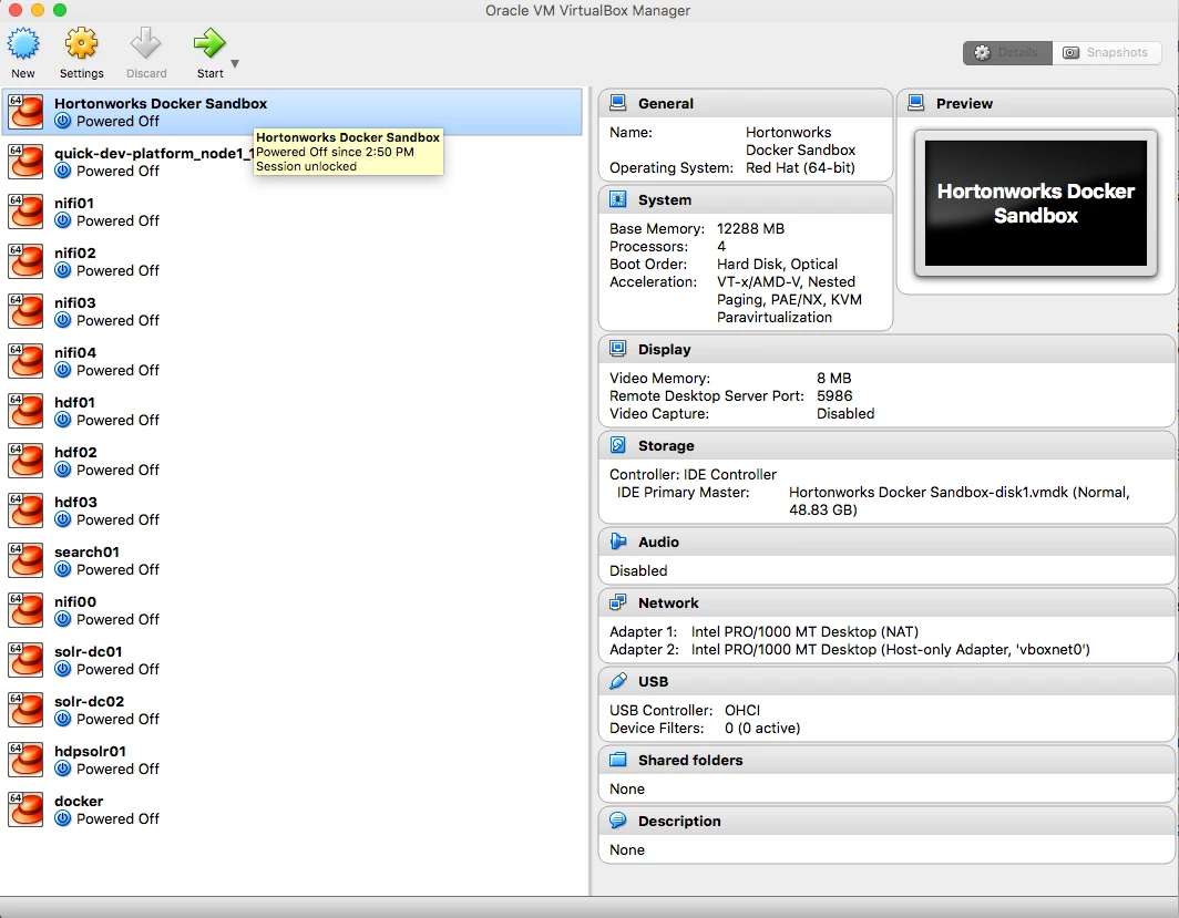

Startup the Sandbox VM
Startup your HDP sandbox. It should be called Hortonworks Docker Sandbox within VirtualBox. You should see something similar to this:

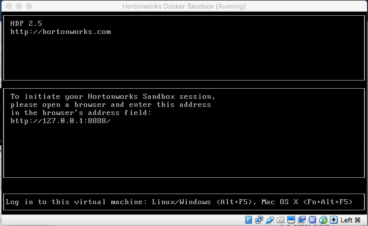

You can start the sandbox by either double-clicking on the virtual machine or by selecting the virtual machine and clicking on the start icon in the menu. Once the virtual machine is started, you should see something similar to this:
NOTE: It may take several minutes for the virtual machine to start.
Login to the Sandbox VM

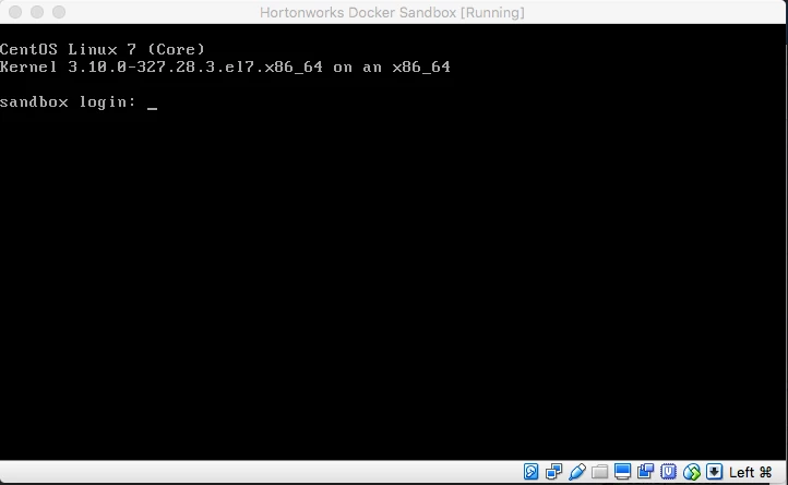

We need to login to the VM that runs the sandbox container. If you use the standard ssh -p 2222 root@localhost, you will actually login to the sandbox container, not the sandbox VM. You can login to the sandbox VM using ssh -p 2122 root@localhost.
You can also login to the sandbox VM directly using the VirtualBox VM window by following the instructions on the VM window. On the Mac you click in the VM window and press the Alt/Option + F5 keys. You should see something like this:

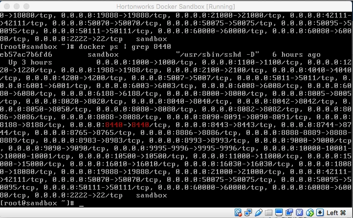

After the VM reboots, login again using the steps provided above. We are going to show the running Docker container using the docker ps command.
docker ps
You should notice the standard Docker output from that command. Look for the port 8440. You should see it in the list. You should see something similar to this:
NOTE: We added the port to the end of the startup script. However, the port will not be displayed at the end of the list. The port will be somewhere in the middle of the list of ports.

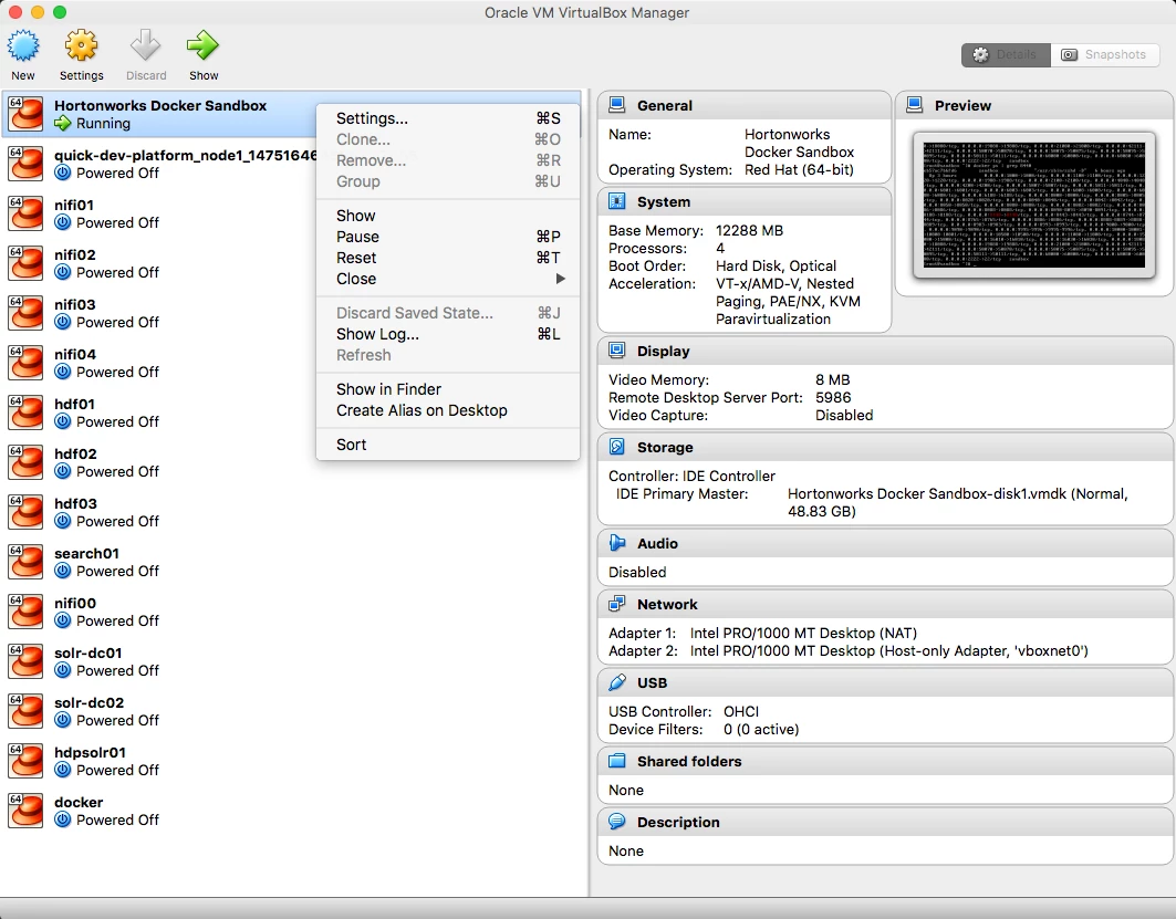

Now we need to update the forwarded ports configuration for our VirtualBox VM. Using the VirtualBox user interface, right-click on the Hortonworks Docker Sandbox to display the menu. You should see something similar to this:

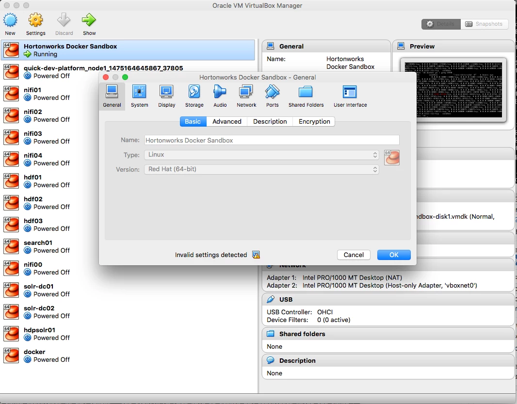

Now click the Settings menu option. You should see something similar to this:

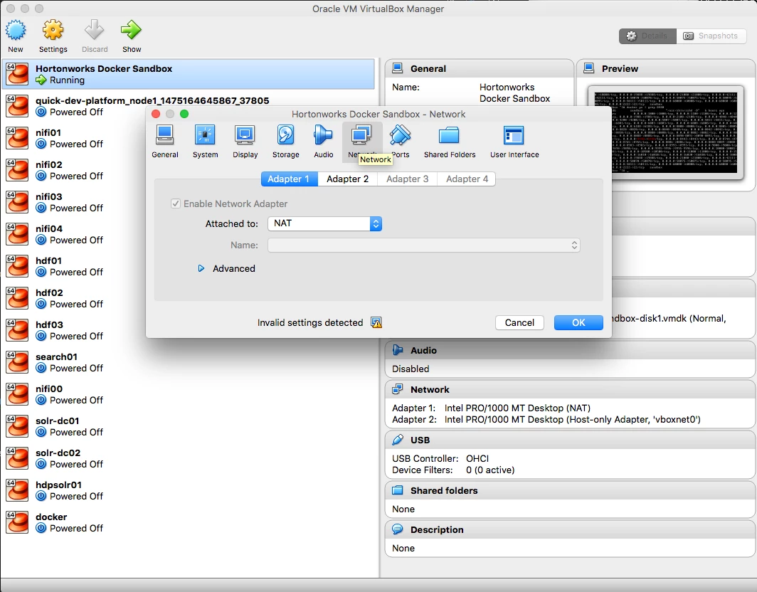

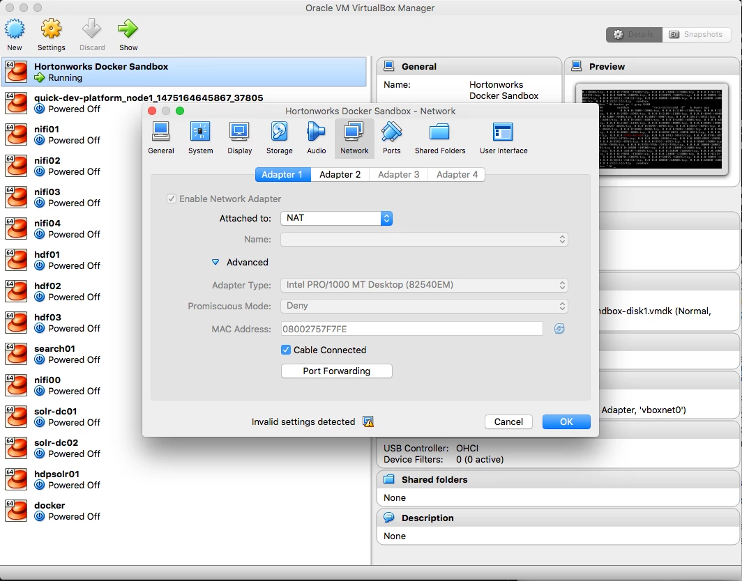

Now click on the Network menu icon. You should see something similar to this:
Now click the Advanced dropdown menu near the bottom. You should see something similar to this:

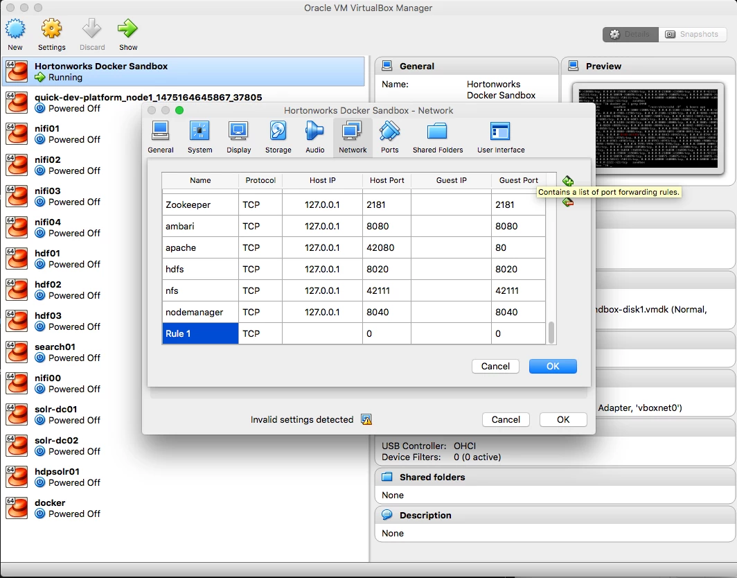

Now click the Port Forwarding button. You should see something similar to this:
Now click the + icon near the upper right to add another port forwarding rule. You should see something similar to this:

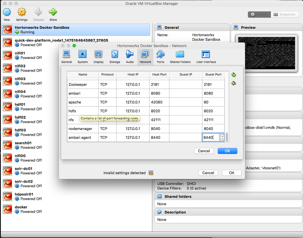

Now add an entry with the following info:
Click the blue OK button. Click the OK button. The settings should be saved.
Now port 8440 should be accessible on your computer which is forwarded to 8440 on the VirtualBox VM which is then passed to the Docker container.
