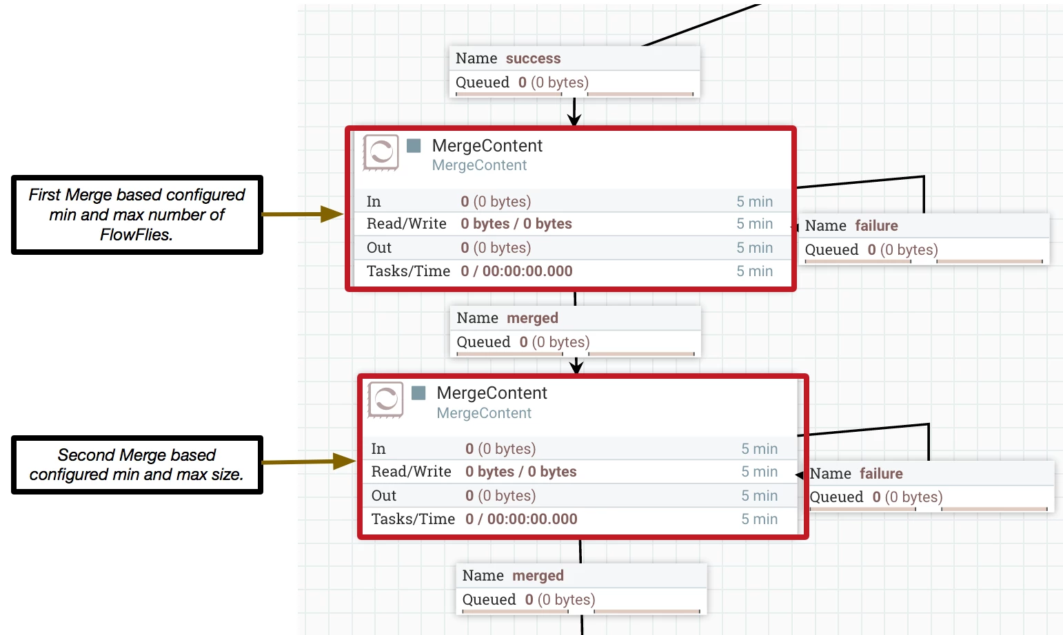

4. Using the MergeContent processor to merge a very large number of FlowFiles. NiFi can not merge FlowFiles that are swapped, so all these FlowFile's attributes must be in heap when the merge occurs. If merging a very large number of FlowFiles is needed, try using two MergeContent processors in series with one another. Have first merge a max of 20,000 FlowFiles and the second then merge those 10,000 FlowFile files in to even larger bundles. (Increase configured nifi heap size in bootstrap.conf also help)

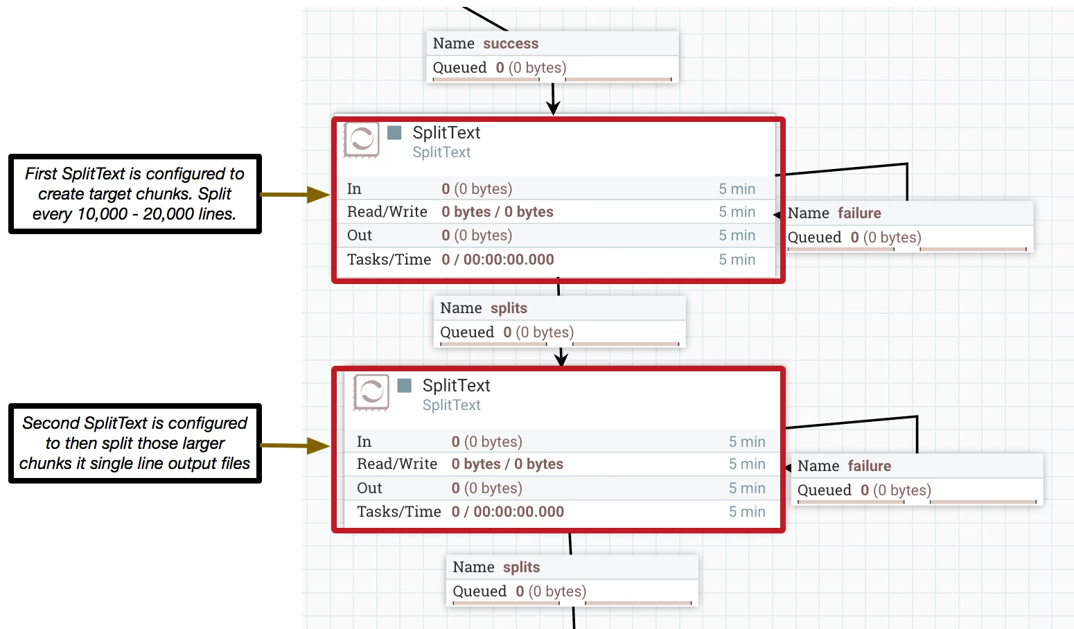

5. Using the SplitText processor to split one File in to a very large number of FlowFiles. Swapping of a large connection queue will not occur until after the queue has exceeded swapping threshold. The SplitTEXT processor will create all the split FiLowFiles before committing them to the success relationship. Most commonly seen when SpitText is used to split a large incoming FlowFile by every line. It is possible to run out of heap memory before all the splits can be created. Try using two SplitText processors in series. Have the first split the incoming FlowFiles in to large chunks and the second split them down even further. (Increase configured nifi heap size in bootstrap.conf also help)
