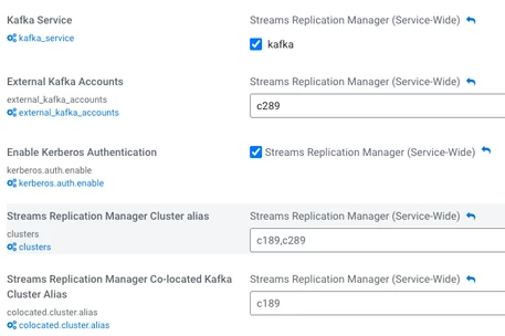

  3. Finally, go to cluster A > Cloudera Manager > Streams Replication Manager > Configuration and add the external account name c289 in the External Kafka Accounts field:
