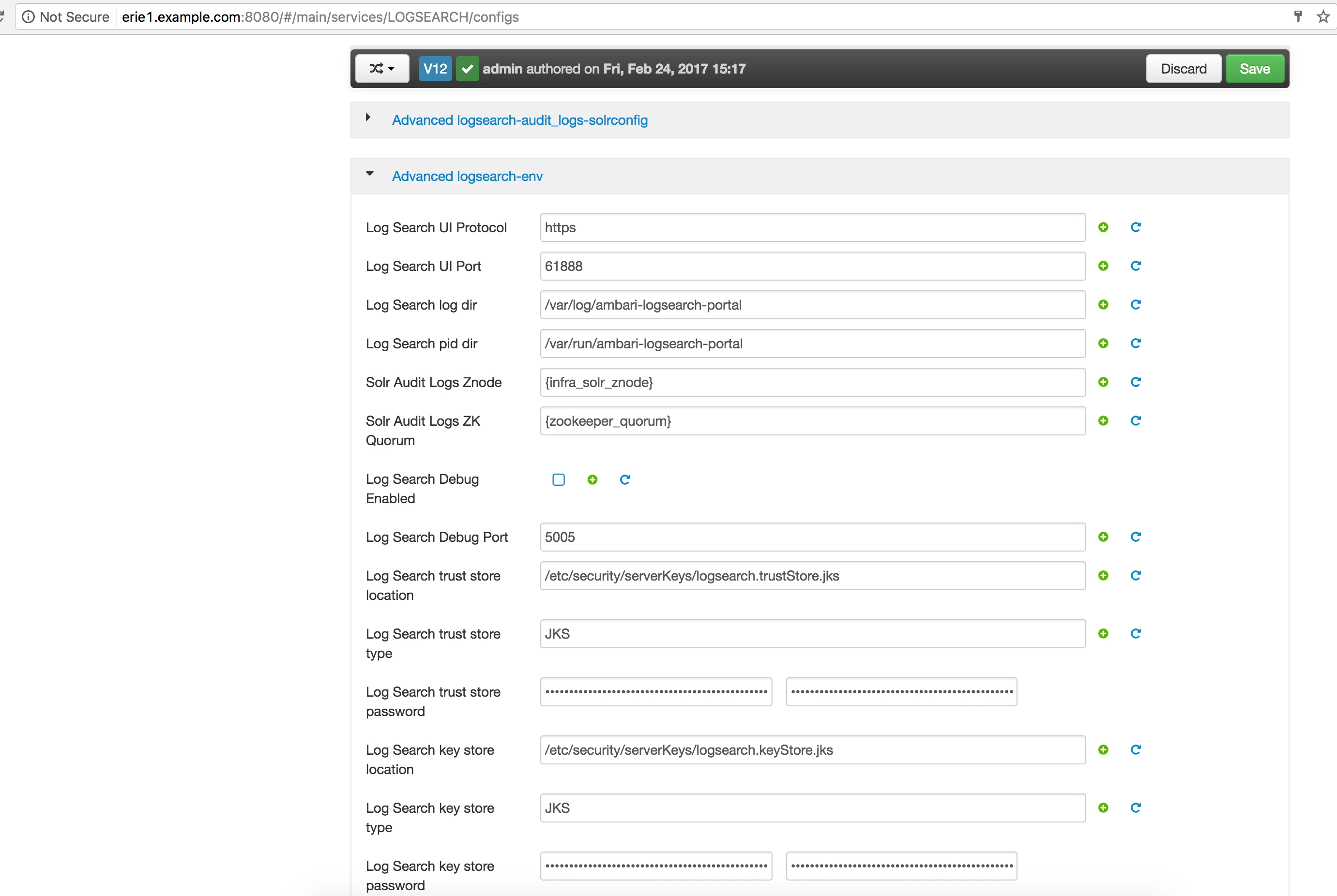

. - Now we can login to ambari UI and navigate to "Log Search" --> "Configs" --> "Advanced" --> "Advanced logsearch-env" and then provide the following details there:
Log Search UI Protocol: https
Log Search UI Port: 61888
Log Search trust store location: /etc/security/serverKeys/logsearch.trustStore.jks
Log Search trust store type: JKS
Log Search trust store password: logsearch
Log Search key store location: /etc/security/serverKeys/logsearch.keyStore.jks
Log Search key store type: logsearch
Log Search key store password: logsearch
12963-logsearch-https-settings.png .
- Once we enter the above details then we can "Save" the settings and then restart the "Log Search" service.

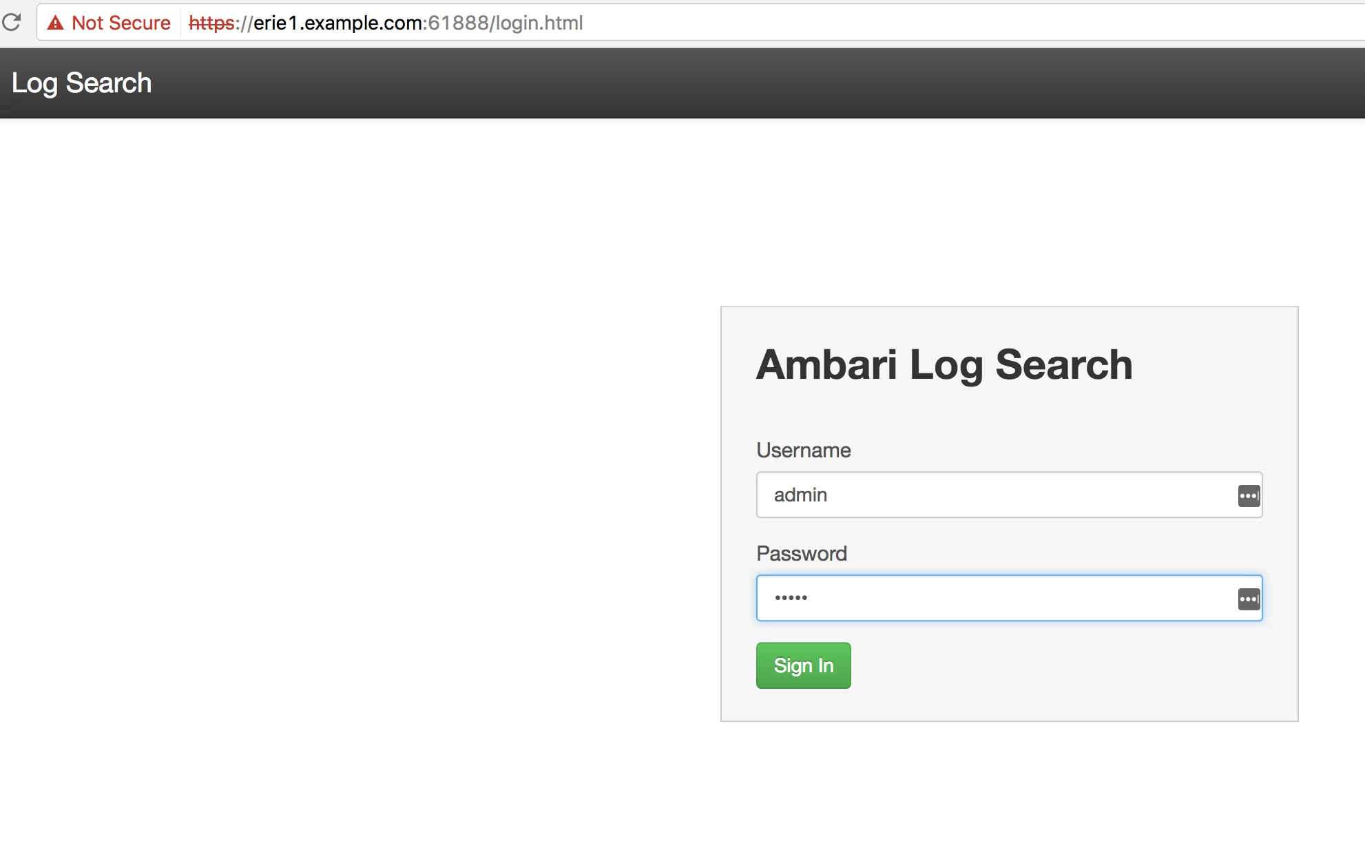

- Now we should be able to access the "Log Search" using the HTTPs protocol12964-logsearch-ui-login-https.png

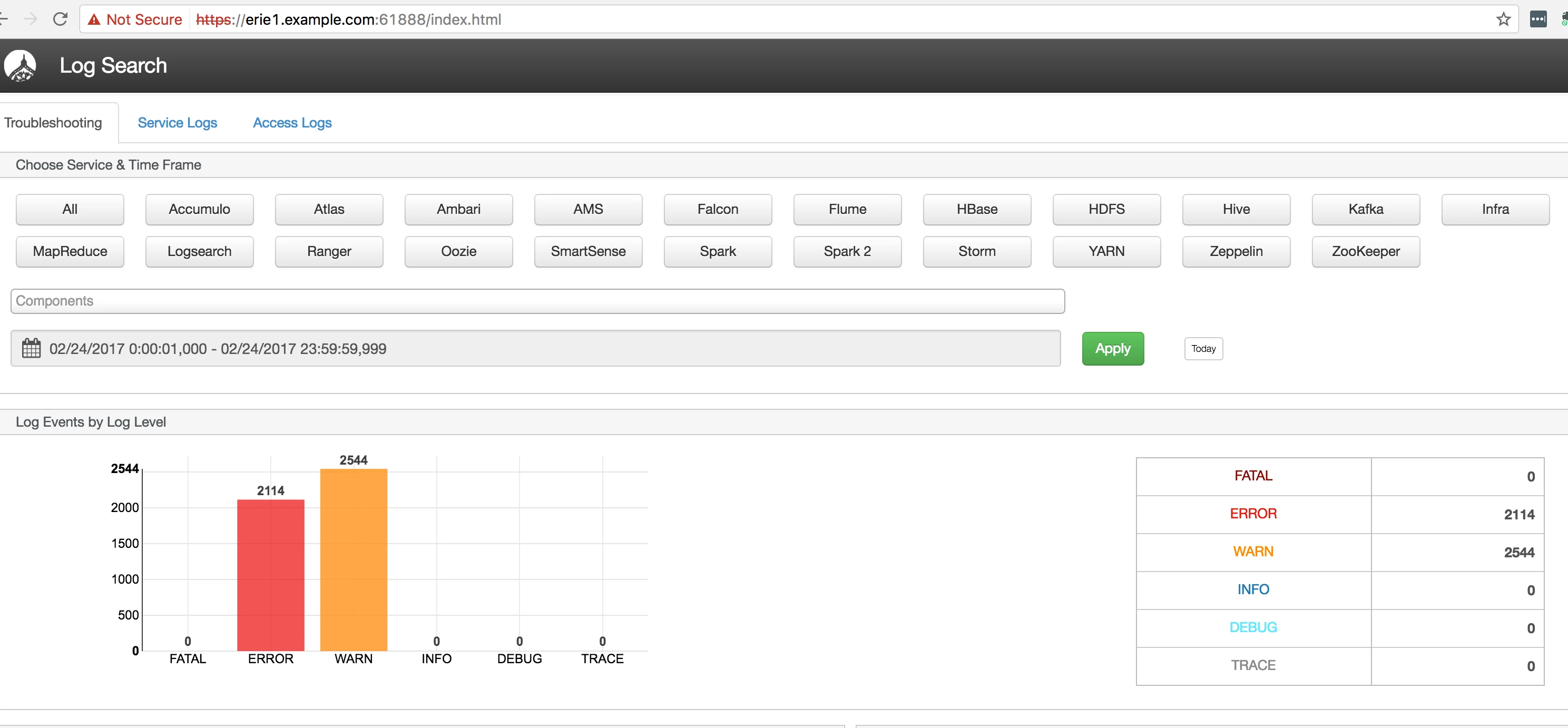

And then the Log Search UI dashboard:
