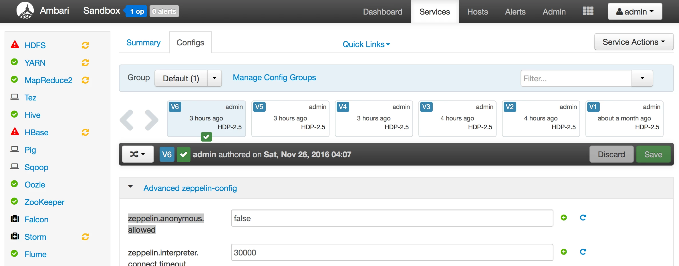

1. From Ambari Dashboard, navigate to Zeppelin Notebook > Configs > Advanced zeppelin-config section.
2. Locate & set property "zeppelin.anonymous.allowed=false". By default, this is set to true so that any user can login to Zeppelin UI as anonymous user.

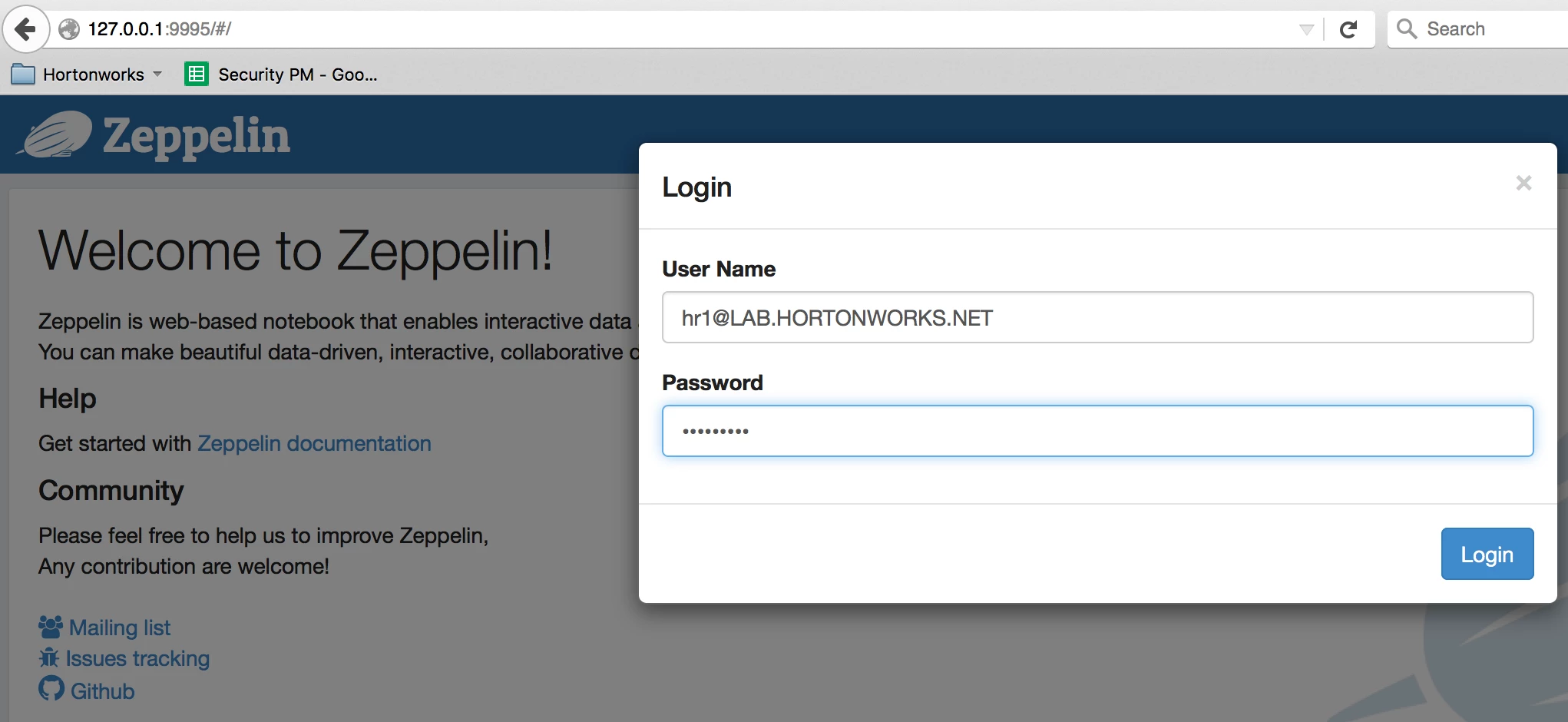

Test the configuration:
1. Once Zeppelin service is restarted, open the Zeppelin UI in a new browser tab by typing http://zeppelin-hostname:9995. Since I'm using HDP 2.5 Sandbox, for me it is http://127.0.0.1:9995
2. Click on "Login" button in the top right corner.
3. Specify any valid Active Directory username and password in the Login window. Make sure to provide the fully qualified user name like "ad-username@AD.DOMAIN.COM", a short username like "ad-username" will give an error (check next section).
If everything goes fine, user will be able to login using their Active Directory credentials. At the same time, the log file will show a success message like this:
