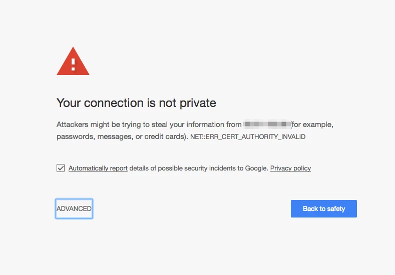

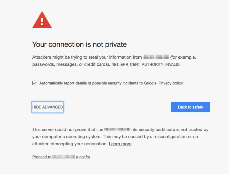

As mentioned in the prerequisites, you should already have a cluster built using Cloudbreak. Click on the cluster summary box in the Cloudbreak UI to display the cluster details. Now click on the link to your Ambari cluster. You may see something similar to this:
Your screen may vary depending on your browser of choice. I'm using Chrome. This warning is because Cloudbreak uses self-signed certificates which are not trusted. Click on the Advanced link. You should see something similar to this:
Click on the Proceed link to open the Ambari login screen. You should be able to login to Ambari using the default username and password of admin unless you changed it.

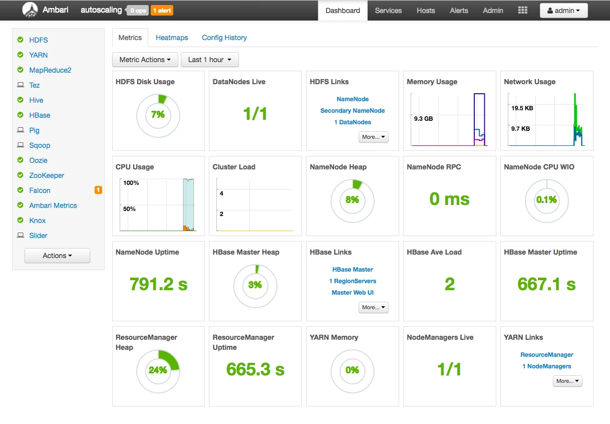

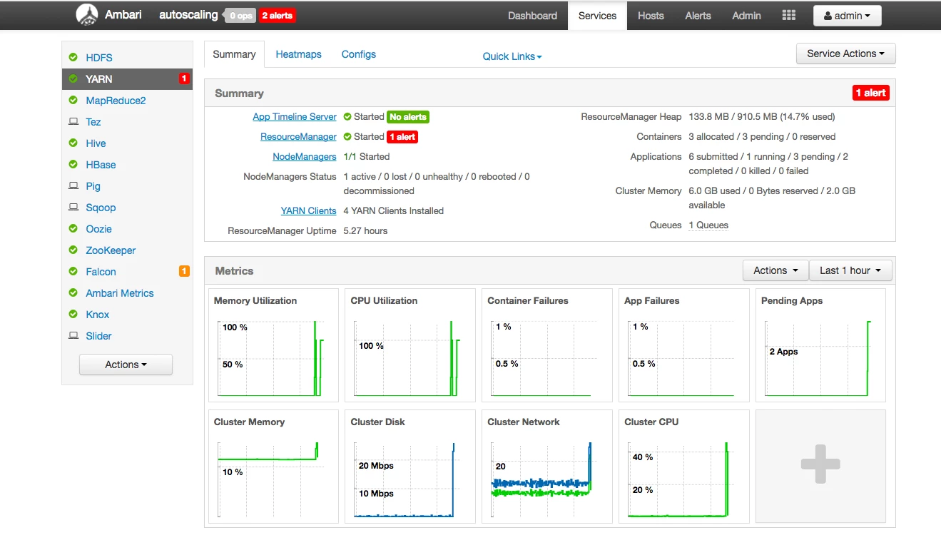

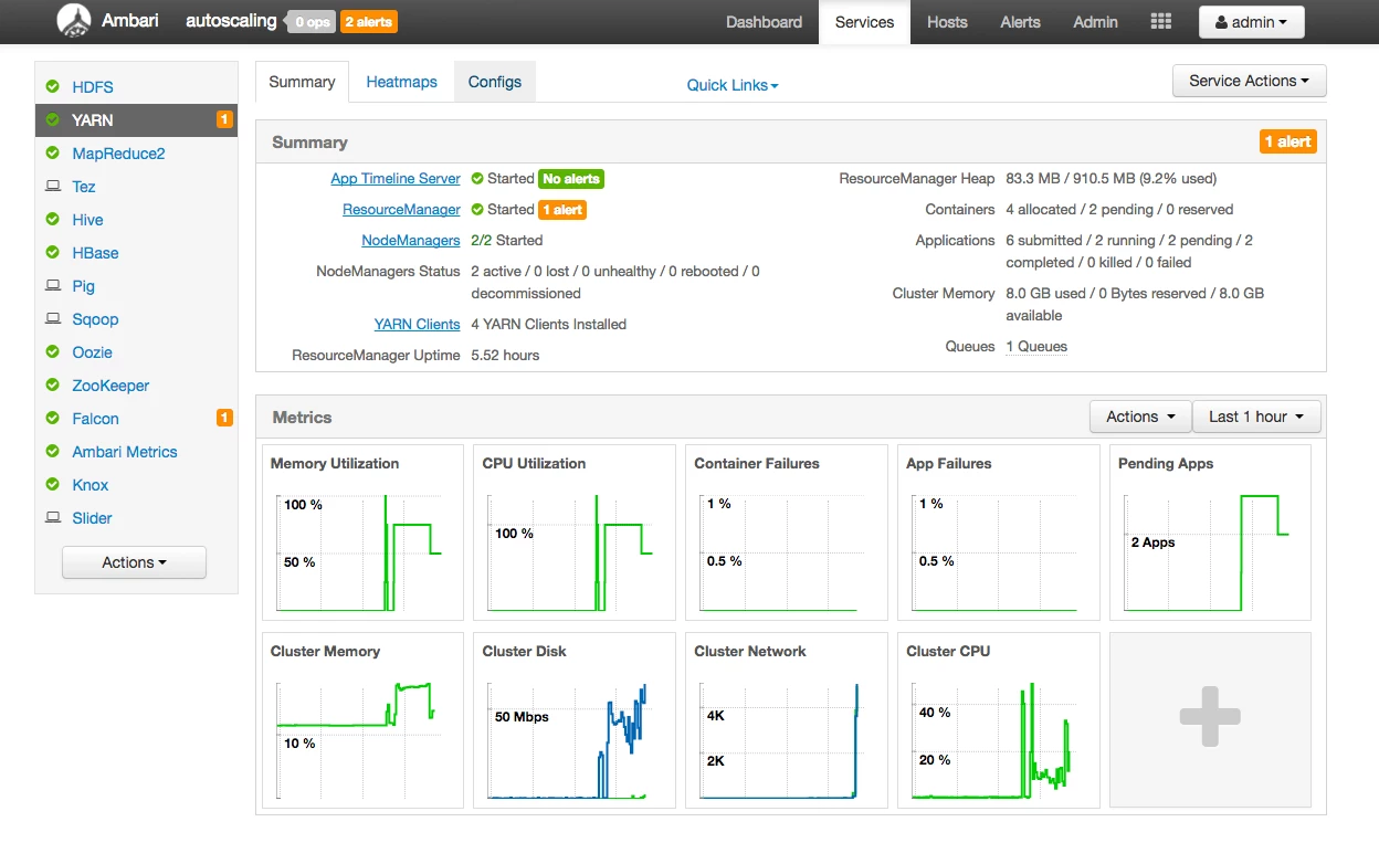

Once you have logged into Ambari, you should see something similar to this:
NOTE: Your specific cluster may look different.
Login into YARN ResourceManager
YARN is the central component used to manage resource availability on an HDP cluster. In Ambari, you can see a high-level summary of resources available to YARN to by click on the YARN link in the service list on the Ambari dashboard. You should see something similar to this:
If you take a look at the upper right corner, you can see a summary of containers, applications and cluster memory. For this tutorial, I would like Cloudbreak to autoscale my cluster when the number of pending applications is greater than 2. To do this, I'm going to create a custom Ambari Alert based on that value. To get that value, I need to look at the YARN ResourceManager JMX data.

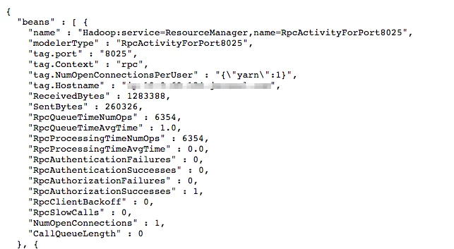

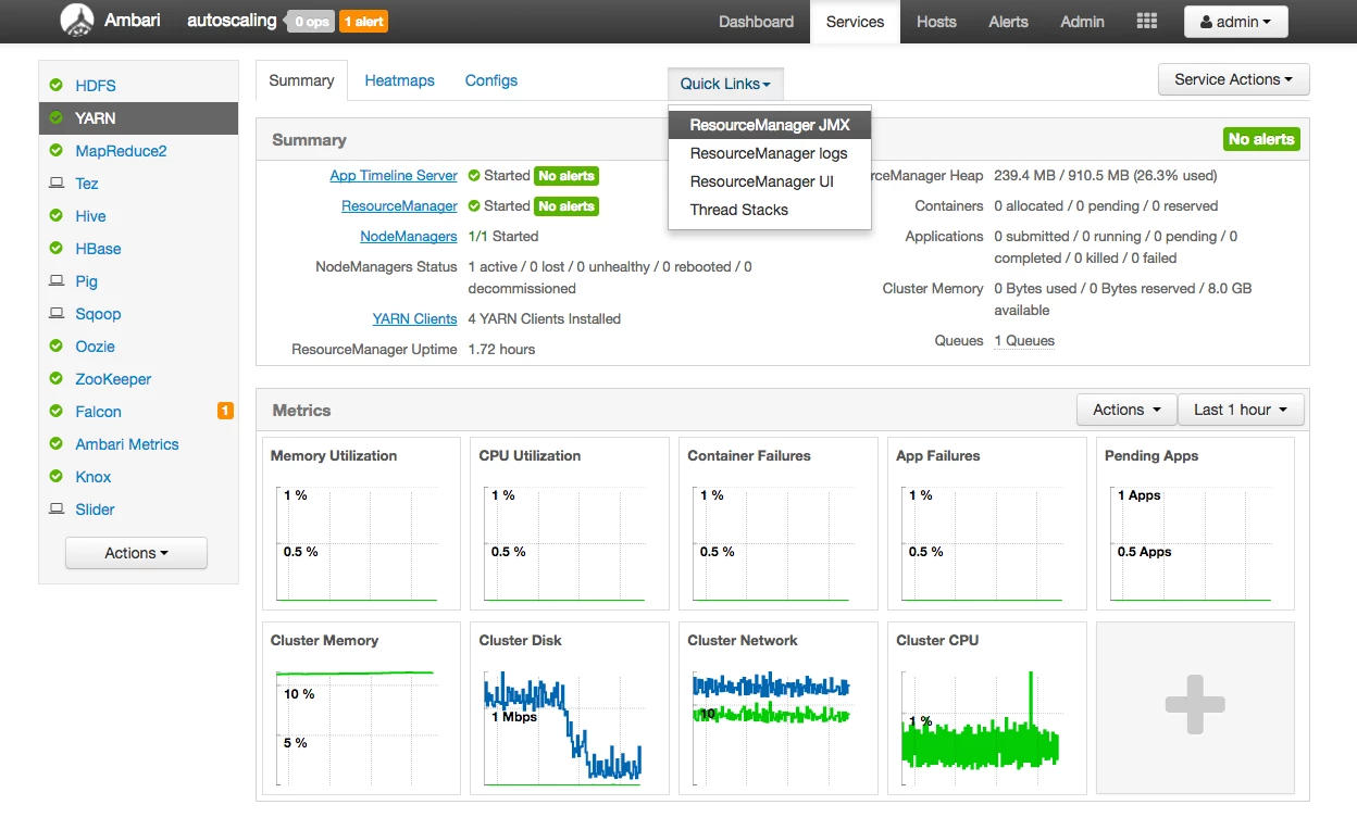

View YARN ResourceManager JMX Data
You can view available JMX data for the YARN ResourceManager via the Ambari Quick Links. You should already have the YARN ResourceManager dashboard visible from the last step. Click on the Quick Links drop down menu in the top middle of the screen. You should see something similar to this:
As you can see, ResourceManager JMX is available in the list. If you click that link you will see something similar to this:

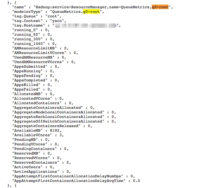

You should see a fairly large JSON output. If you search for q0=root, you should see something similar to this:
This is a list of YARN related metrics associated with the root queue. If you look in the list of values, you should see AppsPending. This is the metric I want to use for my Ambari Alert.

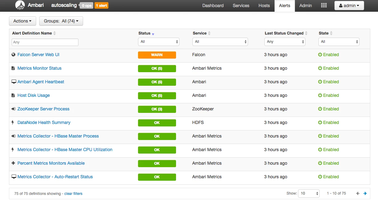

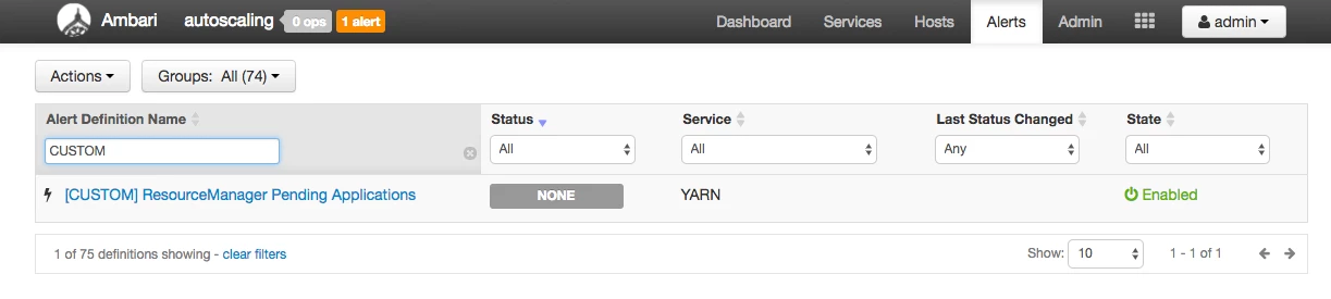

You can also verify via the Ambari Alerts page. In the upper right-hand menu of Ambari, click on Alerts. You should see something similar to this:
Now filter for CUSTOM and you should see something similar to this:
As you can see, the alert exists in Ambari. After a few minutes, the status should change from NONE to OK.

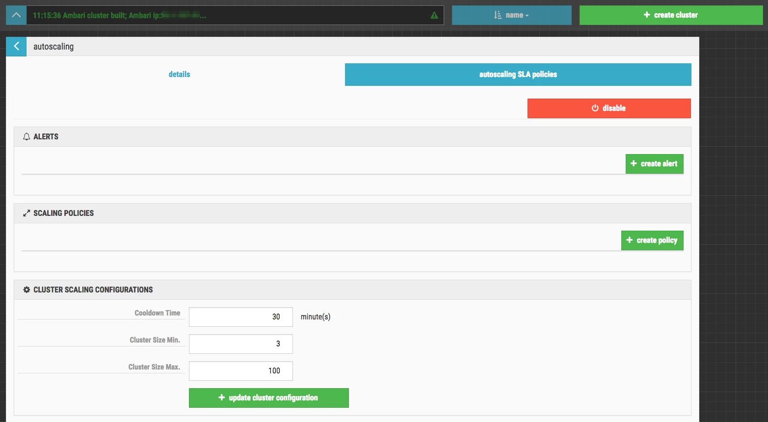

Create Cloudbreak Autoscaling Policy

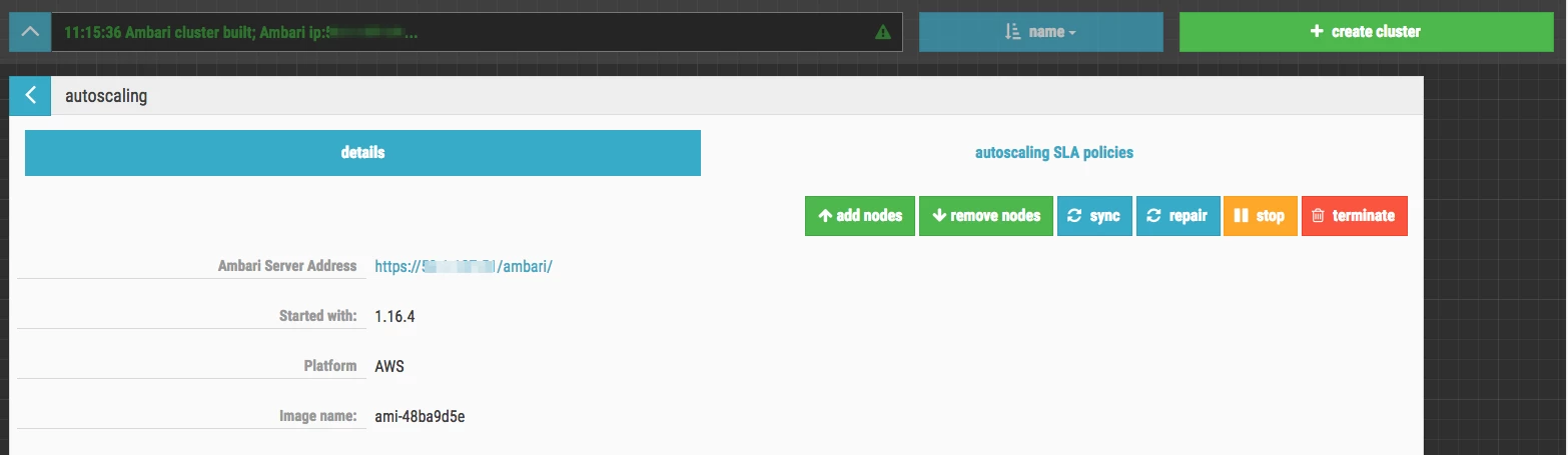

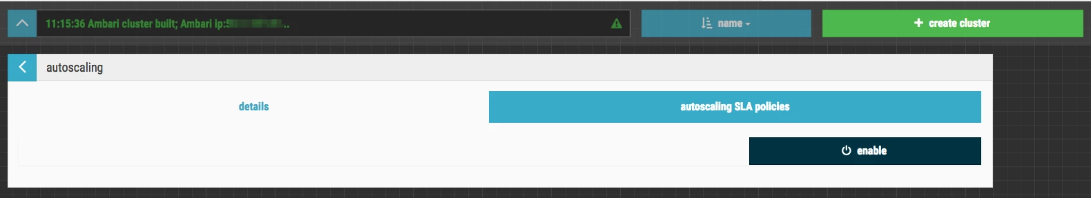

Now that our custom alert exists in Ambari, we can create a Cloudbreak autoscaling policy based on that alert. In the Cloudbreak UI, show the details for the cluster you have running. You should see something similar to this:
Click on the autoscaling SLA polices link to the right of details. You should see something similar to this:
By default, the policies should be disabled. You can click on the enable button to enable autoscaling. You should see something similar to this:

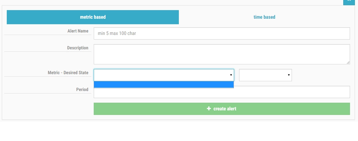

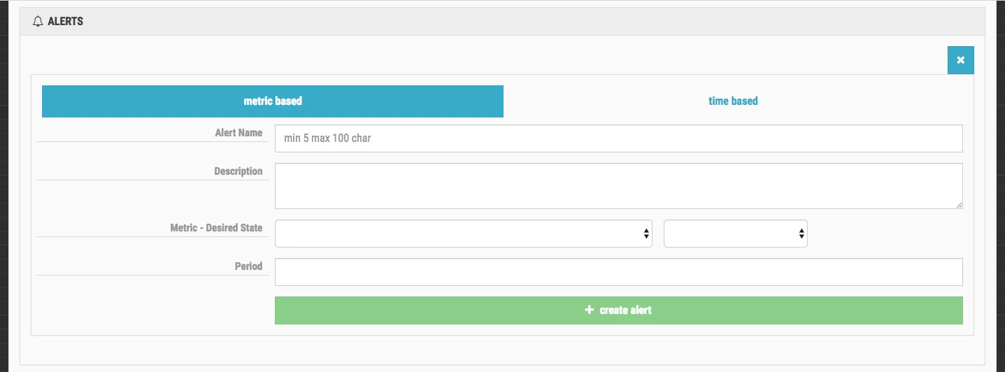

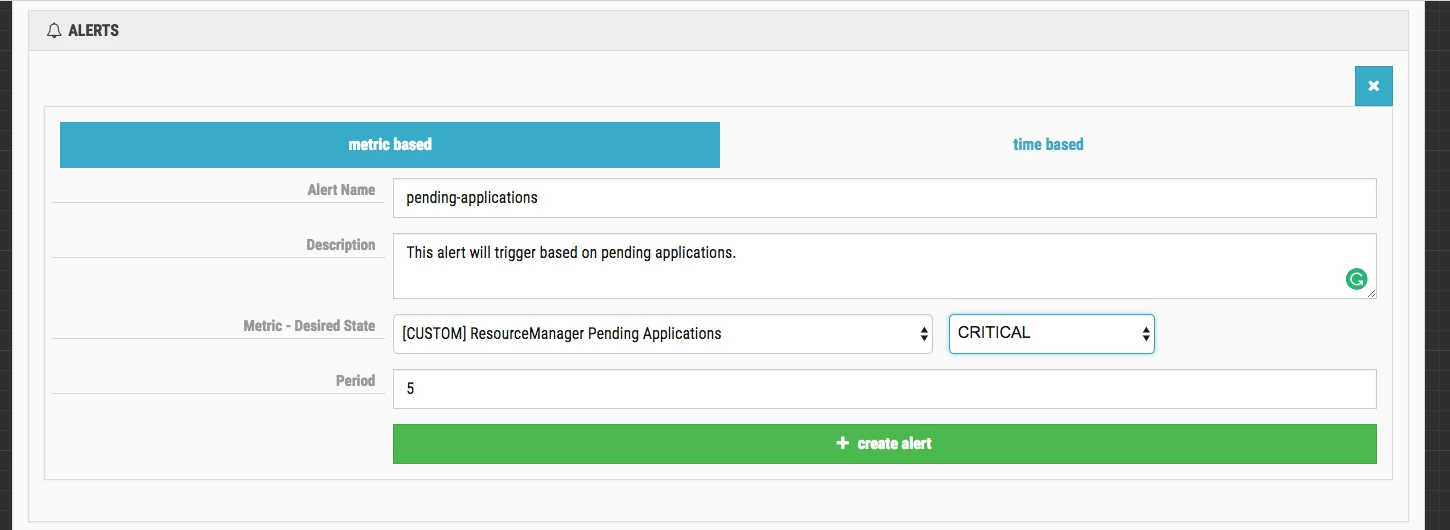

Before creating the policy, you have to define the Ambari Alert on which you want to trigger. Click the create alert button. You should see something similar to this:
You have to option to chose between metric based and time based alerts. Time based alerts allow you to define a cron based time period where autoscaling events will happen. For this tutorial, I'm going to use metric based.
The Alert Name and Description are up to you. I recommend using something informative. The Metric - Desired State is a drop down where you select from the list of available Ambari Alerts and you determine which Alert state you want to trigger. The Period is how long, in minutes, the alert should exist before an autoscaling event is triggered. You should use a value that is reasonable; you don't want the scaling events happening too quickly as that can cause a lot of churn.
You can see what I've used as an example:

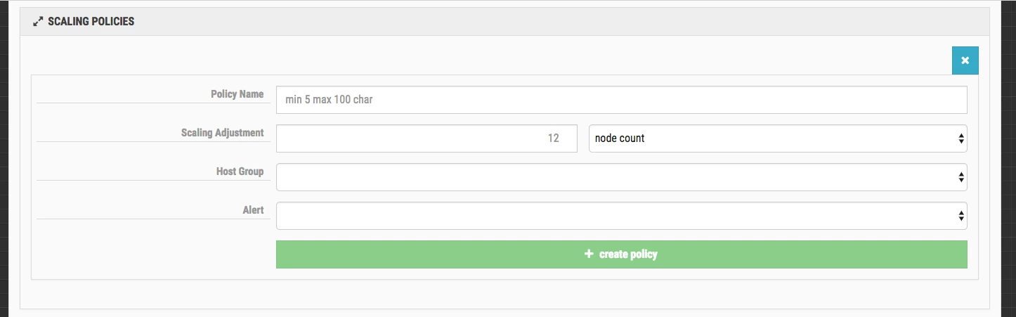

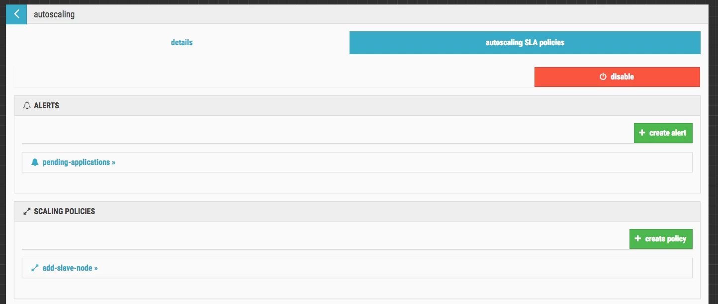

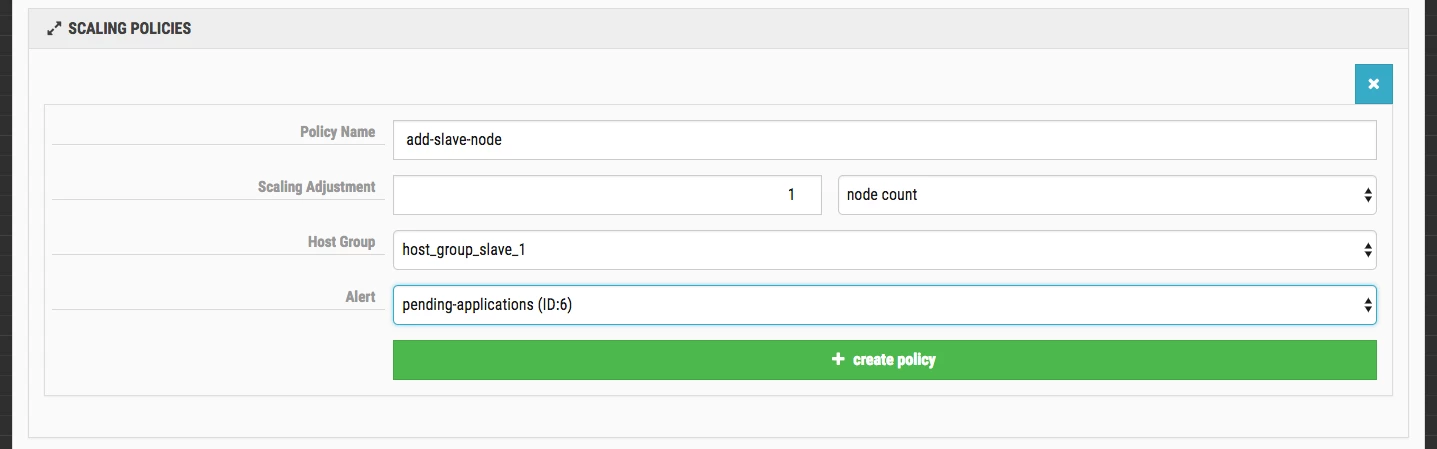

When you have everything entered, click on the create alert button. Now we can define the scaling policy itself. Click on the create policy button. You should see something similar to this:
The Policy Name is up to you. Again, I recommend using something informative. The Scaling Adjustment is how many nodes to add to the cluster. The dropdown to the right specifies the node metric. You can specify a specific node count, a percentage of nodes based on the cluster size, or a total cluster node count. The Host Group defines which kind of nodes should be added. This will go back to your Blueprint used to build the cluster. You may have compute or data only nodes that you want to add. The Alert is the Cloudbreak Alert we created in the previous step.
You can see what I used as an example:
When you have everything entered, click on the create policy button. You should now have an Alert and Scaling Policy defined. You should see something similar to this:

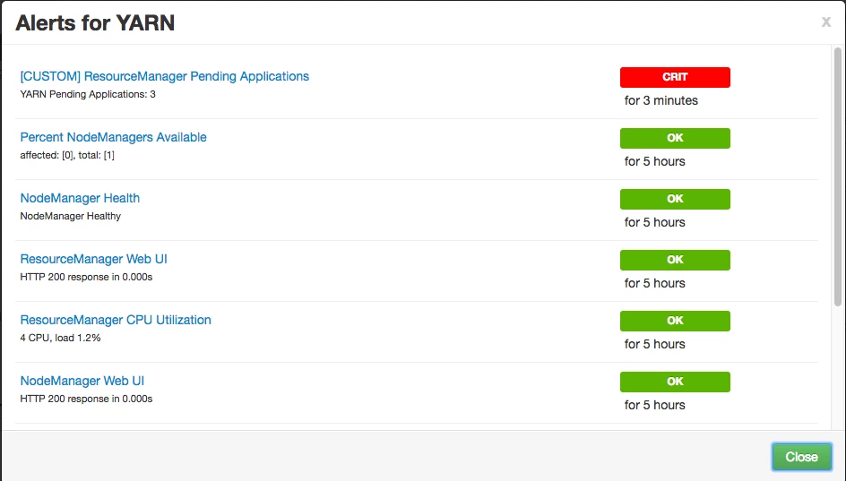

I'm going to need 4 sessions because I want to have 4 submitted jobs at the same time. In each session I'm going to run the following command:
sudo -u hdfs hadoop jar /usr/hdp/current/hadoop-mapreduce-client/hadoop-mapreduce-examples.jar teragen 1000000000 /tmp/terasort1-input
For each session you need to specify a unique output directory. In my case I used terastor1-input, terasort2-input, etc. We need enough jobs running for the alert to trigger and be present for at least 5 minutes, which is the time period we specified in Cloudbreak. In Ambari, click on YARN to see the summary dashboard. You should see something similar to this:
If you click on the red 1 alert you can get more details. You should see something similar to this:
As you can see, this has been CRIT for 3 minutes. Cloudbreak won't trigger an autoscale event until it has been 5 minutes. After 5 minutes has passed and the alert is still present, Cloudbreak should start autoscaling. IF you look at the HISTORY second on the Cluster autoscaling page, you should see something similar to this:

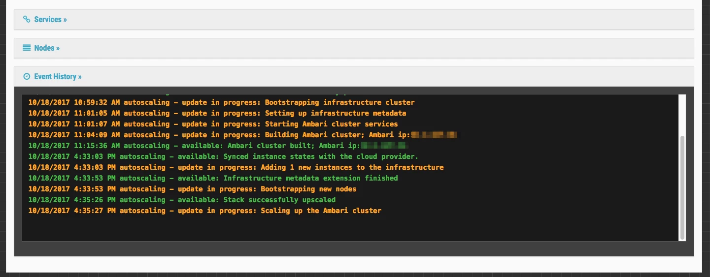

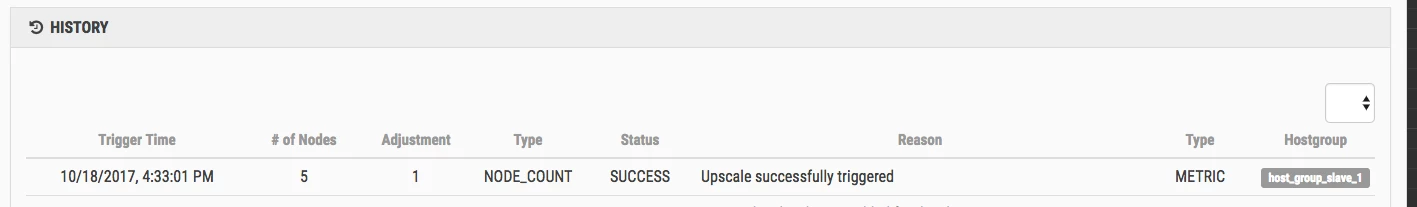

As you can see, Cloudbreak as started the autoscaling process. It will add 1 node to the cluster based on our policy. You can also see this on the cluster details page in the Event History. You should see something similar to this:

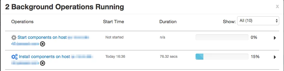

After a couple of minutes, you should notice Ambari showing the addition of another node in the list of operations. You should see something similar to this:
Once the new node is added you should notice that one of the other jobs is picked up and the Alert changes from CRITICAL to WARN. You should see something similar to this:

The autoscaling policy we setup only addresses the addition of new nodes. You need to consider multiple policies that adjusts the cluster up and down. For example you could have a policy that sets the cluster size to a specific total node count when an alert is OK.
Cloudbreak also allows you to adjust the scaling configuration to allow for a cool down time with min and max cluster size. This helps you to control the amount of cluster churn created by autoscaling events. Combined with adjusting the period for the Cloudbreak alert, you have a reasonable amount of control over autoscaling on the cluster.
