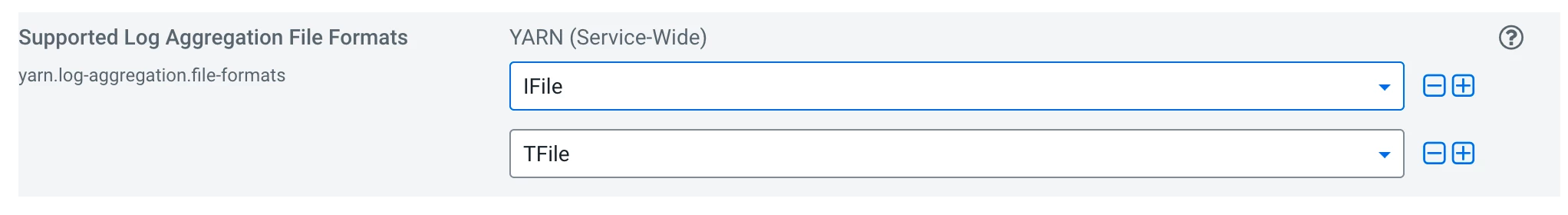

In the CDP DC cluster, once you use the AMToCM migration script to migrate all configurations, you will not be able to fetch a yarn application logs from the command line when using the following command:
$yarn logs -applicationId application_160120642
WARNING: YARN_OPTS has been replaced by HADOOP_OPTS. Using value of YARN_OPTS.
No class configured for IndexedFormat
Can not find any log file matching the pattern: [ALL] for the application: application_1601206427676_0011
Can not find the logs for the application: application_1601206427676_0011 with the appOwner: hive
This issue occurs because the yarn.log-aggregation.file-formats gets updated with the IndexedFormat configuration during the AMtoCM migration.
To resolve this issue, change it to the ifile and Tfile.
Once you change the configuration as mentioned in the above image, save and restart the yarn service, you will able to fetch the yarn logs using the command line.
