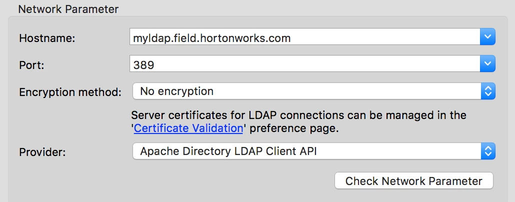

From here, I prefer to use a GUI to create additional users. Apache Directory Studio is a nice multi-platform tool and can be downloaded here.
Within Apache Directory Studio, you can create a new connection in the lower left-hand pane and use the following configuration:

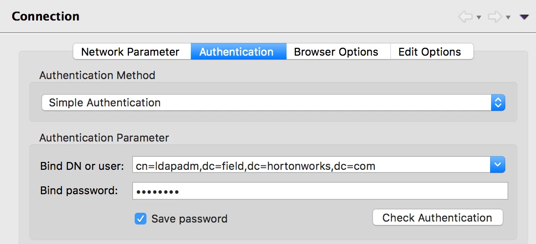

With the following authentication information:
Once you connect successfully you can create your organizational structure and users accordingly.

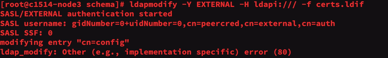

Screenshot 2022-08-15 at 7.18.12 PM.pngI was having this error and Iliterally spent days scouring the Web for an answer. It turned out in my case that the order matters. The correct order was:
  1. olcTLSCACertificateFile,
  2. olcTLSCertificateKeyFile,
  3. olcTLSCertificateFile.
