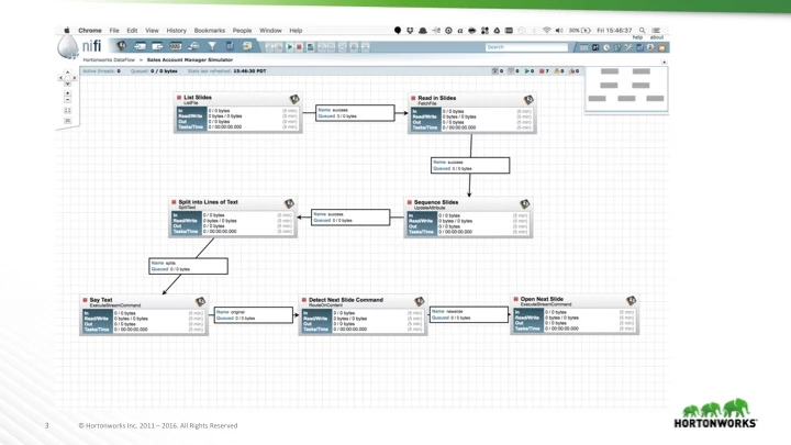

The below image shows the general setup; from top left we have a ListFile processor feeding a FetchFile processor to get the files into Nifi; we then use an UpdateAttribute processor and a SplitText processor to generate our sequenced lines of text; we then feed them into a ExecuteStreamCommand processor to run them through the 'Say' command which also acts as our blocking process to ensure serial execution; we then route the original lines out of that TextToSpeech processor into a RouteOnContent processor to recognise the command phrase 'Next Slide' which activates another ExecuteStreamCommand processor to open the appropriate slide image. Detailed configuration parameters in the linked images below, probably a bit easier to scroll through than pausing the video.

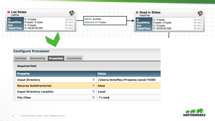

Put your own directory of jpg/txt files into the Input Directory field.
Note that we use a File Filter regex to select just the text files - it's almost code!

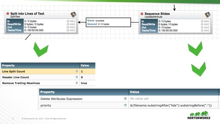

Set the line split count to 1.
Copy the 'priority' attribute without capitalising it, and use the expression here to select the number from files named like 'Slide01.txt'

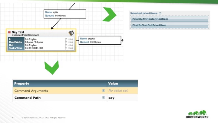

Here we simply use the 'Say' command in the command path.
Note that we use two prioritizers; the first uses our 'priority' attribute from the UpdateAttribute processor to put each slide in order, the FIFO then puts the lines of text within the slide in order.

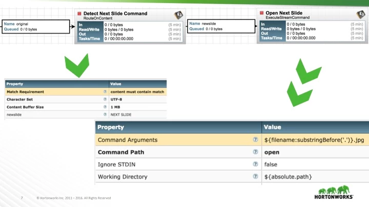

Finally we match the keyphrase 'NEXT SLIDE' here, and use a couple more expression statements to select the matching jpg file for the lines of slide text.
