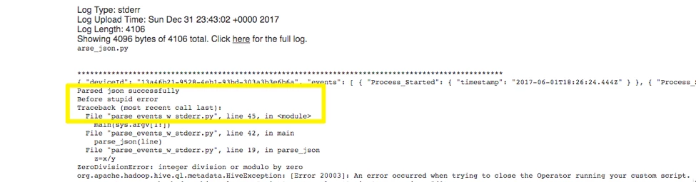

TECHNIQUE 2 - stderr is your friend!
As noted, Hive expects the results from the UDTF to be in stdout. The stderr file is fair game for writing debug statements. This is pretty old school debugging, but it's still effective. Print out values and locations in your code to help you determine where the error occurs or what values are in variables at certain times. For example, you might add the following to the UDTF script to help identify where the issue is happening:
sys.stderr.write("Before stupid error\n")
x=1
y=0
z=x/y
sys.stderr.write("After stupid error!\n")

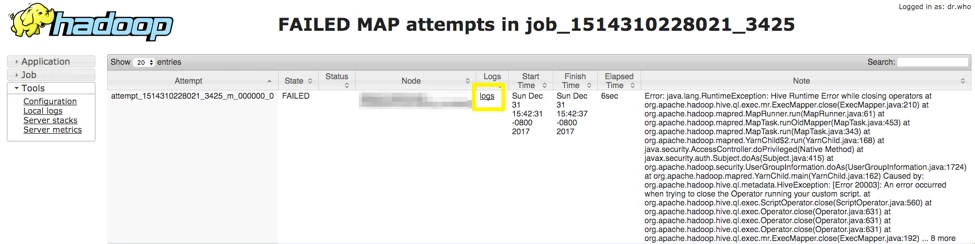

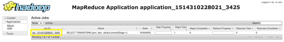

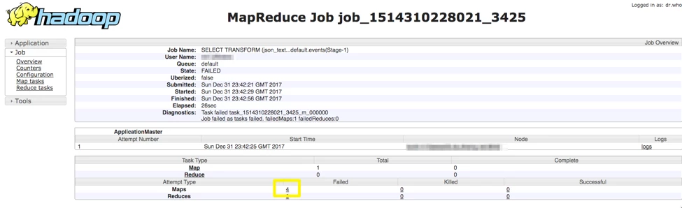

The trick is to find these in the logs when running on a Yarn cluster. These scripts are set to use mapreduce, which makes it a little easier, but basically, you find the Yarn job, drill down on one of the failed containers and examine its' stderr. Attached are some screen prints from the Yarn RM showing this process.
Winner, Winner, Here are our debugging statements!
