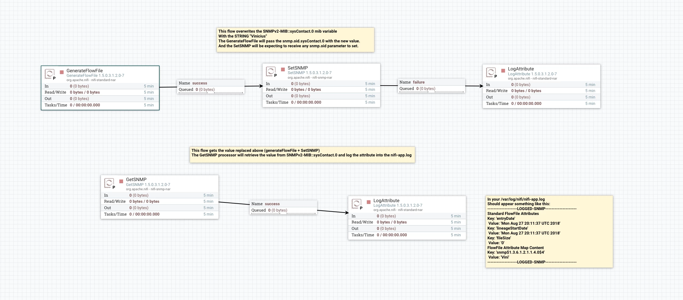

8)Now we're ready to use nifi and draw the simple flow, using SNMP processors.
Go to nifi UI and draw the following components:

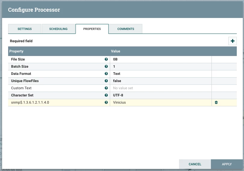

GenerateFlowFile Property

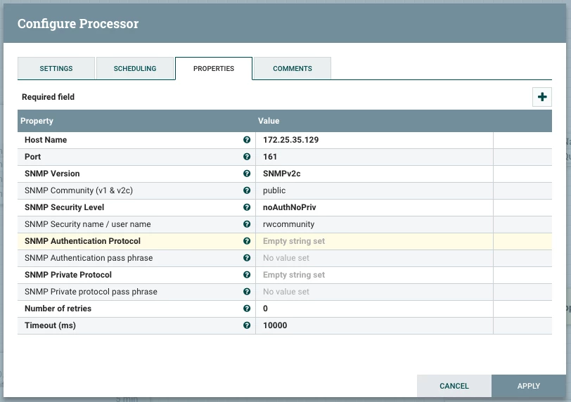

SetSNMP Property

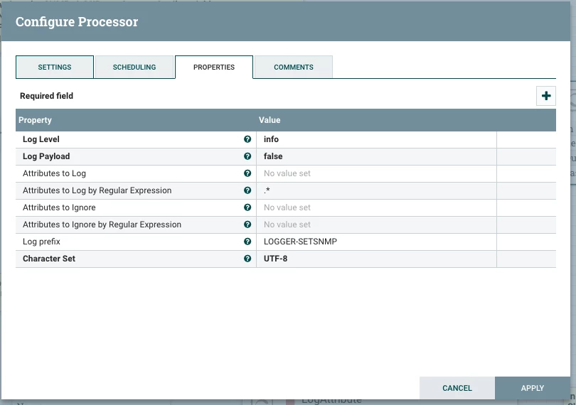

LogAttribute Property

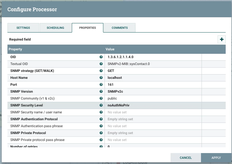

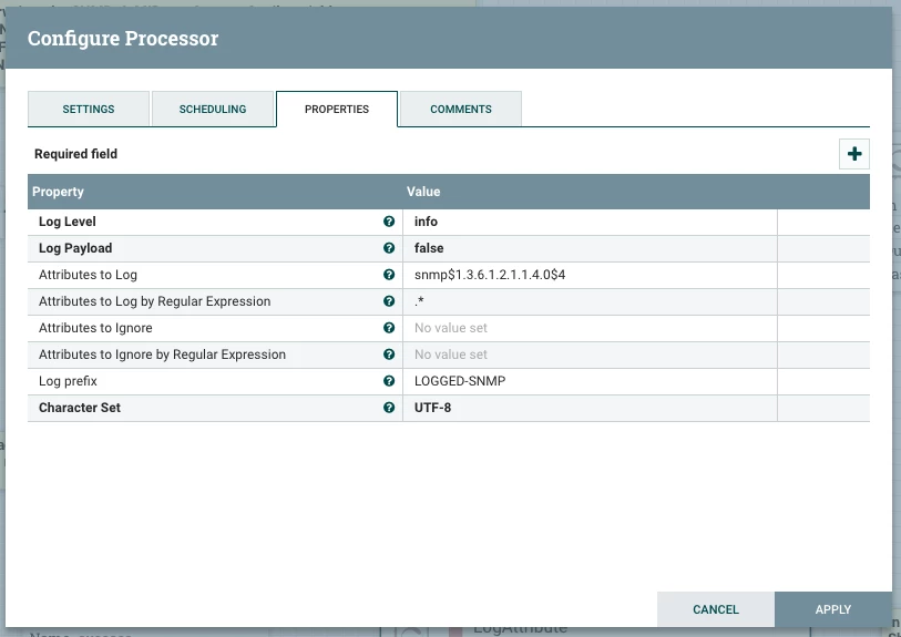

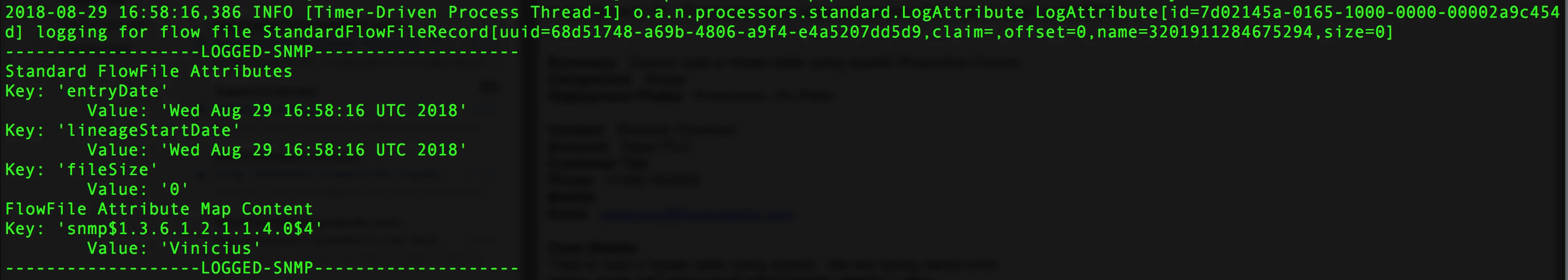

9)Run the nifi flow (snmpset and snmpget) and check if your value is showing up in the nifi-app.log

And then make some snmpget (step 7) to check if it's logging the connections into the /var/log/snmpd.log. Should appear 2 lines:
Connection from UDP: [127.0.0.1]:40769->[127.0.0.1]:161
Received SNMP packet(s) from UDP: [127.0.0.1]:40769->[127.0.0.1]:161

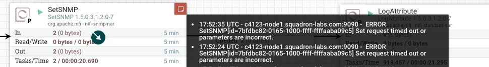

If you're having issues with the SNMPSET like the below.
Check if your snmpset it's able to reach the snmp server and send snmp packets, to do this, you can use tail -f /var/log/snmpd.log to monitor the connections and start the flow to watch the behaviour.
Other attention point is to check if your nifi has permissions to set/get values from MIB's (make sure you did the step 7).
And lastly is to check if your snmp$oid is valid.
And here's the template used:
template-kb-snmp.xml
