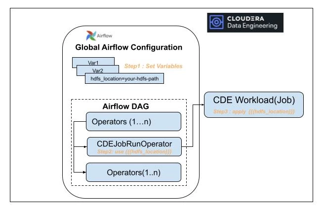

The diagram below demonstrates the pattern of templating for a workload orchestrated by Airflow in Cloudera Data Engineering ( CDE). Using this pattern allows all the jobs to get the correct value of the variables. For example, the purpose we template the  hdfs_location, which could vary across deployment environments. Our goal is to ensure that by changing the hdfs_location in the Airflow settings of the specific environment, the jobs get automatically updated.
  The three major steps in terms of setup:
  • Step 1: Airflow Configuration Setup: we set the variables in Airflow Admin settings.
  • Step 2: CDEJobRUNOperator modification:  We use Jinja templating format to set up these variables inside the CDEJobRun operator to pass these variables to the CDE Job via the CDEJobRunOperator
  • Step 3: CDE Job modification: we apply the variables in the workload e.g. a pyspark or scala job.

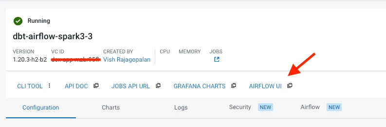

In Cloudera Data Engineering, the airflow configuration for the virtual cluster is accessed as follows:
  • Click your CDE Service and select the Virtual Cluster you would like to use
  • Click on the Cluster Details icon clicking on the cluster details as shown below:VishRajagopalan_3-1714035975821.png
  • Next, click on the Airflow UI as shown below to launch the Airflow application user interface:

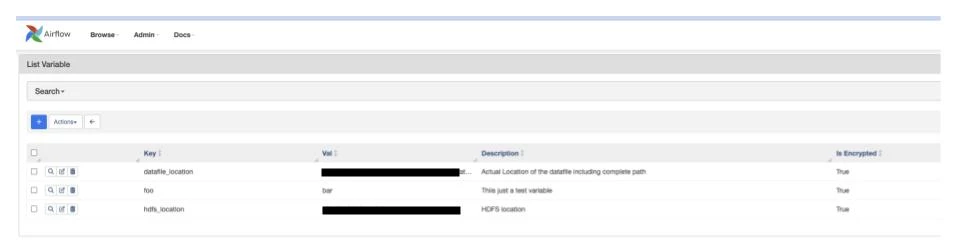

  • In the Airflow User interface, click on the Admin menu and variable sub-menu to launch the variables menu page as below. This shows the variables configured in Airflow currently. To add a new variable, simply select the blue + Sign below to open the add variable page. VishRajagopalan_6-1714036216153.png

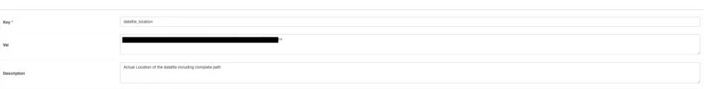

  • Add a new variable called datafile_location to provide the location of the datafile for your spark application to read. You can specify the actual path of the variable and a description in the appropriate fields.VishRajagopalan_8-1714036702897.png
  • You can use this same screen to edit the variable path when you want to make modifications by selecting the row and the edit option in front of the key.

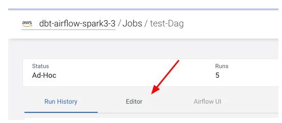

  • Option 2: If you have used the CDE Airflow UI Editor for creating the Airflow job, then Modifying in Pipeline Editor Option  ( Refer picture below for the Airflow UI Editor in CDE)

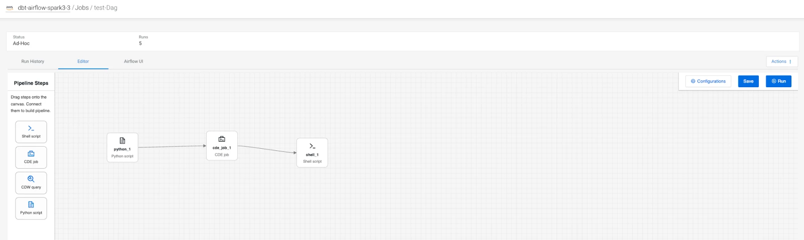

CDE provides a visual pipeline editor for generating simple workflows for those who prefer a drag-and-drop interface for creating simple Airflow pipelines. Please note that not all the operators from Airflow are supported here. If the Airflow Job and the CDEJobRunOperator were created using the pipeline, then we can set up the variables inside the pipeline. To set the variables select the Airflow Job that was created with Airflow UI and select Editor as shown below

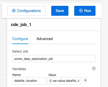

In the Editor, click on the CDEJobRunOperator and add the variable as shown below in the  name and value
  • In the Name text box enter: datafile_location
  • In the Value text box enter: {{var.value.datafile_location}}
Important Note: The curly braces {{ and  }} are mandatory to ensure the variable has the right template format.

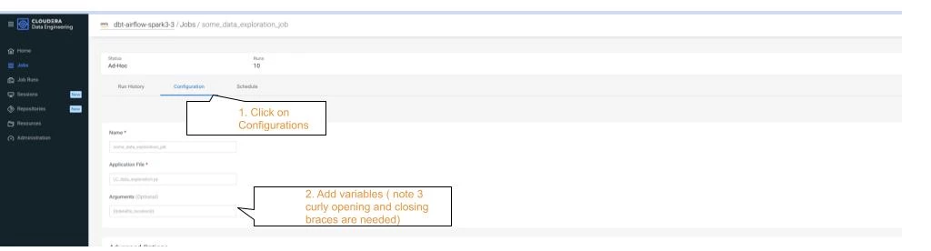

To access the variables inside the DAG we need to set up the CDE Job with the same variable names. There are two ways to do this. We can use the User Interface or the Command Line Interface. Here is a way to set up the variables in the User interface for datafile_location.
The picture above shows the changes that you need to make to your Job to accept arguments.
  • First, click on the airflow job ( or create a new one)
  • Add the argument and use the same variable name that you used in Airflow and CDEJobRunOperator
Important Note: Do not forget to add (three opening curly braces)  {{{ variable-name}}} (closing curly braces) otherwise the variable will not get the value you need.

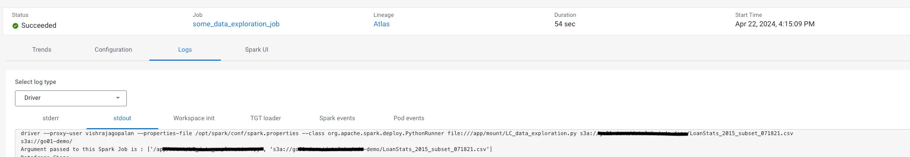

Finally, after these configurations, you can access the variables inside your CDE job by using the sys package. These variables are passed as arguments, and can therefore be accessed with the sys package. Here I have printed the Spark configuration and the variables inside a pyspark job that is called by the CDEJobRunOperator we defined earlier
import sys
print(f"Argument passed to this Spark Job is : {sys.argv}")
We can use this simple test to check if the variable value is captured as arguments. As you can see below the first value contains the data_location value we have set in airflow. We can now use this to get the variable value.
