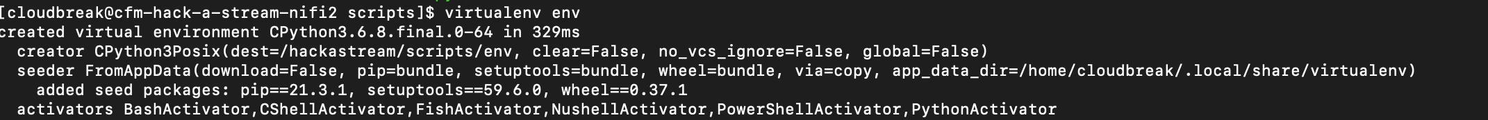

        Step 1 : Execute the following command to create a virtual env
                  virtualenv <env-name-without-brackets>
                  Eg: virtualenv env
          *On executing this a directory with the environment name gets created(the name in our case is env) in the current directory

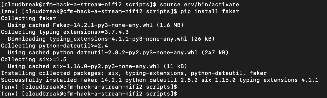

       Step 2 : Activate the Environment and install the package using the following commands
                    source env/bin/activate
               Note : Once the virtual environment is activated you should see you environment name at the start of the command prompt.
          Step 3 : Install the module using the following command
                           pip install faker

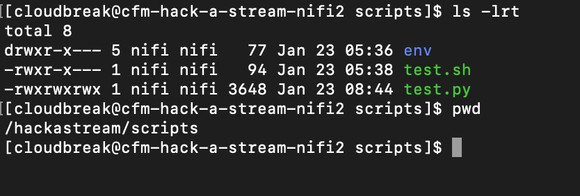

            My script folder looks something like this:
Important : Make sure the script and the virtual environment folder are accessible by the user which is running NiFi.

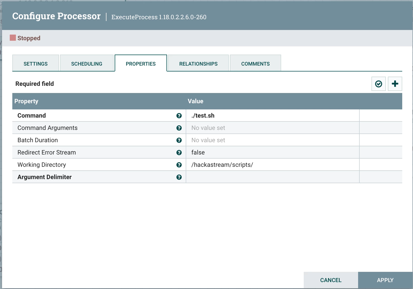

            Step 1 : In NiFi, configure the processor in the following way
Your processor will now be able to import the module that you have setup within your python virtual environment
