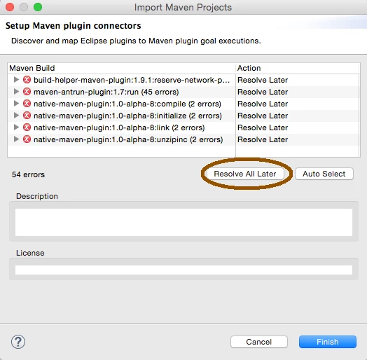

  • Import incubator-ranger project in Eclipse IDE : Open Eclipse Java EE IDE for Web Developers and import incubator-ranger project as a maven project in eclipse.

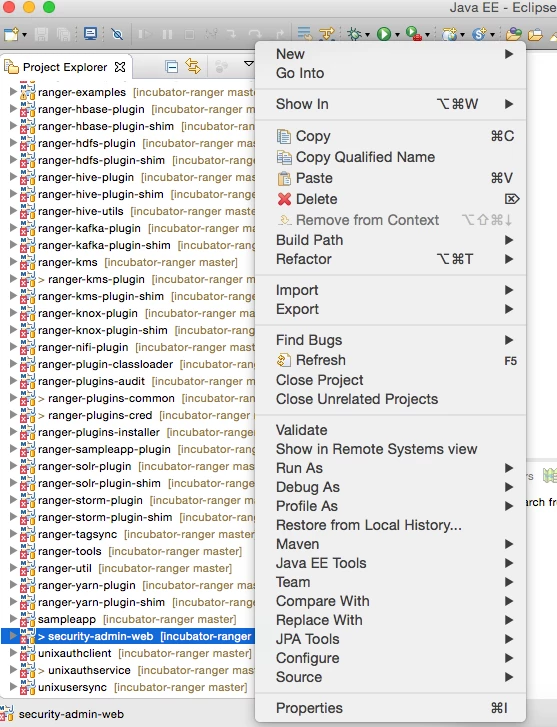

  • Steps to change above mentioned library version in eclipse : Select security-admin-web module then right click and click on properties option.

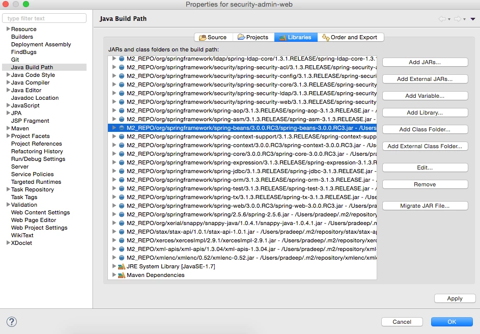

=> After clicking on properties menu; property window shall appear for the ranger-admin module.
=> On this window click on -> Java Build Path -> Libraries tab as shown below on attached screen, scroll down and select spring library of which version need to be changed. Note : In this article, we shall cover case for the spring-bean library only but you need to change the version of all 4 libraries mentioned in the previous step.
=> After selecting the spring-bean jar click on Edit button which is appearing at the right side of the screen. After clicking on edit button ‘edit variable entry’ prompt window shall appear as shown below on attached screen.

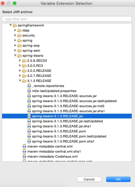

=> Click on Extension... button and select spring-beans-3.1.3.RELEASE.jar library as shown in attached screen below;
=> Click on OK button to confirm and save the changes.

  • Right click on security-admin-web module and click on ‘Run as’ -> ‘Run on Server’ option of appearing pop up window.
