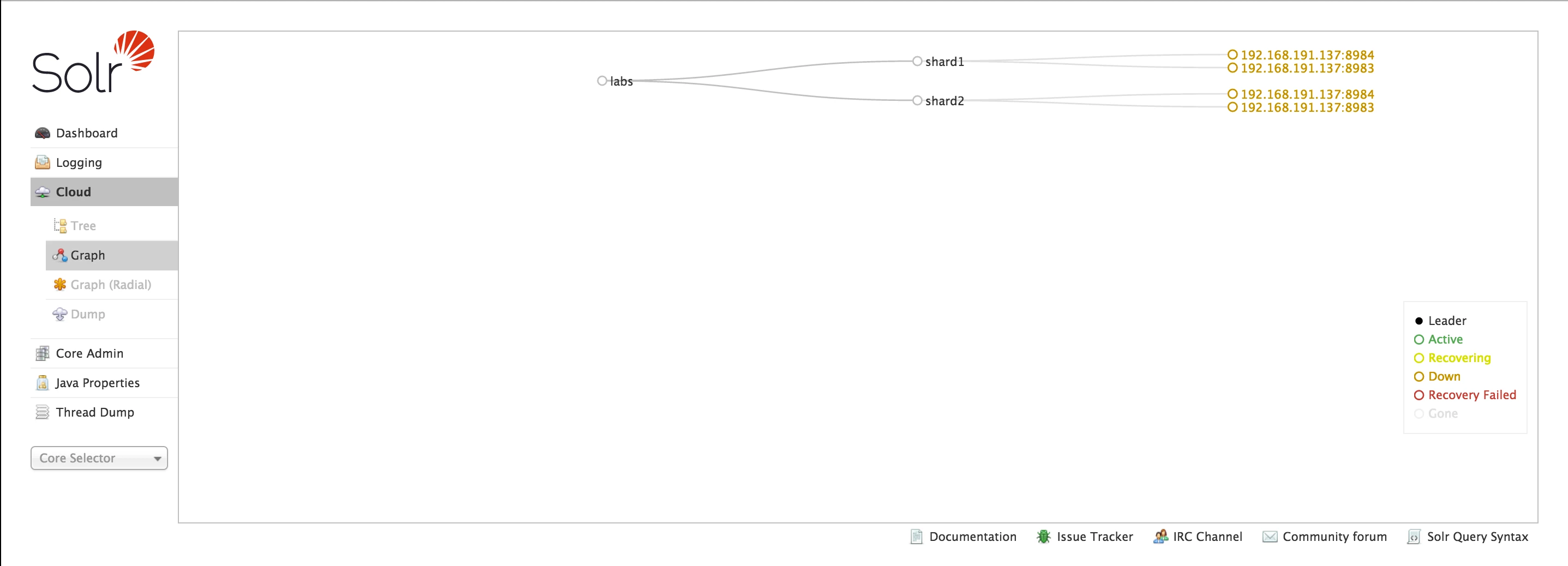

Step 5 - Validate that the labs collection got created

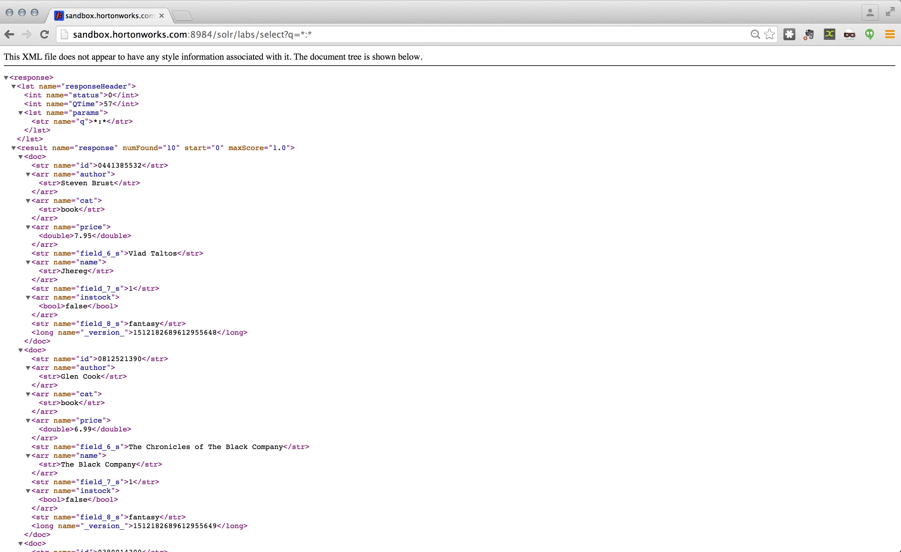

Step 8 - Search indexed documents
Step 9 - Lab Complete
