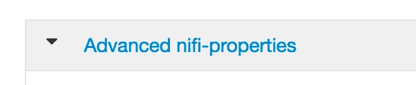

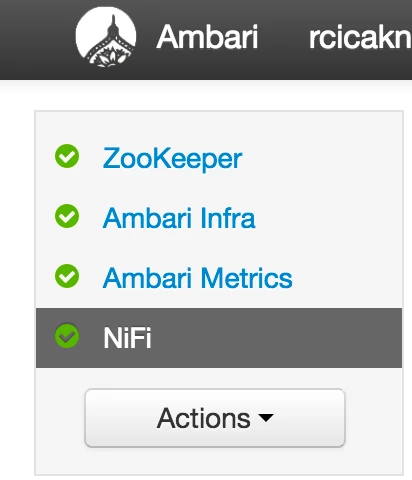

a) In Ambari, go to NiFi
b) Choose the Configs tab
c) Choose the Advanced nifi-properties

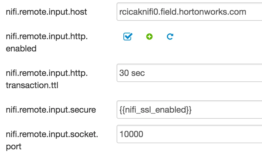

d) Set the nifi.remote.input.host to your NiFi hostname and nifi.remote.input.socket.port to 10000

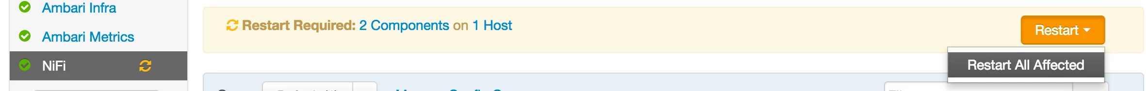

e) Restart NiFi using Ambari

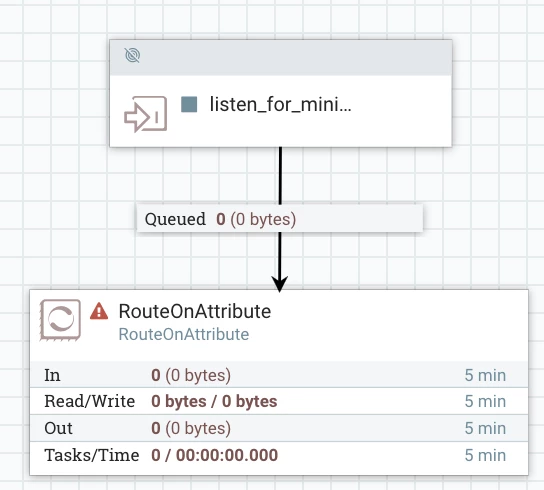

a) On the NiFi Flow Canvas, drag-and-drop an Input port (Name your Input Port – I named mine “listen_for_minifi_logs”)
b) Drag-and-drop processor RouteOnAttribute
c) Create a connection between Input Port and RouteOnAttribute

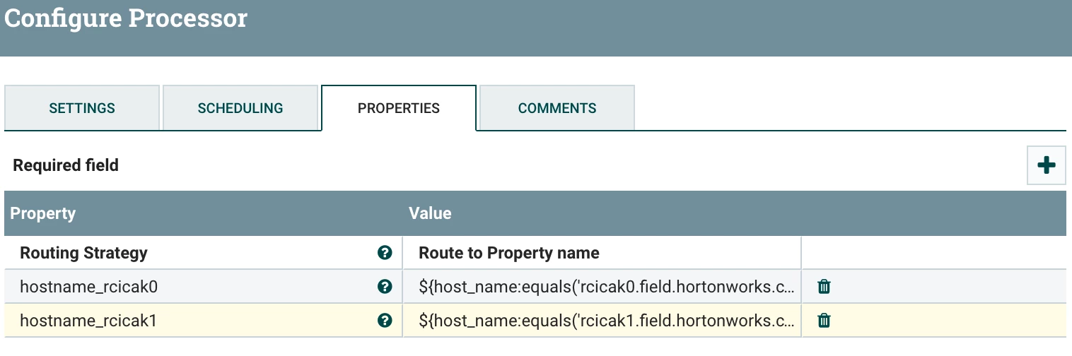

d) Configure RouteOnAttribute - Properties (removing the red caution), adding two properties (one property per server you’re installing MiNiFi on)

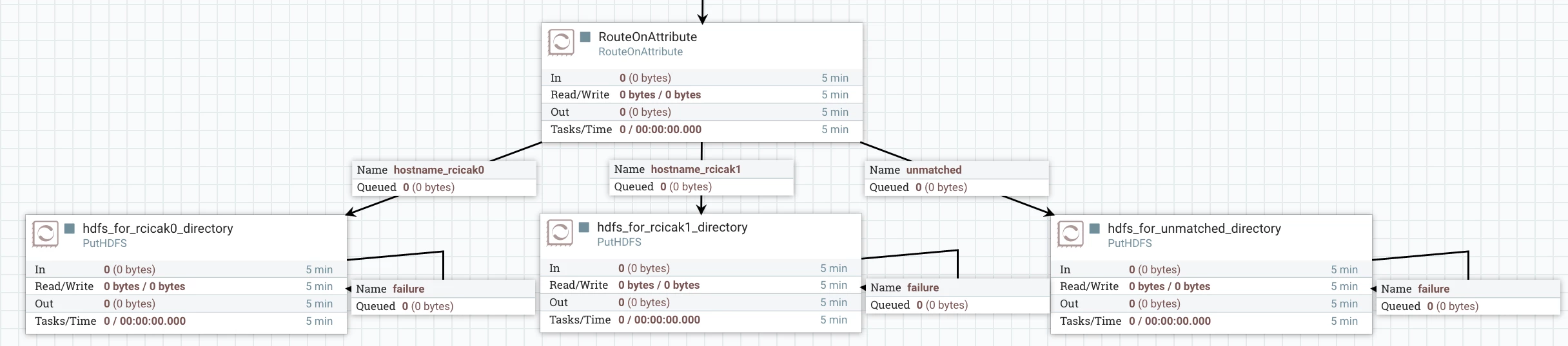

I have two servers – rcicak0.field.hortonworks.com and rcicak1.field.hortonworks.com, the incoming log data (flowfile) will contain an attribute called “host_name” where we’ll properly route the flowfile depending on the host_name property

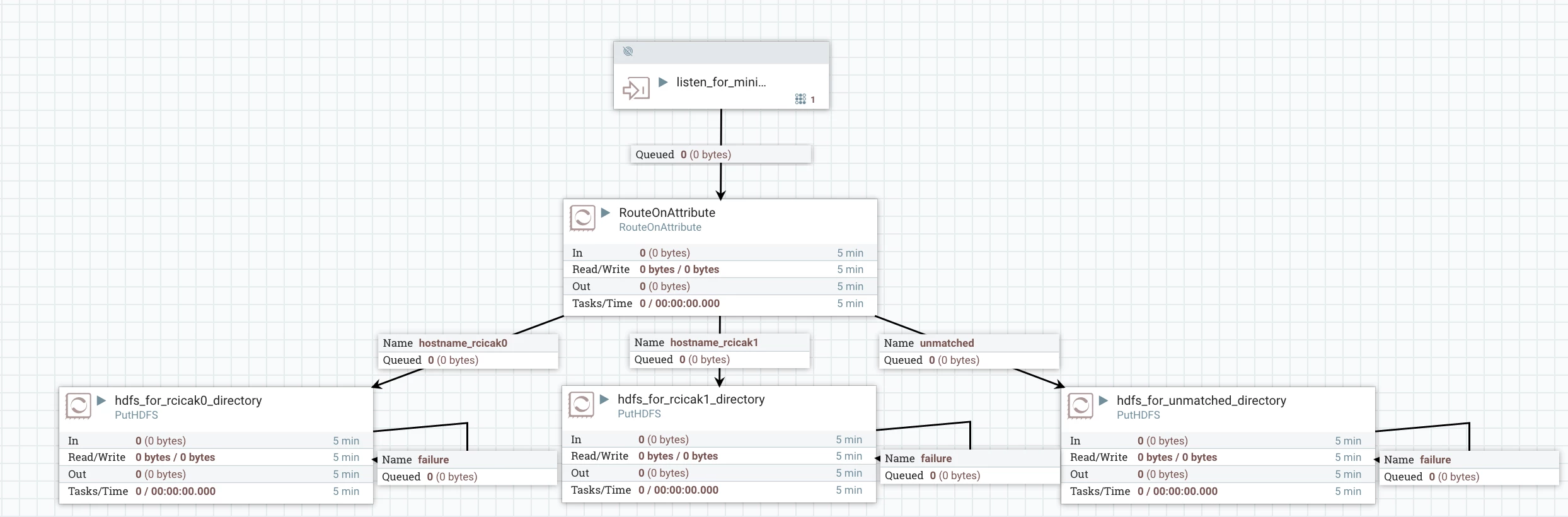

e) Drag-and-drop three putHDFS processors & create a connection using hostname_rcicak0, hostname_rcicak1 and unmatched

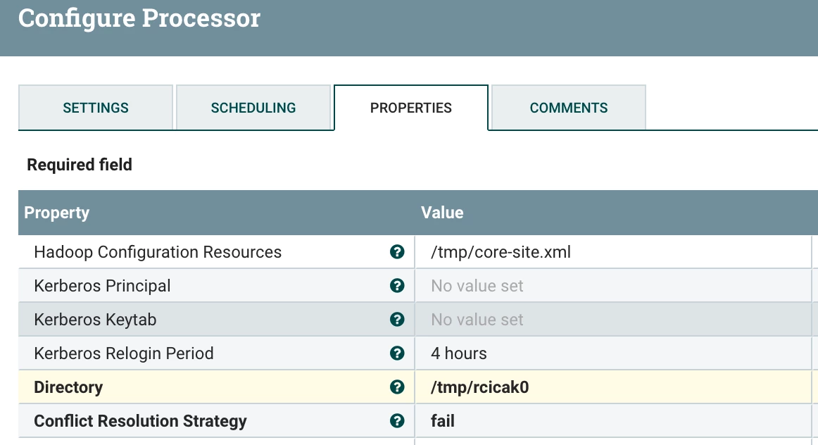

f) Each putHDFS processor will have a different HDFS directory – configure properties for each putHDFS processor /tmp/rcicak0/, /tmp/rcicak1/ and /tmp/unmatched
g) Configure the HDFS directory – properties
(adding a core-site.xml and the directory – depending on the connection)
h) Play the processors – at this point, the NiFi flow is ready to receive Log data from MiNiFi

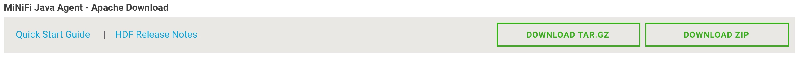

a) Download MiNiFi (from http://hortonworks.com/downloads/ ) on each of the servers (that contain log data)
b) Unzip minifi-0.0.1-bin.zip to a directory

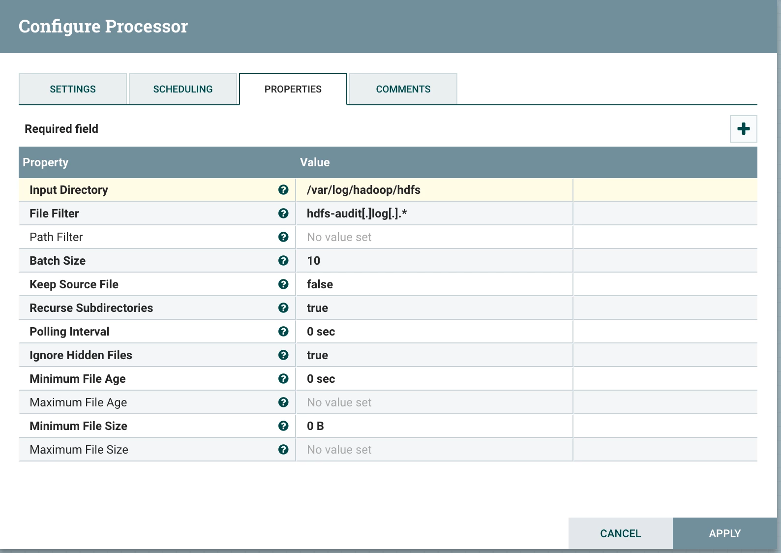

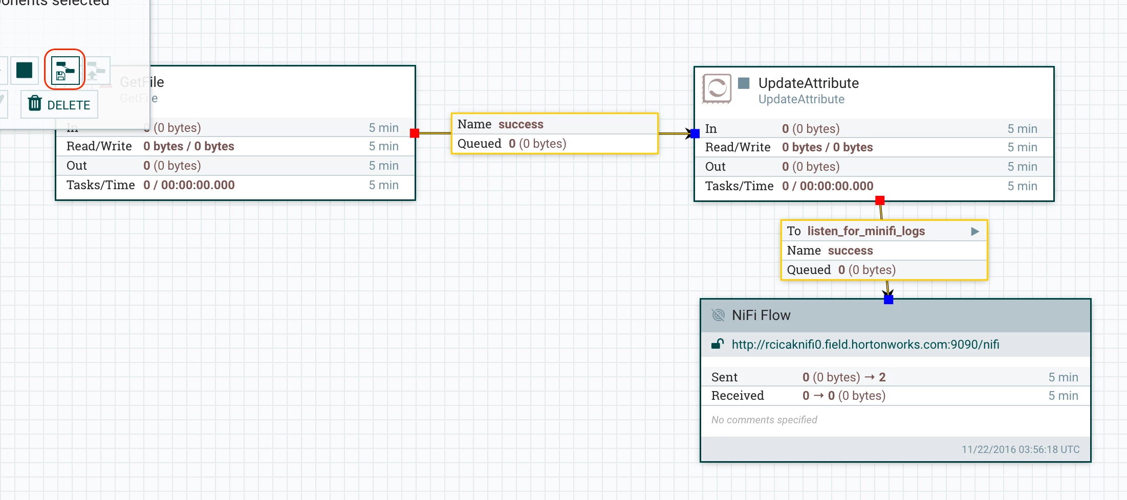

c) Drag-and-drop the processor GetFile
d) Configure the processor GetFile – Properties (IMPORTANT: Any file matching the file filter’s regular expression under input directory [and the recursive subdirectories when set to true], the file will be deleted once the file is stored in MiNiFi’s content repository
In the example above, the file filter looks for hdfs-audit.log.Archive -> in this case is a date
e) Drag-and-drop the UpdateAttribute processor and create a successful connection between GetFile and UpdateAttribute

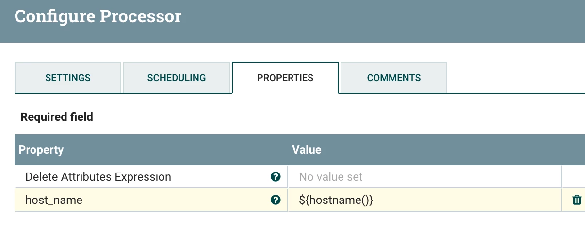

f) Configure the UpdateAttribute processor – Properties, setting the host_name attribute adding the nifi expression language getting the hostname

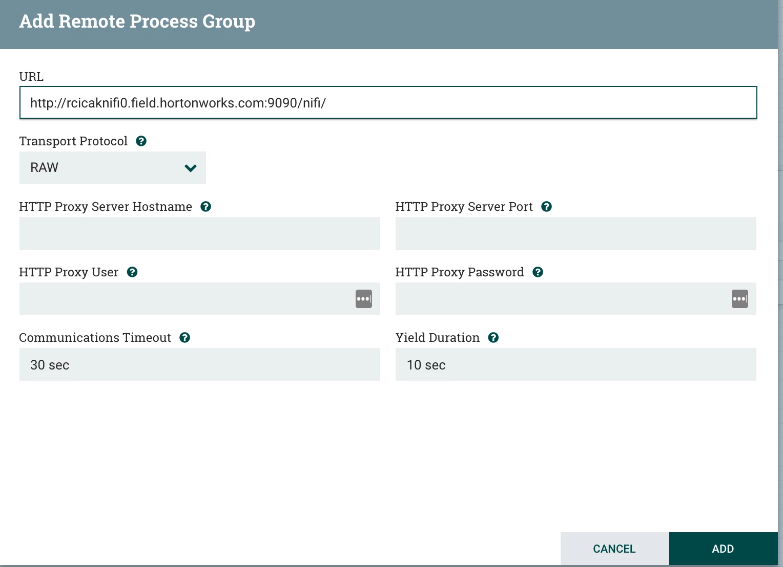

g) Drag-and-drop a remote process group – use the nifi.remote.input.host from above for the URL
Wait for the connection to establish before continuing to h

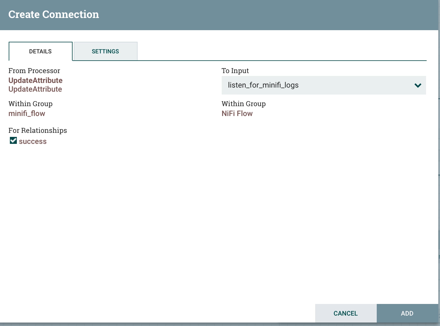

h) Add a connection between UpdateAttribute and the Remote Process Group – under To Input choose listen_for_minifi_logs
