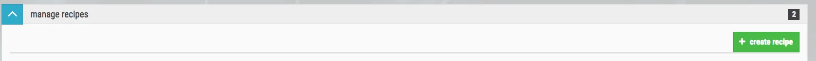

Before you can use a recipe during a cluster deployment, you have to create the recipe. In the Cloudbreak UI, look for the "mange recipes" section. It should look similar to this:
If this is your first time creating a recipe, you will have 0 recipes instead of the 2 recipes show in my interface.
Now click on the arrow next to manage recipes to display available recipes. You should see something similar to this:

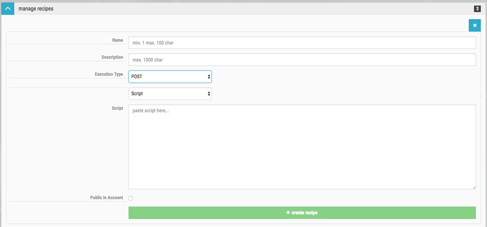

Now click on the green create recipe button. You should see something similar to this:

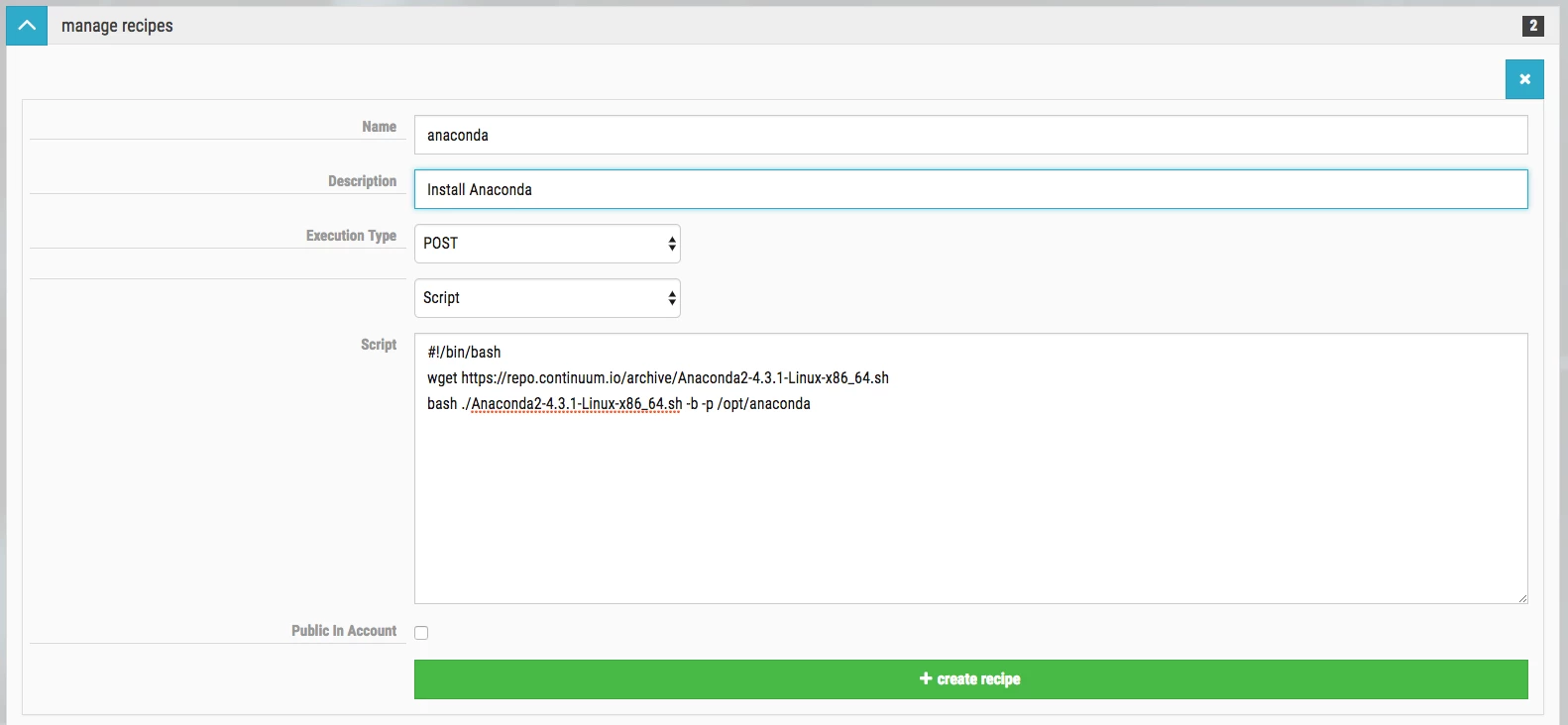

Now we can enter the information for our recipe. I'm calling this recipe anaconda. I'm giving it the description of Install Anaconda. You can choose to install Anaconda as either pre-install or post-install. I'm choosing to do the install post-install. This means the script will be run after the Ambari installation process has started. So choose the Execution Type of POST. Choose Script so we can copy and paste the shell script. You can also specify a file to upload or a URL (gist for example). Our script is very basic. We are going to download the Anaconda install script, then run it in silent mode. Here is the script:
#!/bin/bash
wget https://repo.continuum.io/archive/Anaconda2-4.3.1-Linux-x86_64.sh
bash ./Anaconda2-4.3.1-Linux-x86_64.sh -b -p /opt/anaconda
When you have finished entering all of the information, you should see something similar to this:

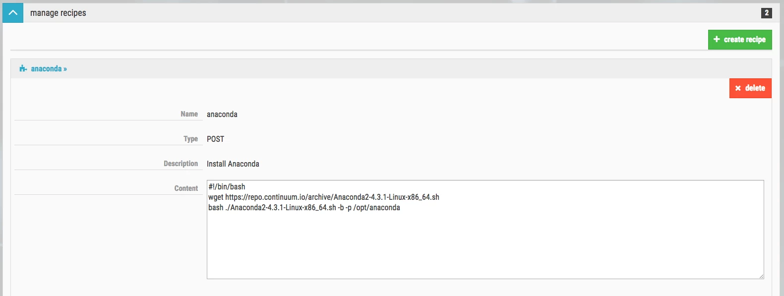

If everything looks good, click on the green create recipe button.
After the recipe has been created, you should see something similar to this:

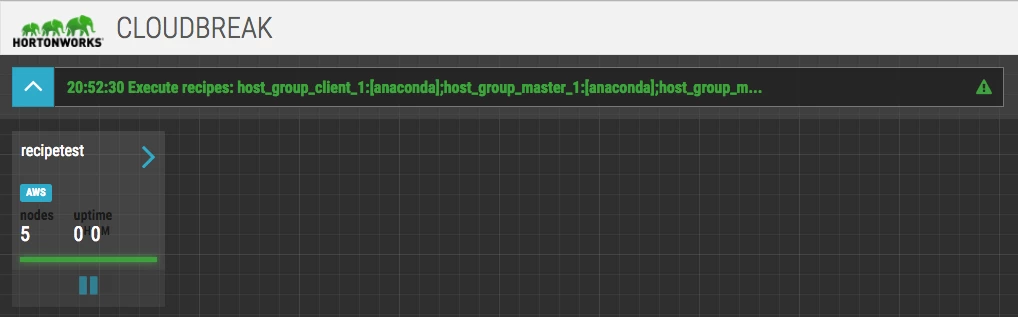

After you have selected the recipe for the host groups, click the Review & Launch button, then launch the cluster. As the cluster is building, you should see a message in the Cloudbreak UI that indicates the recipe is running. When that happens, you will see something similar to this:
Cloudbreak will create logs for each recipe that runs on each host. These logs are located at /var/log/recipe and have the name of the recipe and whether it is pre or post install. For example, our recipe log is called post-anaconda.log. You can tail this log file to following the execution of the script.
NOTE: Post install scripts won't be executed until the Ambari server is installed and the cluster is building. You can always monitor the /var/log/recipe directory on a node to see when the script is being executed. The time it takes to run the script will vary depending on the cloud environment and how long it takes to spin up the cluster.
