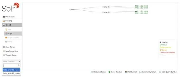

6 - CREATE AND VALIDATE A COLLECTION NAMED “LABS” WITH 2 SHARDERS AND REPLICATION FACTOR OF 2
/opt/lucidworks-hdpsearch/solr/bin/solr create -c labs
-d /opt/lucidworks-hdpsearch/solr/server/solr/configsets/data_driven_schema_configs_hdfs/conf -n labs -s 2 -rf 2
Using the browser, visit http://solr.hortonworks.com:8983/solr/#/~cloud. You should see the collection “labs” with 2 shards, each one of them with a replication factor of 2.

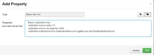

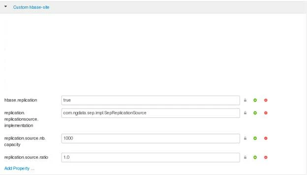

At AMBARI user interface (version 2.2.2.0), go to HBase -> Configs -> Custom hbase-site and click “Add Property ...” and then add the following properties:
hbase.replication=true
replication.source.ratio=1.0
replication.source.nb.capacity=1000
replication.replicationsource
Click the “Save” button. It should look like the screen bellow having entered the above properties:
Restart the services requested by AMBARI.

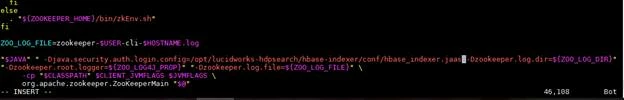

Alter the new zkcli.sh to use this JAAS file:
vim /opt/lucidworks-hdpsearch/solr/server/scripts/cloud-scripts/zkcli.sh
#Add the following information to the JAAS file to be able to authenticate
-Djava.security.auth.login.config=/opt/lucidworks-hdpsearch/hbase-indexer/conf/hbase_indexer.jaas
The result is:

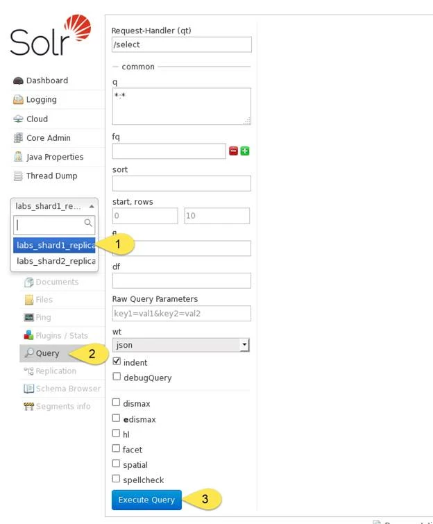

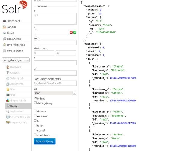

Insert some records into HBase to verify it into Solr:
put 'indexdemo-user', 'row1', 'info:firstname', 'Gerdan'
put 'indexdemo-user', 'row1', 'info:lastname', 'Santos'
put 'indexdemo-user', 'row2', 'info:firstname', 'Pedro'
put 'indexdemo-user', 'row2', 'info:lastname', 'Drummond'
put 'indexdemo-user', 'row3', 'info:firstname', 'Cleire'
put 'indexdemo-user', 'row3', 'info:lastname', 'Ritfield'
put 'indexdemo-user', 'row4', 'info:firstname', 'Horton'
put 'indexdemo-user', 'row4', 'info:lastname', 'Works'

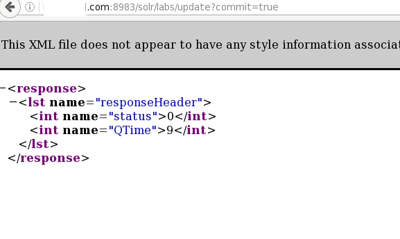

Perform a commit in Solr via terminal ( very important):
#Via terminal
curl http://solar.hortonworks.com:8983/solr/labs/update?commit=true
Or via browser:
Verify in Solr if the indexed data appears:
There you go! The HBase indexer with a kerberized cluster is now working:

In HDP 2.5, users will have uncomment two lines in bin/hbase-indexer to make it work!
HBASE_INDEXER_OPTS="$HBASE_INDEXER_OPTS -Dlww.jaas.file=/opt/lucidworks-hdpsearch/hbase-indexer/conf/hbase_indexer.jaas" HBASE_INDEXER_OPTS="$HBASE_INDEXER_OPTS -Dlww.jaas.appname=Client" #Client is the name given in this tutorial to Jaas Section

Tip! 🙂
Please make sure to add below line in hbase-indexer-env.sh in order to avoid org.apache.zookeeper.KeeperException$NoAuthException:KeeperErrorCode=NoAuthfor/hbase-secure/blah blah error
HBASE_INDEXER_OPTS="$HBASE_INDEXER_OPTS -Djava.security.auth.login.config=<path-of-indexer-jass-file>"
