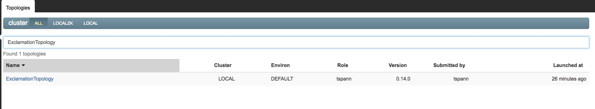

Look at my topology
http://localhost:8881/topologies#/all/all/ExclamationTopology
"status": "success", "executiontime": 7.104873657226562e-05, "message": "",
"version": "1.0.0",
"result": {"local": {"default": ["ExclamationTopology"]}}
Adding --verbose will add a ton of debug logs.

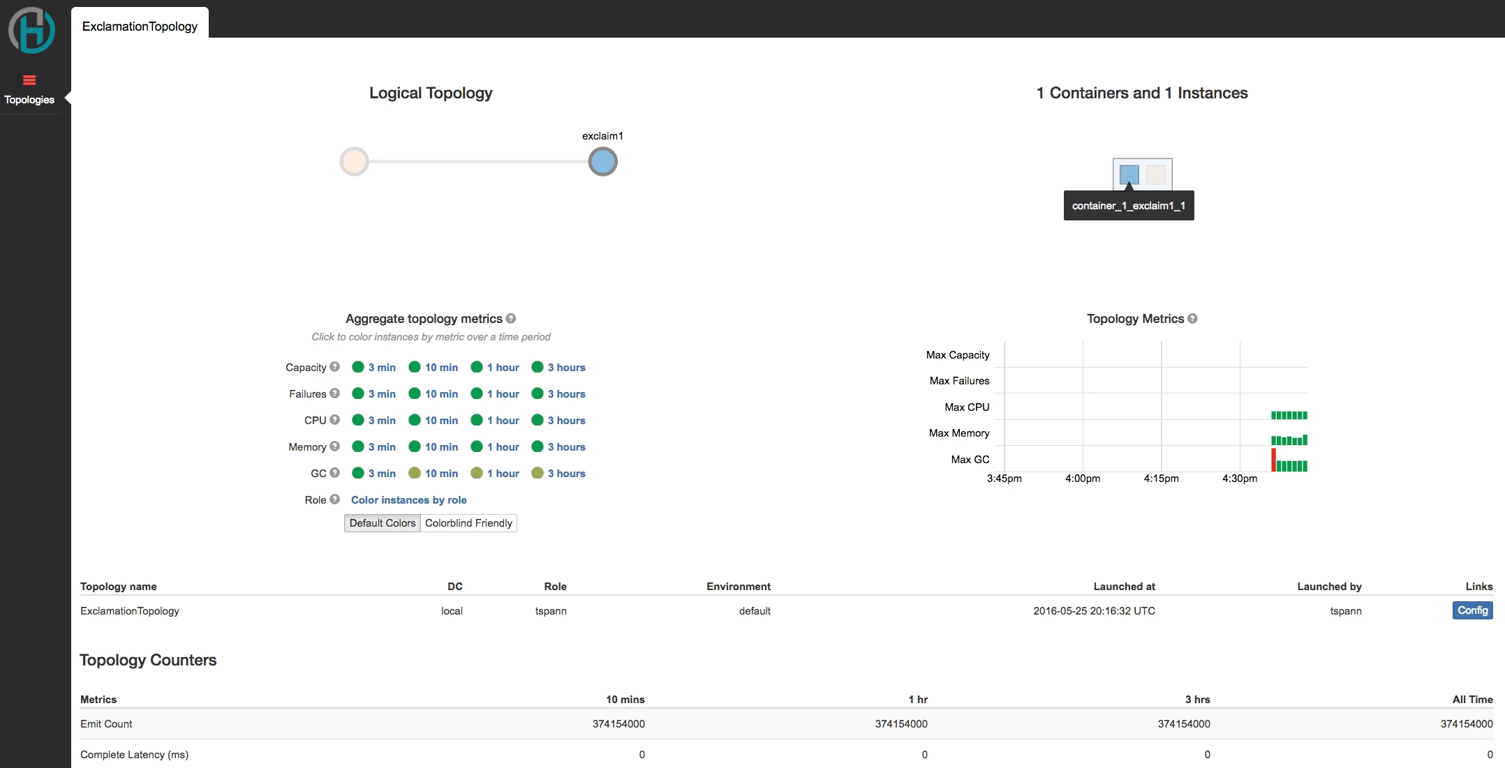

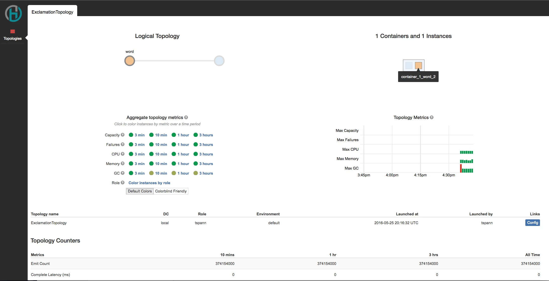

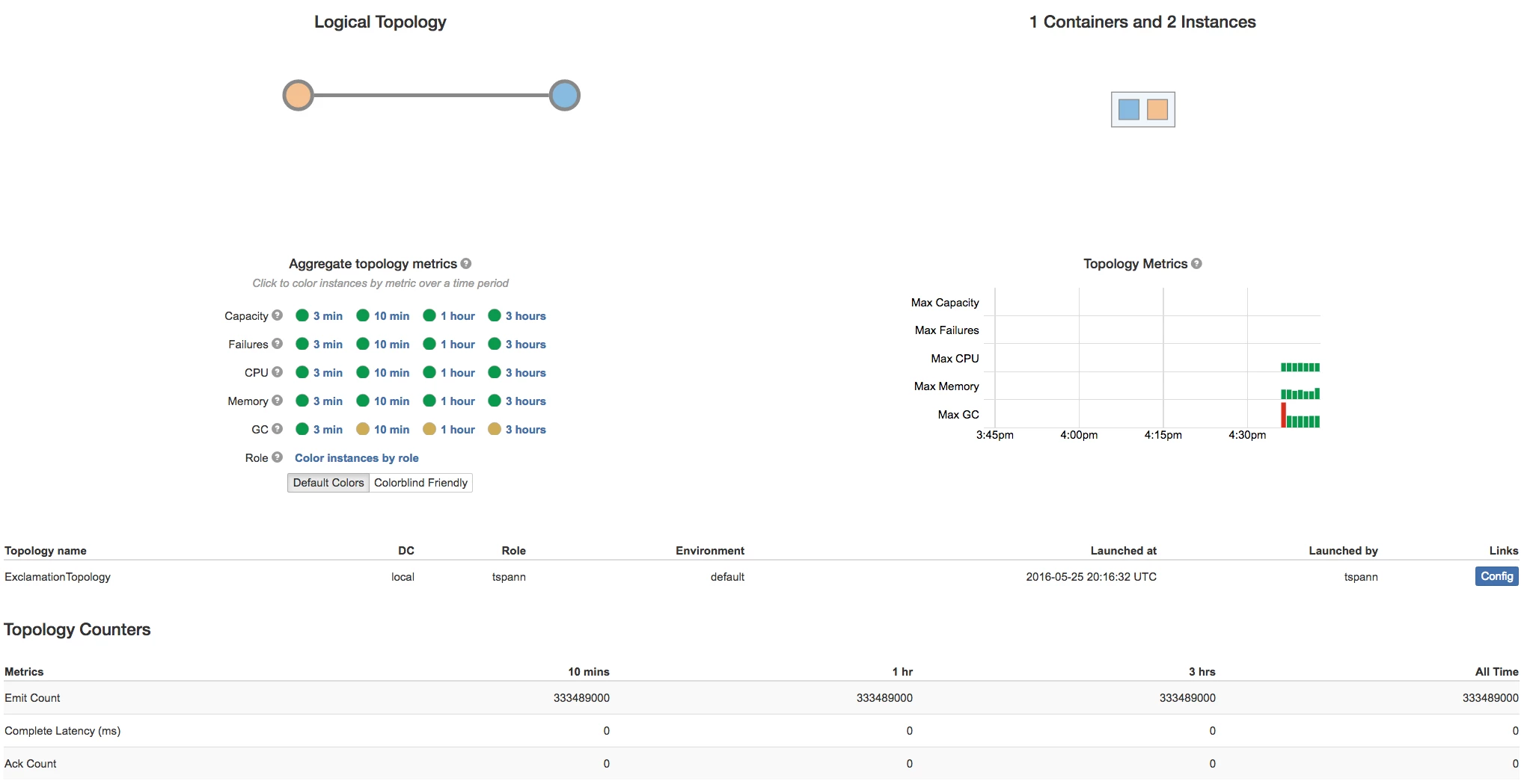

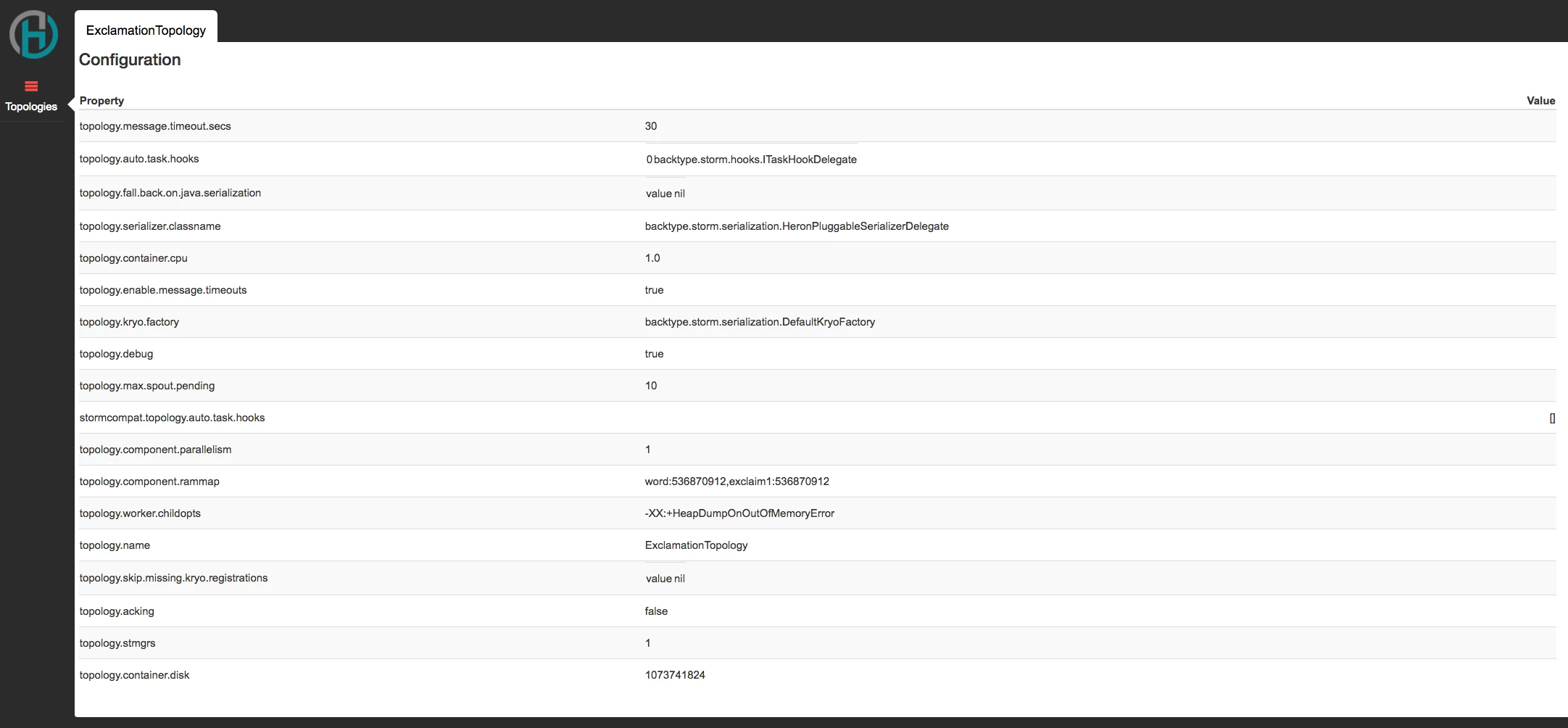

Attached are some screen shots. The Heron UI is decent.
I am hoping Heron screens will be integrated into Ambari.
