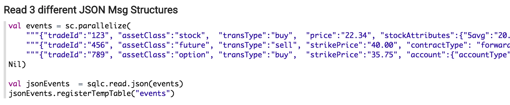

{"tradeId":"123", "assetClass":"stock", "transType":"buy", "price":"22.34",
"stockAttributes":{
"5avg":"20.12","52weekHi":"27.56"
{"tradeId":"456", "assetClass":"future", "transType":"sell", "strikePrice":"40.00",
"contractType": "forward",
"account":{
"city":"Columbus","state":"Ohio", "zip":"21000"
{"tradeId":"789", "assetClass":"option", "transType":"buy", "strikePrice":"35.75",
"account":{
"accountType":"retail","city":"Columbus","state":"Ohio"
1.0 The below image shows the 3 different JSON msgs (stock,option,future) with different attributes and structures.

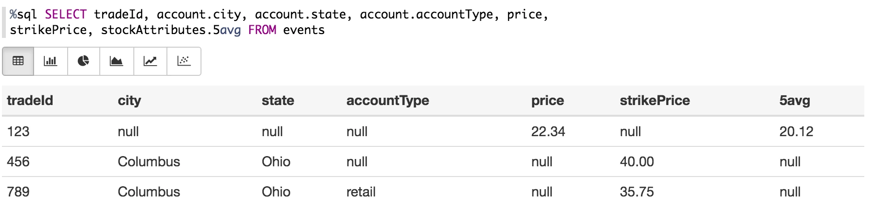

2.0 Here you can query all of the data or any segment of the data using SQL.
Full code on zephub - code link
