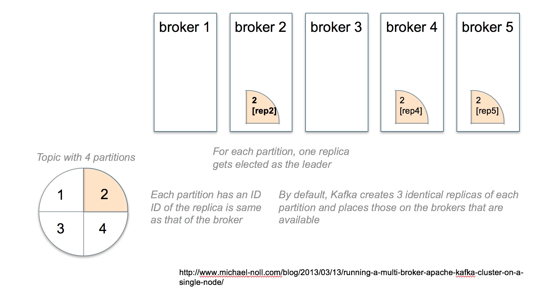

Number of partitions for a topic

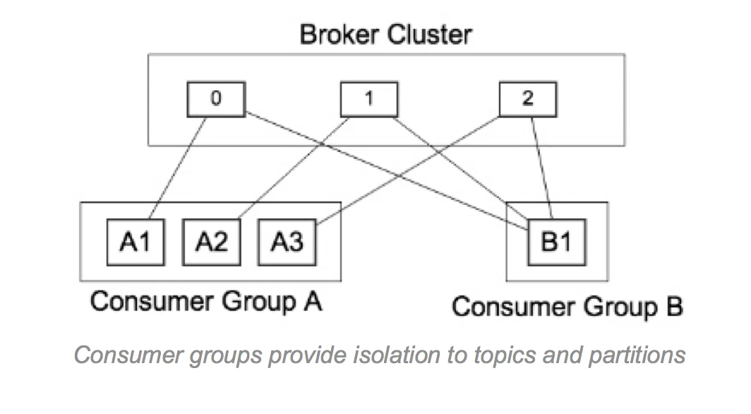

CONSUMERS:
    max.partition.fetch.bytes
  • The maximum amount of data per-partition the server will return. The maximum total memory used for a request will be #partitions * max.partition.fetch.bytes. This size must be at least as large as the message.max.bytes or else it is possible for the producer to send messages larger than the consumer can fetch. If that happens, the consumer can get stuck trying to fetch a large message on a certain partition.
  • fetch.message.max.bytes
  • The number of bytes of messages to attempt to fetch for each topic-partition in each fetch request. These bytes will be read into memory for each partition, so this helps control the memory used by the consumer. The fetch request size must be at least as large as message.max.bytes or else it is possible for the producer to send messages larger than the consumer can fetch.

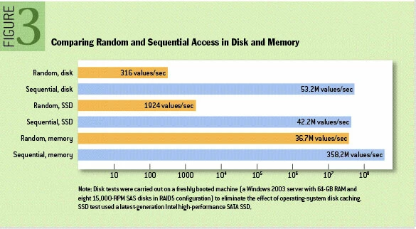

    • While most Kafka deployments contain a lot of RAM, you can get comparable performance with spinning disks depending on the type of IOPS you need.
    • Give huge page cache & avoid disks if you are going to be doing random IO operations.
    • Kafka broker will always write to page cache (OS) first
      • Messages are flushed by based on several configurations
      • Flush message to disk controlled by log.flush.interval.message
        Defaults to Long.MAX_VALUE which is very big
      • The number of messages written to a log partition before we force an fsync on the log
      • The per-topic override for log.flush.interval.messages
      • OS will flush (pdflush) regardless of kafka params
    • Default flush configurations will cover most use cases as the durability is provided by replication
    Source: http://queue.acm.org/detail.cfm?id=1563874
