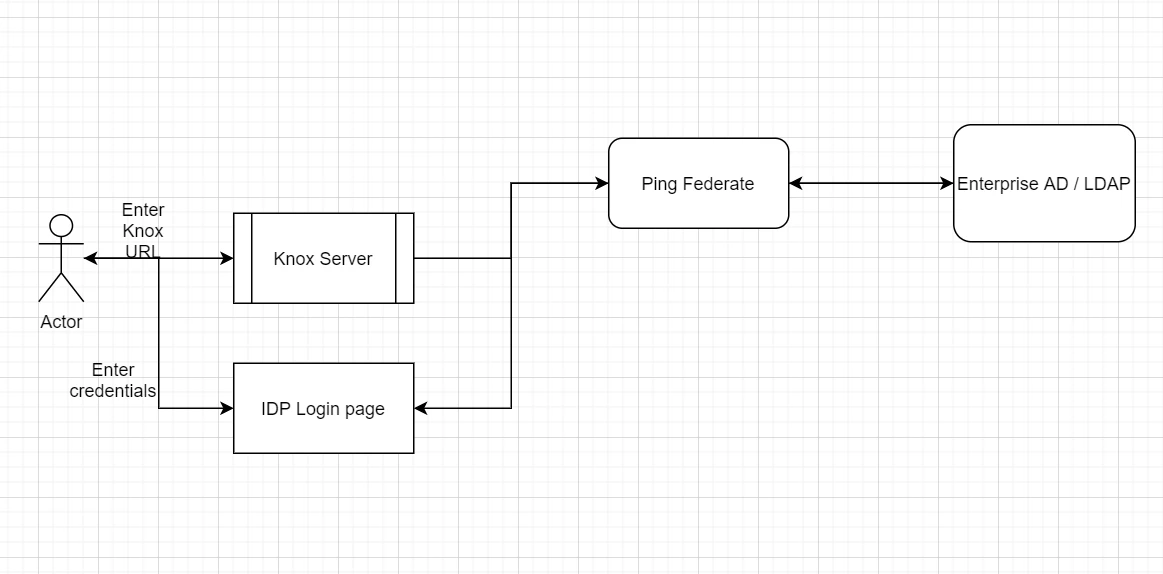

The following diagram depicts the process at a high level:
The SAML authentication process has three components
- Identity Provider: Identity provider has the flexibility to authenticate users against an authentication source, and sends a SAML response XML back to the service provider
- Service Provider: Service provider is an application that requires users to authenticate
- Authentication source: A directory service such as AD, LDAP. The service provider uses the authentication token and does not need to know the authentication source.
As part of this integration, both IDP (Ping Fed) and SP (Knox server) exchange information for the handshake to work successfully.
