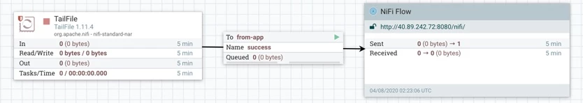

NiFi Stateless will pull an existing flow from NiFi Registry.  The following is a simple NiFi flow designed in NiFi:

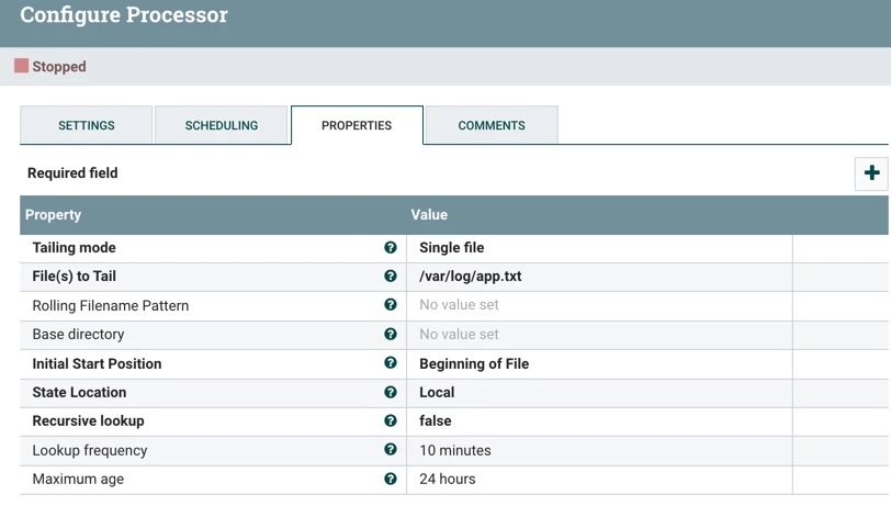

TailFile processor will tail the application log file /var/log/app.txt.  The application deployed will write log entries to this file:

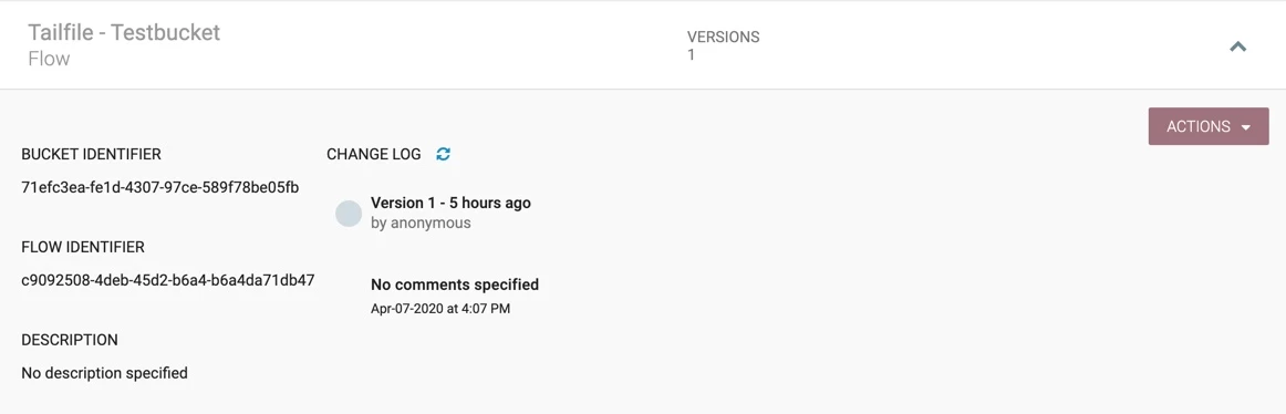

The flow is checked into NiFi Registry.  NiFi Registry URL, Bucket Identifier & Flow Identifier will be used by NiFi Stateless at run time. More about this soon.

In that YAML file, NiFi Registry URL, bucketId, and flowId will need to be updated. These values are from the NiFi registry. NiFi Stateless binds itself at runtime to a specific flow to execute.
    args: ["RunFromRegistry", "Continuous", "--json", "{\"registryUrl\":\"http://nifiregistry-service\",\"bucketId\":\"71efc3ea-fe1d-4307-97ce-589f78be05fb\",\"flowId\":\"c9092508-4deb-45d2-b6a4-b6a4da71db47\"}"]
